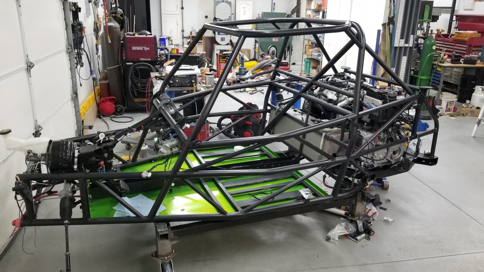

80 degrees?!? You must have tried to paint that a while ago, cause it's been hotter than blue blazes here for a couple weeks now. Good to see you are doing final build things and no longer dry fitting. The green floor is a great color and will definitely stand out once you are finished. :)
Ha, yeah, that was last Friday at 6am. Started painting at 7 and by the time we finished it was 80 degrees. I'm not sure what we were doing wrong. That Steel-it was just weird to shoot. It's super thick, they say "no reducer" and still orange peals terrible. And the overspray. yikes.
Kinda like spraying metal flake I'm guessing. I could never get it right, but one of buddies from high school could shoot it all day long, using the same spray setup, and it would come out perfect. There is as much art as science being able to spray paint better than just good. :p

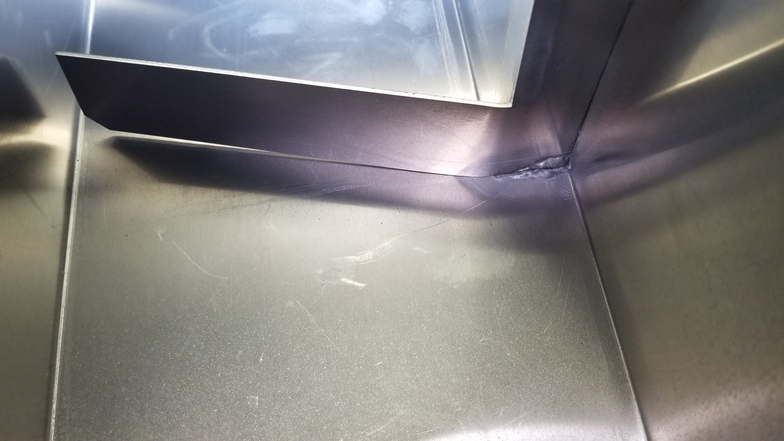

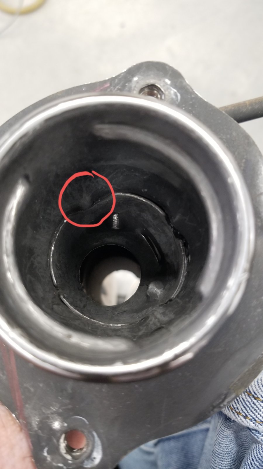

Had a clearance issue with the fuel level float. While cleaning the tank, and inspecting with the phone, I noticed that the baffle is only attached to one side. I was able to reach in and give it a slight bend and now it misses the float. I'm not sure how well it will work as a baffle with the huge gaps, but we only changed that by about 1/16" on the far left. As a side note, it's nice and clean in there

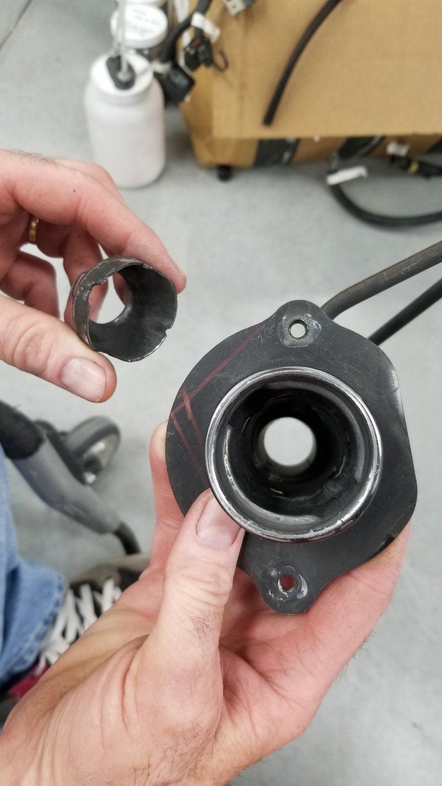

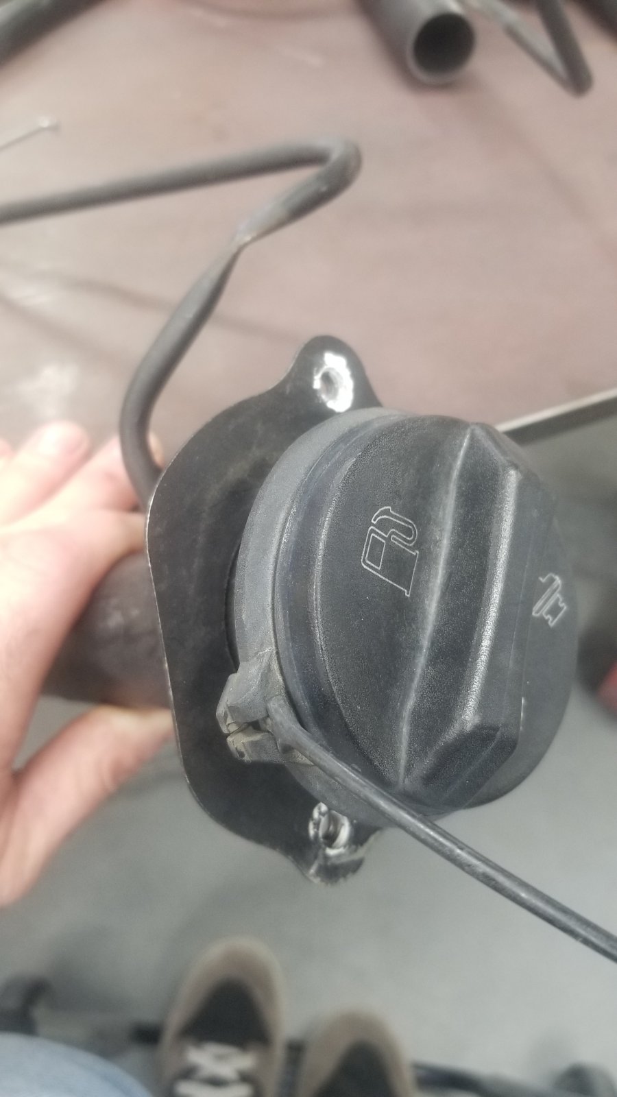

After semi- ruining the cobalt filler tube I bought for $15, I remembered I have one from the HHR.
In the build video, it says to remove the baffle, does anyone know how to do this if it has these big dimples . I've searched the forum but can't find an answer

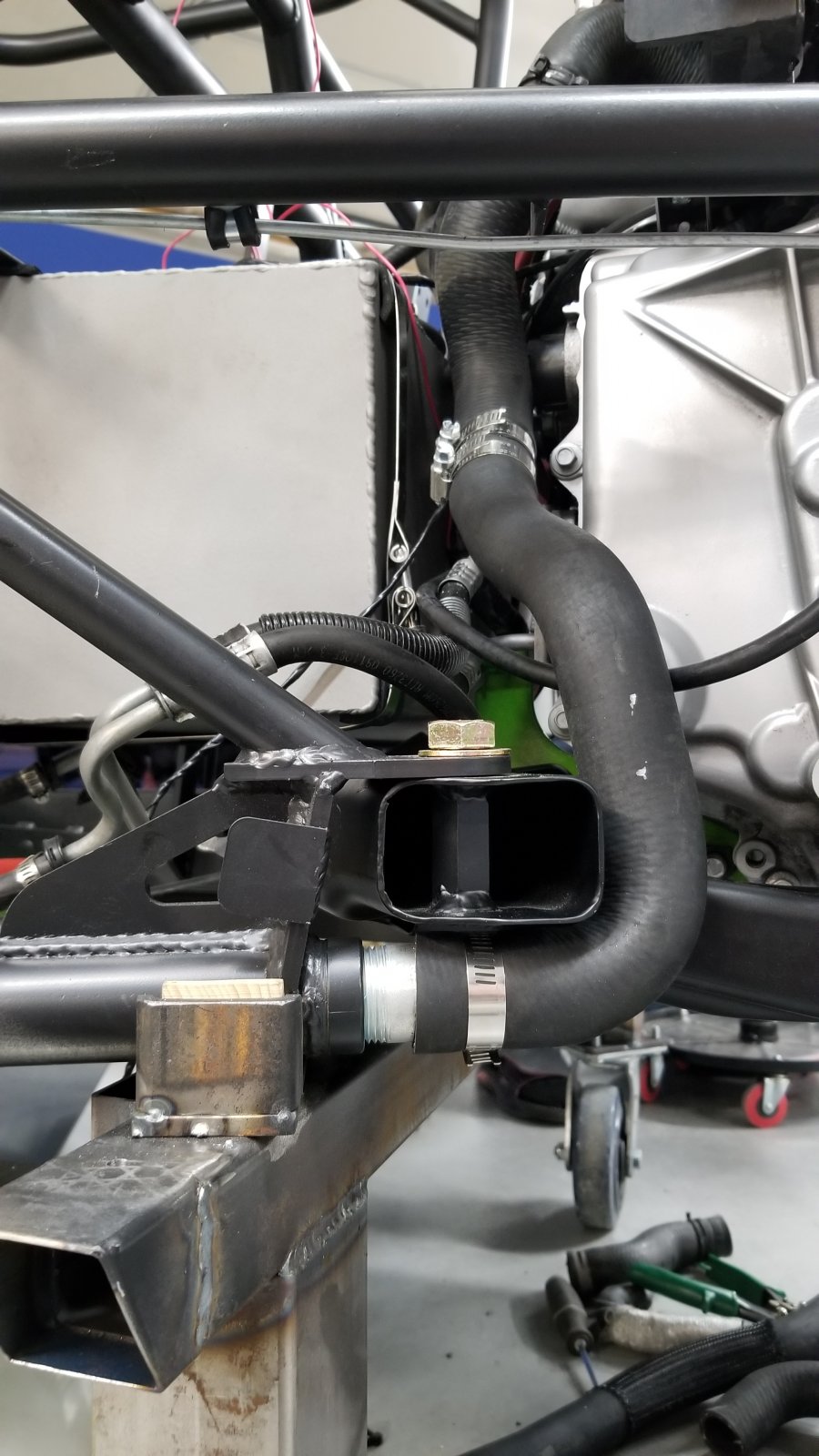

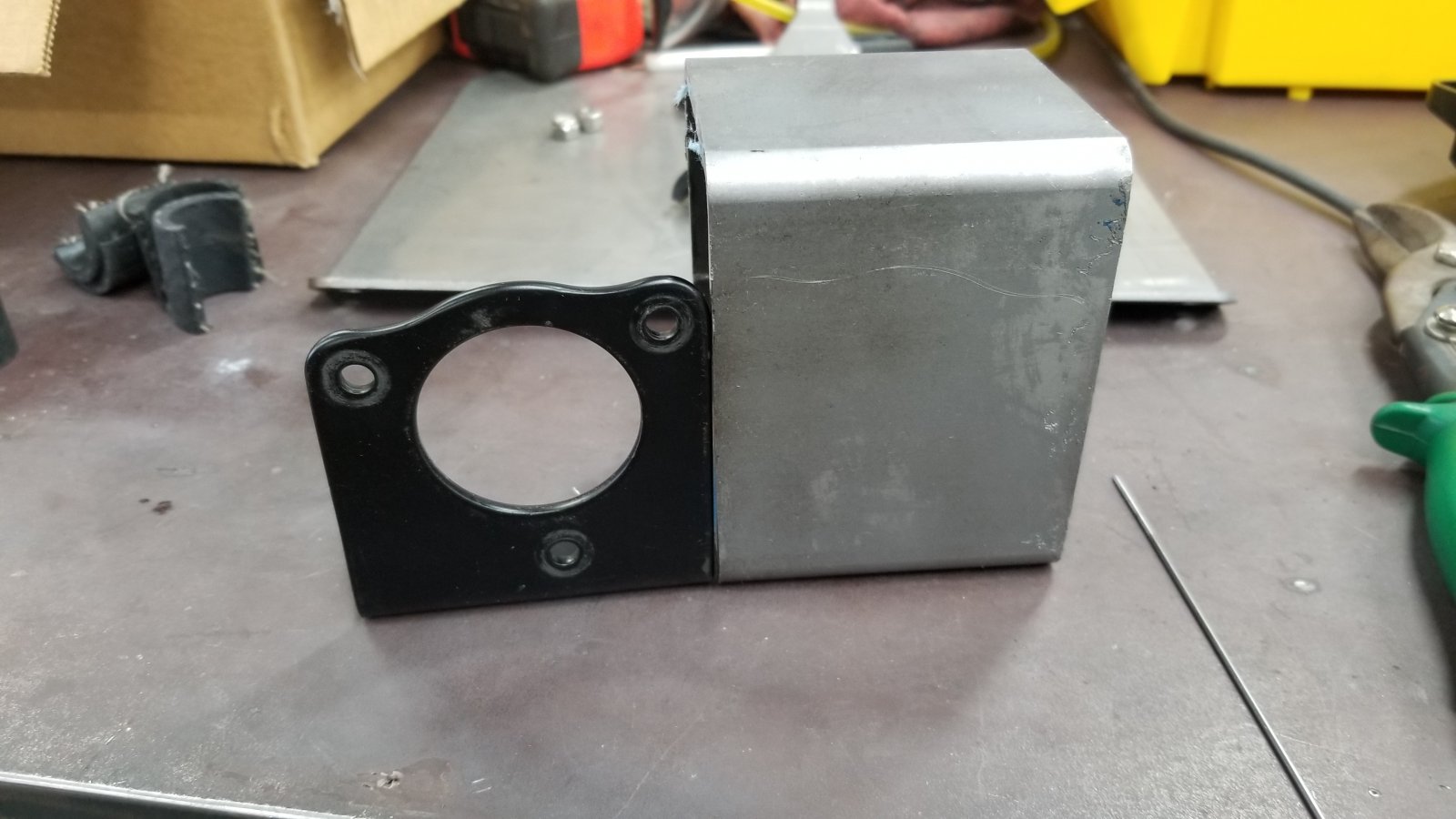

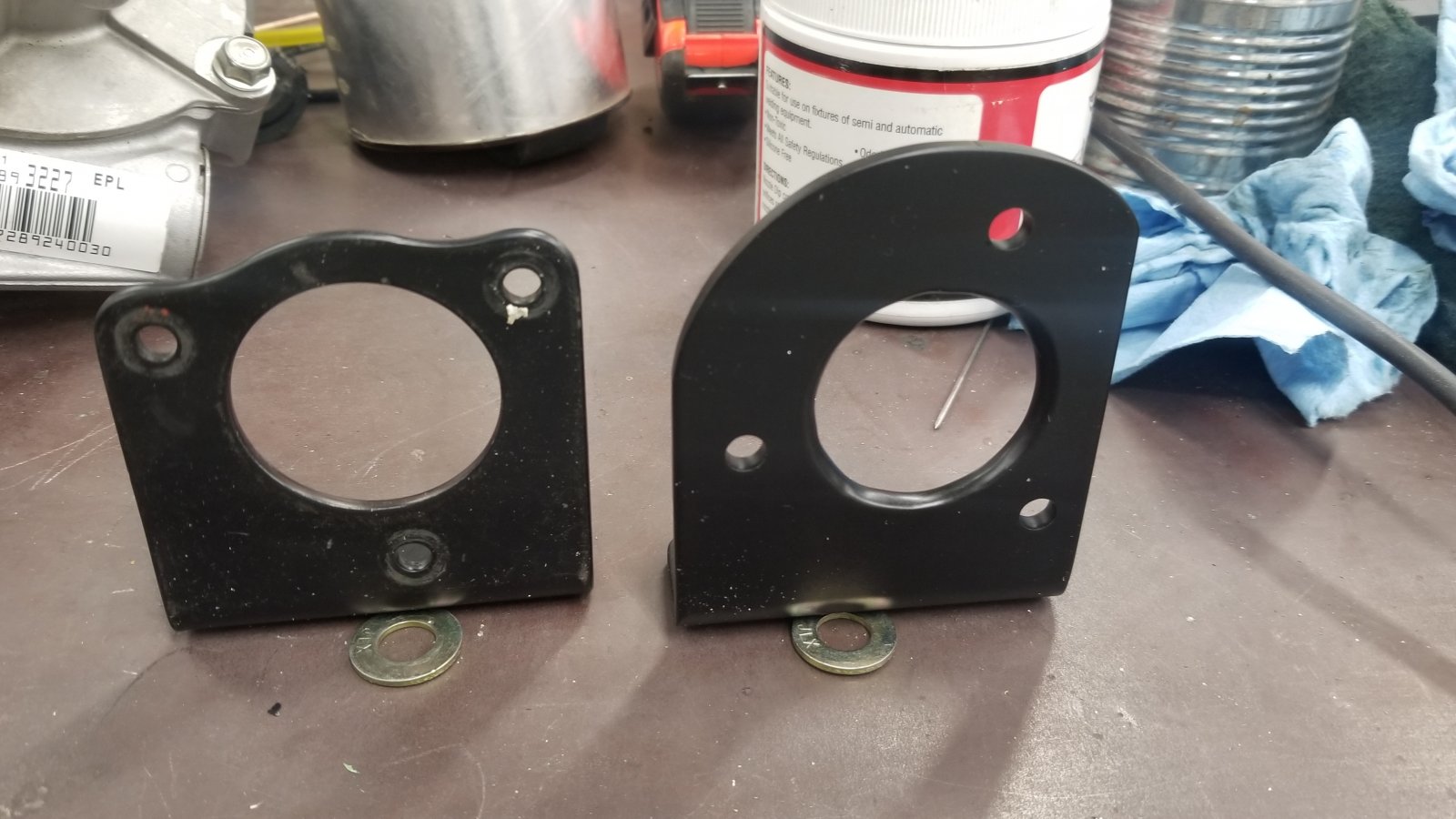

Got the new power steering box bracket built with the HHR clocking.
After we got it mounted, I realized we maybe should have clocked it more clockwise to give some more leg room. No time now. We've got a race in 5 weeks.

Tim, yes, we cleaned the inside of the filler hose. The stuff in the filler hose is from being cut with a saw. We cleaned ours and then had to cut it with the band saw and it was dirty again.

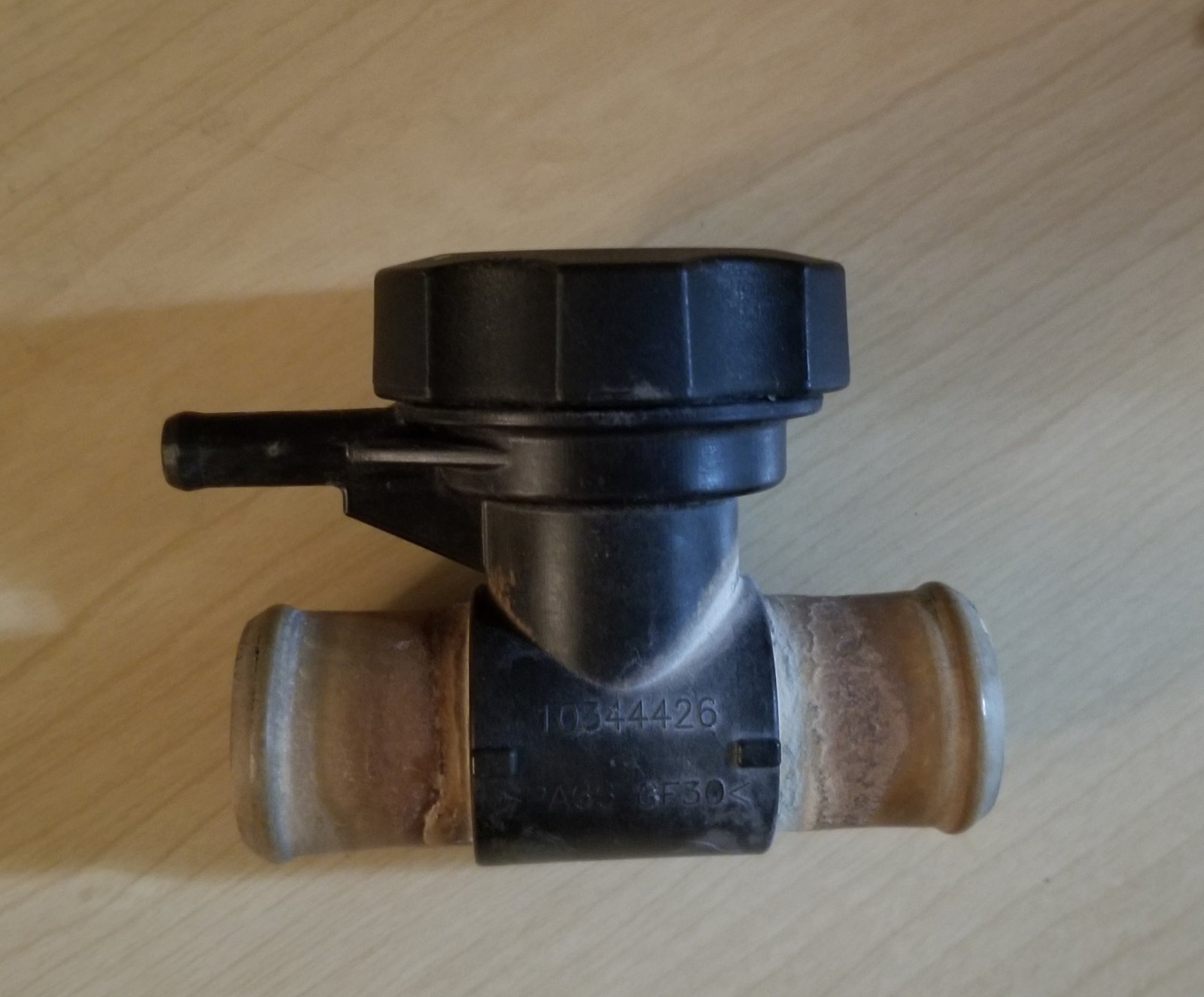

Would there be a benefit to installing this at the coolant outlet from the motor as a high point fill? How hard is it to get the air out of the system. I see the video says to remove the overflow and hold it up higher than the motor. How many times does this have to be done?

I don't know if anyone else has done this but I used my air lift tool to put a vacuum on the cooling system and sucked the coolant into the engine. I have run the car multiple times and no air bubbles have came out. The level never dropped and temps were all good.
Karter2026
I did the same Never added a drop after the initial fill. Now when I drained it for the SC install I vacuumed it down and filled it I had to add about 8oz after that. I think it was because I did not have it completely empty. Great way to check for leaks also If it wont hold a vacuum it will leak coolant.
