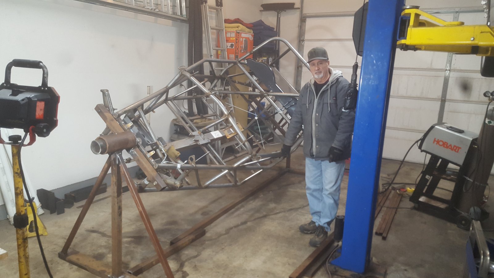

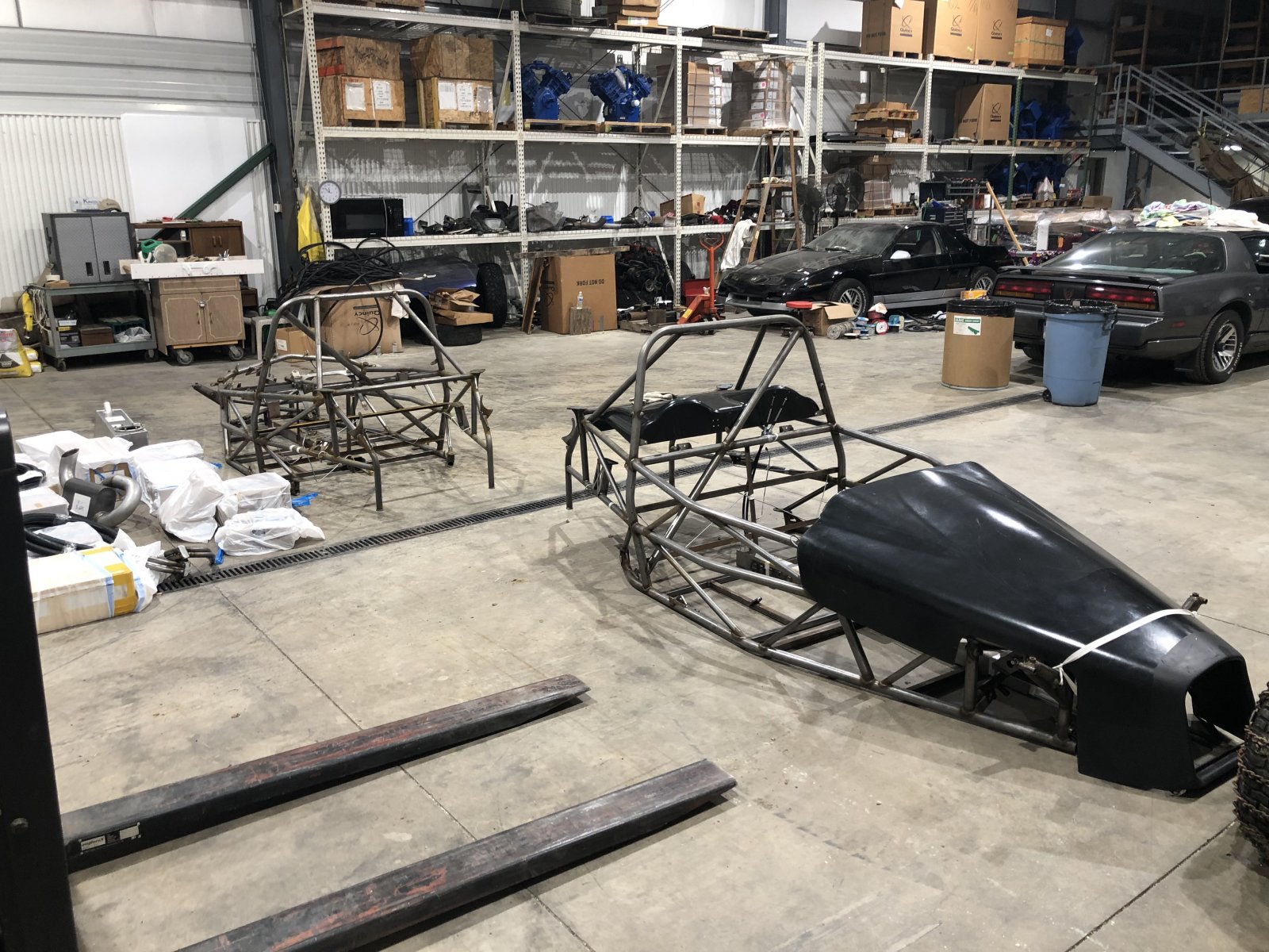

Hello Goblin community,
My name is Jim and this is only my 2nd post on the forum so I wanted to start my build log and this being Christmas eve day I finally have the opportunity to write a little on the forum. I didn't list a donor because I haven't purchased one yet but it will be a turbocharged build.
I have two kits to build so I figured it would be worth building a rotisserie for the frame.
This first one is for my buddy. Then the 2nd one will be mine.
I need to paint my frame and I'm sure there are plenty of things I can do till I find my donor so any advice would be appreciated. Thanks and Happy Holidays! Jim

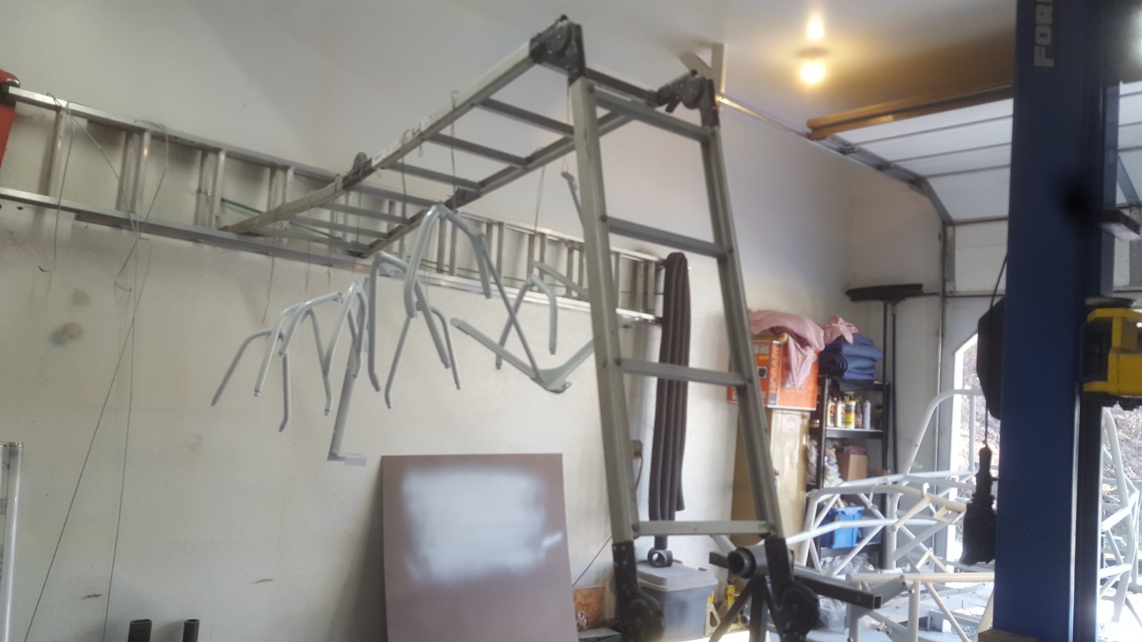

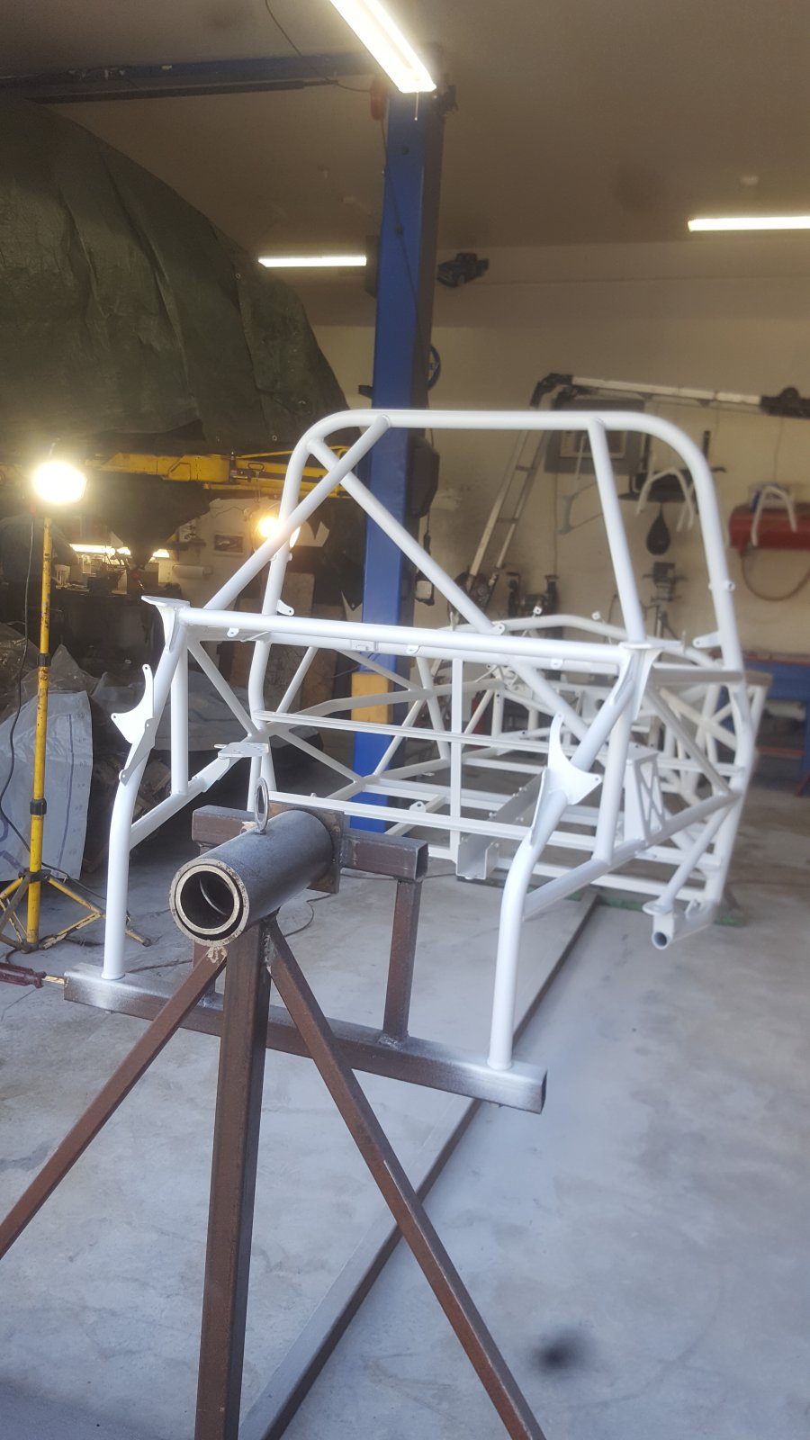

I give credit to those who are building there cars and take the time to post to the forum. I'm retired and find it hard to spend the time building my Goblin and then taking time to post. LOL! That said here is where I am to date with the build of my buddies Goblin...

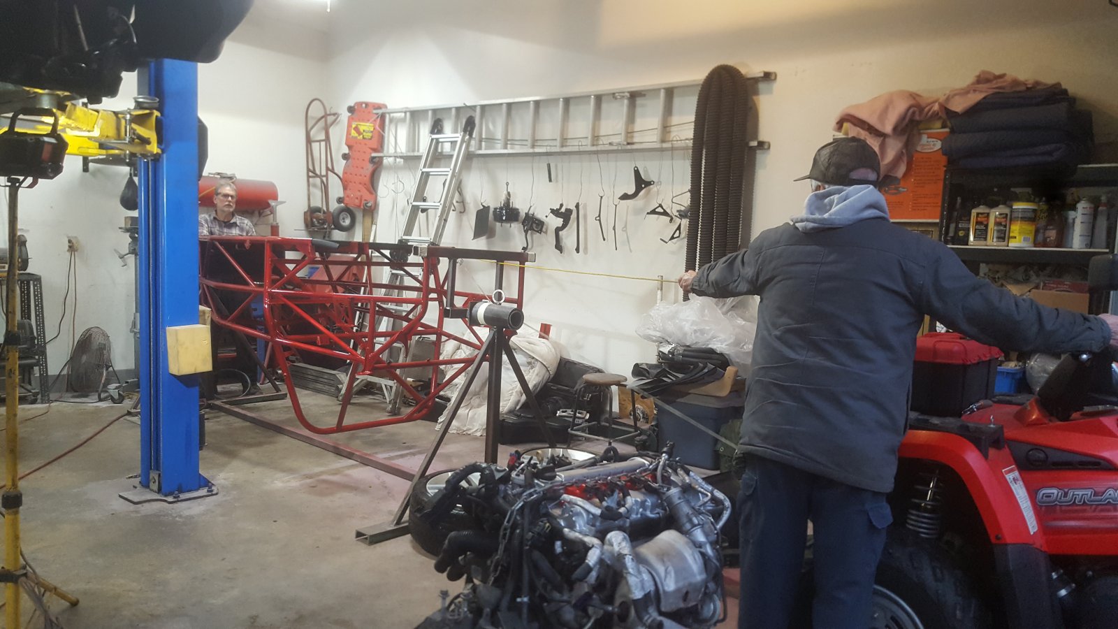

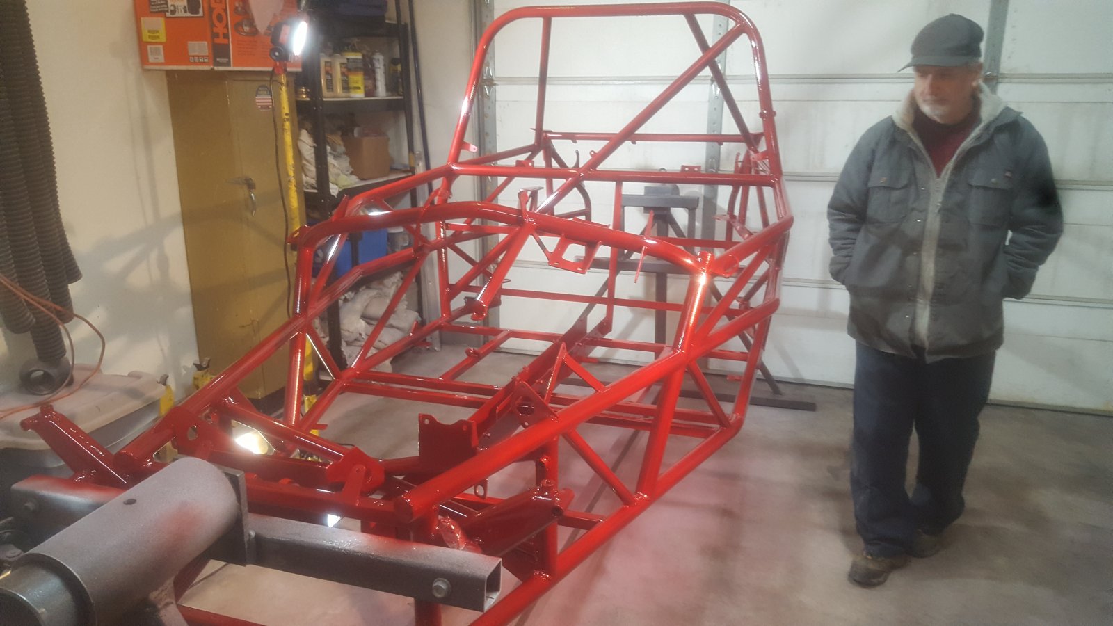

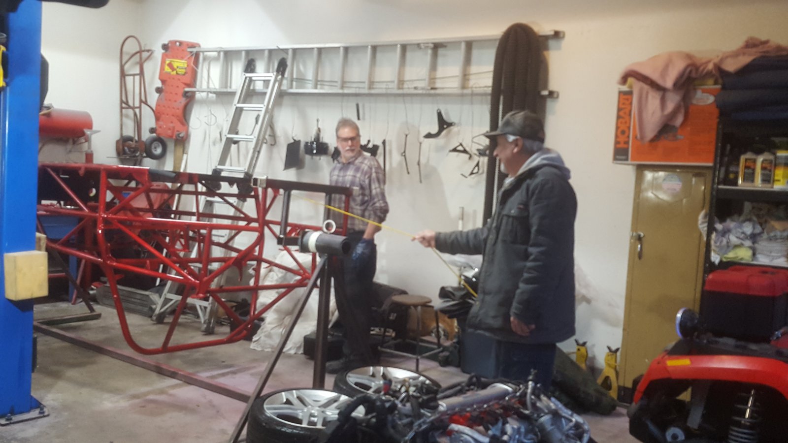

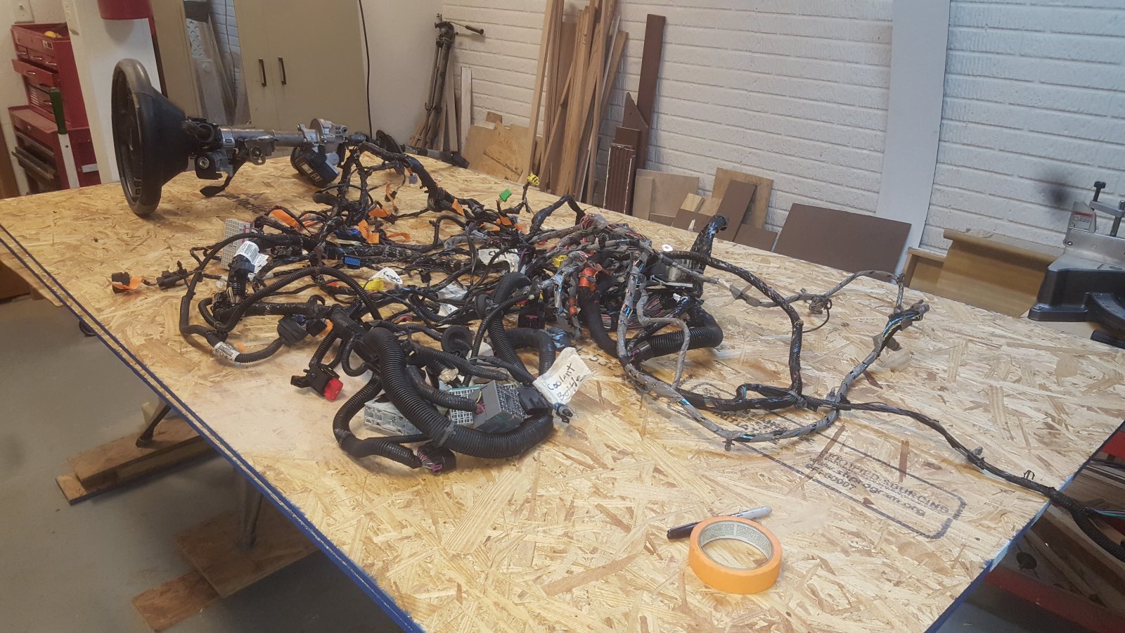

Frame has been epoxy primer, base coat/clear coat. Donor stripped and completely sold all all leftover part's even the shell. Used the winch on my quad to pull the hoses through the frame which made it very easy to do. Painted the majority of the donor parts to install on the Goblin. Rewired the Cobalt harness for installation. That was a little tricky since it was a 09 LNF sedan with all the extra wiring. Used SI from my old place of employment to access the schematics and hope I got it all right! That first start will be the test! Now its time to start assembling!
