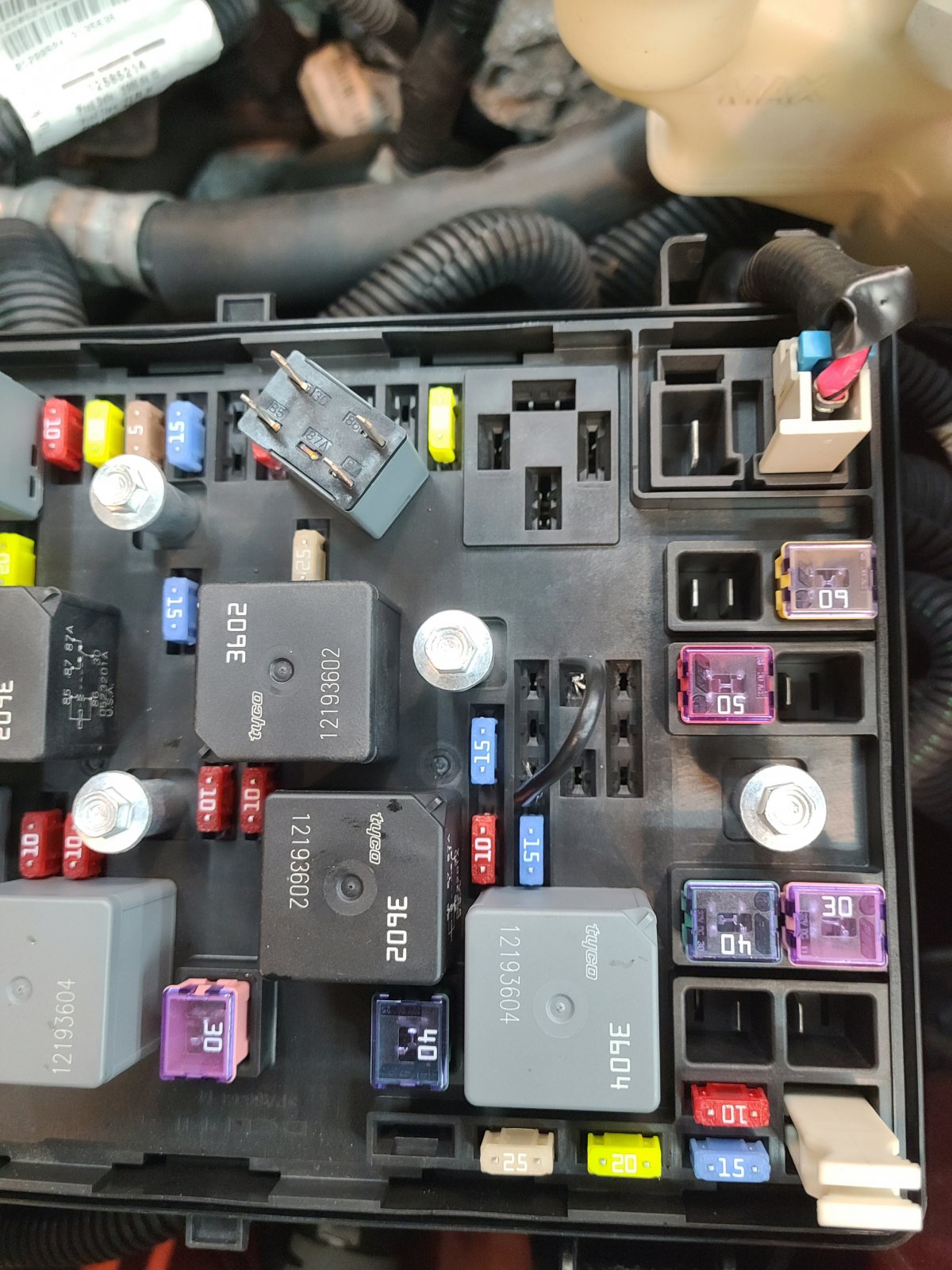

PaulPerger Well-Known Member PaulPerger Well-Known Member Jun 17, 2023 #1 I can't seem to jump the fuel pump and empty the fuel tank... am I doing something wrong? Attachments 20230617_134556.jpg 301.7 KB · Views: 320

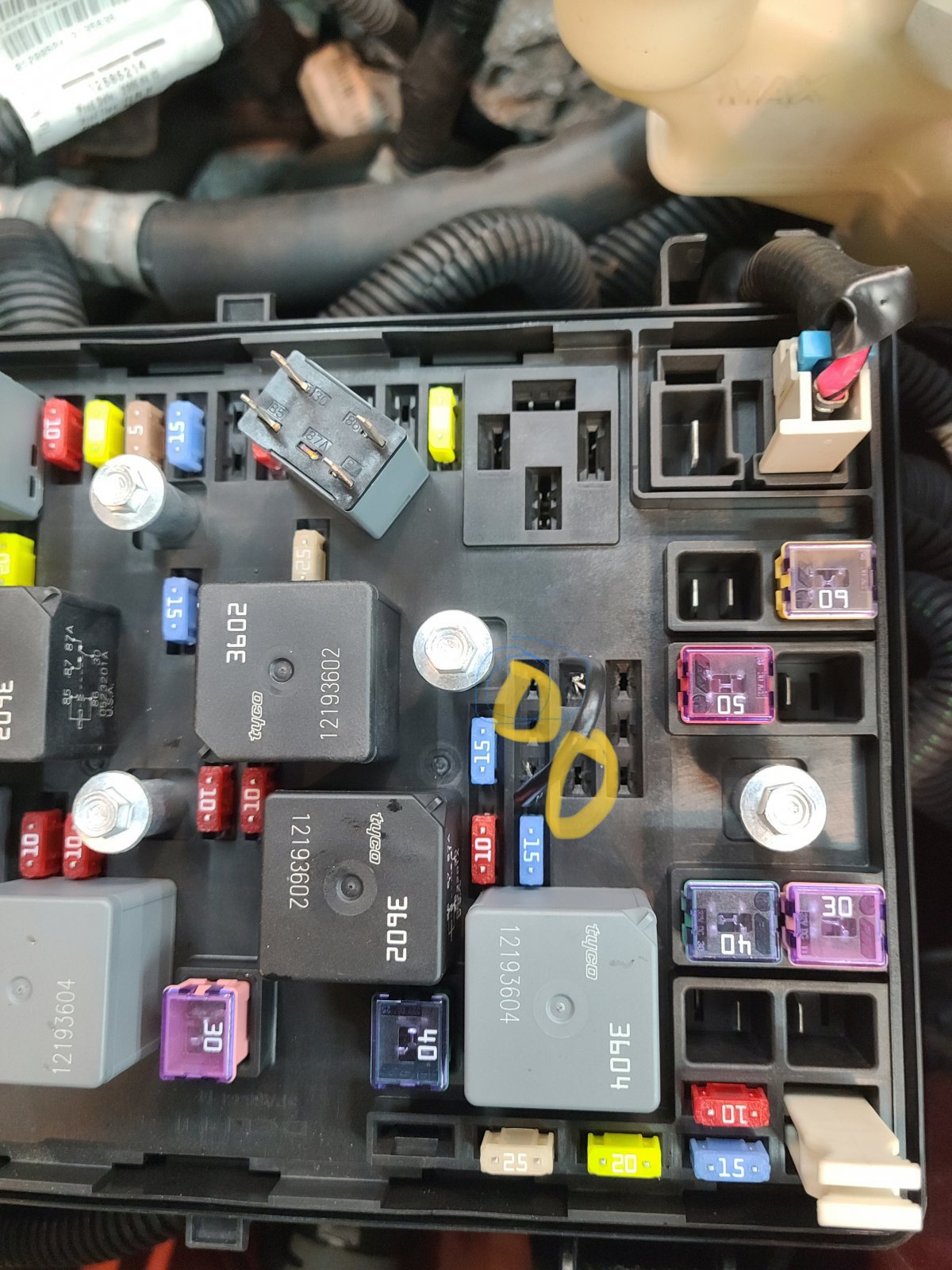

ATMironov Well-Known Member ATMironov Well-Known Member Jun 17, 2023 #2 I think it’s the other two terminals, You want to jump pin 30 to 87 Last edited: Jun 17, 2023
G Gtstorey Goblin Guru G Gtstorey Goblin Guru Jun 17, 2023 #3 If you do this wrong you can burn up the traces on the circuit board inside the fuse box. I would make up a fused jumper with a 15amp or smaller fuse.
