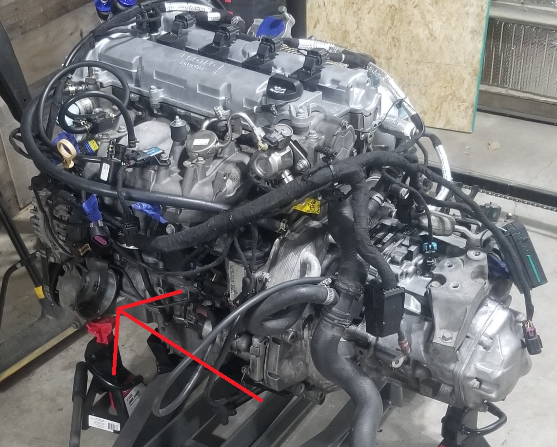

turbo engines (LNF) cannot remove the a/c condenser or the belt will hit on other things, but I was able to gut my compressor so its basically just a pulley now.
I was able to pull the a/c condenser off my LNF engine fully, just replacing the belt with a shorter one. Perhaps there's something non-stock about your engine.
Hmm, did you mean removal on the LSJ? Because the AC can be removed and a shorter belt can be installed with no issues. I have done this on my LNF and there is no interference or contact with anything else on the front of the engine.
