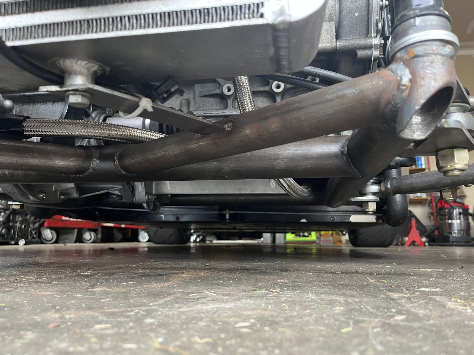

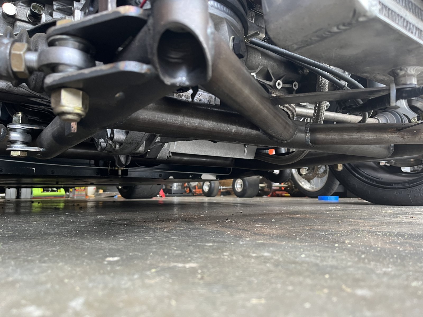

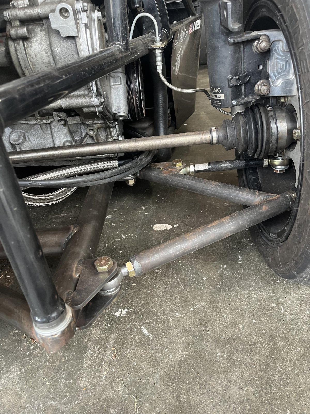

Basically what sasquatch said..Couple of questions about the rear sway bar... I am currently not running any sway bars - front or rear. I would have figured the use of the sway bar would have upset the suspension balance with the Goblin being so light - especially without a sway bar on the front.
Please educate...
1. Have you run without a sway bar?
2. Could you tell us why you chose to use the SS sway bar in the rear and the advantages of using it?
3. Have you tried the smaller non-SS sway bar?
4. Do you have plans for a front sway bar in the future?
I appreciate your input and real world experience...!!! Thanks!
the stock 400 front 300 rear is fine for the average street goblin and some autocross. Once you start going to big tracks and taking turns at higher speeds, the car looses the front end and pushes heavily. You can even tell it pushes on mountain roads as well. A front sway bar would just amplify the push even more. So i would never even consider a front sway bar. you can play with the sway bar size depending on your spring setup. lots of varying factors with setup balance
