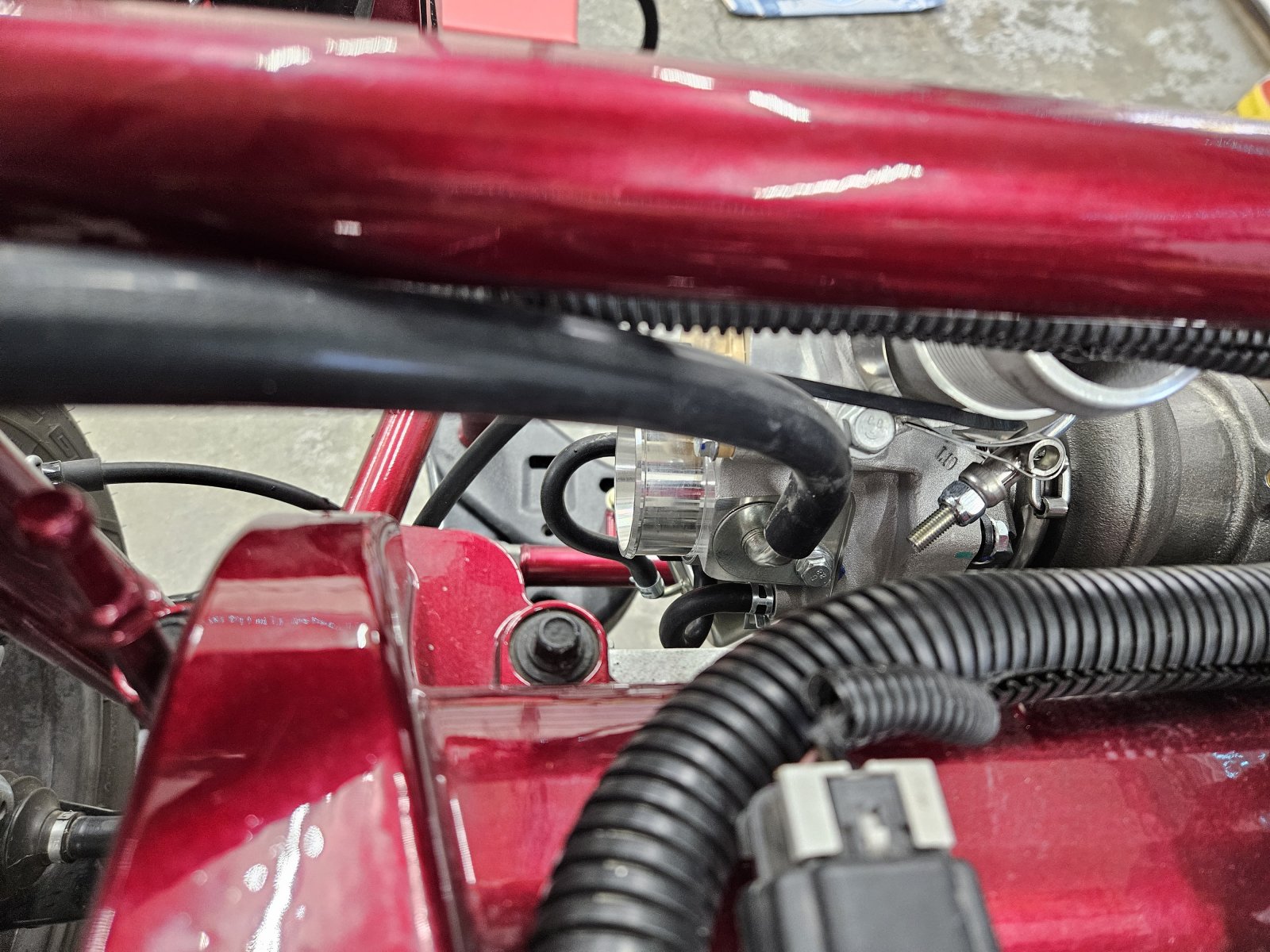

So since I can't control boost with my ecm im replacing it with a manual boost controller from ZZP. Yes I have forged internals on the 2.2 and id like around 15psi of boost.
Would I remove the waste gate actuator control solenoid then cap off the boost reference vacuum line and atmosphere line.
Then connect the manual boost controller to the intake vacuum/boost barbed fitting on one end then connect right to the wastegate actuator barb?

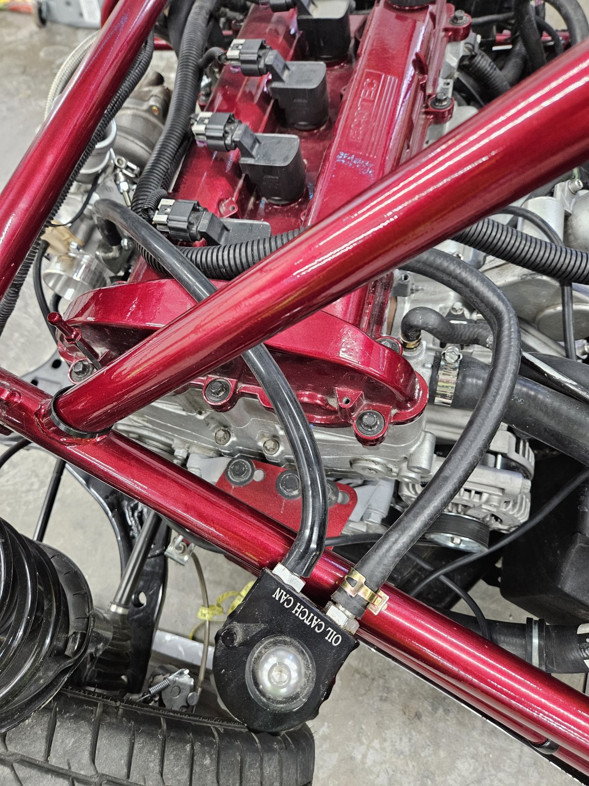

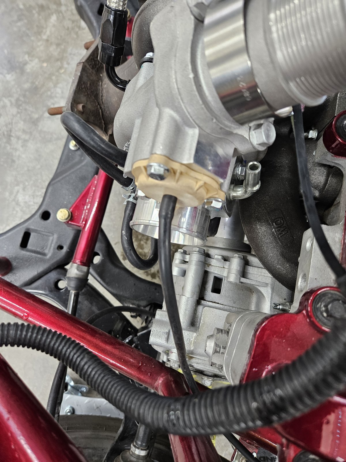

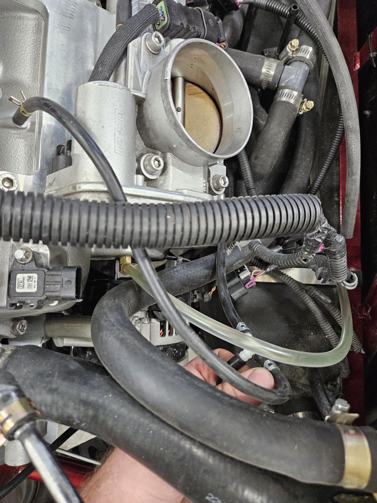

On the second/third pic the T piece connects to the top intake barb then goes to my boost gauge and the boost bypass valve on the turbo.
On the last pics the vacuum barb off the turbo goes to an oil catch can then to the valve cover.
Thoughts suggestions? Does this all seem correct?
