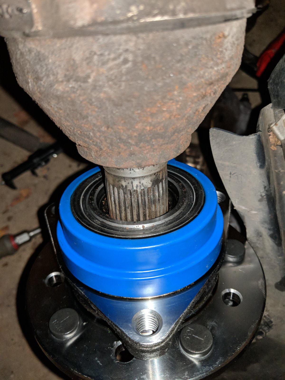

I wanted to go 15 front and 17 rear but it looks like I will be going 16 front and 17 rear most likely. If I can figure out the hub conversion I will be going with these

I will probably be picking up some grand am hubs to try next week.
Technically they are 5x115 but they supposedly work for 5x114.3
I actually spoke with my local discount tire and they were very helpful. Pricing is pretty reasonable as well.
The TC axles have a different diameter and spline count on the hub side. Not sure a Grand Am hub will work. If I had to do it all over I'd go with SS/SC axles instead. Much easier to get to the more common patterns.
KJP
The grand am hub does work with the axle only issue is technically they are 5x115. There is debate on the internet about running 5x114.3 on here being ok or you dying instantly as soon as the wheel is mounted.
I am going to continue to do some more research.

Well I ended up buying 10 hub assemblies to try in 5x114.3 and not one will work. I will be using the grand am hubs I just need to take a little material off of the knuckle and they will fit.
I will pick up wobble nuts and hubcebtric rings just to make sure everything balances as it should.
I tested the hub on some wheels I have off a Supra and they fit just like a 5x114.3 hub would so this is the option I am going to go with.

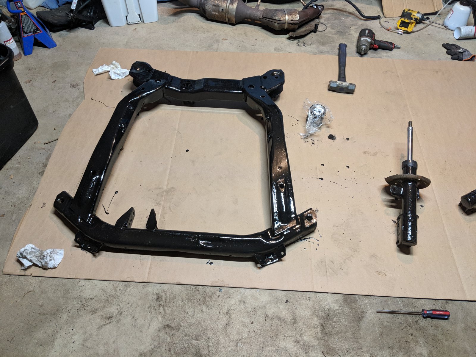

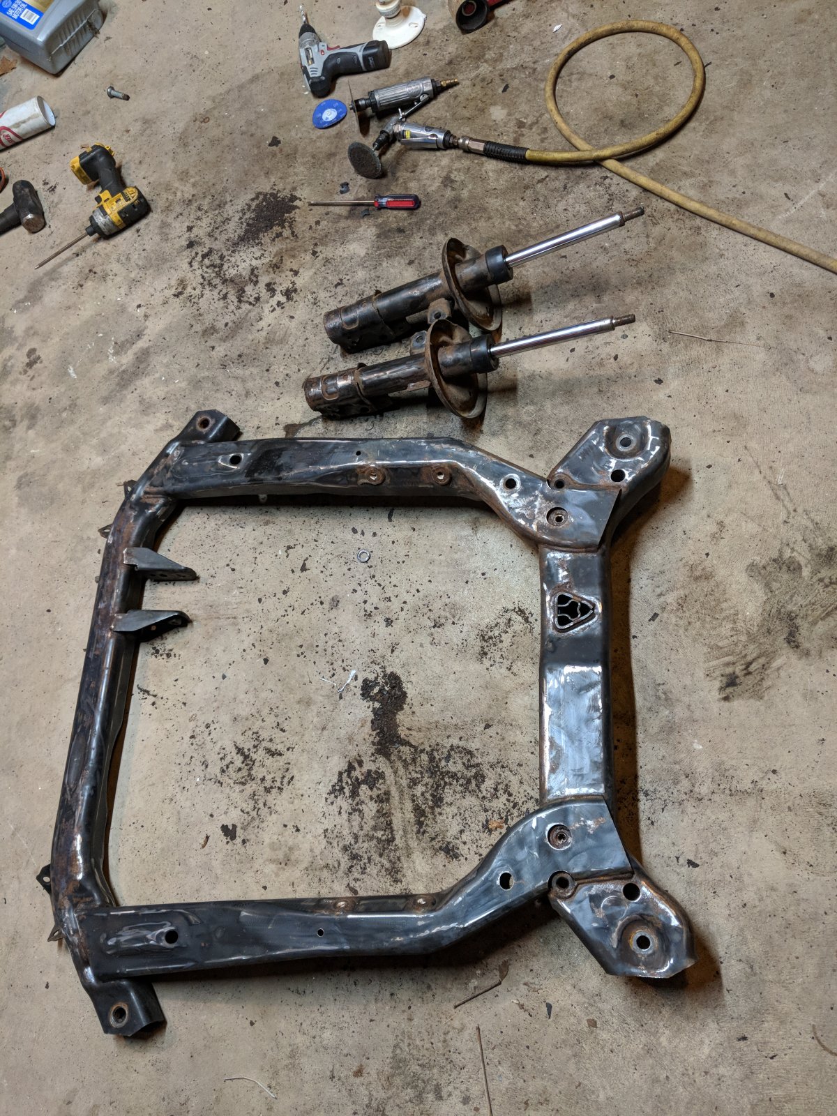

Decided to use this warm weather to get some work done.
I power washed my subframe and then sanded down the rust spots and roughed the paint.
I then put down the first coat of paint. It will be satin black but I used some gloss I had from another project on the first layer.

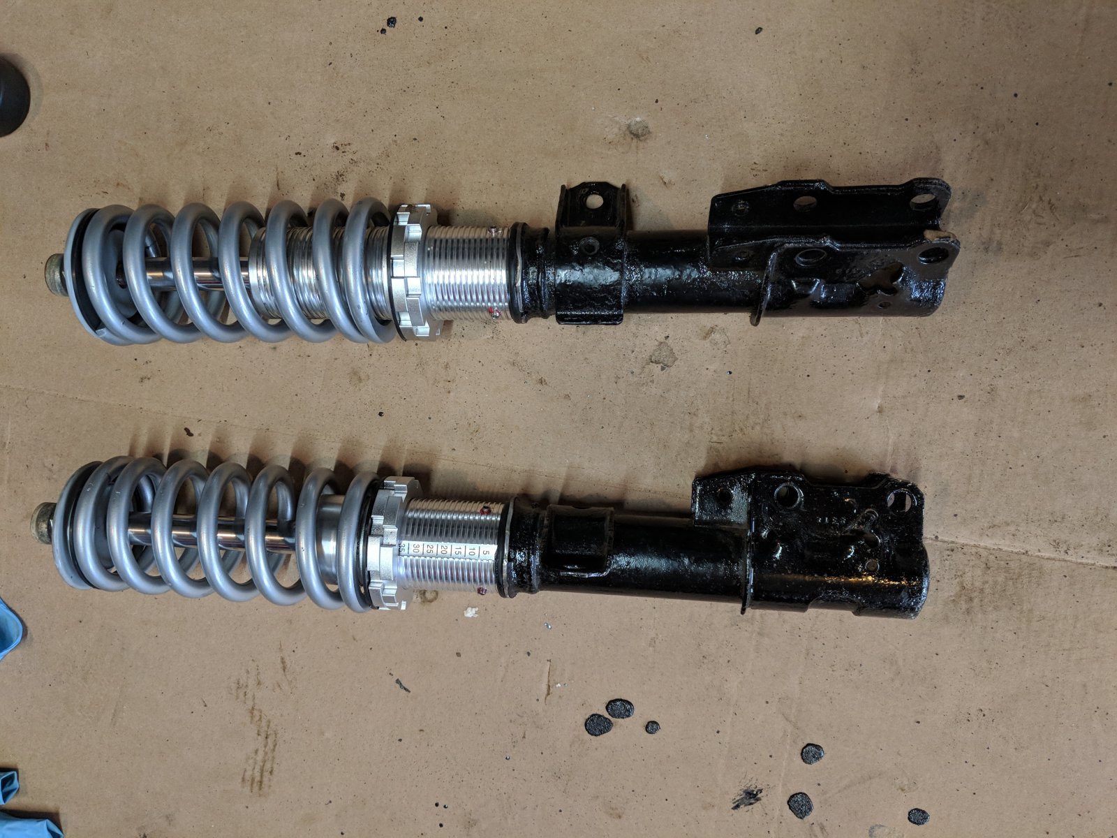

I built some coilovers with the OE struts and eBay Civic coil kits over the weekend.
I need to touch up the paint but they came out looking pretty good. The tops are plastic which I don't like so I may have to figure out what else I can do there.
Total cost of about $40

Considering all the weight and stress on the spring caps in this application, you might want to look into something like these
https://technotoytuning.com/universal/parts/conical-upper-hats-coilovers-25-id-springs-22mm-center
Looks like QA1 sells them also but they don’t list the dimensions
Are the spring rates identified on the eBay springs?
I didn't see the hats from QA1 online except for in the kit. I don't trust the plastic so I plan on getting new ones.
I emailed the seller about spring rates but my optimism on getting good information back or any at all is pretty low.
Also the kits I got are all identical for for the 40 bucks you can actually do two goblins.

FWIW I've heard the spring rates are pretty high on the ebay springs, like in the 450lb/in range.
The QA1 caps have a slot to slide the strut shaft through, and wouldn't be ideal for the goblin anyway.
Looks like some of the ebay coilovers (and there are thousands of types) come with aluminum spring caps
https://www.ebay.com/itm/FOR-88-00-...997538?hash=item58eb9c17e2:g:wB0AAOSwL81aPgUU
maybe one of the other guys doing this could order a set and send you the extra pair?

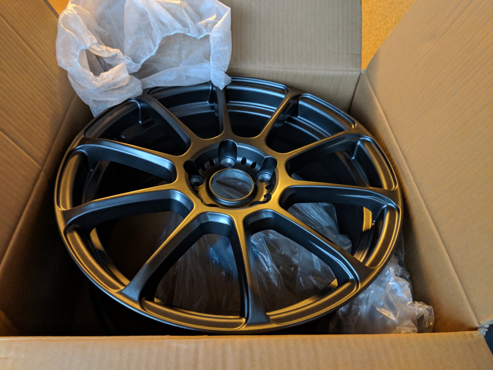

My wheels arrived and I love the color on them.
I plan on doing my frame a very similar color.
I ended up going 16 in the front and 17 in the rear in 5x114.3
I have probably owned 10 sets of aftermarket wheels and this is the first set I have ever purchased new.

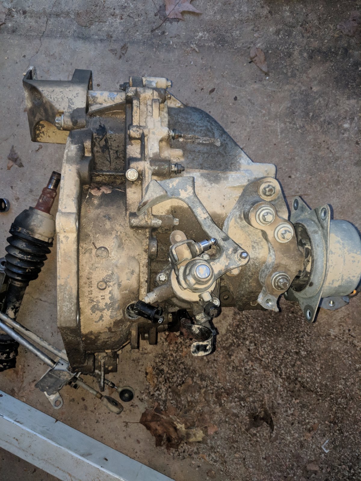

On an impulse I sold my non LSD F35 and put a deposit on a new trans I will be picking up next weekend after it is pulled from the car.

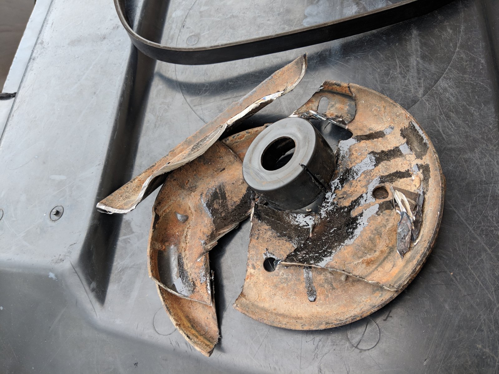

Because everything seemed too straight forward and like it would go together too well I had to add a little complication and here it is.
It needs a powewashing horribly but it's 31 and rainy so that's not happening till it warms up
