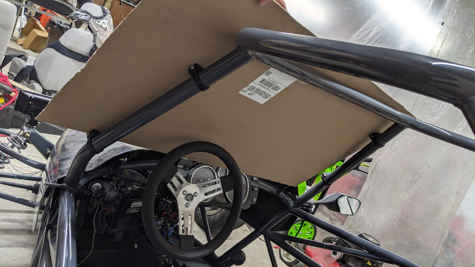

Forgive me if someone else has tried something like this and I didn't see it. Looking for feedback on this idea.
I had an experienced glass technician come out to see my car. I have a track frame.
His suggestion was for me to come up with a frame for a windshield using 1/8" sheet metal. He suggested this material to keep the frame one piece and because the standard rubber seal for windshields is made for an 1/8" edge. He also recommended that I leave the sides of the frame about 2" wide.
I'm working on a pattern for the frame using cardboard. I will shape the outside to fit into the car. Then I will cut out the inside for a custom-cut piece of laminated glass. The frame will mount to the roll cage via the clamps in the pictures. The offset away from the cage provided by the clamps gives needed clearance between the top of the steering wheel and inside of the windshield. It also looks like it would make the windshield frame land nicely at the edge of the hood, where I could use some rubber edge trim to try to get a finished look. I may try to make the frame only an inch wide on the bottom to preserve visibility, using the pre-existing holes in the hood to attach some brackets to the frame for added rigidity.
After the pattern is made, I will trace it to a large piece of paper that I can feed into a plotter. I will then turn the full-scale tracing into a drawing file that I can clean up. The cleaned-up file will be printed on the plotter to test fit the refined pattern to the car. Once I'm happy with that, I can take the drawing and my sheet metal to a shop with a CNC plasma cutter to have the shape cut nicely.
I am not planning on the windshield going all the way to the top of the cage, only enough to feel protected and pass MI inspection. I could add a support from the center of the top of the roll cage to the top of my frame for more rigidity if needed.
Thoughts?
-Michael

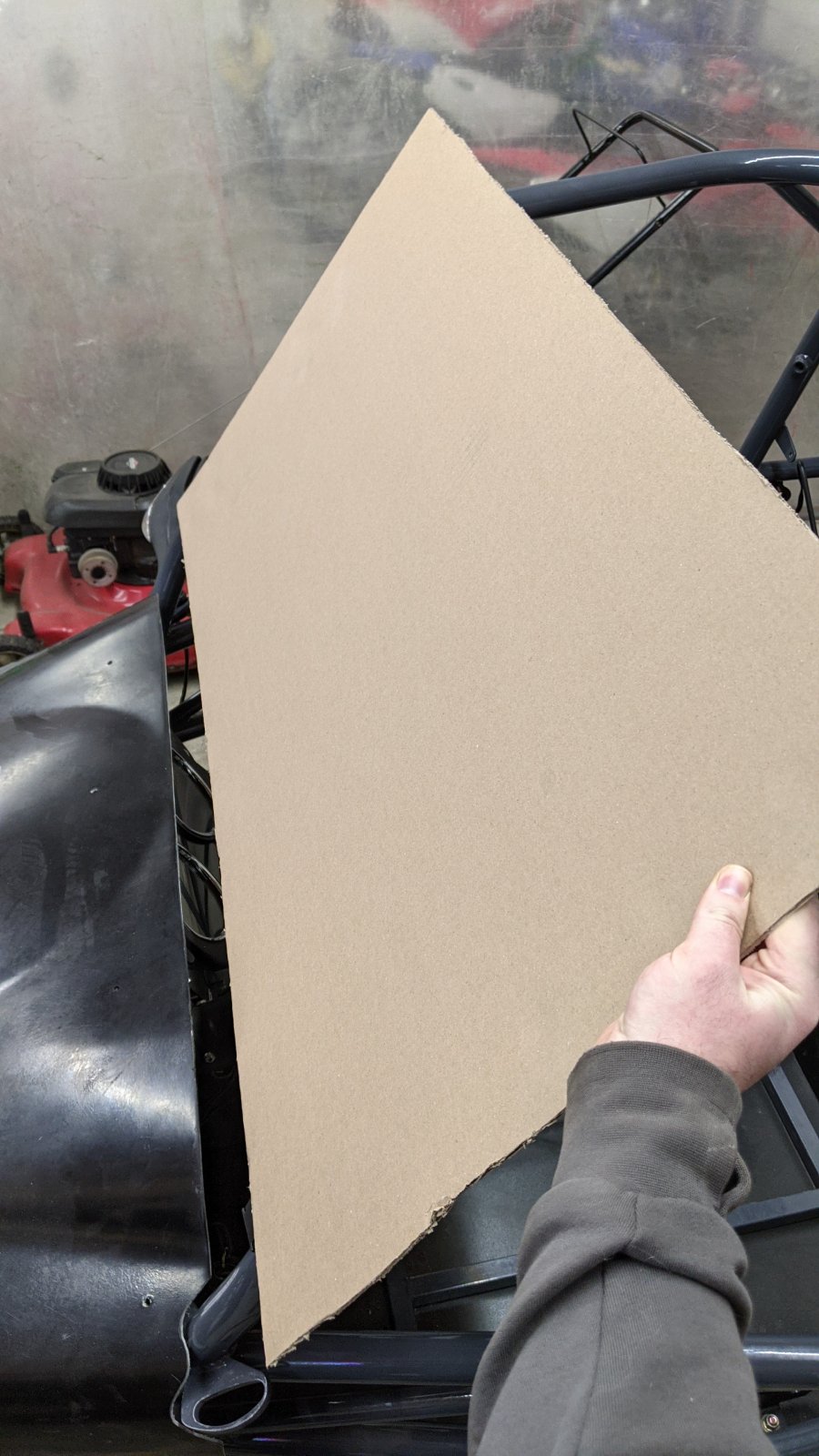

An added thought; I could back up the four sides with a secondary frame made from flat stock or angle iron. May allow the frame to be thinner.
Edit: Just realized how much my pictures suck. The cardboard sags quite a bit. If supported to stay seemingly-straight while flat against the tube clamps, the edge of the cardboard does seem to land on the slight contour in the middle of the hood at the edge.

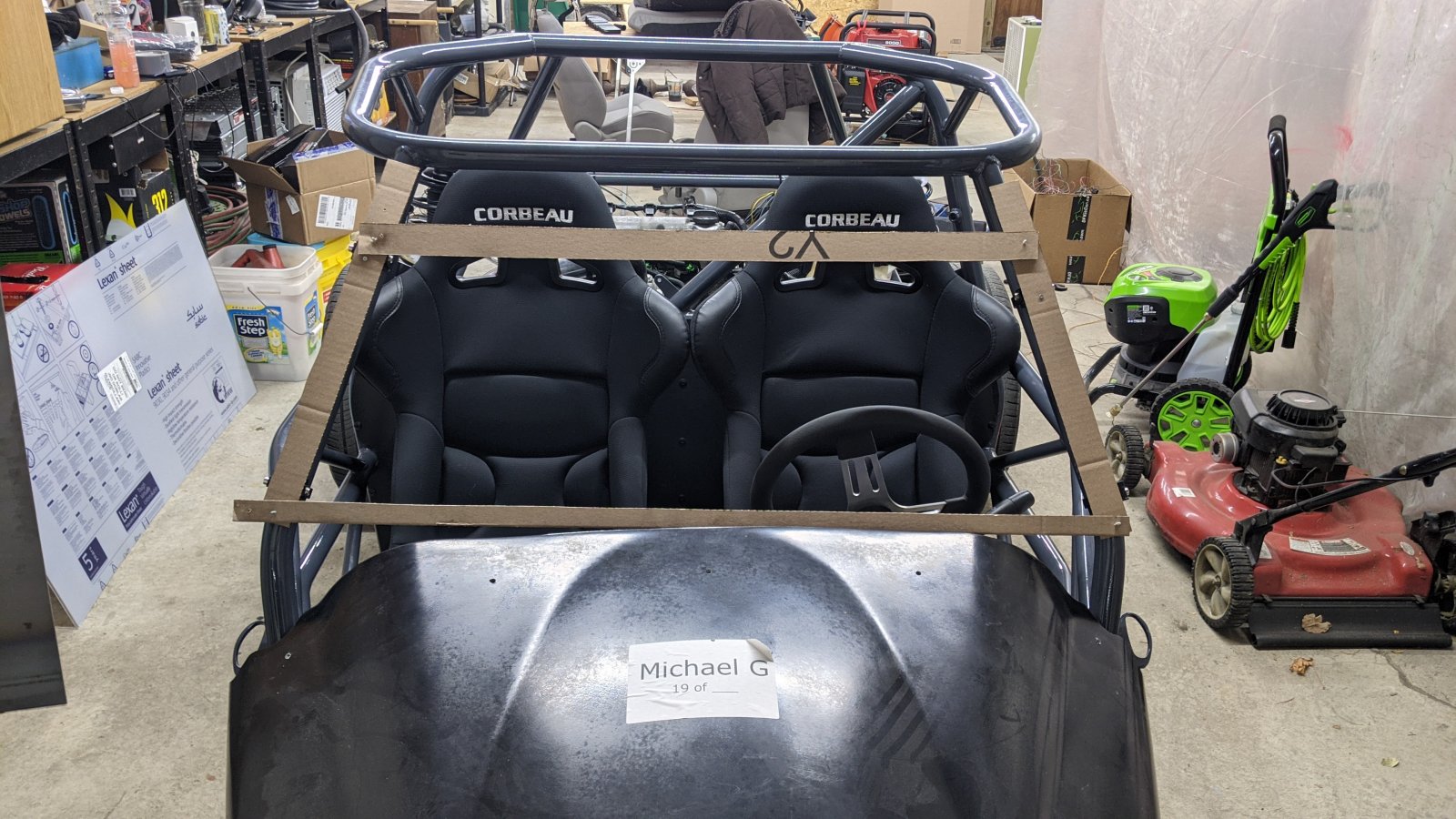

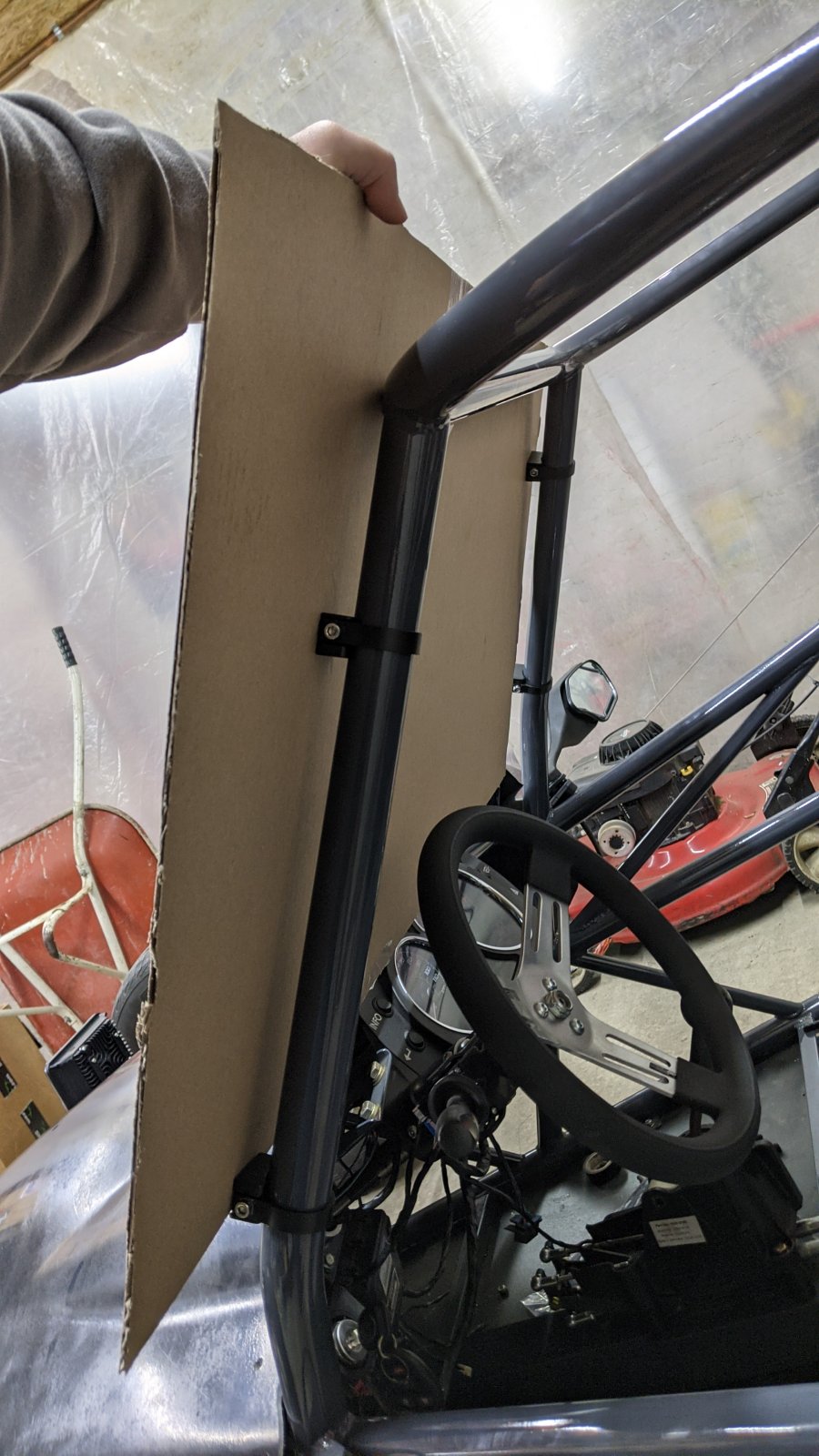

Small update. Feel free to laugh at my cardboard prototype. It definitely isn't cut exactly straight or squared up. Should get the idea across though.

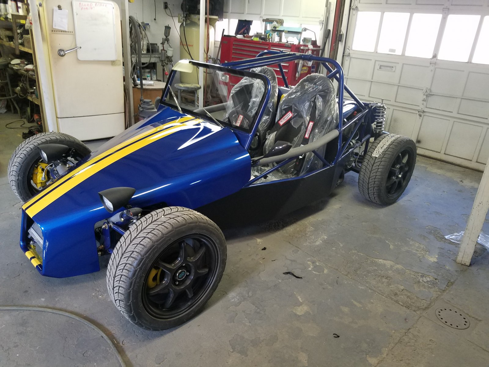

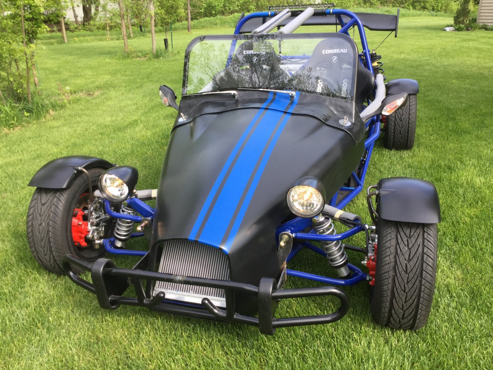

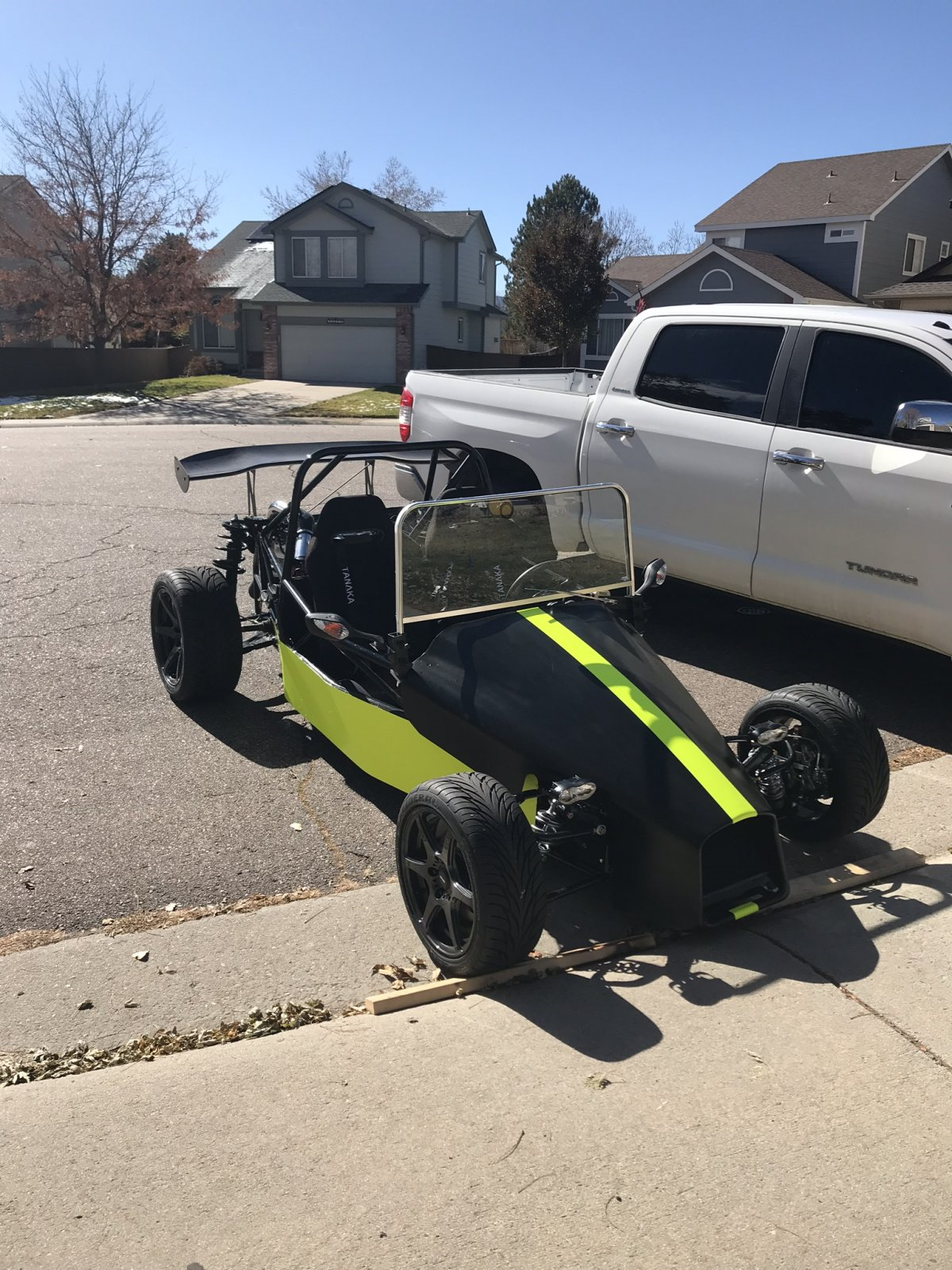

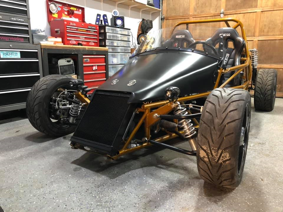

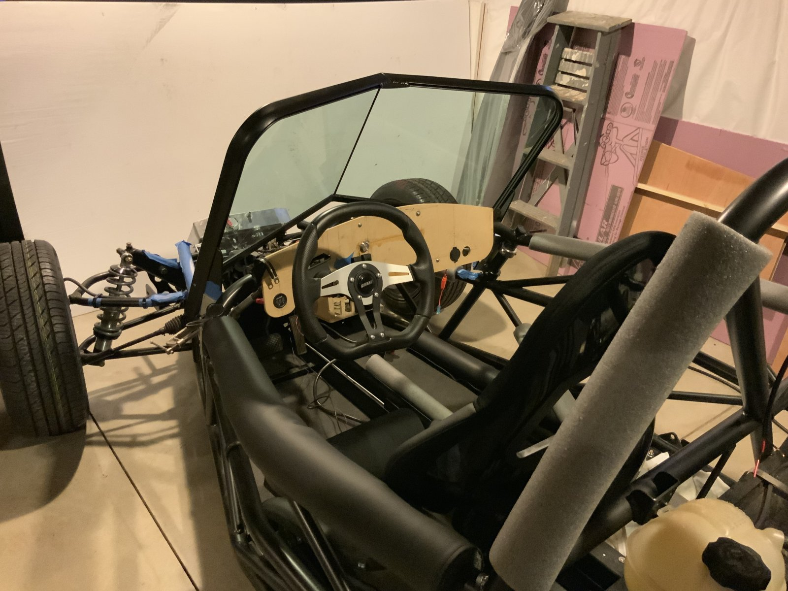

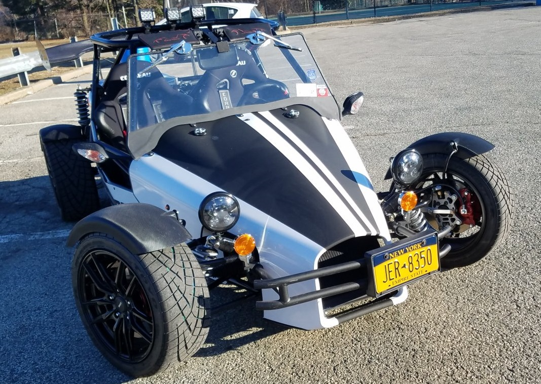

Those are all glass options, but here is a curved polycarbonate option on Alex Eddington's car.

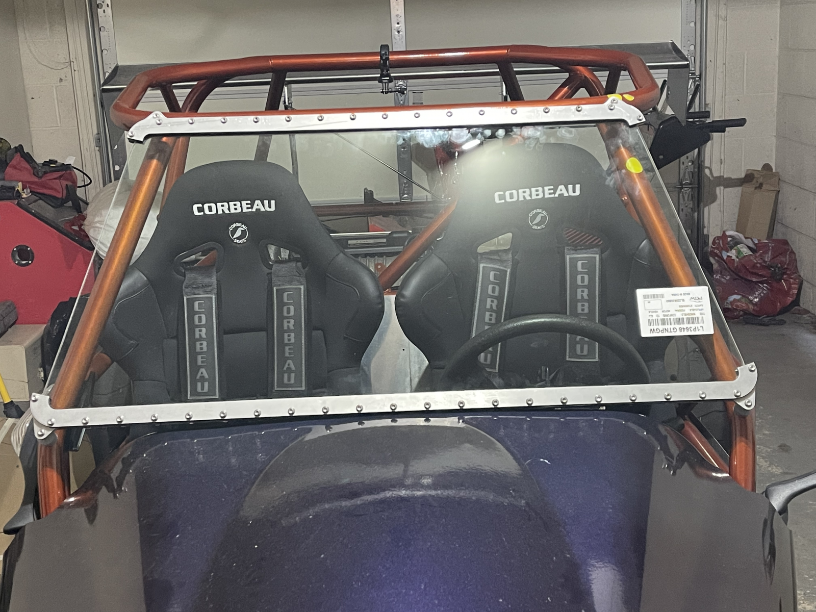

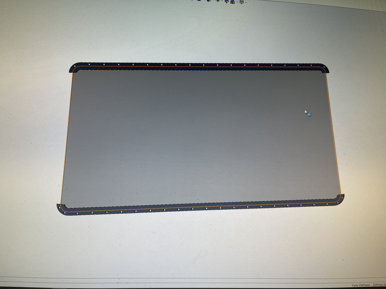

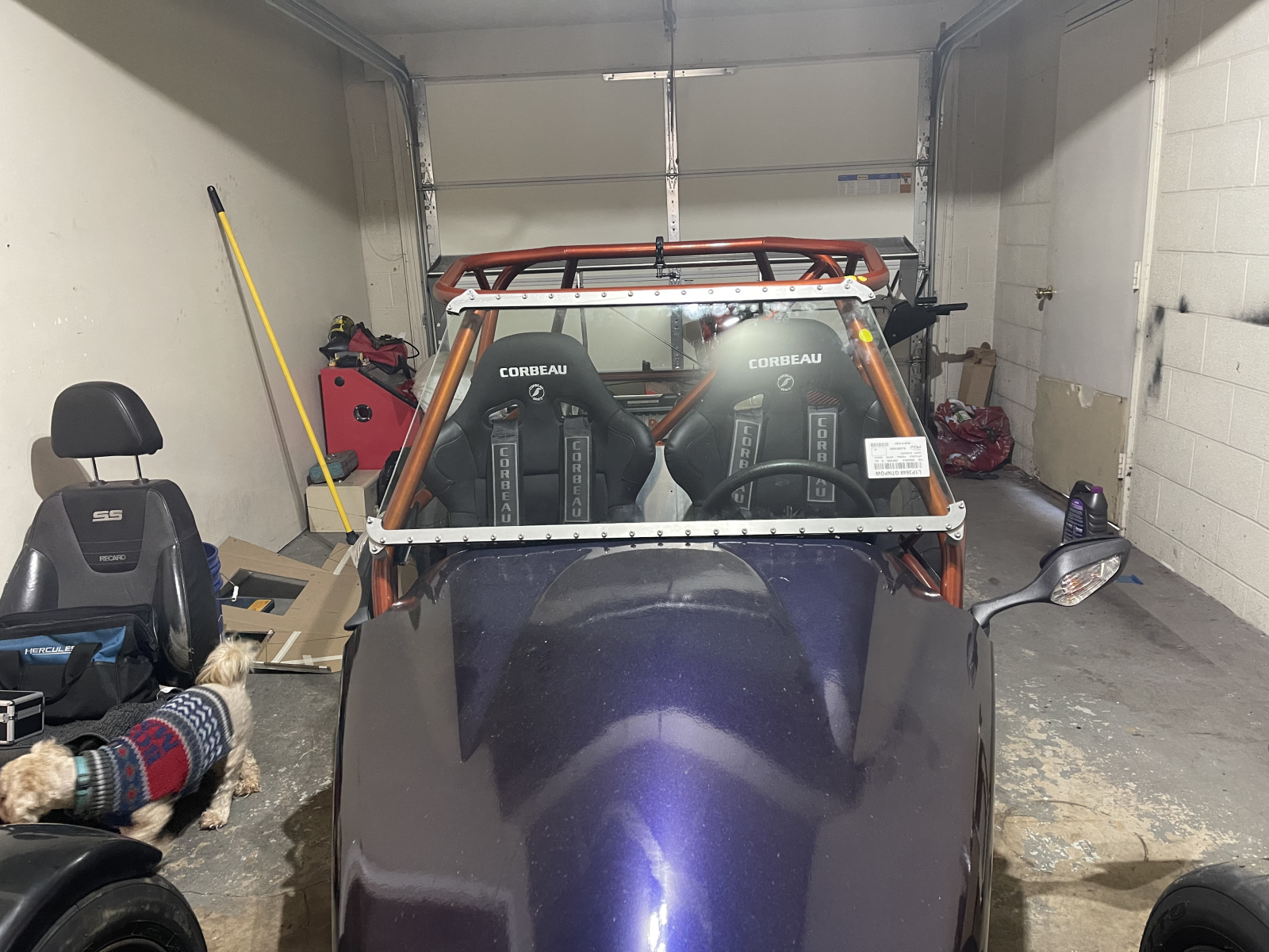

Wanted to pop in this thread with an as1 windshield design I designed and put together. I was not a huge fan of other designs that seemed bulky on the left and right edges so I went with a top and bottom clamp design using laser cut sheet metal parts. I believe the final cost of gals cutting, laser cutting, and rubber sheeting is around $350
