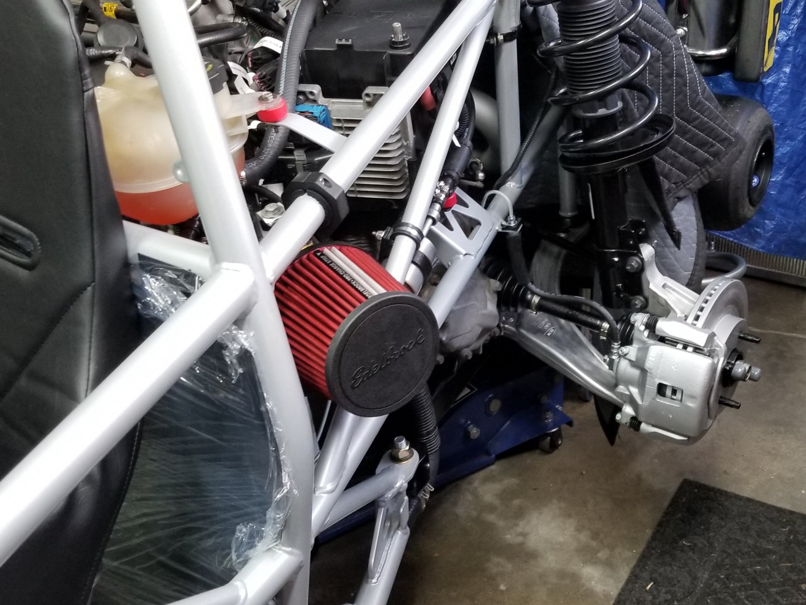

k.rollin
Not a big update, but I did mock up the front brakes and mount the wheels. I remember reading about someone who was running 15" wheels and had to shave their calipers to clear the barrel ID, so I wanted to check before painting the calipers. I've got less than a finger's width of clearance.

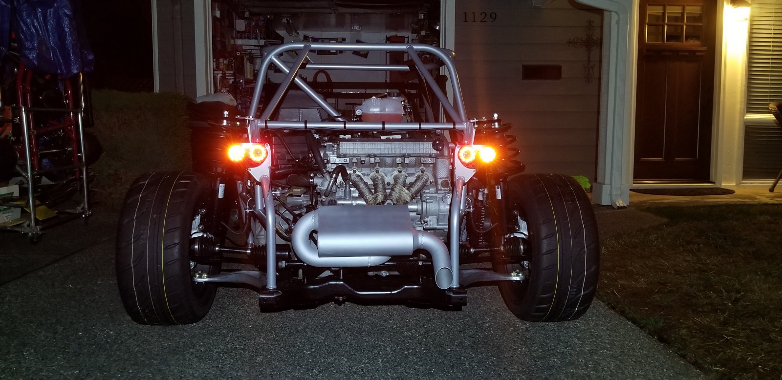

k.rollin
Another day of really minor progress. Started by reassembling the engine hoist so I can pull the oil pan to remove the bit of dipstick funnel that broke off while preparing the engine for paint several months ago. Also bought longer bolts for attaching the steering arms to the uprights, a replacement screw for the brake position switch (no more zip ties), and a M10-1.25 tap for retapping the headlight bungs.
Unfortunately, running around town ate most of the daylight hours I planned to work today, so the only changes have been installation of the brake fluid reservoir and headlights.
