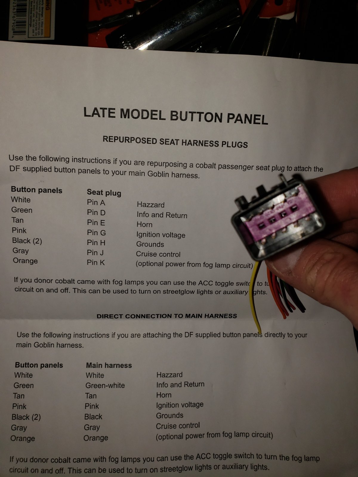

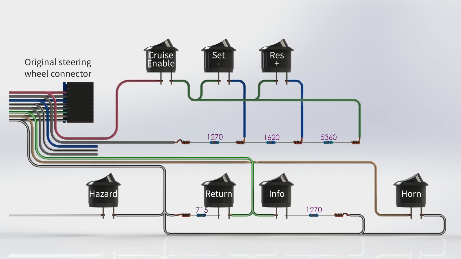

Note to self: when doing wiring on the Goblin, it is best to use the correct wiring diagram. For me, that would be the one Desert Sasqwatch posted above, and not the one Lonny posted at the start of this thread... For any "LATE MODEL" builders on the forum who have not yet reached the point of wiring the button panel, I have a DFKC resistor pack I don't need. Free to the first one to DM me with their mailing address.
