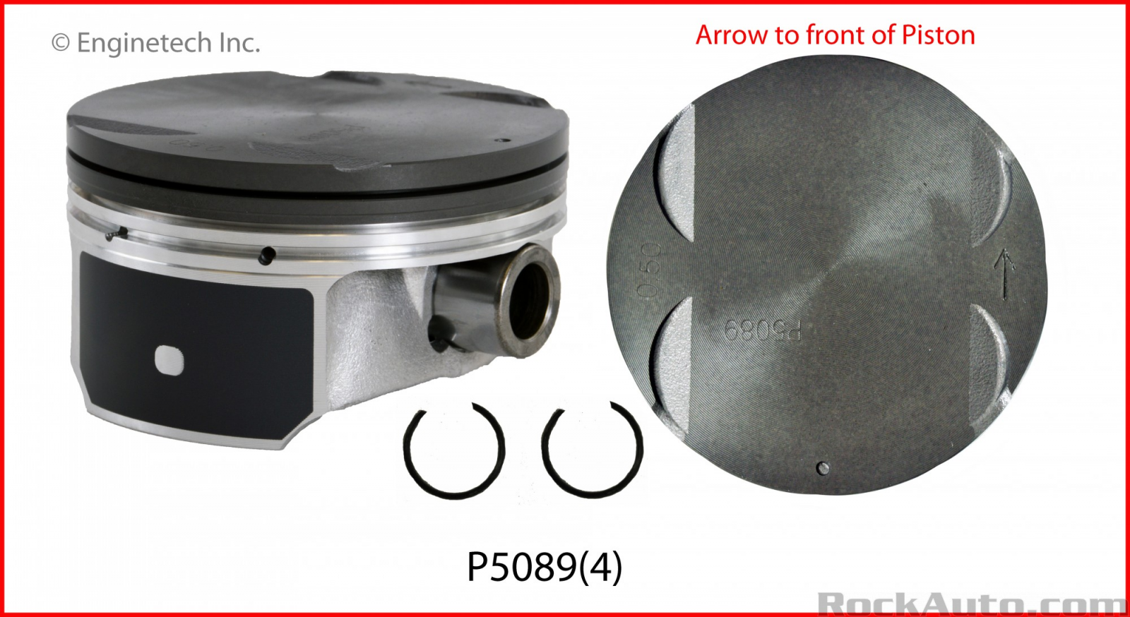

You also need to look at the valve relief pocket on the piston.
It might be as simple as that. Looking at ZZPs pictures, the LE5s have reliefs, but the LAP are just flat top.

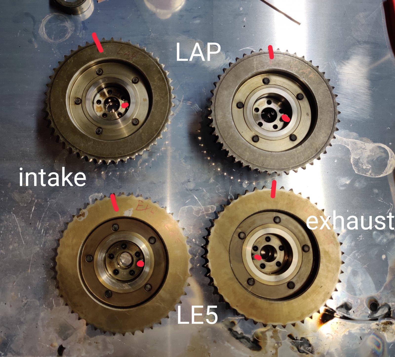

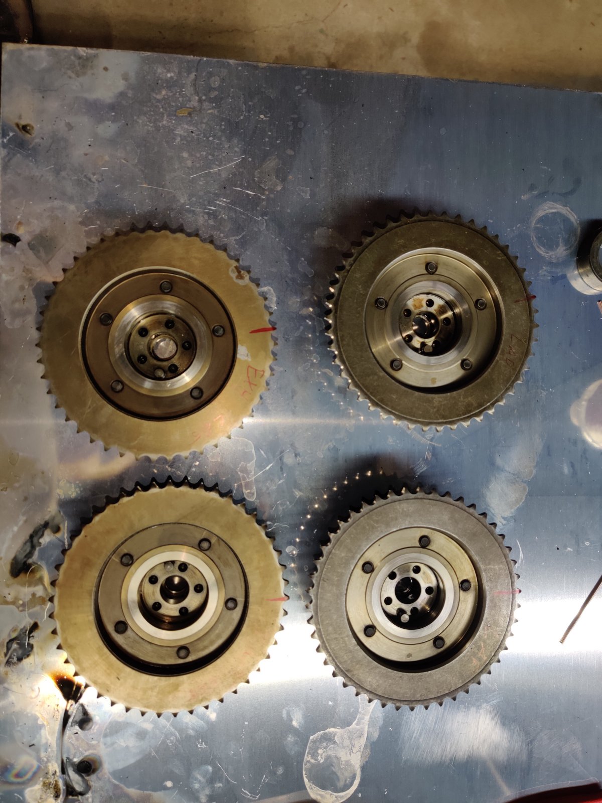

Okay so I am running this exact setup, I have the LE5 ZZP cams in my 2010 LAP 2.2, first off, the head itself is identical but you will need to get the cam phasers aka gears from a LE5 as the dowels are in different locations IF YOU TRY TO USE THE LAP GEARS YOU WILL DESTROY EVERYTHING. I have attached a photo showing both gears and the dowel locations. Any other questions just ask.
Looking at part numbers again, the intake cam phaser on the LE5 seems to be a different part number (according to RockAuto anyway) but the exhaust is the same. Your picture makes it look like they are both different. Thoughts?

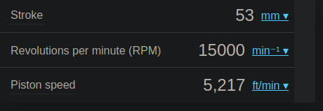

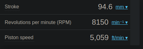

That redline is awesome haha. Your piston speeds are very high! My math says that's aproaching current F1 cars!

Honestly I never even pulled the head, I fed about five feet of climbing rope into each cylinder individually and rotated the engine to hold the valves up while changing the springs, it doesn't make any strange noises so I assume PTV is okayish maybe, I would strongly recommend not turning it as hard as I am if you expect it to survive for a reasonable period, the exhaust is identical I believe the gear material had changed between 2006 and 2010 based on the gears pictured, as far as tuning I copied the LE5 VVT map from what was advertised as a ZZP tune before HP tuners wiped the modified tunes from the repository otherwise it tunes like any other setup

Here's the uncolored on photo, the red line is the index tooth on each gear, the photo is rotated 90° from the labeled version but somewhat more clearly illustrates the difference if you blow it up

Still have concern with the valve relief in the stock LE5 pistons though. Diamond Racing lists the pistons with 0.140" (Intake) and 0.130" (Exhaust) valve pockets. Its obviously working for you @Cnixon160, I'm just scared that I could potentially screw up a fresh forged build if it doesn't work for me for some reason. Not to mention the ZZP LE5 cams are hella expensive.

I think it's possible to cut valve reliefs in most forged pistons. Either by a machine shop prior to (or probably really during) or even after assembly of bottom end (look up piston fly cutter).
jirwin
Interesting! That was much easier than I thought it would be (with the right tool of course). I wouldn't imagine balancing would be an issue with that since in theory you'd be taking the same amount off each piston.
