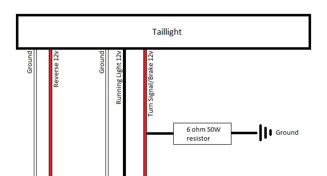

Have to bump this thread to ask a question ... I am planning on installing resistors on my stock DF taillights to eliminate my rapid blinker issue. From Torch's last post in this thread, it sounds like the correct way to do this is to wire a resistor in parallel between the +12v turn signal/brake wire and ground. Something like this (sorry for the terrible Paint skills!):
Just want to confirm!
Torchandregdoc
The wiring is correct, but I can't confirm the resistance until I look at the car tomorrow.
