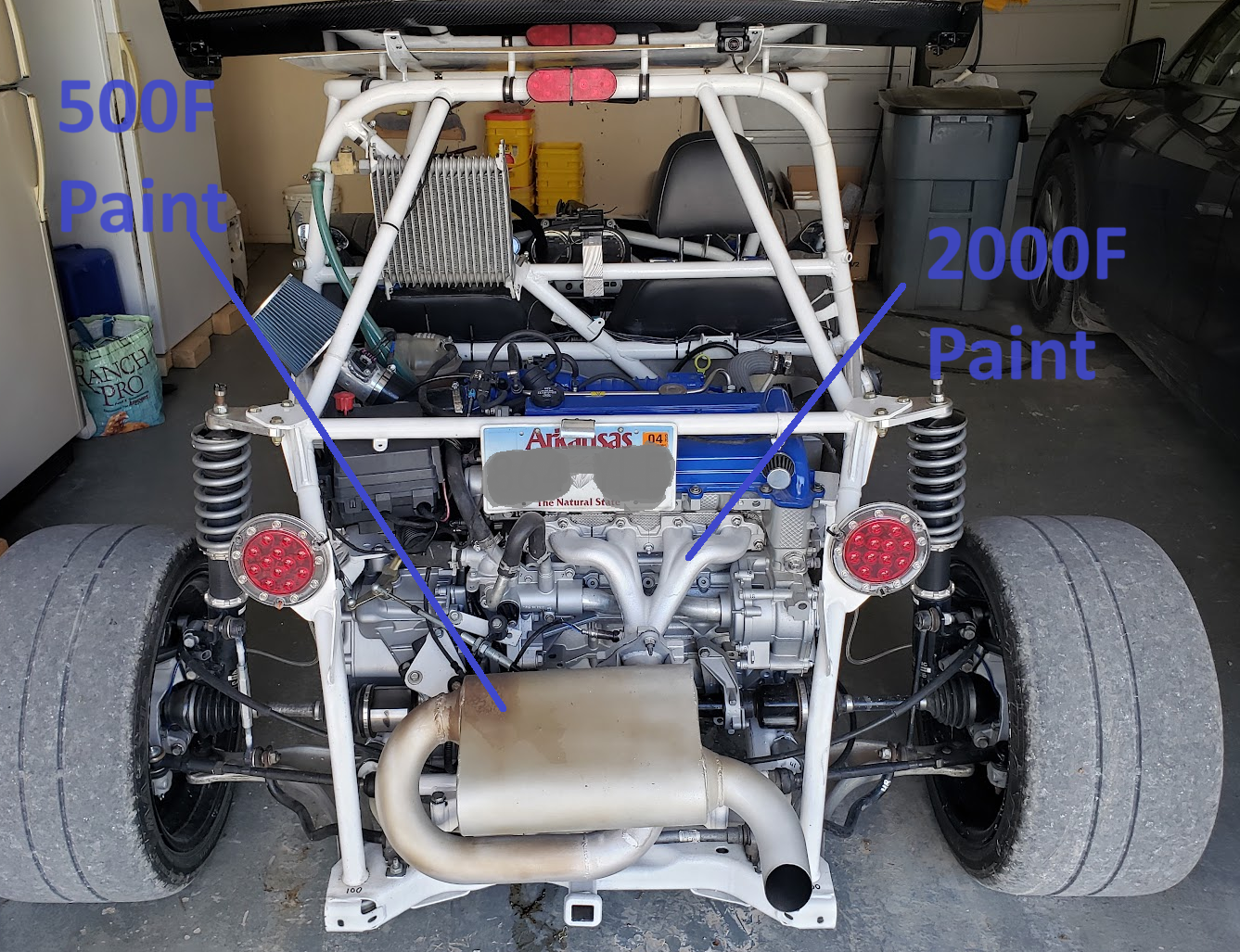

I tried the Rustoleum 500F engine paint on the muffler, as the 2000F VHT stuff keeps flaking off.
We will see if it goes back to silver after a few more heat cycles... otherwise it is back to the flakey stuff.
