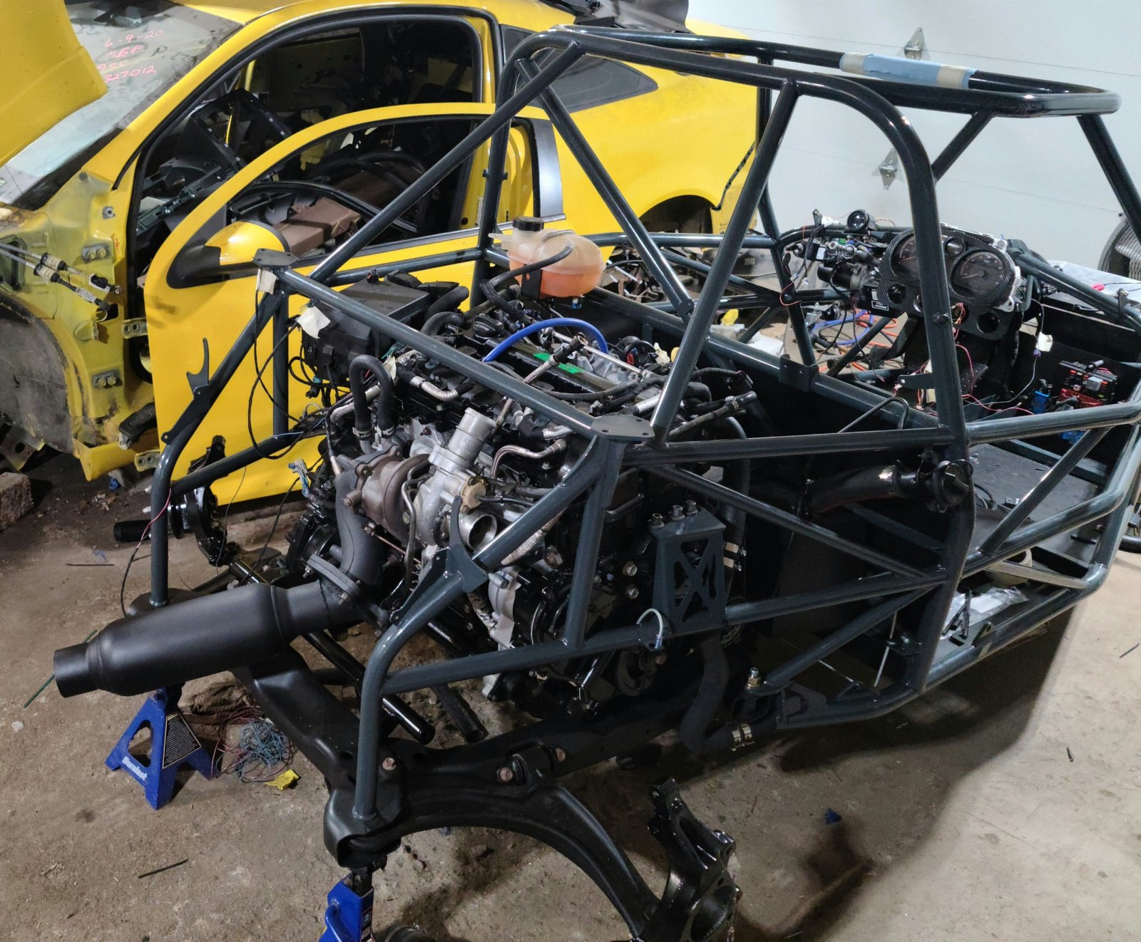

I cut mine off the donor flex pipe. Then stuck some random bits and pieces I had laying around the garage to it with the adult glue gun. I'm not the best welder so we'll see if the new exhaust set up holds up. It feels solid and I like the look better than the square muffler on the back of the Goblin.
