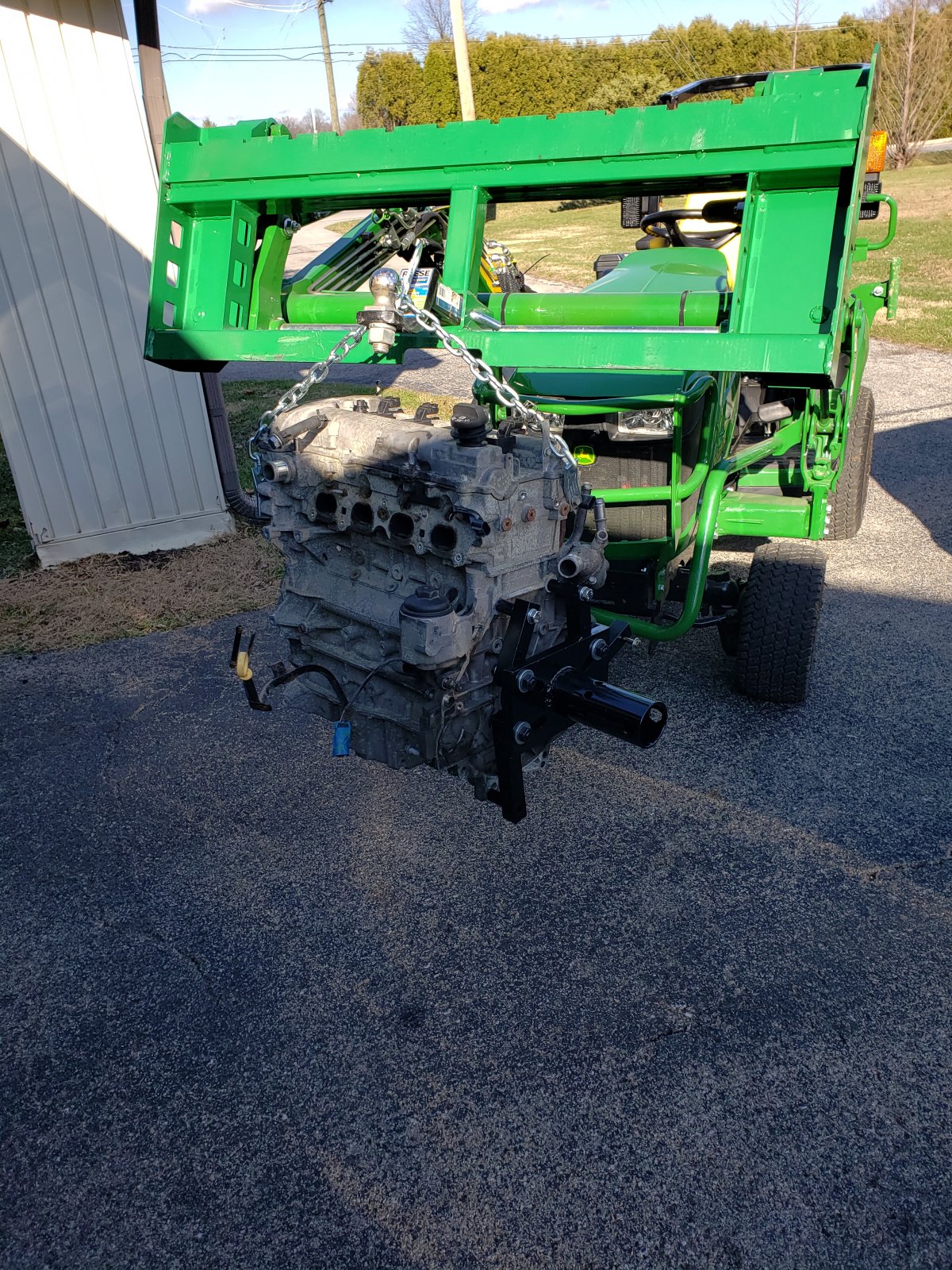

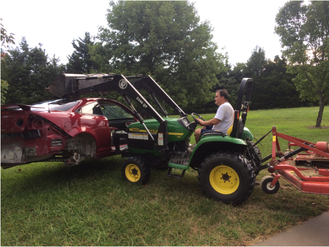

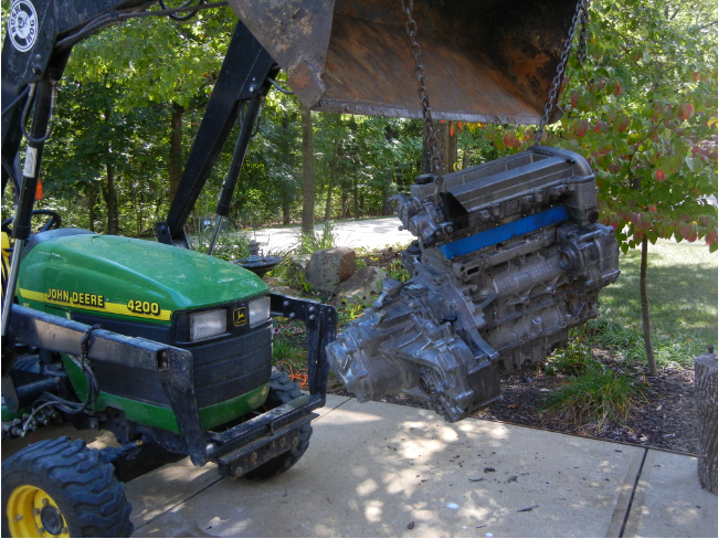

Who says you need an engine hoist?? :) put the jd to use

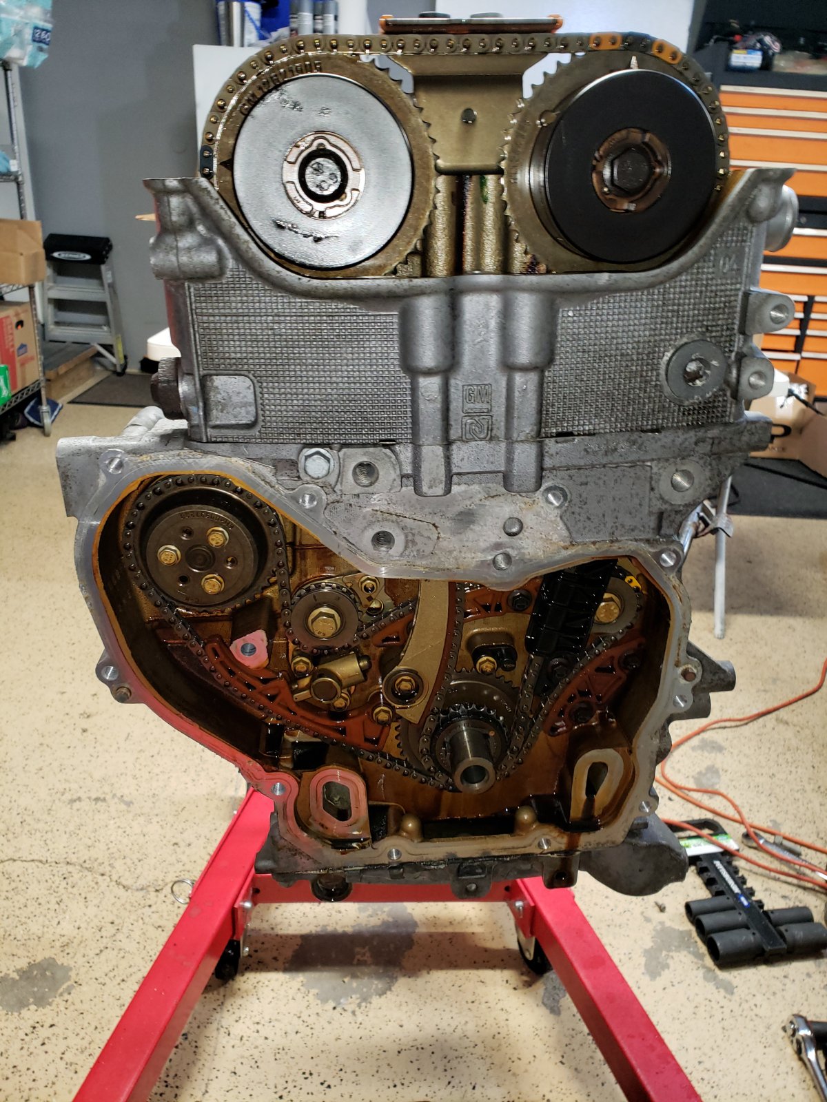

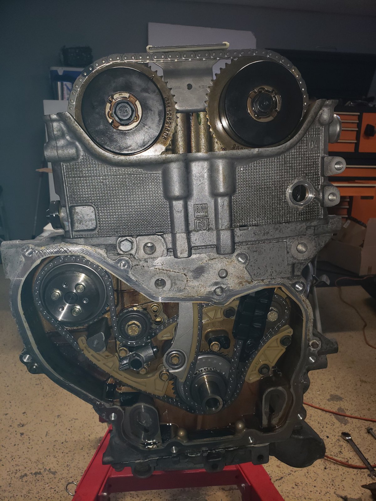

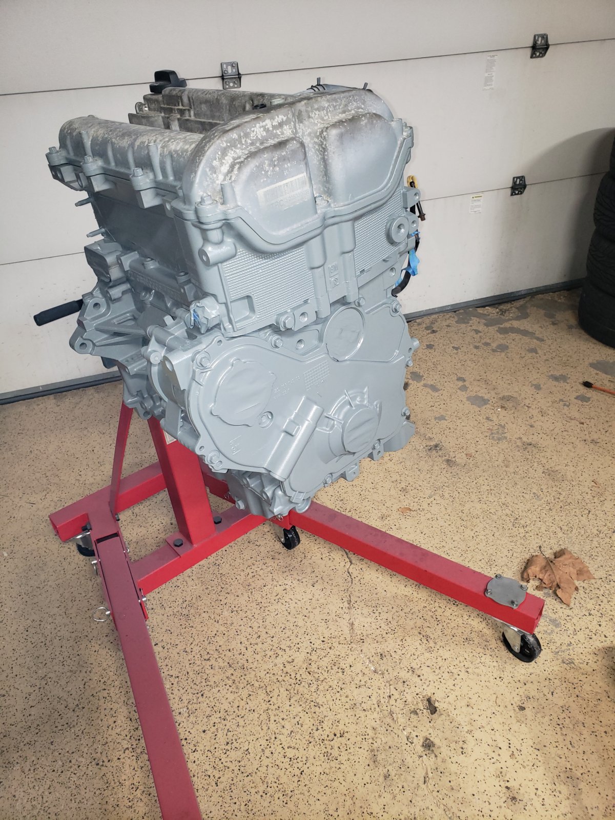

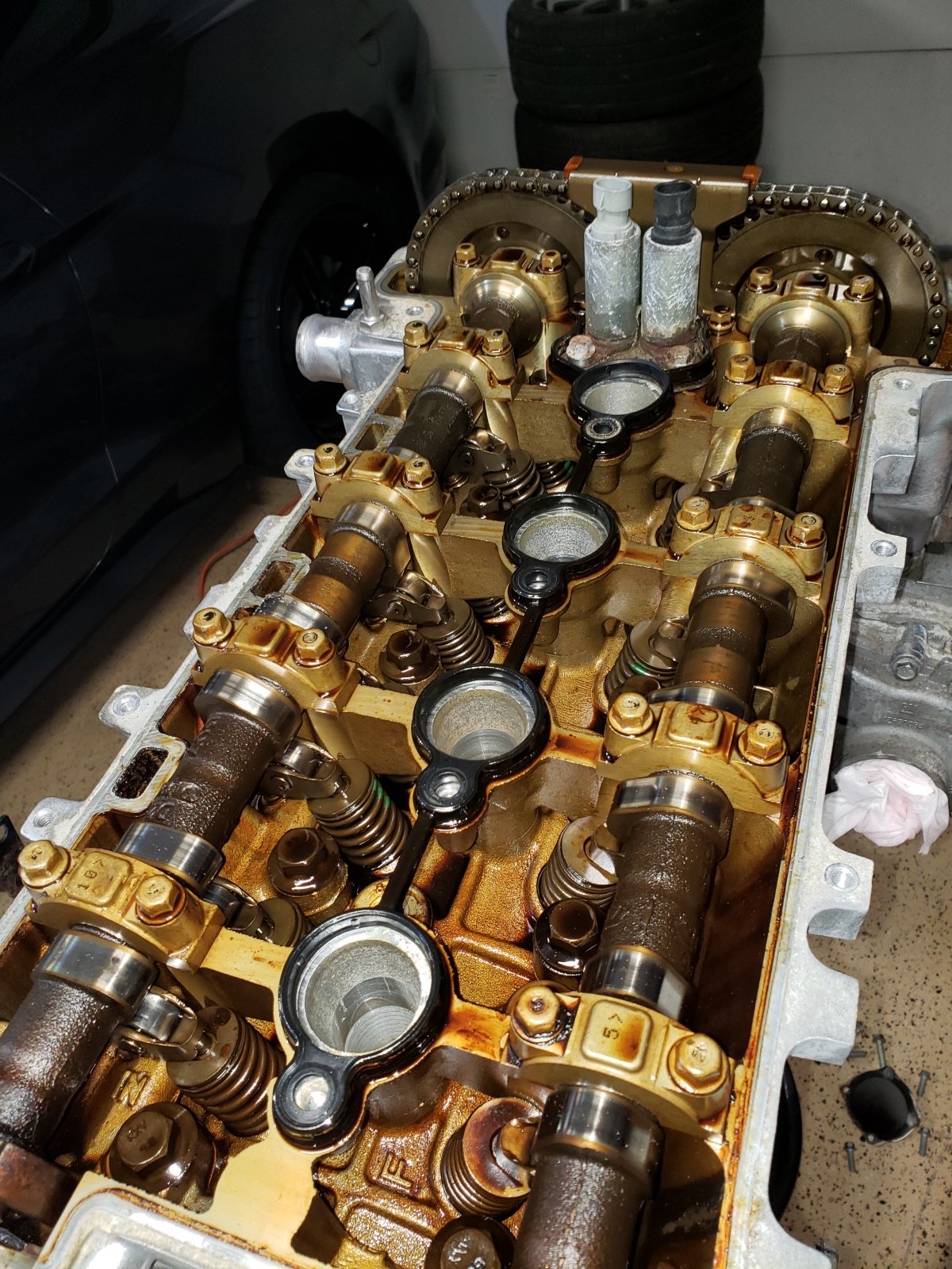

Pulled valve cover and replaced water pump and timing set. Looked pretty clean inside. Snapped one of the longer water pump bolts due to herculean efforts

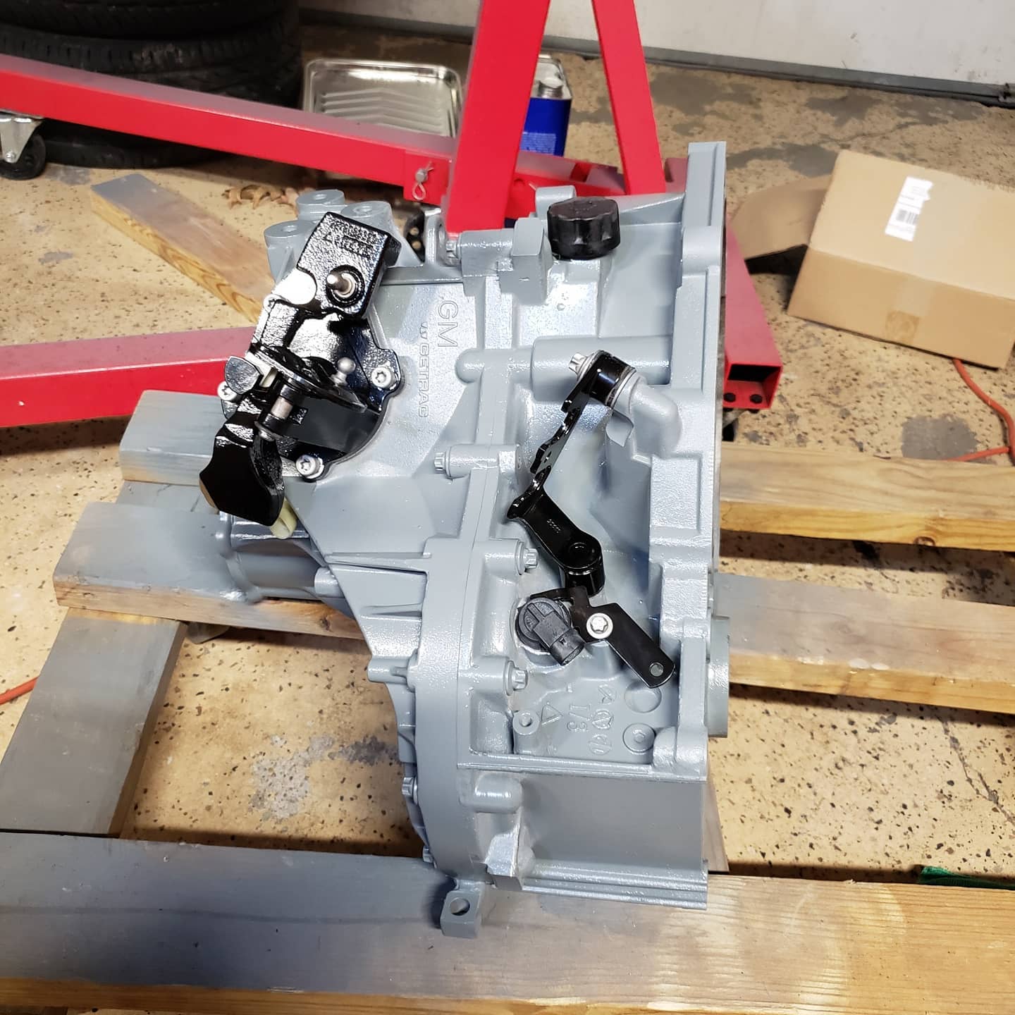

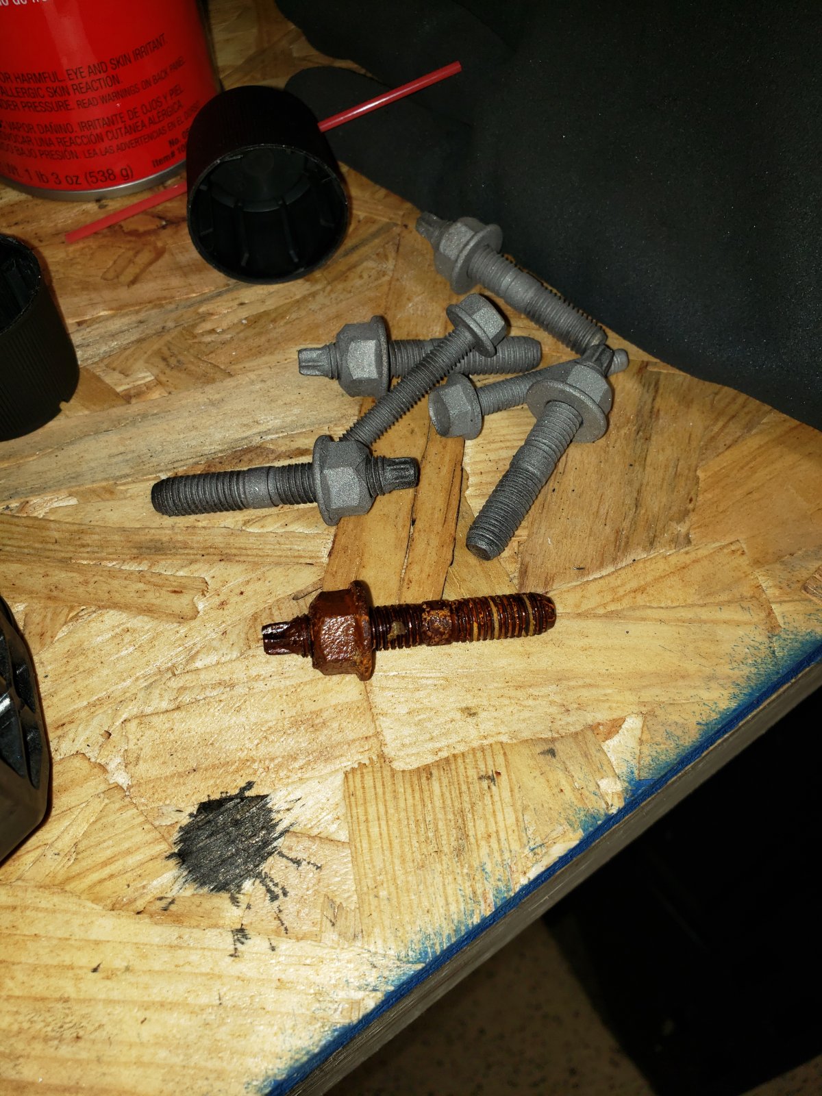

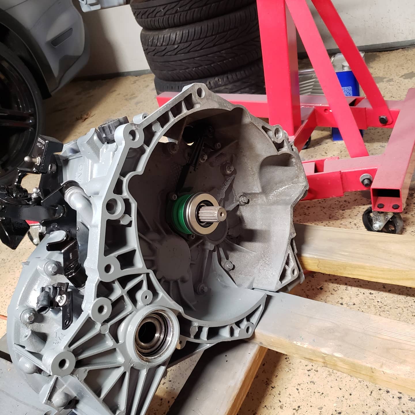

Transmission painted and powdercoated. I cerakote'd the bolts to see how they last after cleaning and sandblasting. Then I saw that considering it's an F23... I need to cut the counter weight... after powder coating. :confused:
