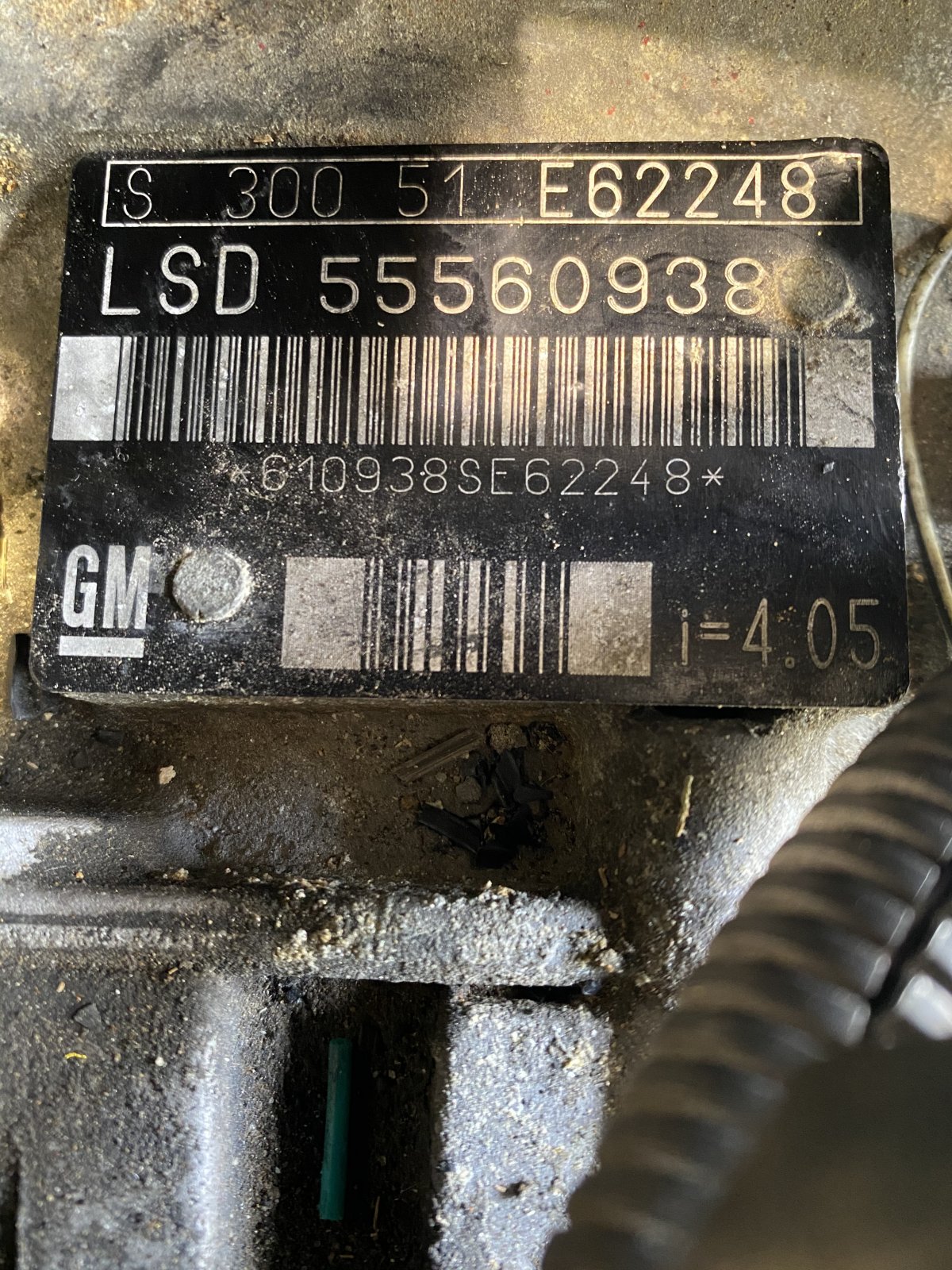

Towerdog
Mine has it right on the label
Here is another sample of the G85 transmission plate. Sorry for the (lack of) quality of the pic, it's the best I can get without ripping the car apart.
However ours does not state it in the plate and according to the windows sticker and VIN, it does have the G85 option. Maybe certain years have it in the tag while others don’t. Maybe the TC have it on the tag and our SC doesn’t??

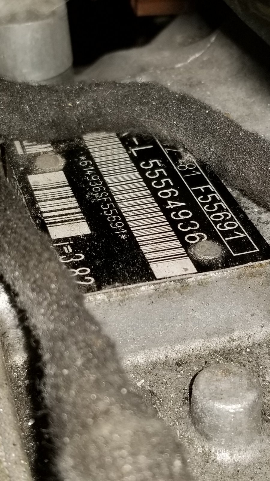

I have two transmissions here.
One from an SS/TC sedan and one thats in my donor car. The one from the sedan is a 3.82 and says "X-L 55564936"
The one in the donor is a 4.05 gear and says "FZ55560937"
4.05 might explain why it feels like it could use a 6th gear on the highway.
