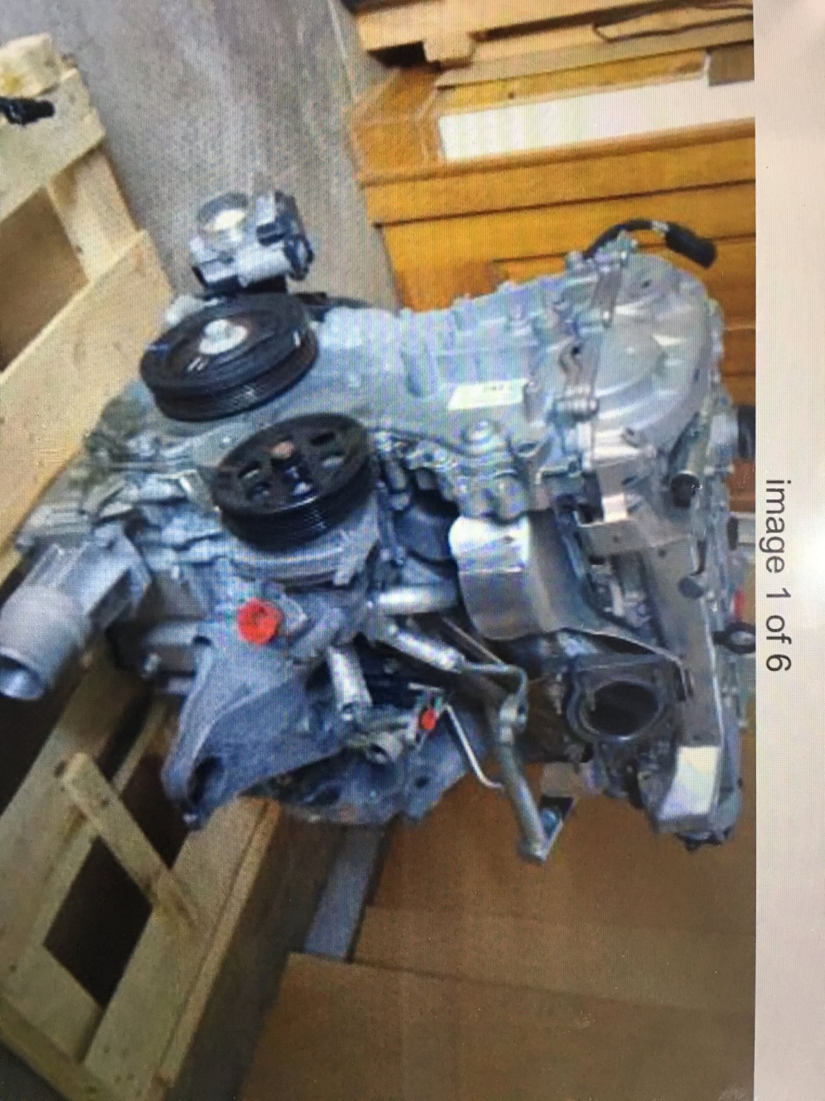

BAR-AIR
Good Evening,
Was just looking thru the local Craigslist and came across a Ecotec LTG (from a Cadillac) 7000 miles with a blown piston due to an aftermarket tune. Any idea how much of the internals are interchangeable with a Cobalt’s 2.0?
F
View attachment 4679Good Evening,
Where are you located ? I saw that engine on cl as well (unless there are alot of blown pistons from tuning ! ) im in alden and found a ats engine and trans with 68 k on car-part that im putting in a mg midget
