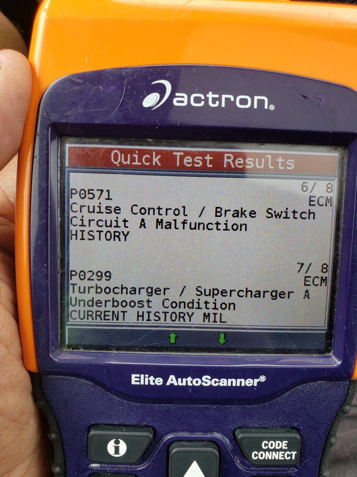

I ran a code check because the check engine light came on. Under boost malfunction what is causing this please if you know help me out thanks in advance.

95Blitz
  • Faulty turbo or supercharger
  • Low oil pressure in the engine
  • Fault in the EGR system
  • Air or intake leak or restriction
  • Faulty boost pressure sensor
Either #4 or 5 I would think.

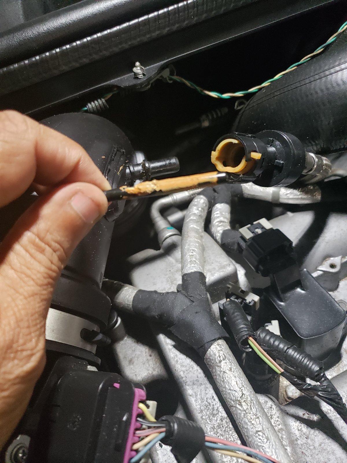

Man oh man I just purchased this car as my Donor car for my build the power loss and code is do to this air fitting was broke and the previous guy Silicone this piece up in the other piece that's why the boost was lacking causing the code smdh.
Just amazing what some have found on their donors. Makes you wonder a little about the fact they are on the same roads as us. :/
comegetjoe
The 09 ss/tc I bought also had this fitting broken off and poorly jbwelded together.
Where does the opposite end connect to?
