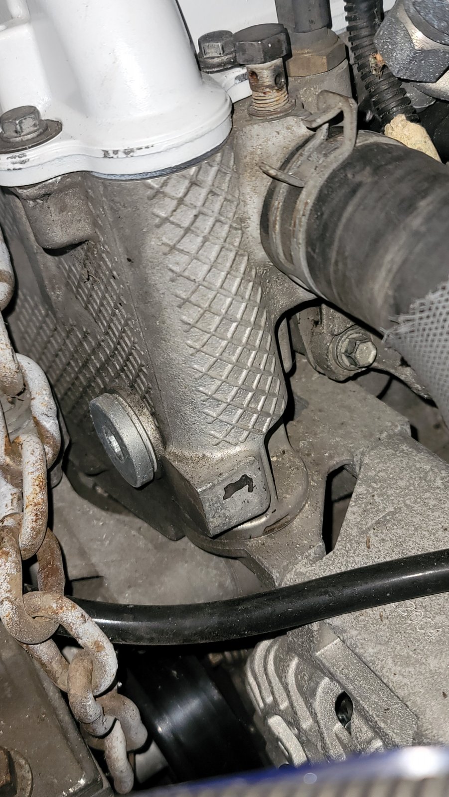

As you can see, the passenger side engine hoist bracket is missing.
Any ideas on what to do about if I don't do fabrication?

Wrecker is a great idea, thanks DesertSasqwatch. The weird part is there's no indication of where it mounts up to. There are no boltholes from where it was supposed to be... WTF Mate?? any ideas

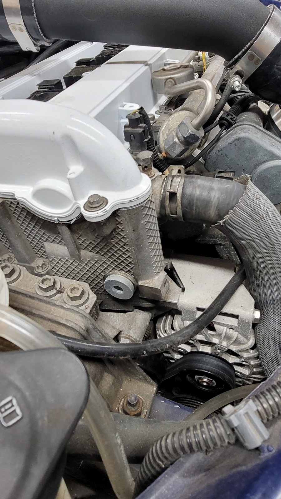

Yeah, I noticed that as well, Dsteinhorst? Any ideas? I think It's for bleeding the system easily, but I don't know why you'd want to bleed a sealed system. Car didn't have coolant in it when I got it, so, maybe the culprit.

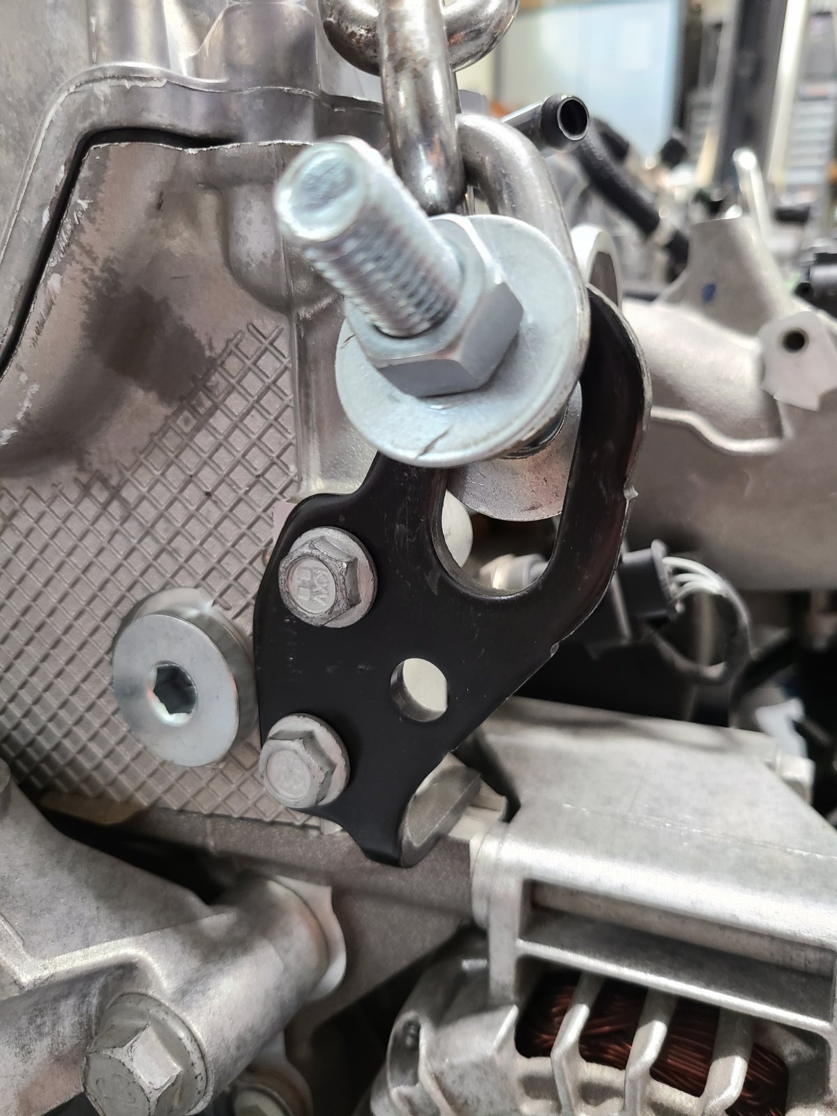

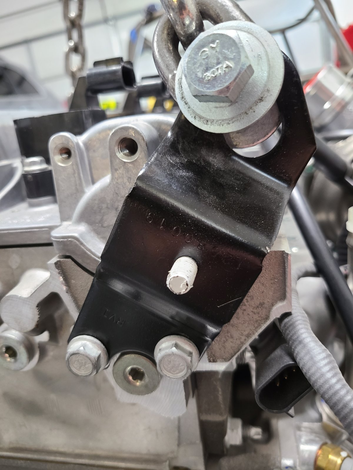

I looked back and think you're building an LSJ-T, right? The hoist bracket mounts to the tensioner bracket, and is useful for moving the tensioner pulley to get the belt on and off, but if you're not using the LSJ tensioner, then the missing bracket isn't a problem unless you actually need to use it as a hoist.
