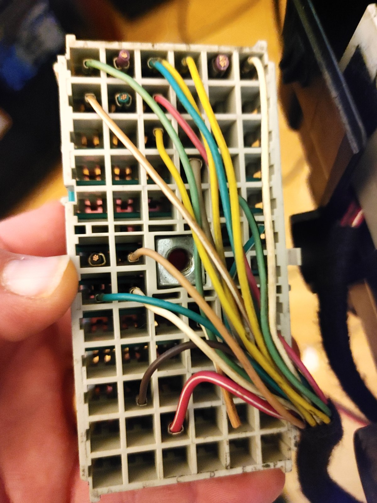

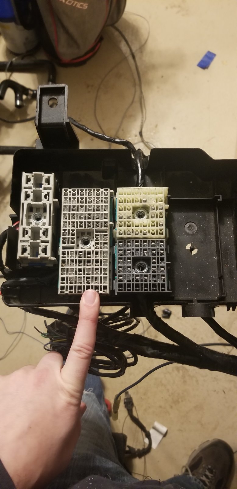

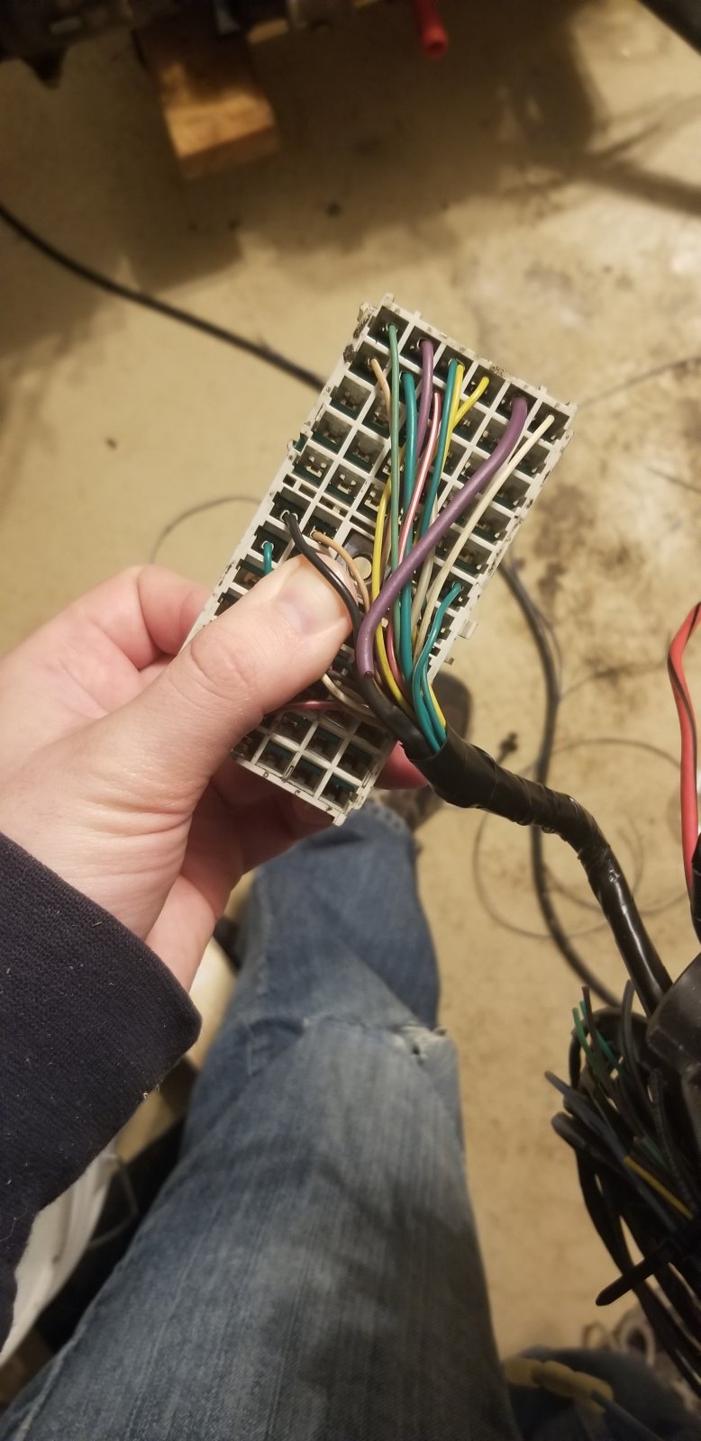

This is the connector and ground that I guess I cut too short. I don't know that it is the correct one. I have not yet been able to confirm completely that this wire should be grounded. Just an educated guess. Hope this helps! (The wire is over the top of my thumb)

On the later donors the only ground that comes out of the X2 fuse box connector is the wiper motor ground.
You may want to invest in an alldata subscription since if it has the same info as the service manual, you can check all of the connections to confirm they are going where the need to, for your donor.
Thanks! I'll see where mine goes and make sure it's not an orphan wire hanging out somewhere.
