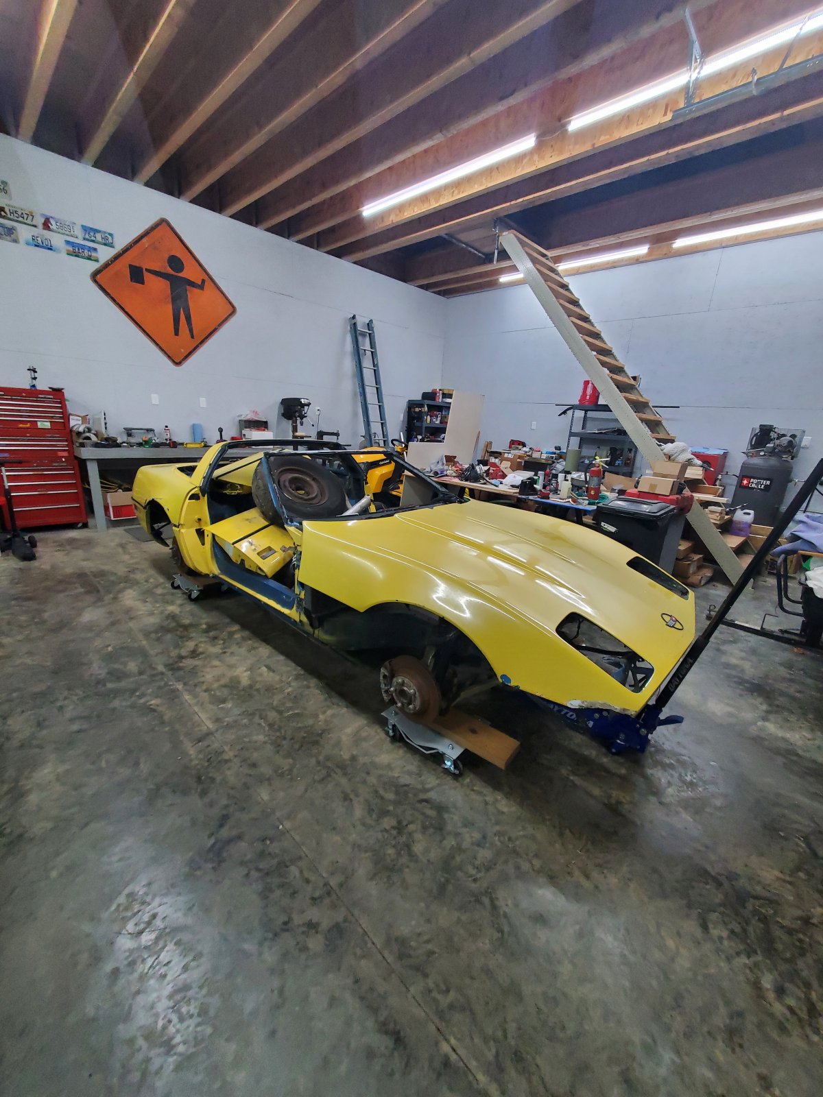

It’s been a while since I posted any updates to this one.
A deposit has been made at the local engine builder. There is an aluminum head 383 in my future.
A large package from Silver Sport Transmission is on its way with a shiny new TKX and accessories.
FiTech will soon be sending their Ultimate TPI harness and computer to allow use of the TPI intake with SLP runners I found.
A Raingear wiper system is on the way too.
Combine those with the new complete wiring harness and front disc brake conversion and I think that will keep me busy in the shop for several weeks.
Good thing some shop space should be opening up soon.
