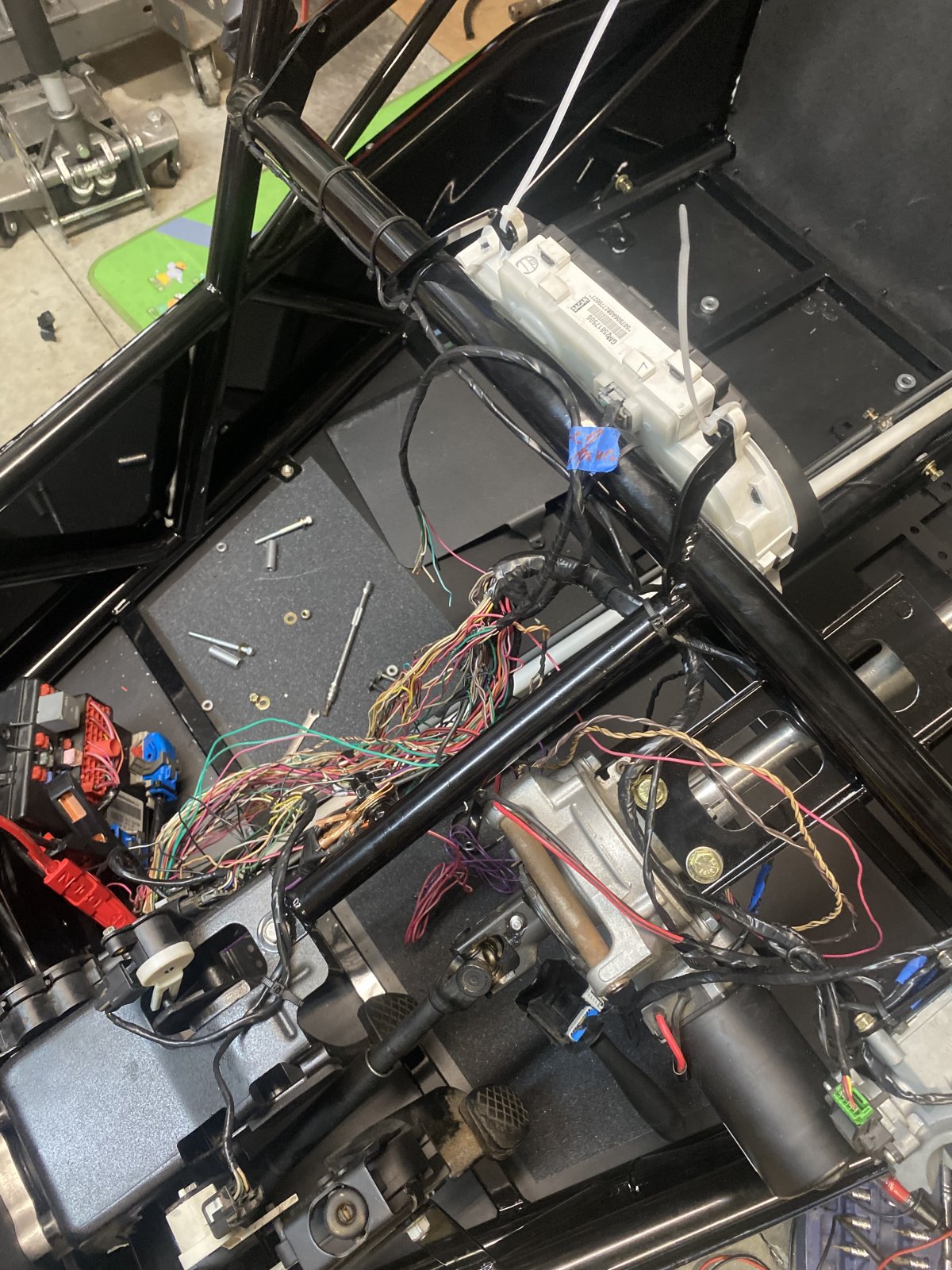

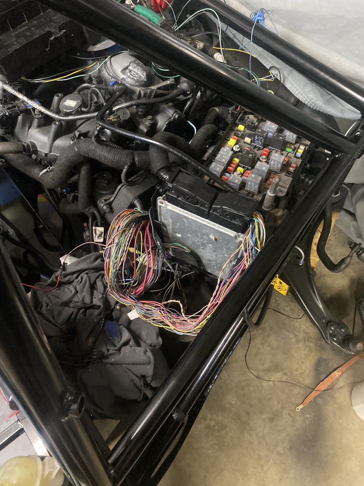

So for the pass few days i been trying to turn on the goblin. Fuel pump prime. Clutch sensor got power all the way to the computer. Both fuse box and bcm click but I get no starter signal. I can jump the relay and it turns over. Gas gauge is at zero. All data wires connected right. Undid the whole harness and everything looks right. No theft light on. Gas pedal moves with throttle body. What could be the problem.

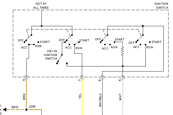

a the ignition switch i notice that the brown wire loses power when i try to start the car is that normal..
There are five wires
White/black 5 volt dc part of the theft deterrent
Red/white 12volts dc fed from the bcm ign/SW fuse(for actually turning on the crank relay when you try to start the car)
White wire looks like 5 volts passes through the switch to the bcm when car is started (Not sure on this one)
Yellow 12 volts dc fed from the switch back to the bcm from the switch to the crank relay when car is started(should read 12vdc here I would think when trying to start the car)
Brown 12 volts dc ,Feds the theft deterrent module and the ignition lock solenoid
From the wiring diagram that I have for a 2009:
  1. The brown will lose 12v during cranking. It's only on with Accessory and Run.
  2. The Yellow should have 12V during Run AND Start.
  3. The White is the start command (through the resistor for anti-theft)
  4. The White/Black is the Off/Run/Start circuit from the BCM.
  5. The Red/White is not included in this diagram and I assume it is Hot all the time and is included in the power distribution diagram.

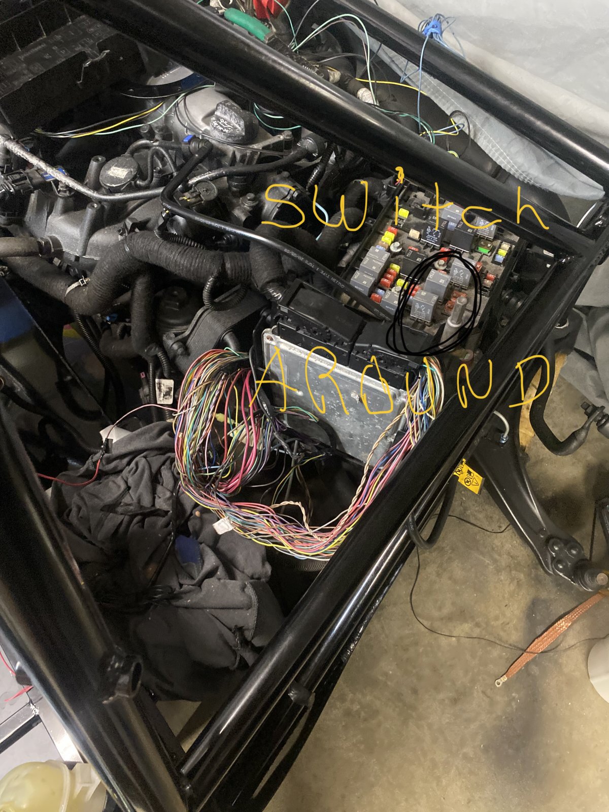

Switch these 2 relays around, I just went through this myself. Amazon 2 for 20. , One is probably bad .
or auto zone 1 for 30

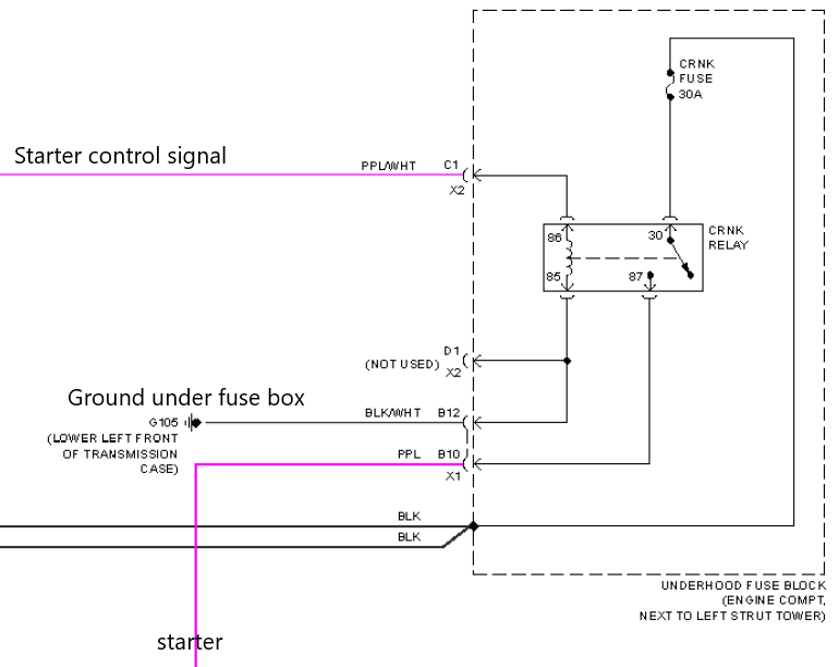

  2. Do you have the one black wire from the headlight harness under the fusebox grounded? It's a large white connector under the fusebox, there should be one black wire coming from it that goes to ground. It provides ground for relays in the fusebox.
We need to determine if the ECM is even ready and sending the STARTER CONTROL signal. That will help a lot.

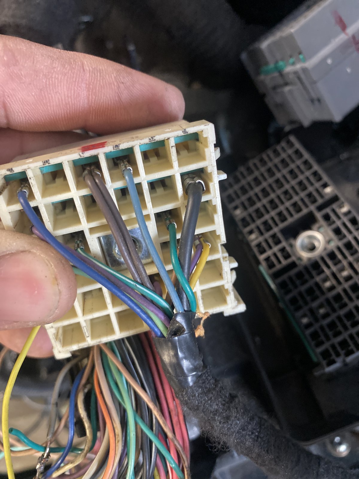

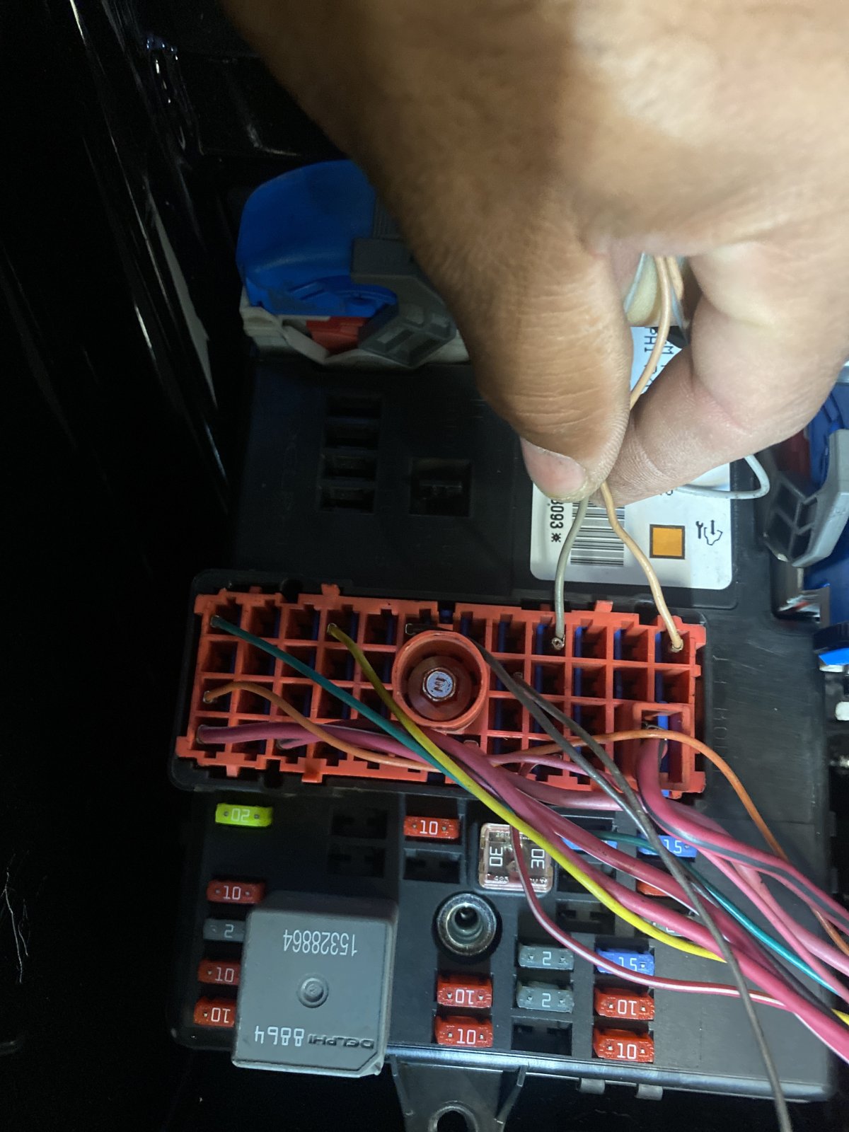

Ok so I found 2 cables not connected coming from the bcm now the question is where they go to
