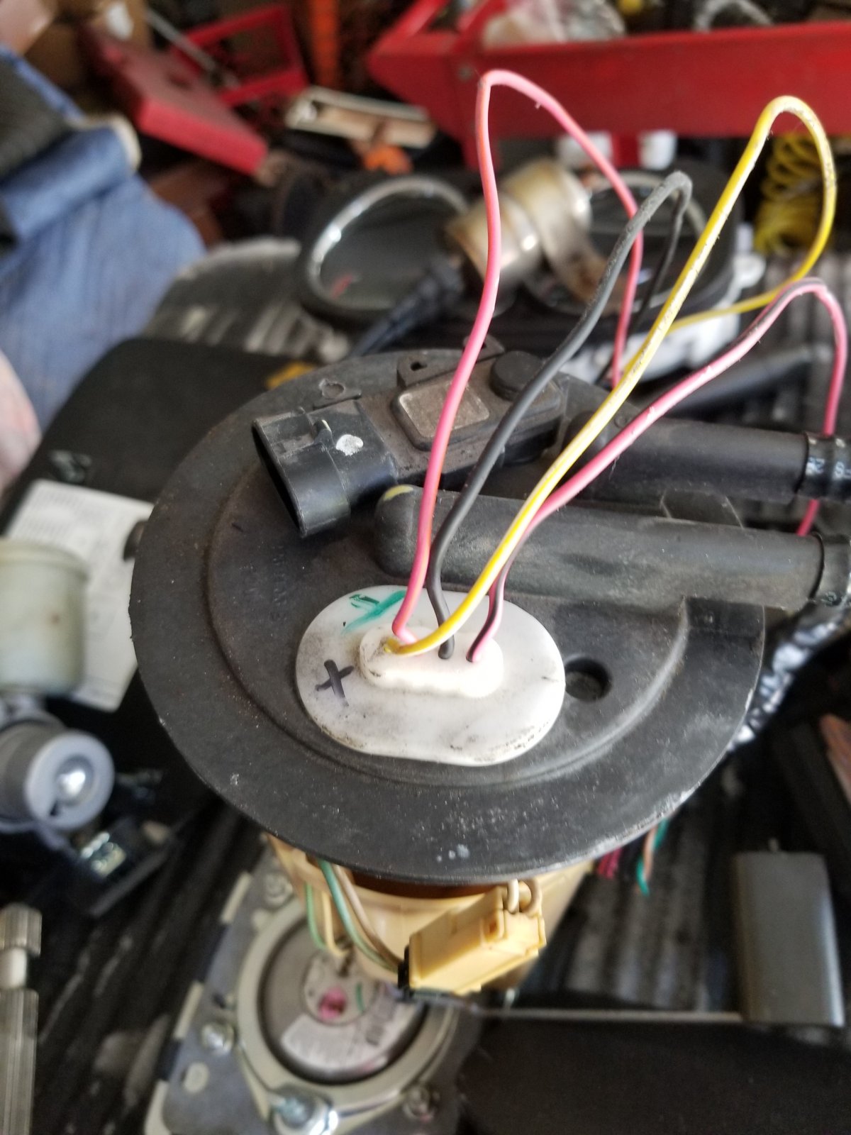

Hi. Putting a vom meter on my donor fuel pump, which btw has wires built in the housing, the fuel gauge goes open at some fuel angles. I need a new one. The 05 2.0 unit is very expensive. Do I have to have this one? The 2.2 pump is much less. What is the difference? Does the fuel pump flow more? P

Is your SS doner supercharged? Mine is, (05 2.0) and the wires coming out of the housing are built in, not like the amazon unit you showed.

Yes 2.0 ss/sc it has a plug at the top there are no wires visible from the top of the unit. Could you upload a picture of yours ?

I’m not sure what that one is. Looks nothing like mine. Maybe a tank pressure sensor, could be some sort of emissions thing. I recall something in the build videos mentioning having to get a new fuel pump if you had a certain style.
The one I linked bolted up with the supplied hardware. There is no intelligence In the pump just get power from the relay and runs when the ecu fires the pump relay. I didn’t pin out the fuel level wires not sure how accurate it is but I did run out of gas when the needle said it was out of gas lol.

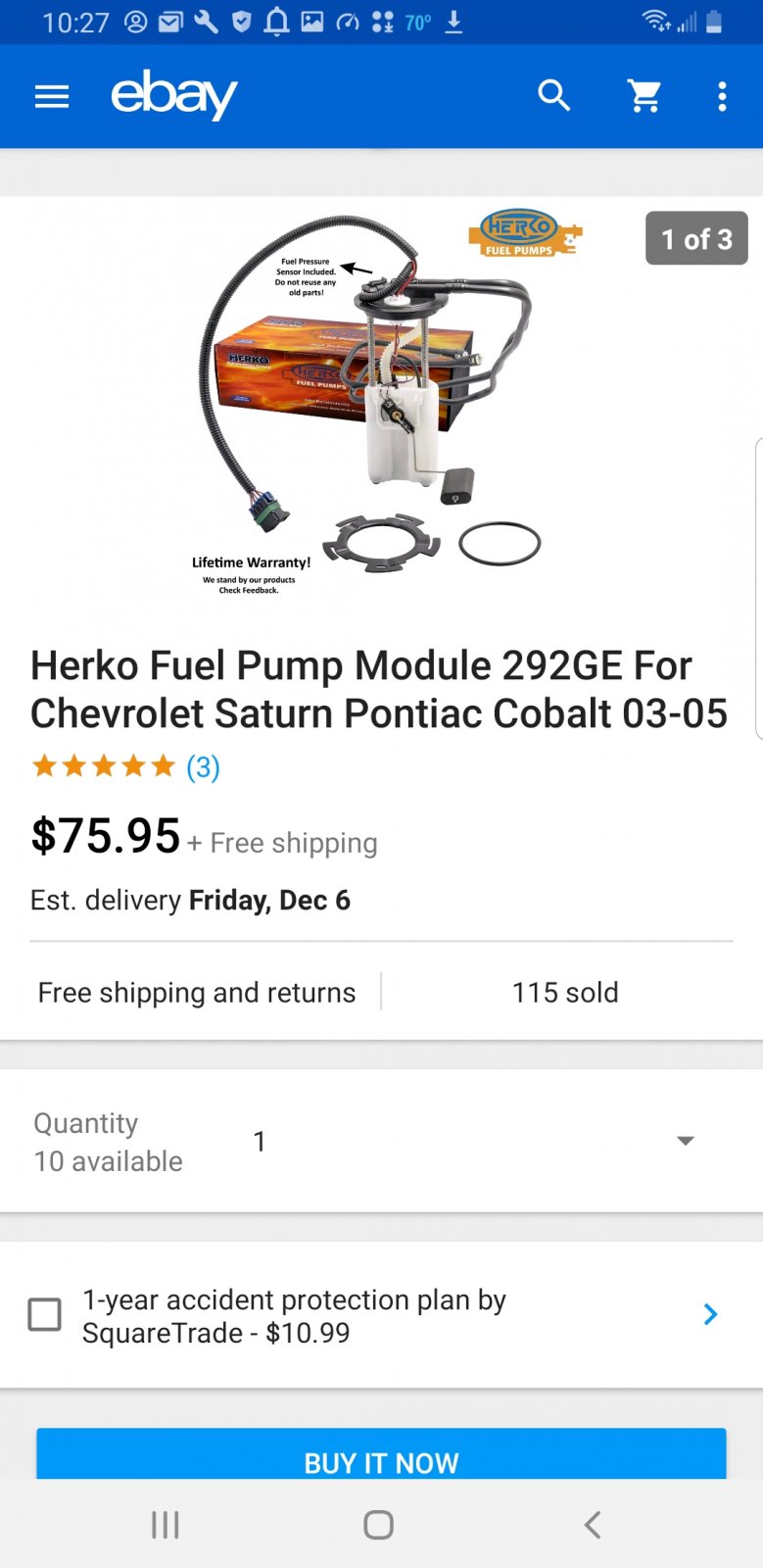

I could use the cheaper one like you have if I had the short harness that plugs into it. Dont know where I could get one, do you?

I think I ffg ound the answer to my bbn problem. Buy the attached pump on Ebay. It's a direct replacement for my 05 2.0. Cut the wires a solder in a aftermarket 4 pin plug, which I already have.
