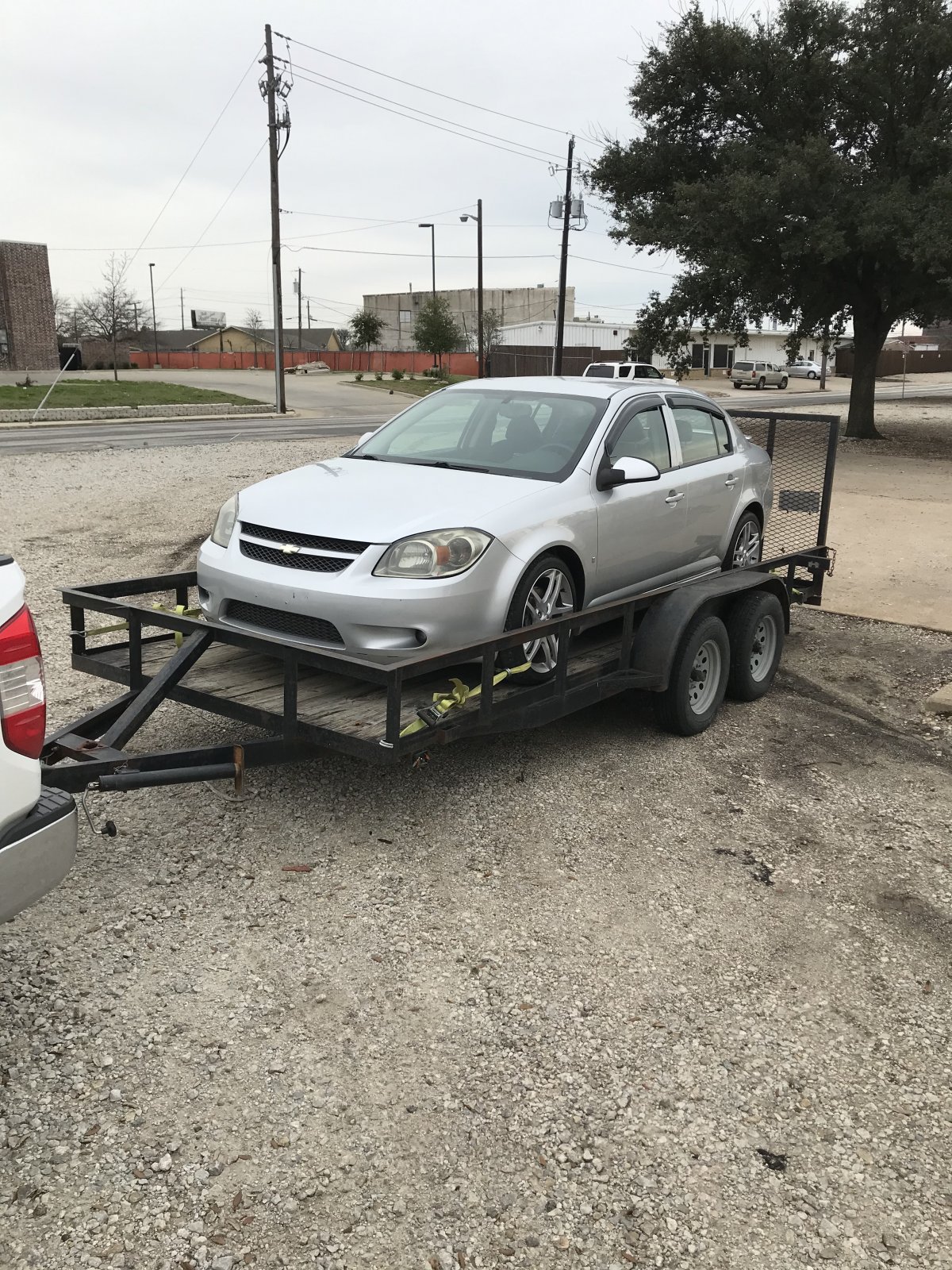

Bought a running donor.

So, my donor stripping and prepping will commence. My donor is a 2009 SS turbocharged. Really good shape.
Jason, welcome to the forum and the Goblin family. Great donor, how many miles? LSD trans (look for the G85 code on the trunk sticker)? Stripping the donor will be a great learning experience, was for many of us, and will be a great father and son project. Don't forget to start a build log when you start working on your donor.
