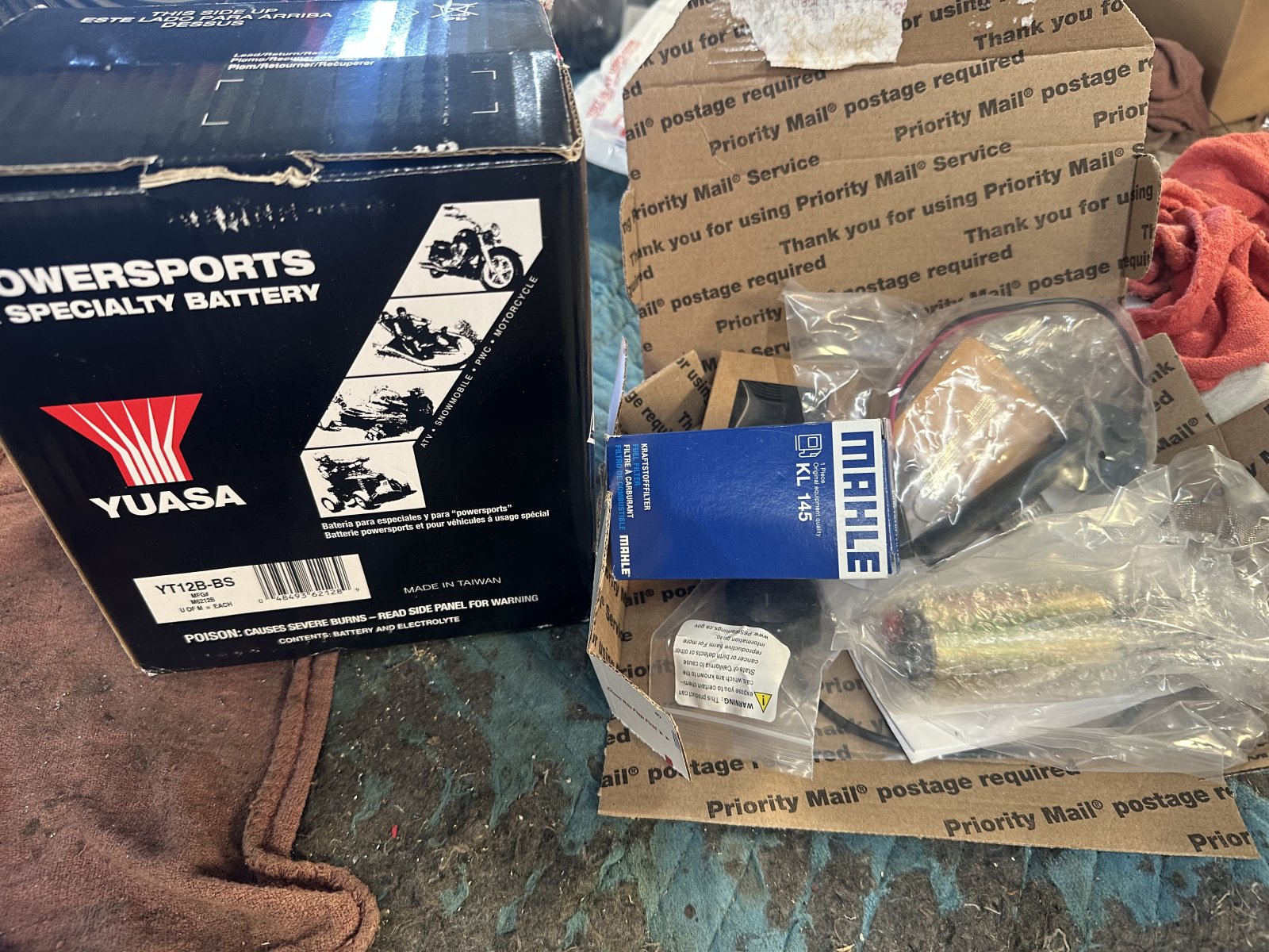

to get me back where I was 5 Years ago, I need a battery and fuel pump. Then “fix” what I think was wrong from before. Then I can move on to fixing or prepping for the track weekend.

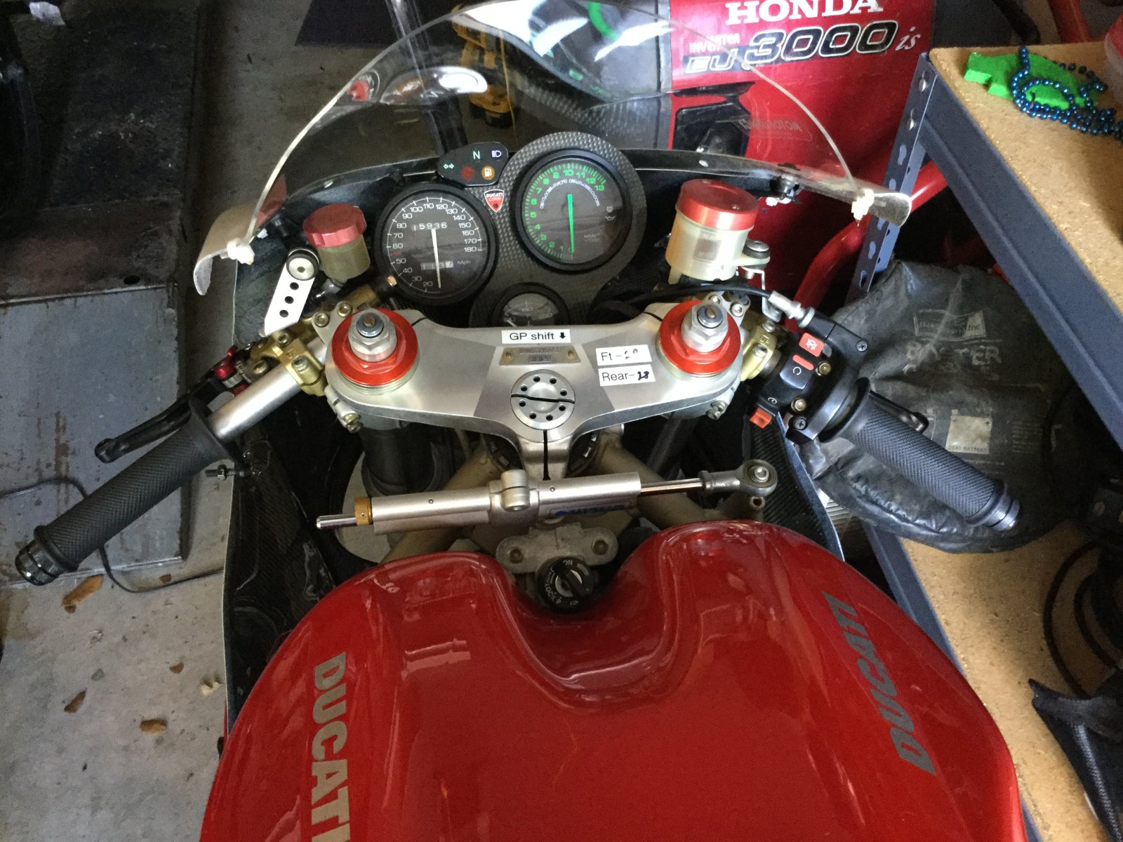

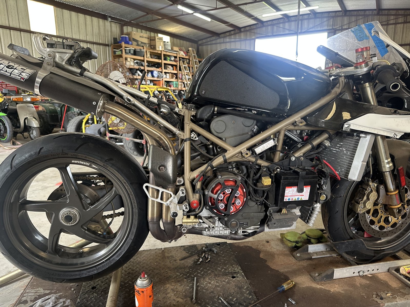

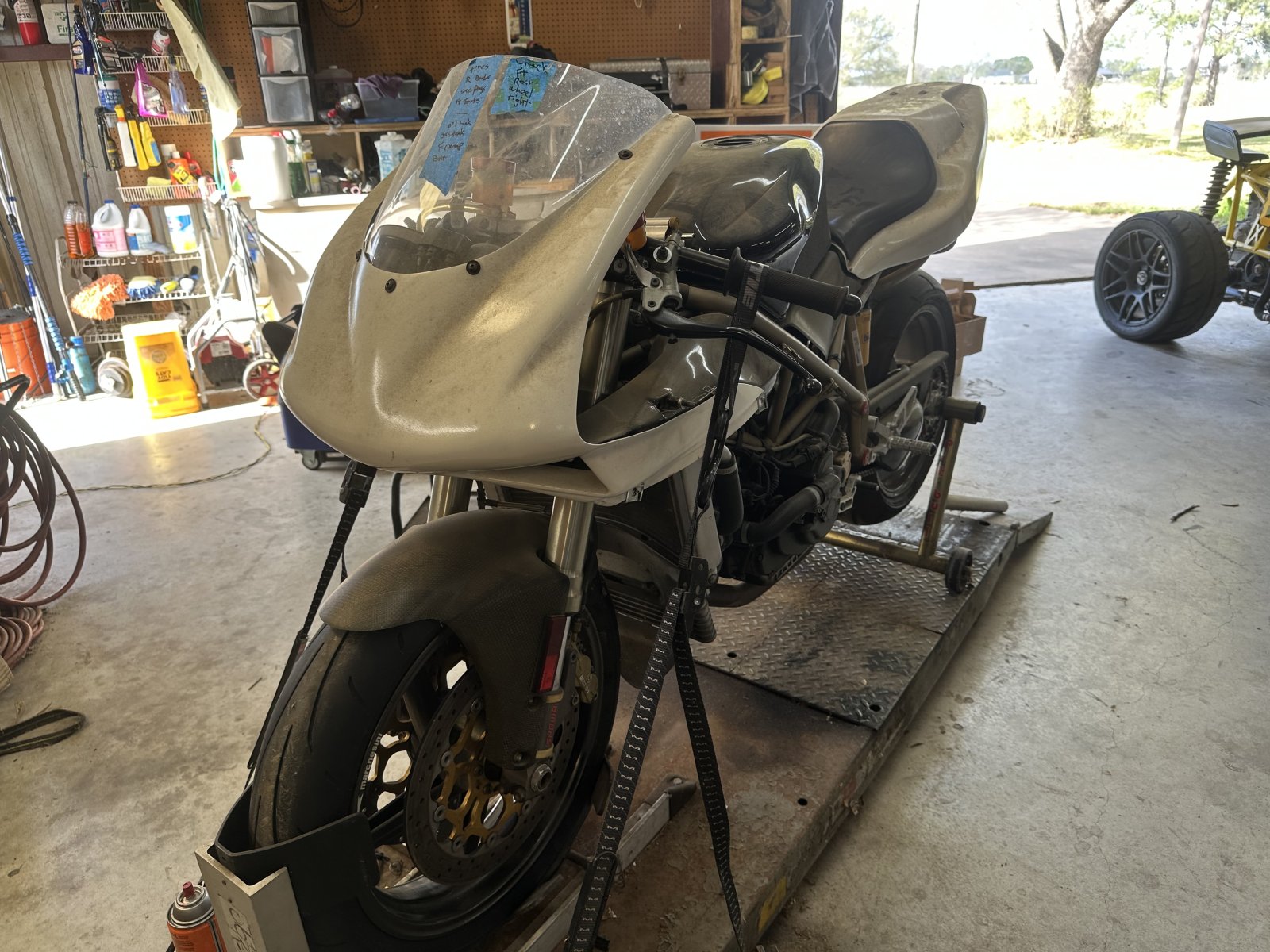

here’s what I’m working with. More to come ….

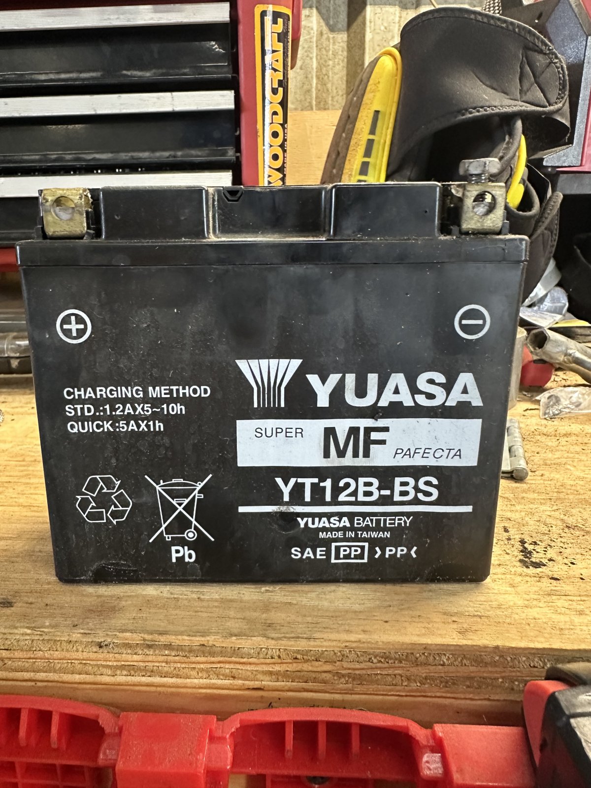

First thing is a battery and fuel pump. The battery is toast and the fuel pump is locked up because of our great gas we have. :rolleyes: The battery I use is smaller than the original Because the original is a huge 25 year old lead acid based that can spill over in high lean angles, plus is heavy. The upgrade battery I use is sealed, smaller and lighter with the same cca and such.

Fuel pump, filter, seals and such, plus the battery.

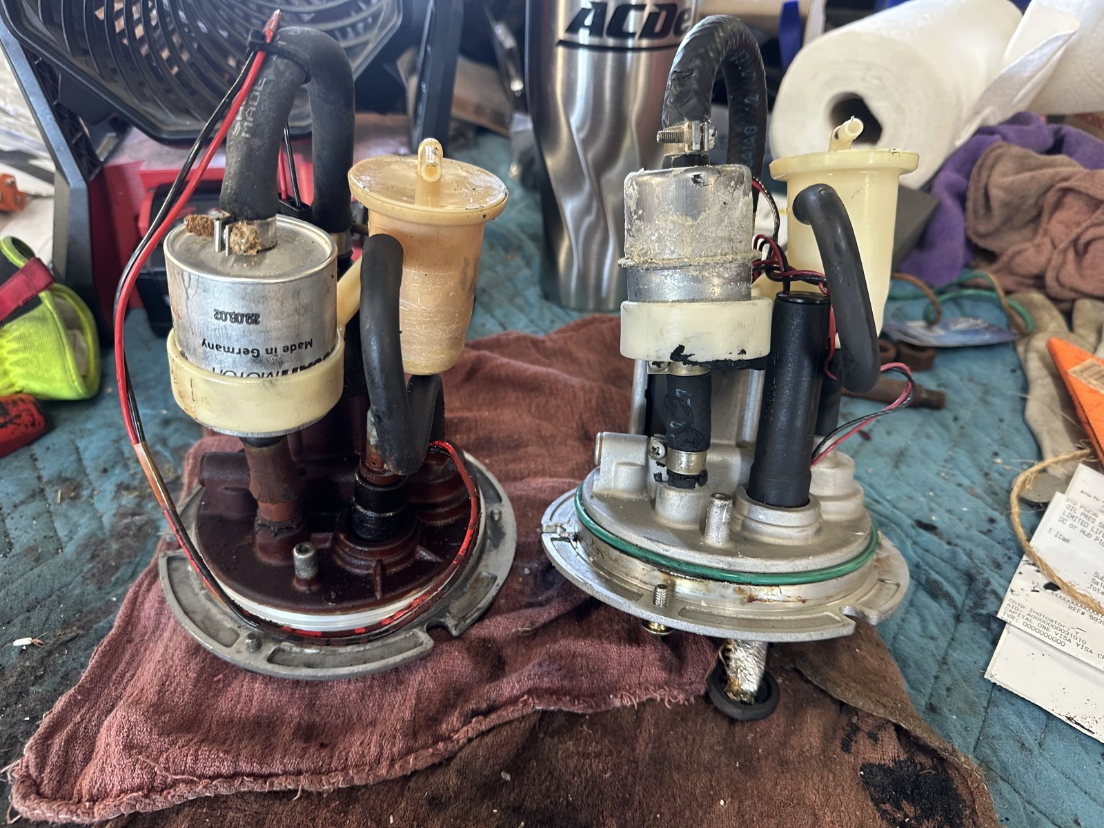

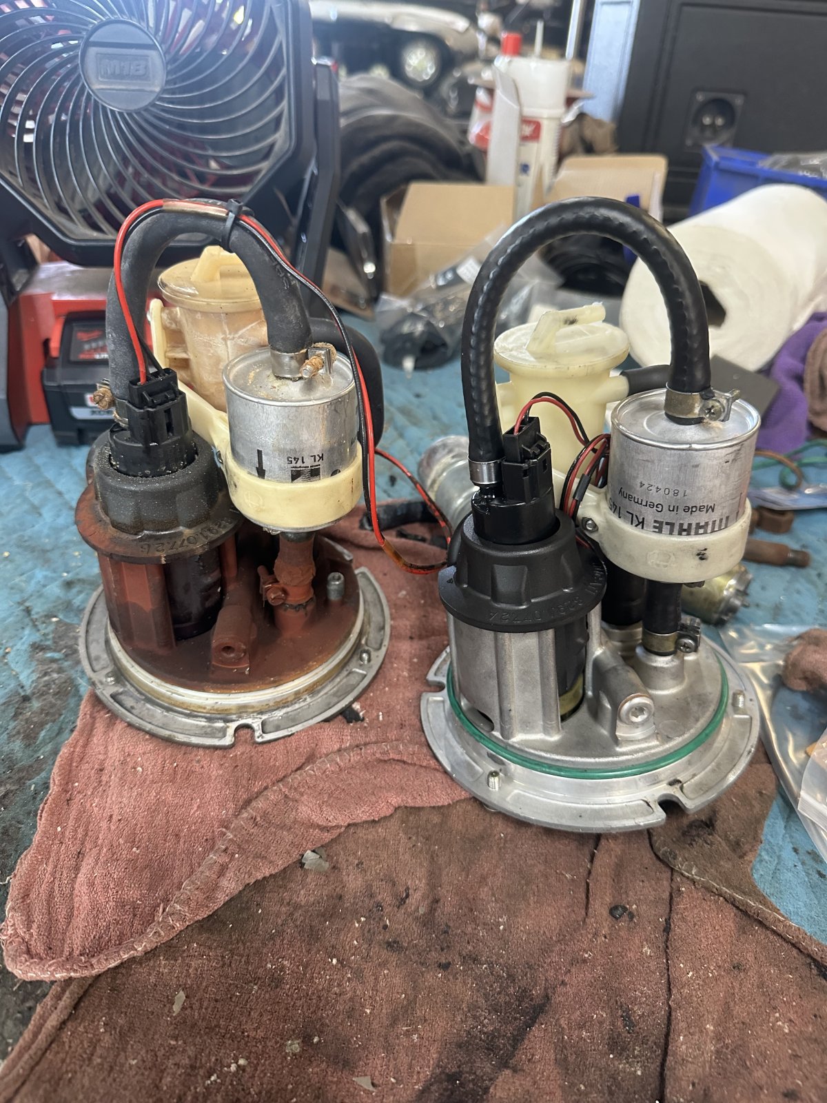

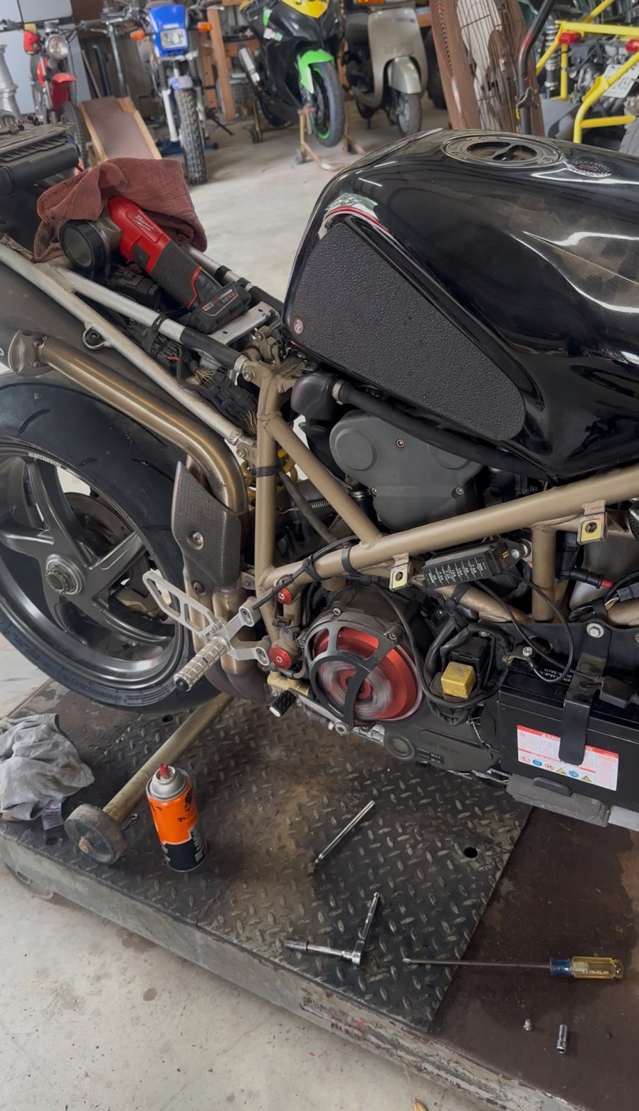

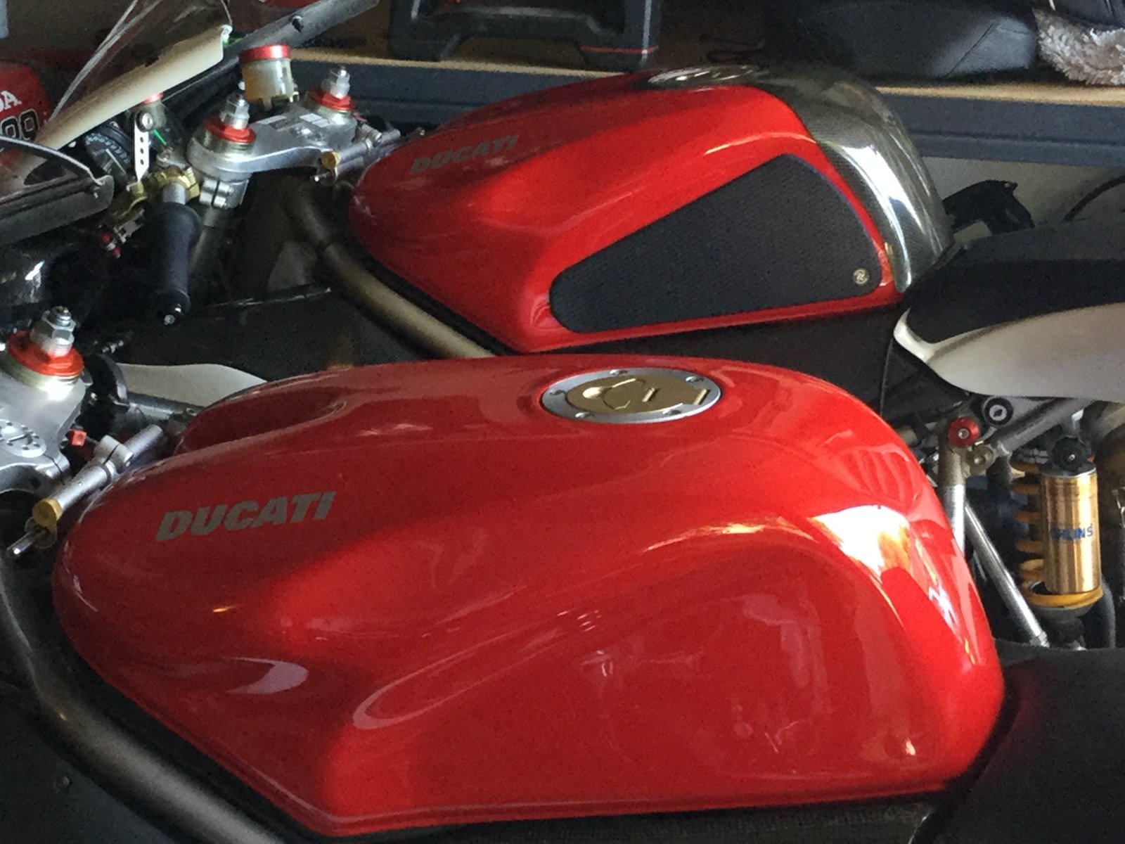

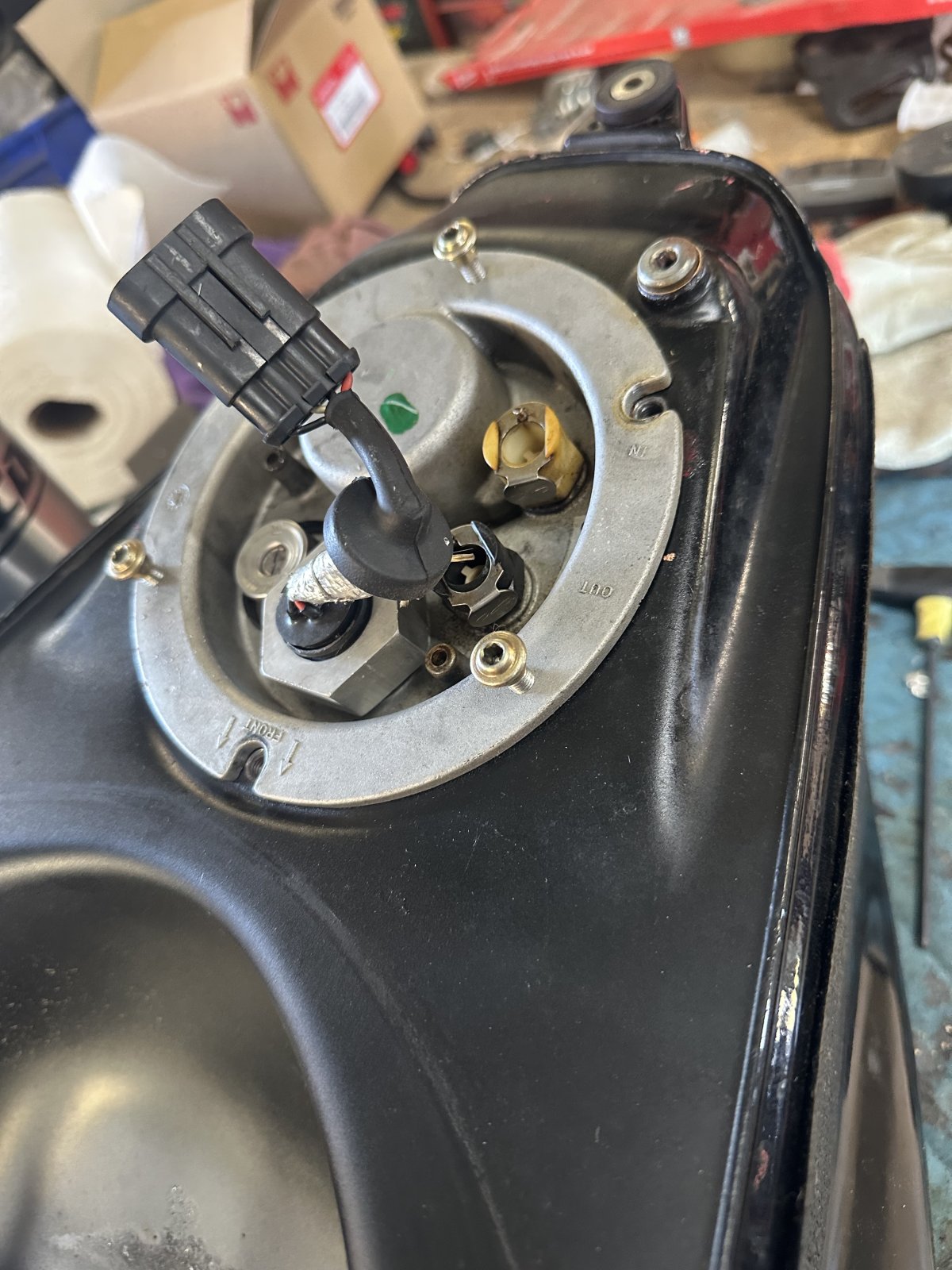

Got to work on the ducky for a bit today. Put acid in the battery and charged it up. Then decided to tackle the fuel pump. Ugh. What a mess. The black tank on the bike is actually a replacement I bought about 8-9 years ago. I didn’t want to crash on the track and mess up the stock parts, so I found a tank to use while the pristine original one sits on the shelf. Well that was great on paper. :rolleyes:

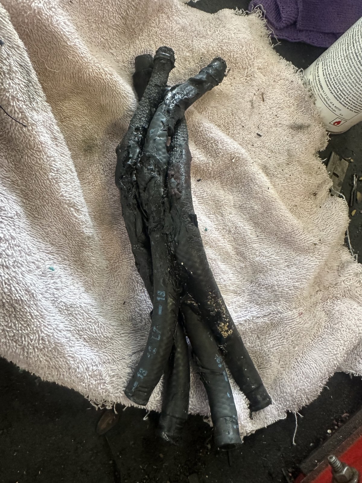

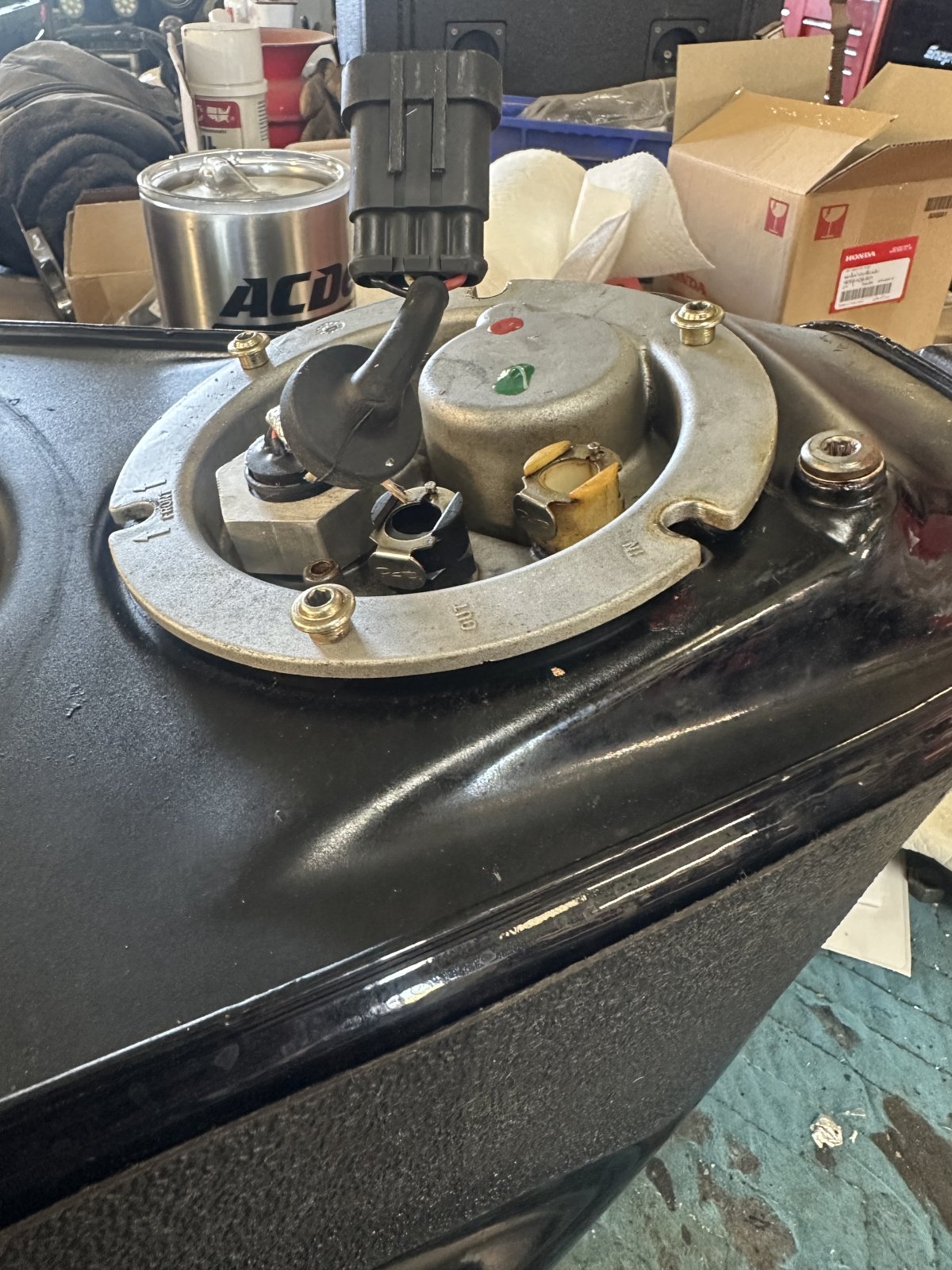

black tank: the pump was inop, so that needed replacing no matter what. When I pulled the sending unit the hoses were all “gooey”. Thanks ethanol. :rolleyes:

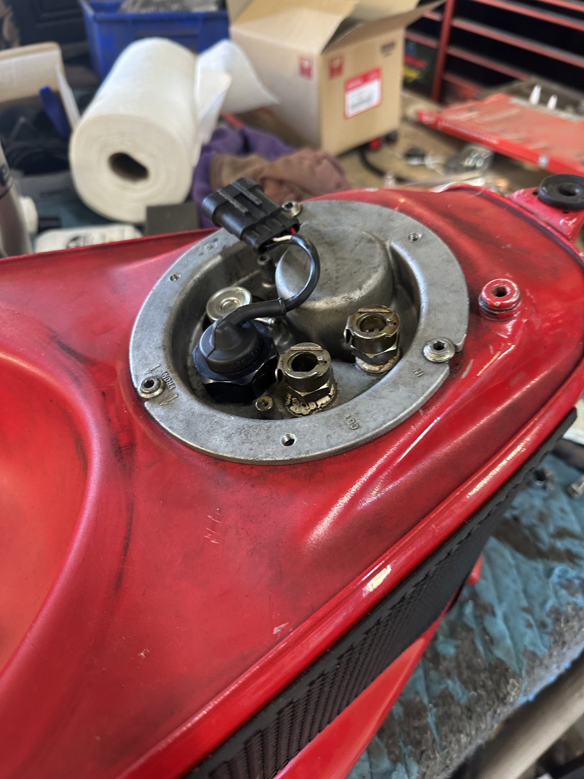

on to the original red tank: decided to pull the sending unit and drain the tank to try and preserve it. Again the hoses were gooey, but also noticed the inner liner has come apart and the tank is rusting. :(
so at the moment I’m replacing the guts on the black tank and drinking about the red tank.
oh note: you pull the screws that hold the sending unit to the tank, then put the bolts into the threaded holes, crank down and that pull the sending unit out. Sweet:cool:

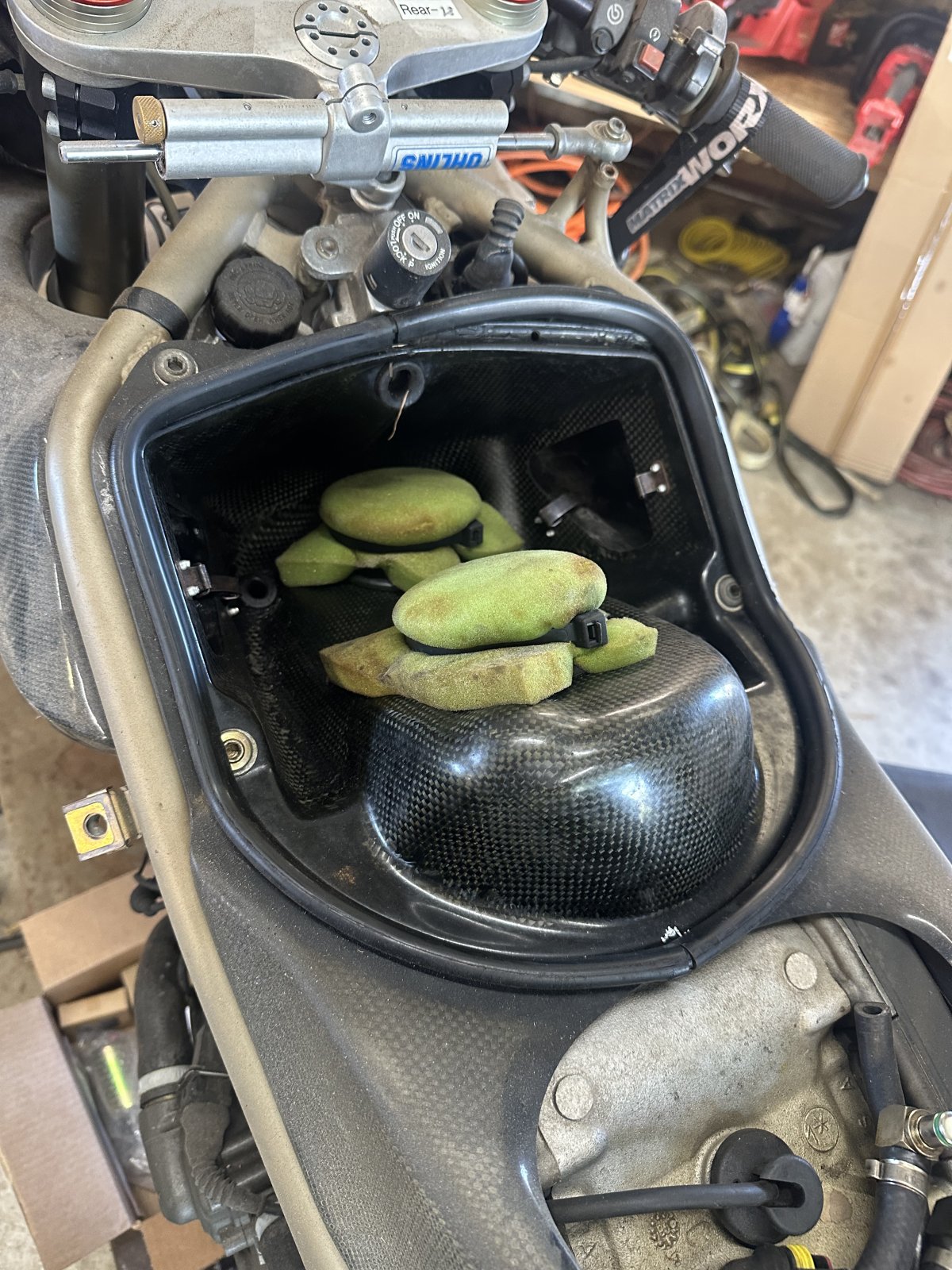

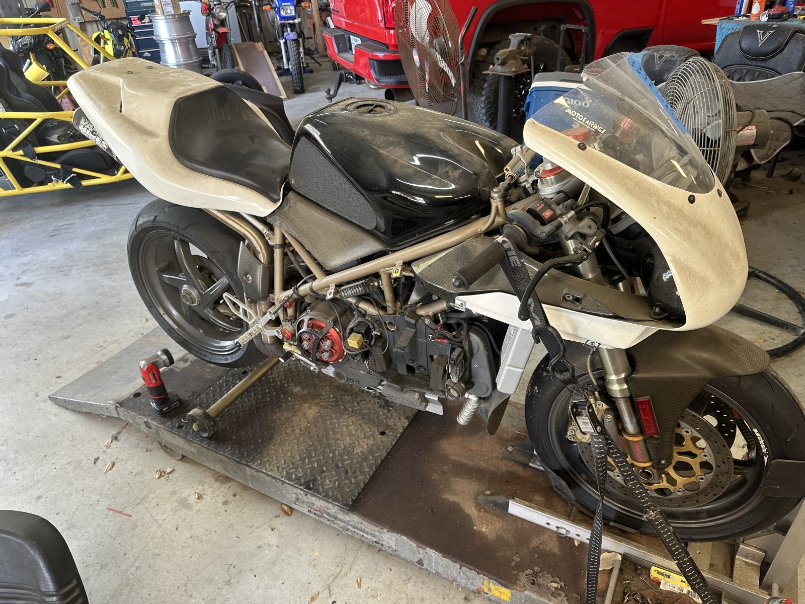

The tank is actually the cover for the airbox. When I pulled the tank, I noticed my “weekend fix” has lasted 11 years. :D This goes back to a ride we had after winning pikes peak in our division in ‘14. My buddy/crew member came down from Oklahoma to join us. He rode my FZ1 and I rode the 996. As I was checking it over I noticed the air filter was deteriorated. There was no time to hunt down a new one, so I “fixed” it. :D

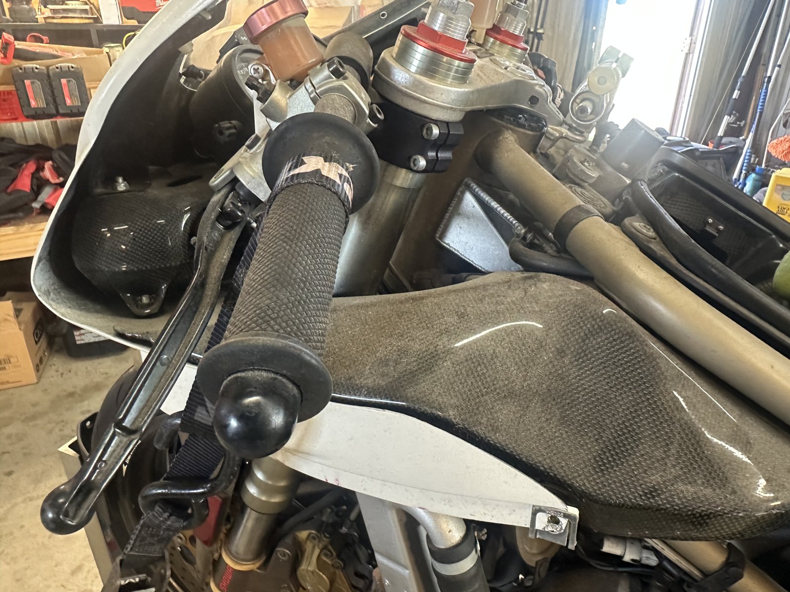

You can appreciate this. Hell, had to be 10 years ago or so, a dude on craigslist was selling a bunch of carbon fiber parts. All brand new. I was only going to buy a few things I really wanted, but ended up with almost everything. Two key things were the headlight bucket and air intake runners. :cool: That reminds me. I have some other carbon fiber pieces stashed somewhere.

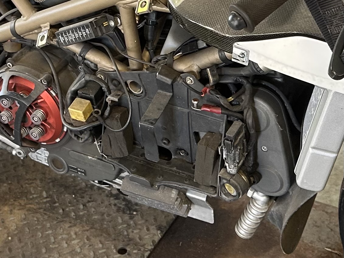

also note the aluminum coolant reservoir. Another awesome upgrade I got not to long ago. :cool:

Still waiting on plugs, but the old ones will work fine. Changed the wires, since the others are original 26 years old. Put the sending unit assembly back in the tank, installed battery, filled some fuel and hit the start button…… she lives. :cool:

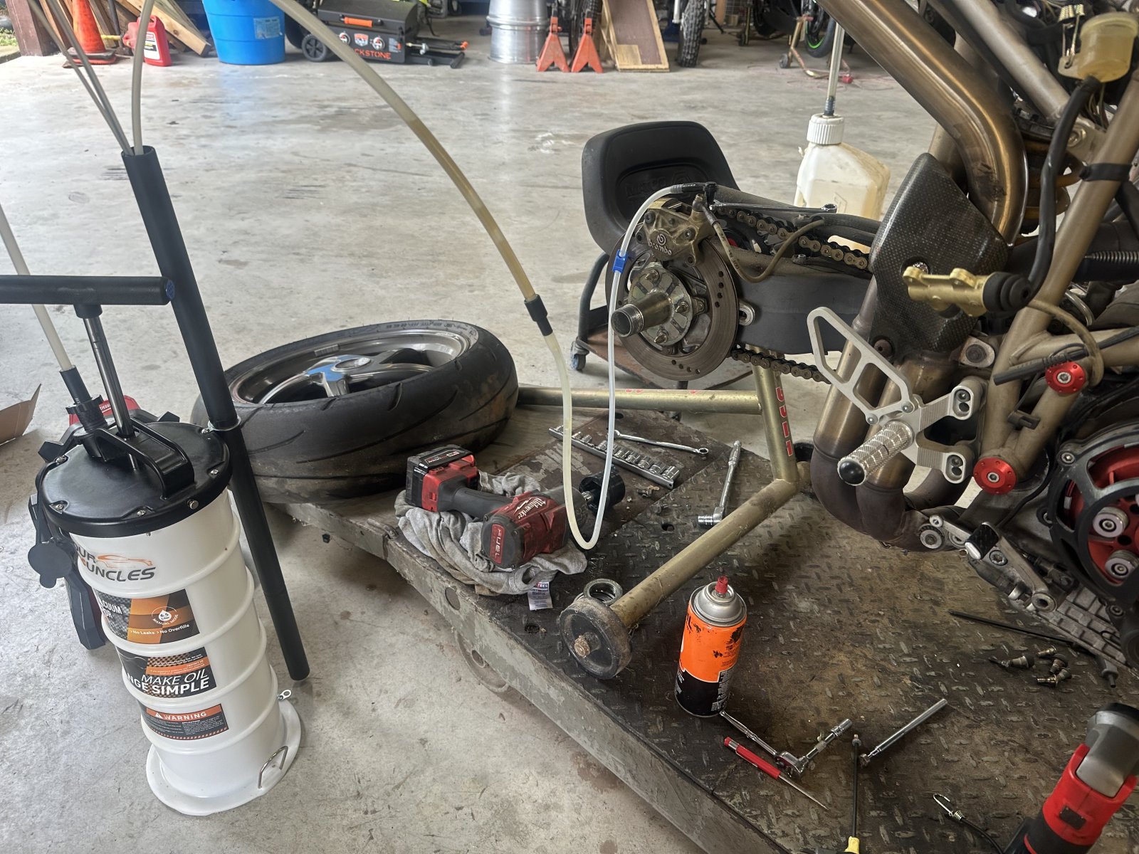

then another quirky Italian thing (there’s several). The rear brake is worthless and even at my level, the rear brake is not used, but it has to work to pass tech, so I gotta get it working again. I replaced the master years ago, but it was never right. It’s actually simple; reservoir is up. it flows down to the master, which has to pump up, over, down and around to the caliper. First, you have to dismount the caliper and put it on top of the rotor instead of under. Then you have to get the master up high enough than all fluid can flow downward. So remove master and caliper, attach a vacuum bleeder and get after it. Surprisingly, it didn’t take long to bleed with the vacuum going. Now I have a rear brake I’ll never use :D
