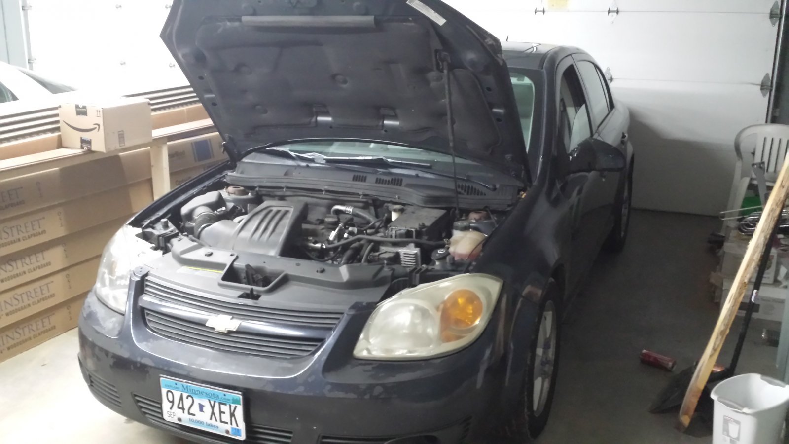

Searched for about 2 weeks and then found a 2008 LT with 72K miles on it for $600. The car was actually sold as an 07 LT which is the main reason i bought it, i likely would not have bought it had i known it was an 08.
Car had a previous salvage title. Seller said it "runs great when it starts, sometimes it doesnt start, sometimes it runs rough when it starts". Interesting. Windows didnt work, stereo didnt work, seat belt was broken. I asked if he trusts it... he said yeah i've been driving it for a year. I asked what percent likelihood i could make it home 75 miles away.. he said he'd give it 5% likely. Long story short it ran like a champ even through a rain storm with the windows down :)

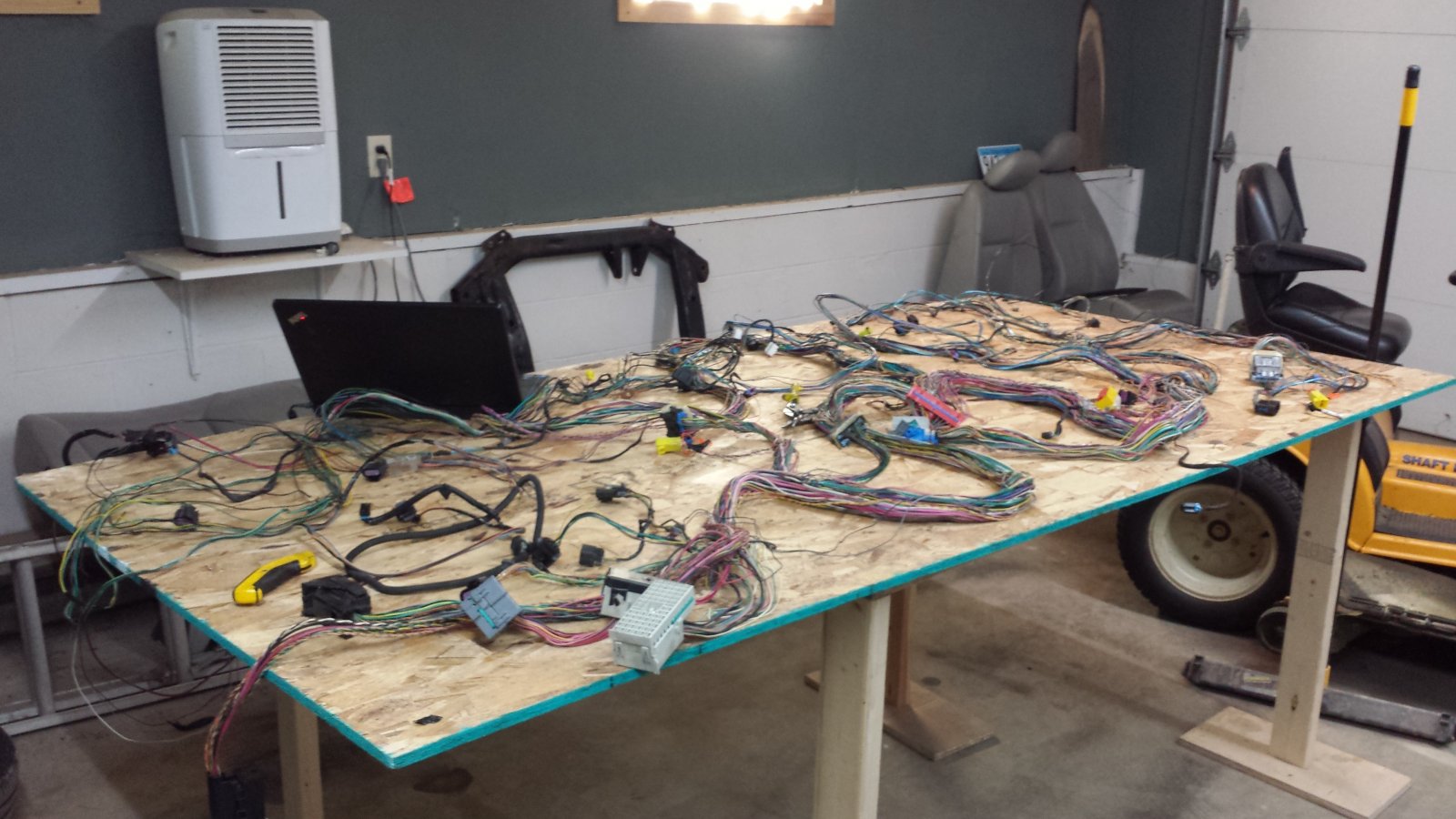

Harness fun! Think i got everything correct, only 1 extra connector

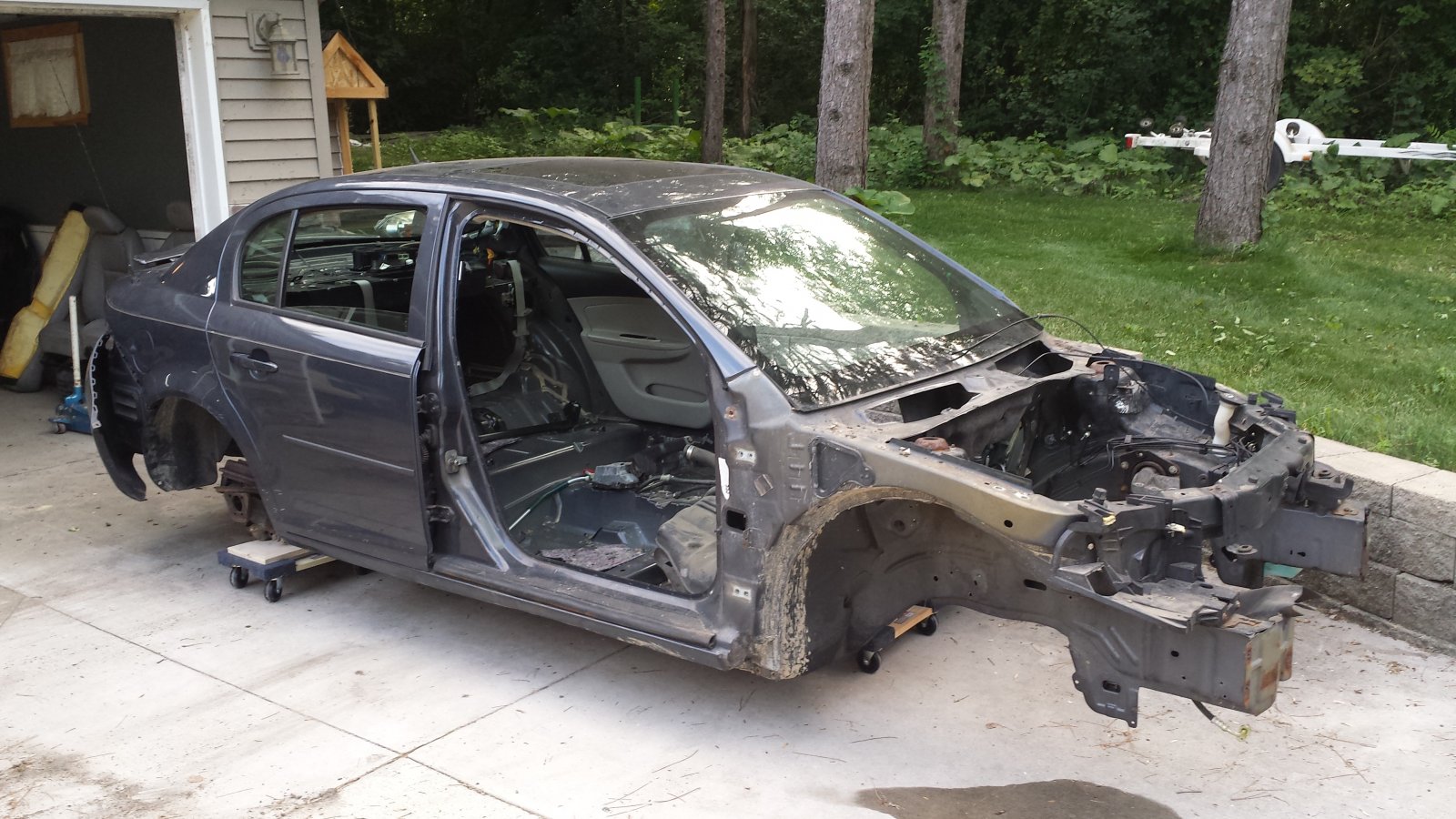

Stripped and ready for recycle.... no one wants it so its been sitting for a couple weeks! :(

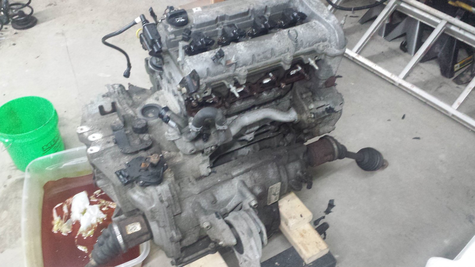

Engine stripped and ready for paint prep.
The entire goblin will be Matte black with the exception of a few accents in bright blaze orange.
Been getting the run around from the powder coat shops around here so i've decided to build a curing chamber and coat it myself. Chassis is estimated to be shipped from DF last week of august so a have a couple weeks to get the coating chamber ready.
I had the same problem. The only way for me to get rid of it was to take it myself to recycling. I ended up giving it to a friend of a friend who recycles vehicles.
N
Yeah, unfortunately i just bought a plasma so it'll be getting a workout. I dont currently have a good trailer to haul it to the scrap yard. They will all take it but dont want to pick it up!

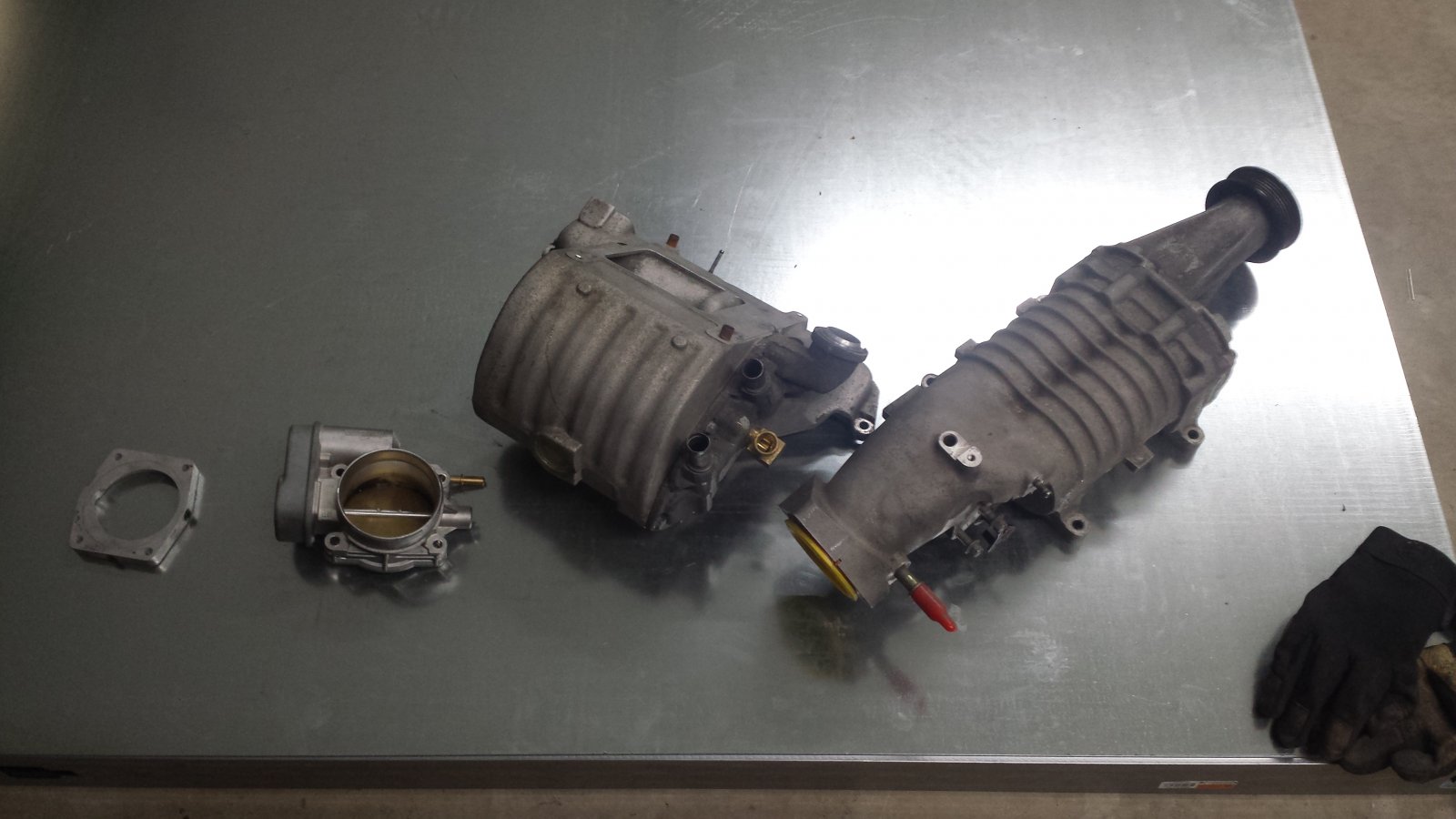

Supercharger folks, picked up some parts pretty much un-researched... anything specific i should be looking at on the intake or charger? Guy said the intake has the double bypass. Guess i need to start researching ;)

The double bypass refees to the water flow on intercooler. Look a ZZP for doube bypass. For diagram of hose routing.
