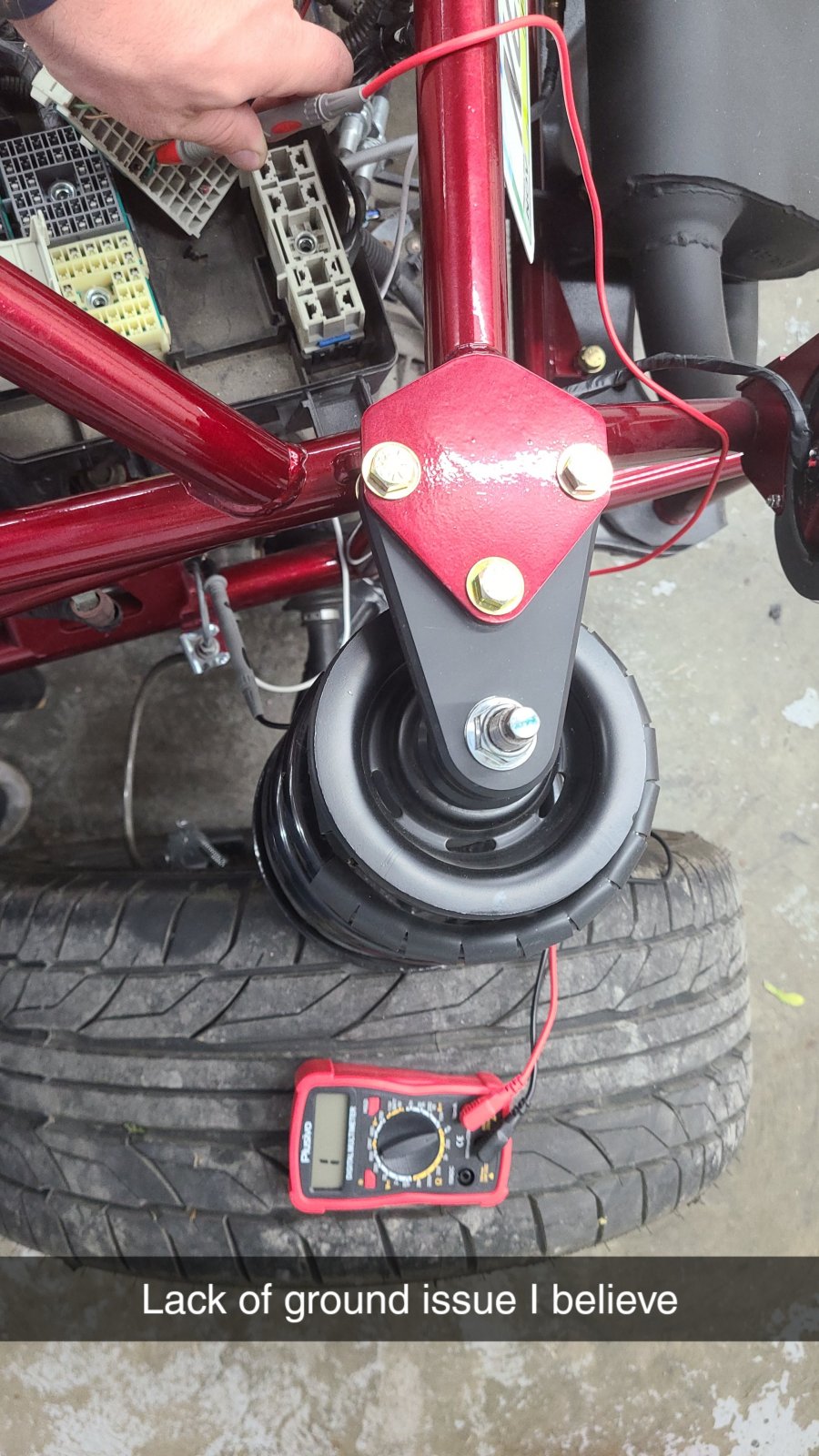

So the wire is good but I believe the ground is bad. The ground under the fuse block seems solid

What I was referring to about the ground was when the fuse box was off and I had access to the b7 plug i tested to the rear ground post and I didn't have ground.
I installed the fuse box back on the plugs. I unwrapped the wires at the fuse box grabbed the white wire that goes to b7. I had grounding at the rear post.
Ran a jumper wire from my negative post on my battery and checked my rear ground and I'm grounded on the rear post under the fuse box.

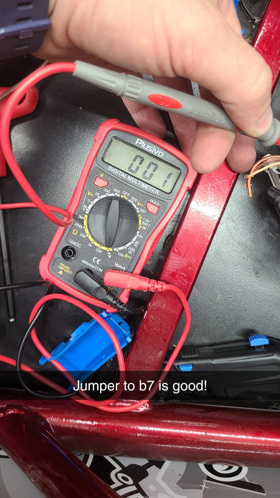

I then added a jumper wire to b7 plugged everything back in with lights on and I have ground at the rear post.
I also have continuity from b7 to the bcm x1-8.

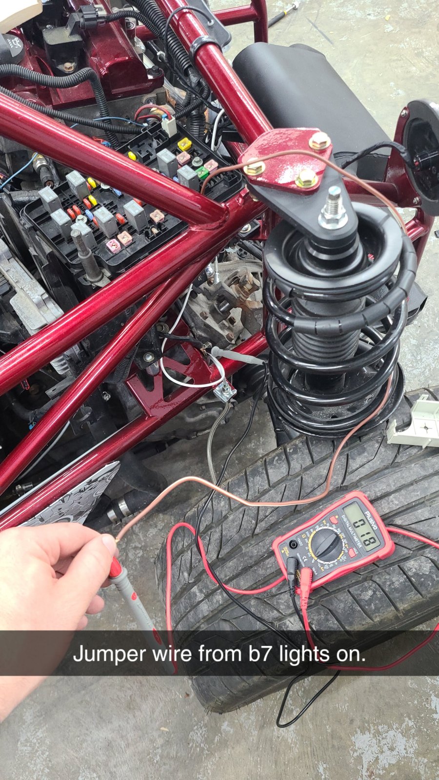

Yes this is b7 to ground. I also took the jumper wire right to ground and had no clicking noises snd my lights never turned on.

Next step is to see if you are getting any power to the park lamp fuse while grounding the B7 plug. If not we have it narrowed down to right at the fuse box. We will have to confirm that the B7 plug is actually making good contact to it’s mating terminal. But check for power at the fuse first.

B7 jumped to ground. No power at the 15amp park fuse
That leaves two choices.
1. B7 isn’t making good contact with it’s mating pin. Visually inspect both sides for damage. Pull b7 wire from the X connector and tighten it up with a small screwdriver.
2. internal to the fuse box printed circuit board. It’s possible to disassemble the box and check the board but it involves following the trace and applying power and ground directly to the relay pins. Doable but fiddly.
An option to fix it is to just install a relay some where using the white wire as the closing signal for the relay.
