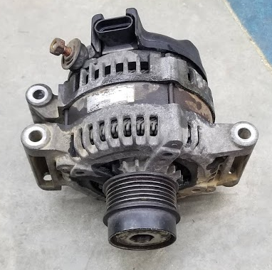

My LSJ just turned on the red battery light on the dash, and the alternator is making a squealing noise.
The used-auto-parts-yard have $27 alternators for the normal Cobalt, but don't have my SC LSJ engine's alternator.

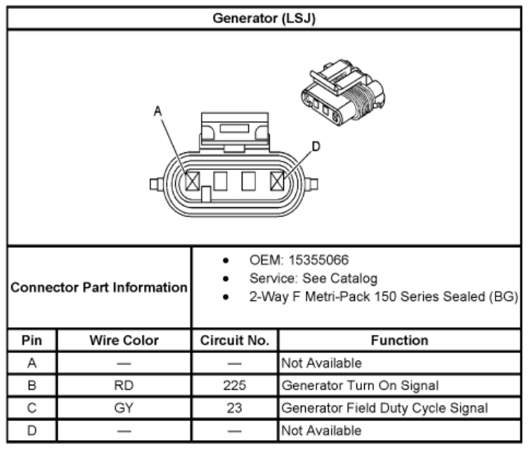

Looking at the form factor, the two alternators look the same, physically, but the LSJ one has a different electrical plug.

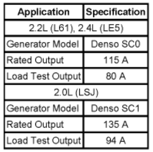

I am tempted to buy the basic alternator, and the normal Cobalt electrical plug, and solder it into my engine harness... I really don't need the rare 135A alternator. Will this work? I don't have the connector/electrical view for the normal Cobalt alternator.
Oh yeah, I need to keep the 6 rib pulley off the old alternator, as the basic one is a 5 rib pulley.
Thoughts?

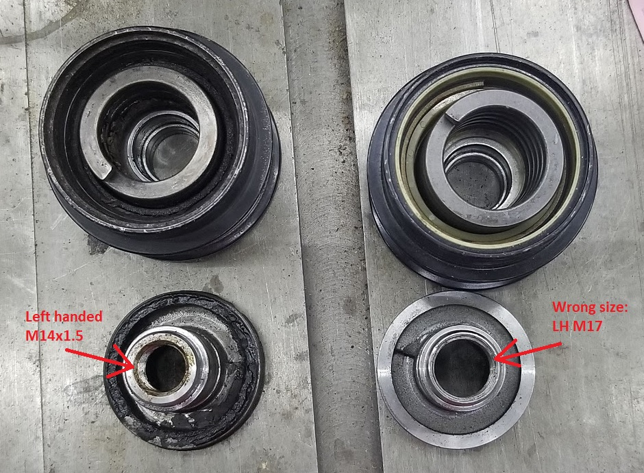

I ordered a new CONTINENTAL 49912 pulley, which is suppose to fit my 06 LSJ, but it didn't match the main thread.
18650

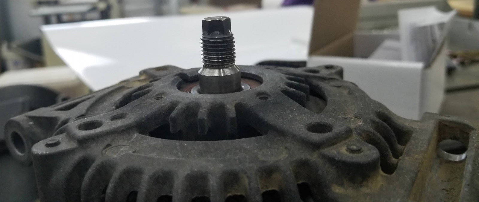

My LSJ alternator shaft starts as 17mm shaft, then tapers down to a left hand M14x1.5 thread.
The new pulley has same dimensions except the main thread is a LH M17 thread.
18653
Rock auto has other pulleys for my LSJ, but they don't mention the main thread in their specs. Not sure if my alternator shaft is unique, or if the suppliers have the threads wrong.

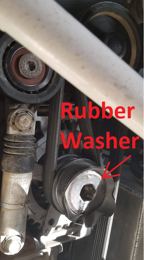

Well I turned my alternator overrun pulley into a regular pulley by making a rubber washer out of an old inner tube, then tightening on the left hand threaded outer nut with the 19mm allen head.
18831
Mickey mouse? MacGyver fix? Well, the alternator is working now.
Took it out for a test run yesterday, and discovered that I hadn't torqued the allen nut enough, and when I shifted into 2nd gear, it unthreaded.
Used the impact gun this time, and need to cut the rubber back a bit.
Update: Well that didn't work too well. The pulley unthreaded when I got off the throttle. I will try a Gates override pulley and hope that their pulley works better than the Continental pulley, which didn't fit.

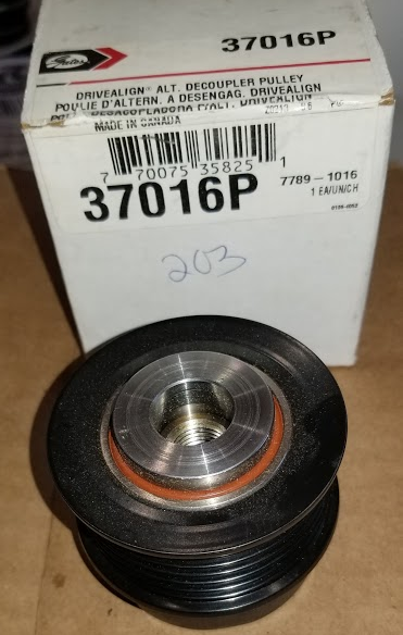

The Gates alternator pulley has the M14x1.5 left hand thread that my LSJ alternator has!
19048
So the proper fix is now installed. It was $85 for just the pulley! For $20 more I could have bought a rebuilt one... just didn't trust it would be as good of quality as my current alternator. My mickey mouse rubber tube fix didn't last very long, and it unthreaded.
