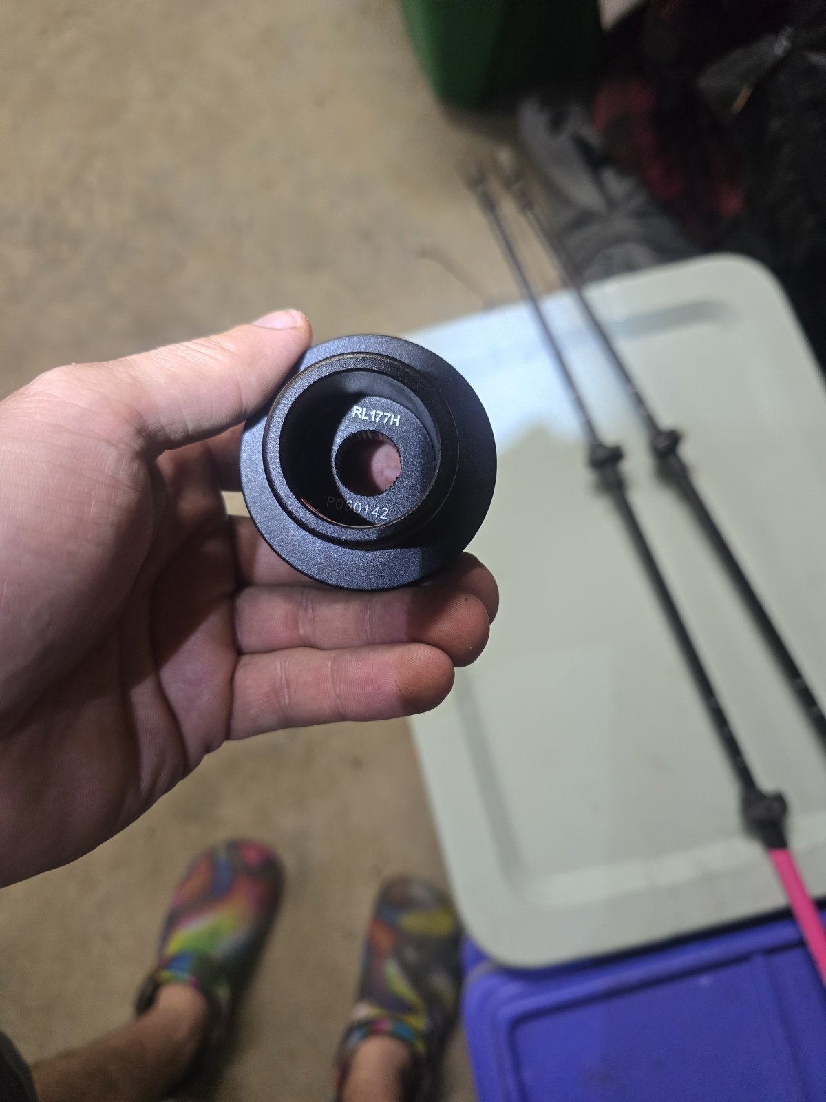

I am so confused with what's going on here.
I read people say to order the Cobalt HUB adapter which is the SRK-177H. https://getnrg.com/products/srk-177h
So I did.
It is so far from fitting it doesn't even make sense. The cobalt shaft is a GM 36 spline. The DF Goblin has a 23 spline. How are people on here saying this is the correct HUB adapter, I've seen quite a few people recommend that part number.
So I did.

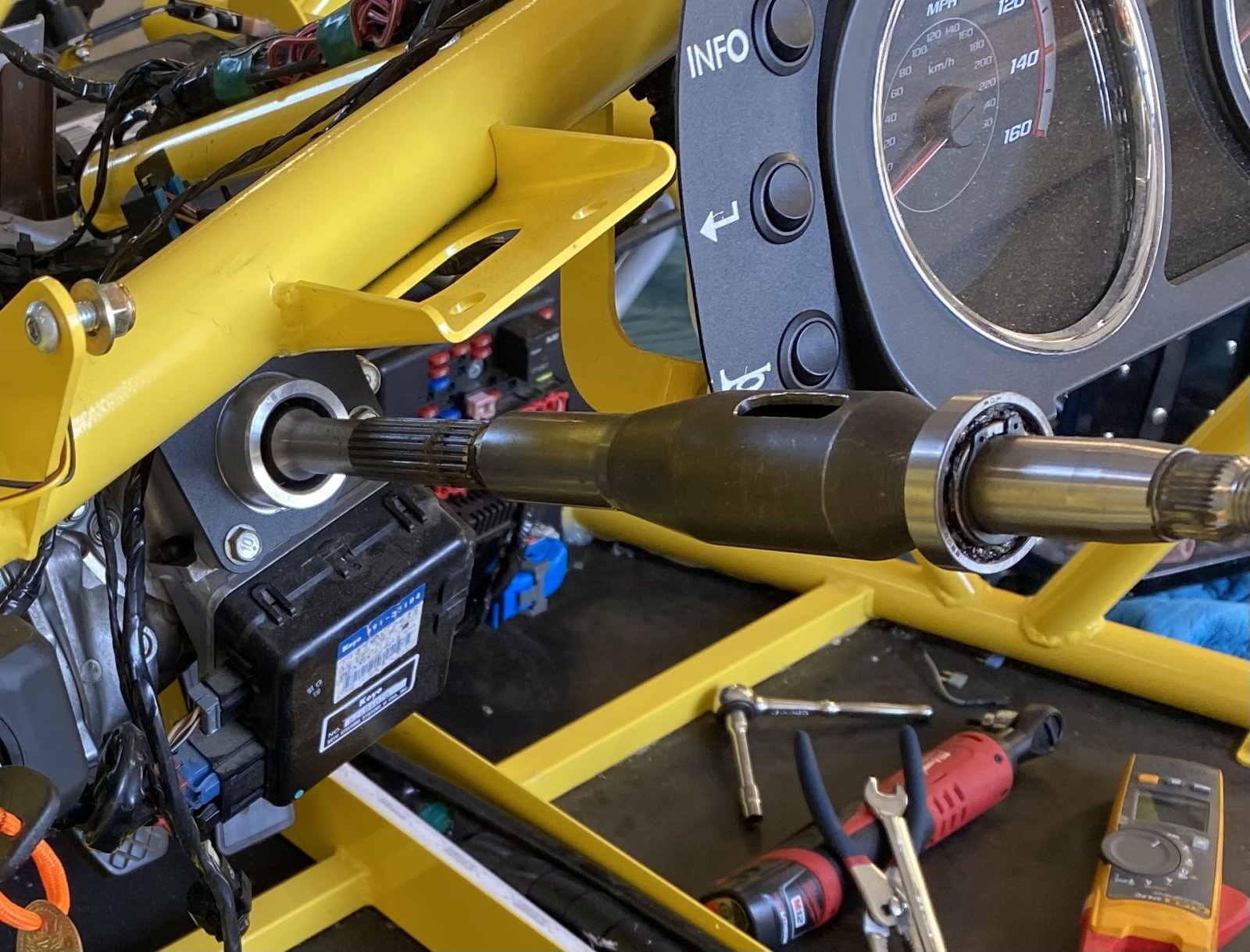

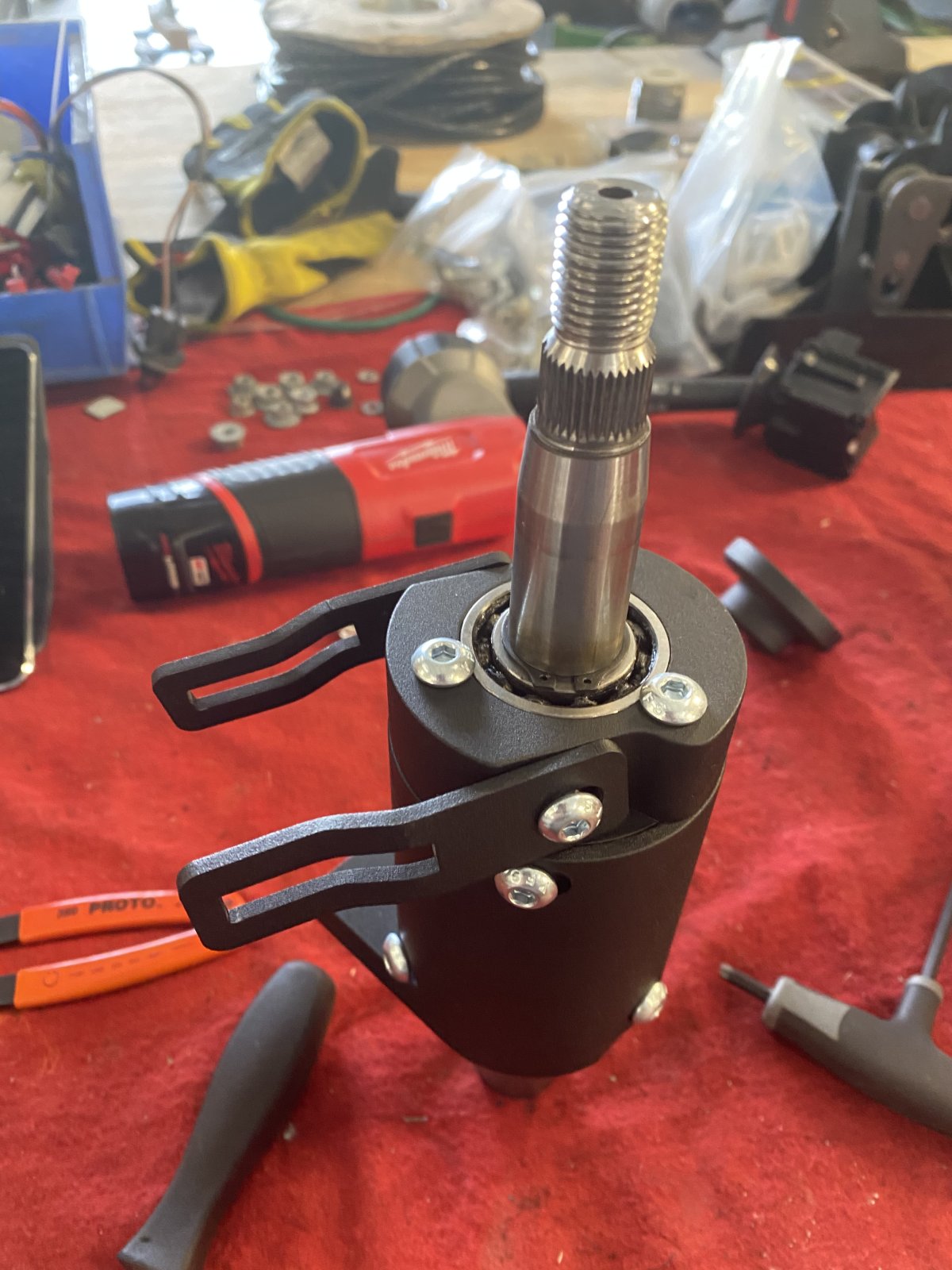

Are you talking about the Longacre steering wheel and the 3 hole adapter? This is 36 splines to mate to the Cobalt immediate steering shaft that is removed from the donor steering column assembly (tilt mechanism). It is assembled into the DF supplied aluminum steering adapter (looks like a thick aluminum soda can - in size) which is mounted between the steering wheel and the electric steering box. The steering shaft that comes out of the steering box has 23 splines and the immediate steering shaft mates to this shaft. Sounds like you are trying mount the steering wheel directly to the electric steering box?

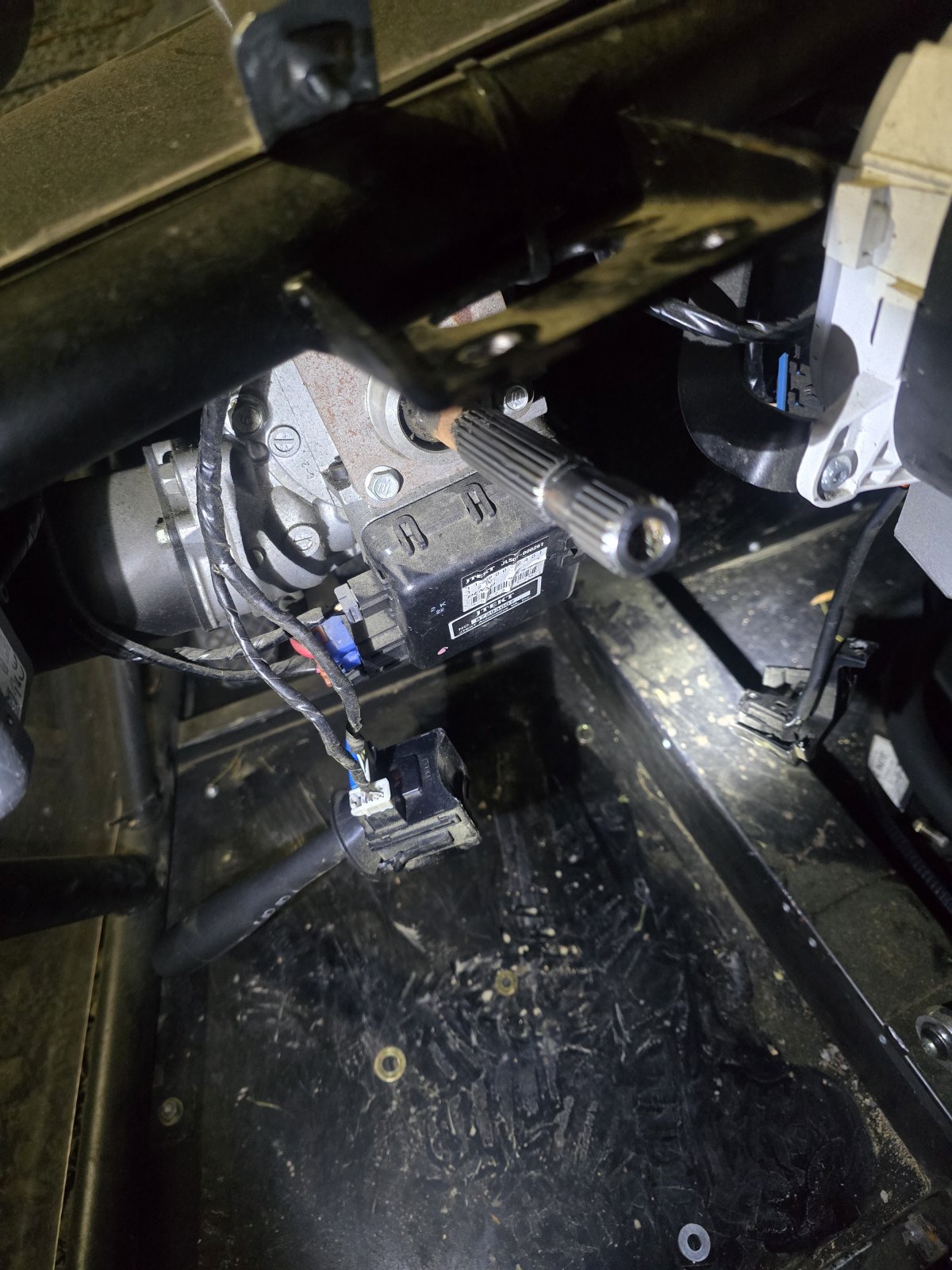

The cobalt NRG is a 36 splines. The shaft coming out of my steering rack is 23.
Its also a different diameter even.
Like it can't be further off.

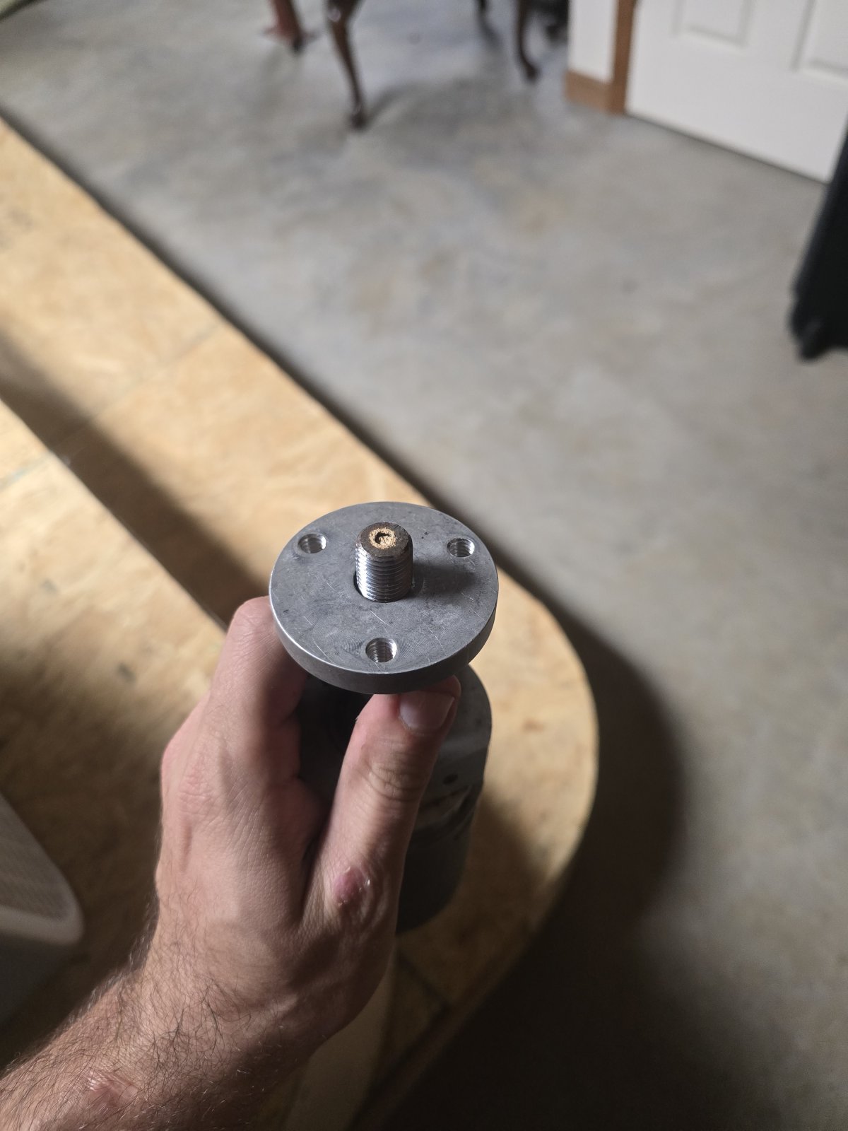

My aluminum soda can thing has a threaded nut on it and no splines

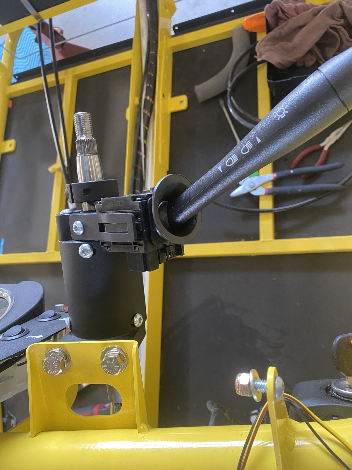

Although the wheel is a little close for my taste, putting it on the power steering unit would make it very far, plus you won’t have turn signals and such.
Yeah. I am okay with losing the turn signal lever. I already hit it with my hands and don't like it as is.
I mocked it up today and closer to the dash is better for me with my fixed seats and short legs.
I really really hate how close it is to my chest right now and making it even closer with an adapter isnt going to make me happy
Not trying to be mean in any way, but it looks like you are on your own for a solution with whatever adaptor you will need to make. Maybe scope out a hub from another vehicle with the correct splines you need. This is a critical component, it will need to be “correct” for your safety.
I wish I knew what other vehicle accepted these splines. But that information is like hunting for a unicorn.
I'm going to cut the soda can thing off. Use those splines. Use my CMC plasma cutter to cut a standard 6x70mm flange with a transition fit over the OD of the soda can section I'm re using and will weld it on. Slip the flange back over and weld that on.
It'll be more stout than the factory one.
I've made several steering shafts and hubs from scratch on rat rod builds I've done. I'm not worried about it
