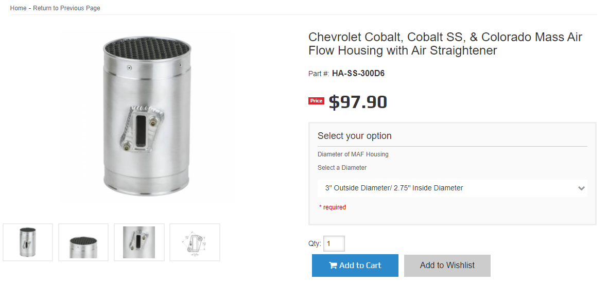

Anyone have a link to a quality honeycomb air straightener?
I ordered this one. It has a nice pressure fit into the MAF tube.How are you all doing! Here we are with another 75 deg day in KC is this December or May!??!

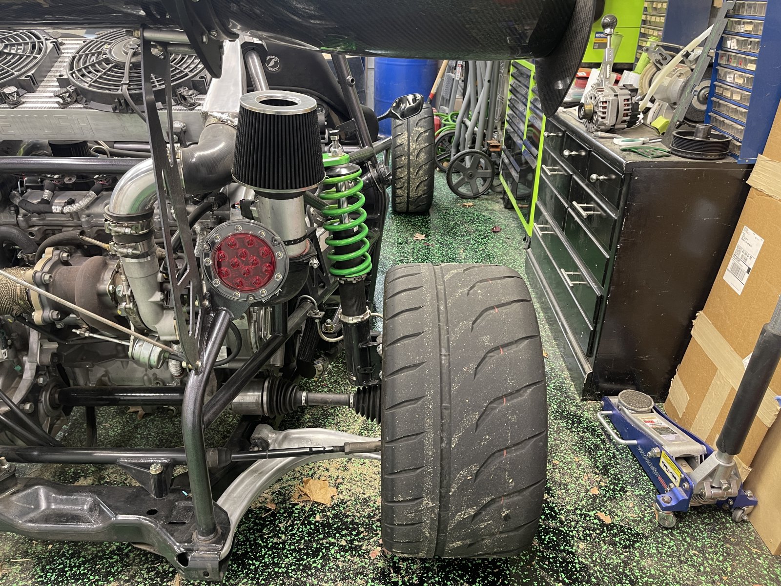

So long story short, I've noticed for a while now that while im on the highway and behind say a semi truck with the strong air currents coming off I get just little micro cut outs on the engine when your not in boost, Basically just steady throttle.
Today the wind is gusting 30-65mph so I did a little test to confirm my suspicions, I let it idle to temp inside the garage idle was solid no blips nothing.
I back out into the wind gusts and boom everytime it gusts the engine cuts out for a split second over and over. Pull it back in idle is fine.
So I think i'm having the same issue I think maybe @ctuinstra was seeing with the MAF reading crazy air. Which is actually a relief because I was hoping it was not some other crazy issue. I'm going to buy one of those expensive honeycomb inserts for the intake and see if that will help smooth out the air a bit and test more. Although testing might not be until winter is over at this point
Thanks!

You have enough straight pipe before the MAF to help straighten out the air.I have been following your posts with interest.
I wonder why I have not had similar issues?

Your MAF is too close to your turbo. It probably doesn't have anything to do with the wind effect but when the turbo spools up it will send some unwanted feed back to your MAF.How are you all doing! Here we are with another 75 deg day in KC is this December or May!??!
