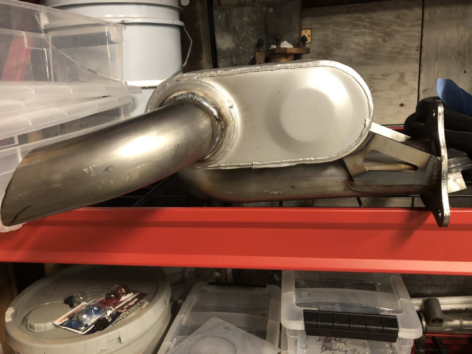

On my donor car there were two O2 sensors. One in the exhaust manifold and one in the downpipe. My new header has a port for one 02 sensor but the pipe and muffler DF sent doesn’t have a hole for an O2 sensor. Is this something I need to weld in or do I not use the second O2 sensor?
The 2nd O2 sensor monitors the efficiency of the CAT.
Since there is no CAT, no need for the 2nd O2 sensor.
