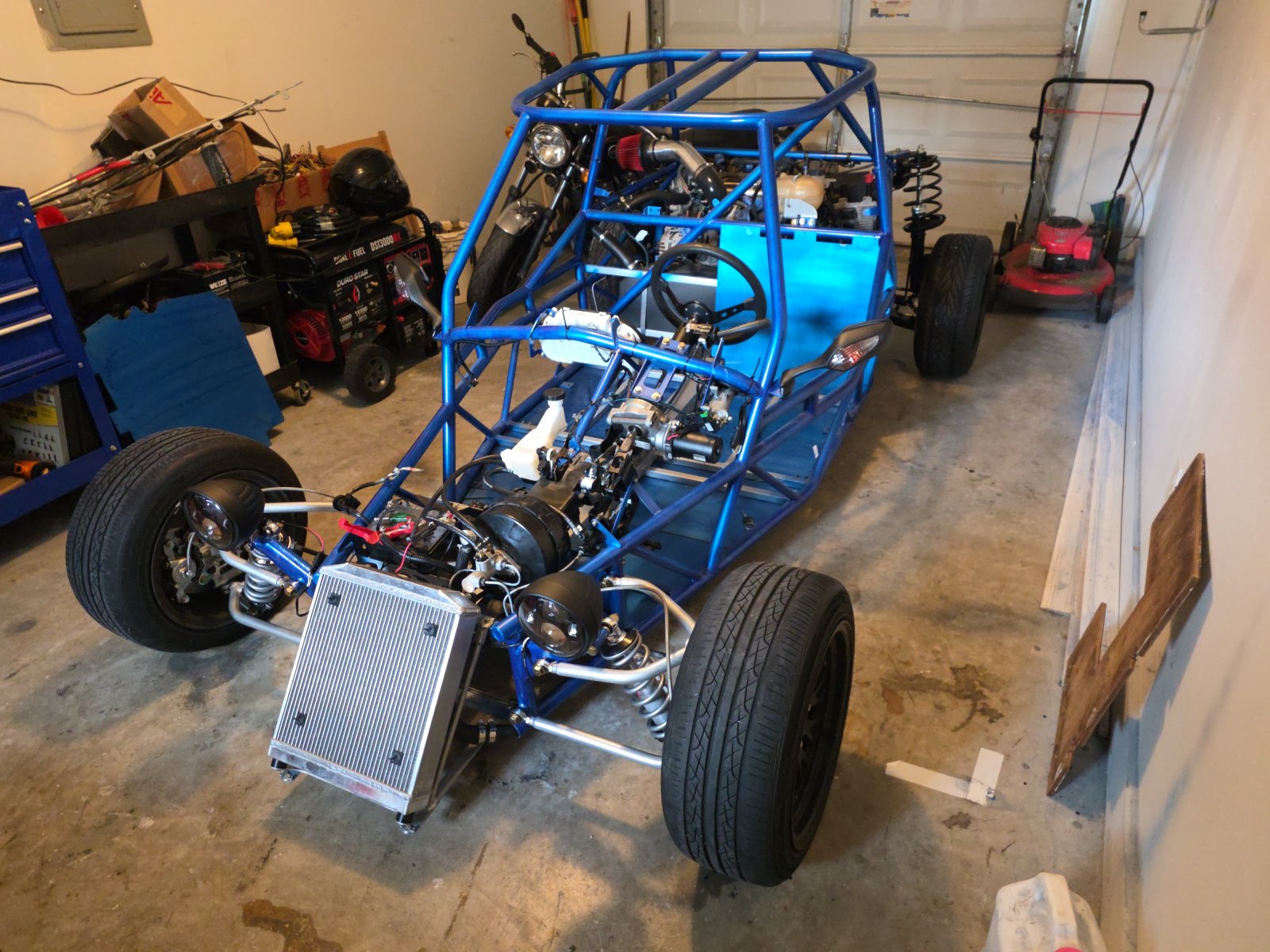

My Goblin is finally off the jack stands and in to the driveway; but I need some help and/or advice.
Kit#499
2010 Cobalt XFE(?)
2.2L F23

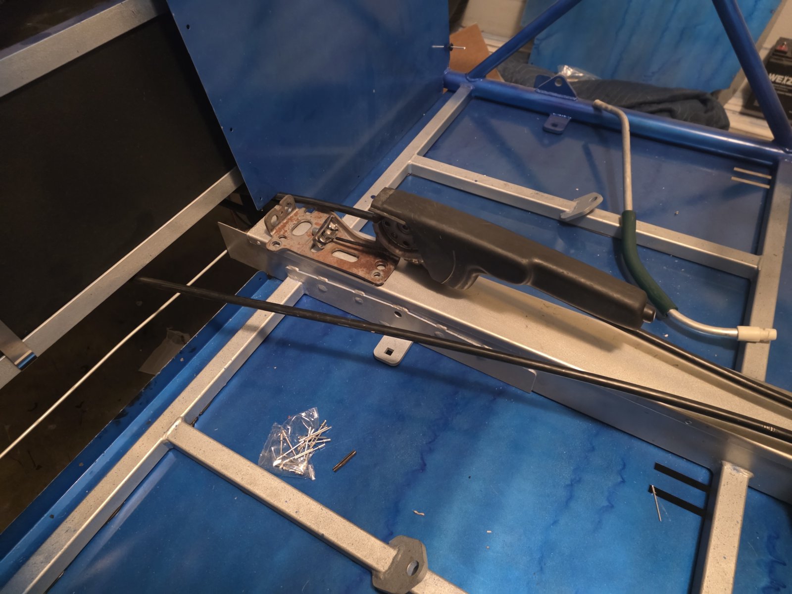

How were you guys mounting the parking brake lever to the tunnel cap?
I was considering using rivnuts.
Did you guys have to use the SS parking brake cables intended for calipers?
My donor had drums. I was considering cutting the cable and using a stop.

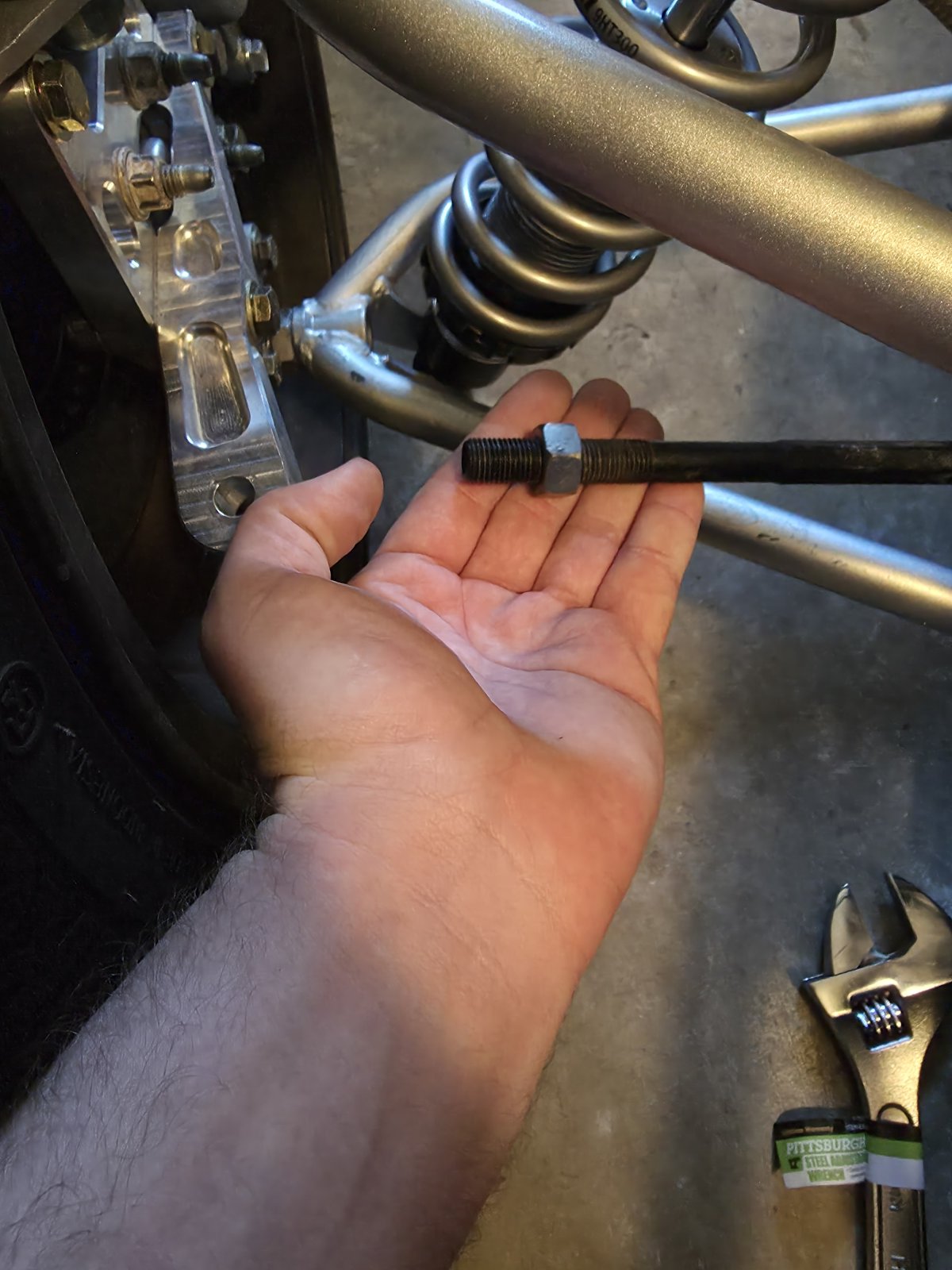

How did you guys pull the toe out of the front?
I've got it.. close.. but its really close to the end of the inner, and its still slightly.. visually toed out.

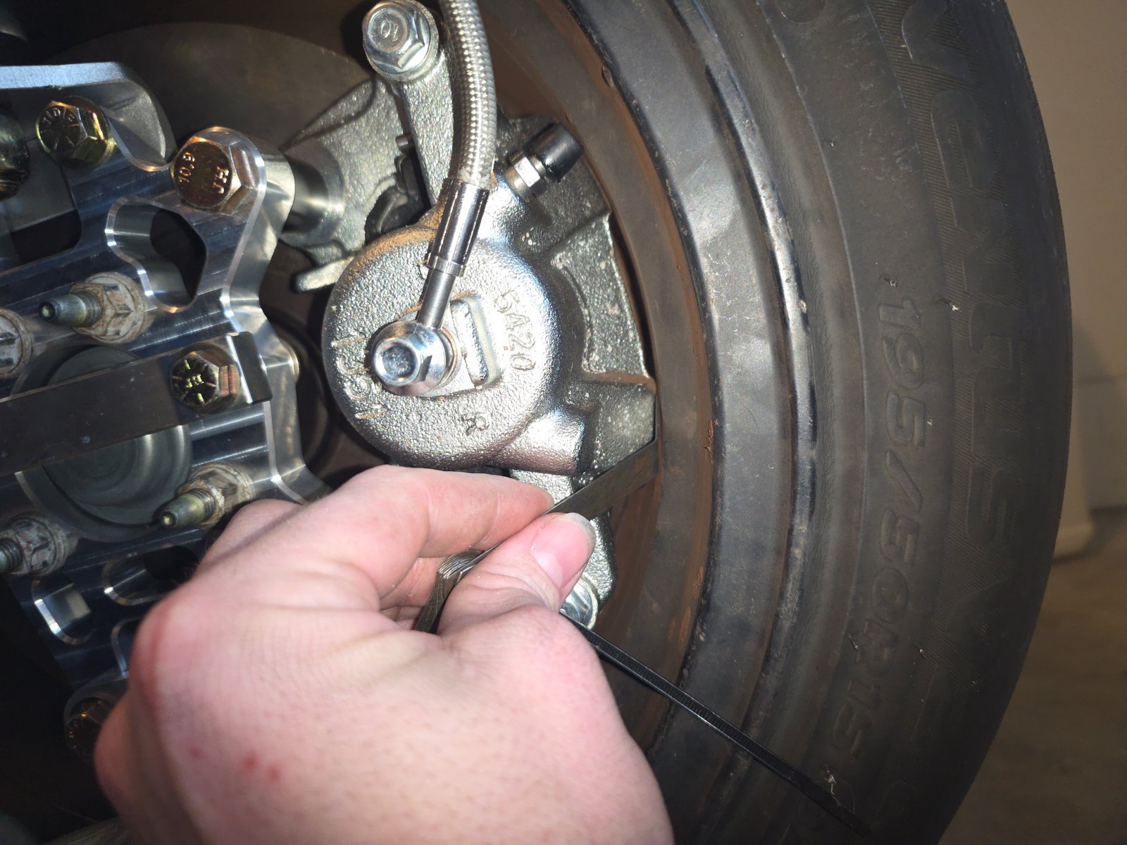

I've attached a picture of my Goblin and also a picture of me checking the caliper lash.

I think I just used bolt and lock nuts to mount the park brake lever. Rivnuts would work fine too.
you can buy park brake cables for a SS cobalt. hopefully you saved the park brake cable tubes coming off the lever.
need pics of the front end. You may have something out of place. In your parts stash, the new outer tie rods provided by Df go on the front and the stock cobalt outer tie rods get moved to the rear.

I ended up ordering the universal brake cable. It just seems like the easiest way to route and adjust the slack.
I did indeed keep the tubes, but thought I would break them while bending.
Upon further inspection of the front tie rods I've found that there is ample room to adjust out.
I was just worried for nothing. They are indeed the kit-supplied outers.

There shouldn’t be any bending of those tubes for the park brake cable. Not that I can remember.
i have NRG seats that came with sliders that I mounted to the Planted bracket. I have reclining seats, but I also have the short chassis, so I’m all the way back on the slider and no room to actually recline. I would assume the longer chassis you could recline if need be.
I ended up bending the parking brake tubes, and yes they eventually broke.
