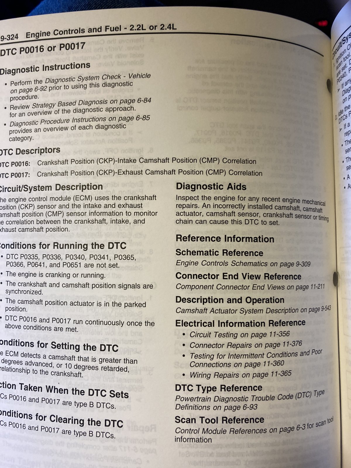

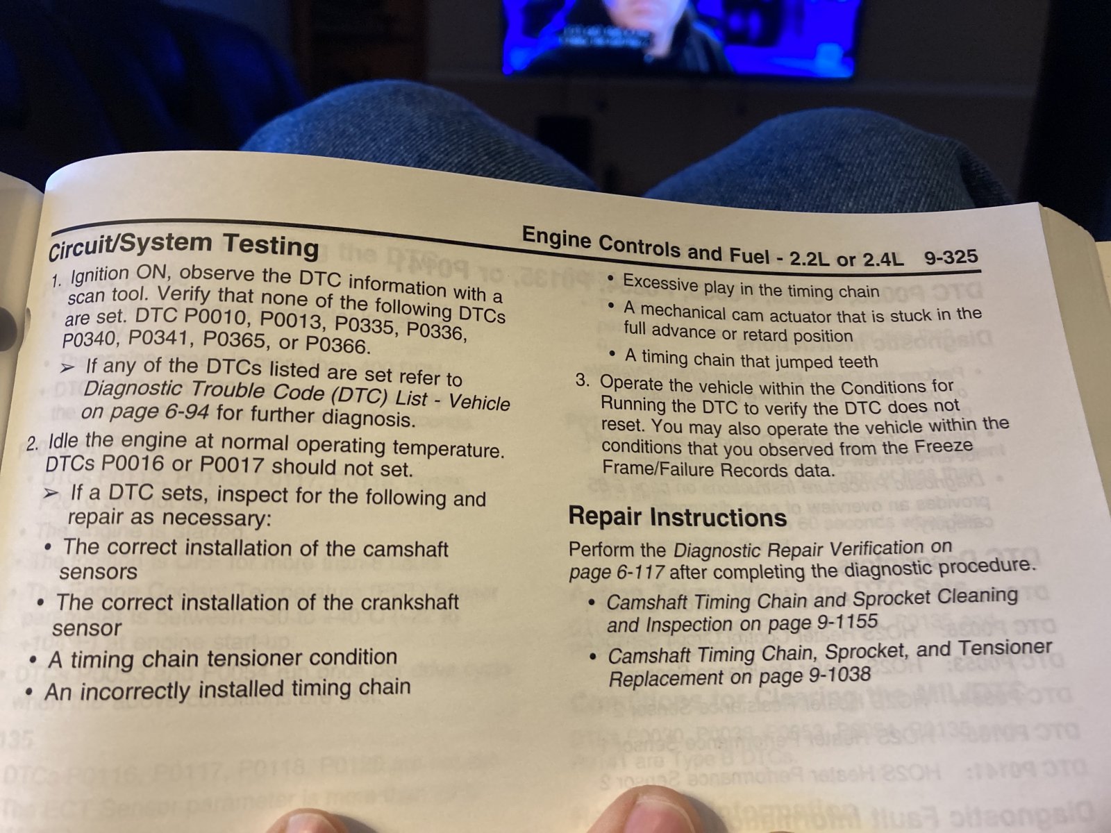

Probably not much help but
Chris_WNC
It does help. I'm going to check the cam actuators tomorrow. I've checked and double checked everything but those.
Which manual is that? I should probably try to track one down.
Factory service manual. They aren’t cheap but worth their weight in gold at times. I bought the 3 volume set on eBay. They are also available from Helms.com
I think the same info is available from alldata.com.
