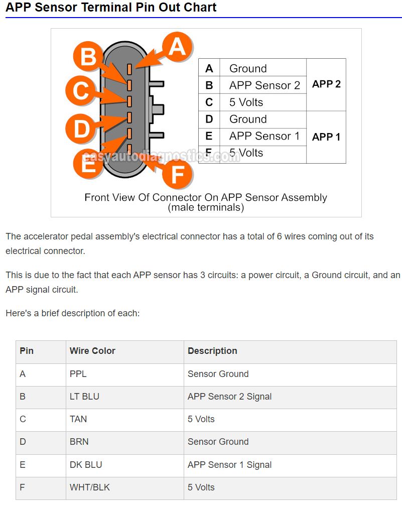

APP Jumper Harness. It connects the wiring harness to the Accelerator Pedal. I assume the wring was generic between Cobalts (and other GM models) as was the ACC Pedal. Then, all the needed was a 'jumper harness' to correct the wiring outputs. Everything basically makes an X to the other side. These were used in at least LSJ vehicles, do the other models not require this?
Mine may have this, I don't remember. It can only help to remove it, if you get the wiring correct, and make the connections correctly.
It seems other models do not have the jumper harness. Mine as a SS/NA was straight to the wire harness. Have you checked the jumper for wiring issues?

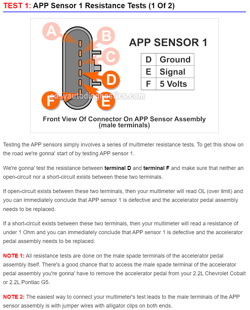

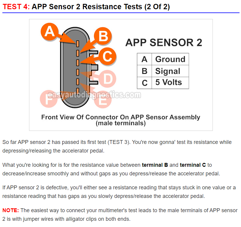

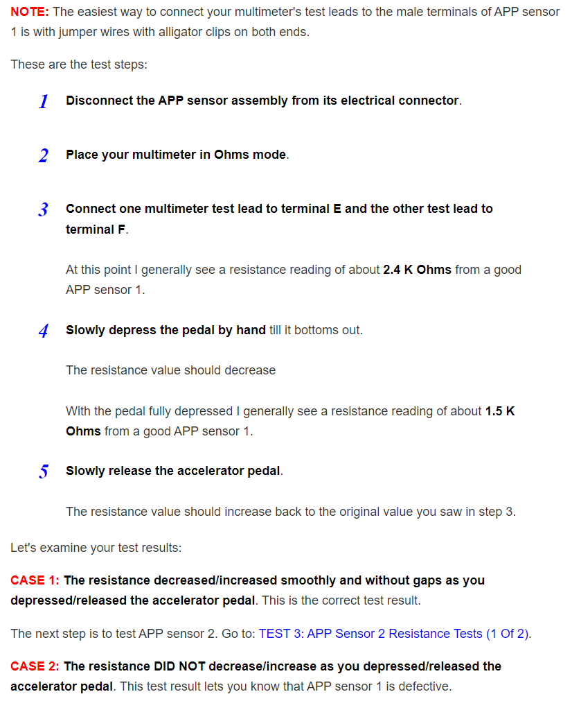

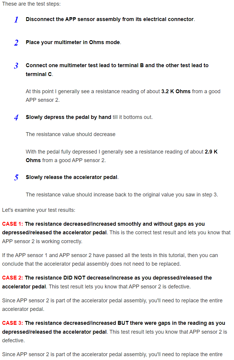

My values were slightly different, but consistent with the article. Since I have already replaced the pedal with no effect, I didn't really suspect the pedal was the problem anyway. Good article though.

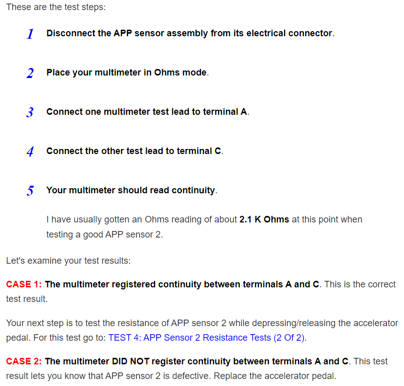

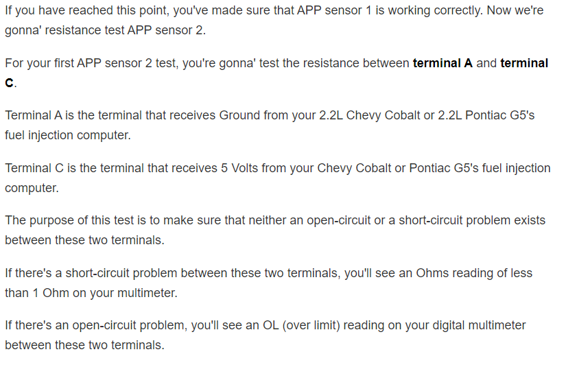

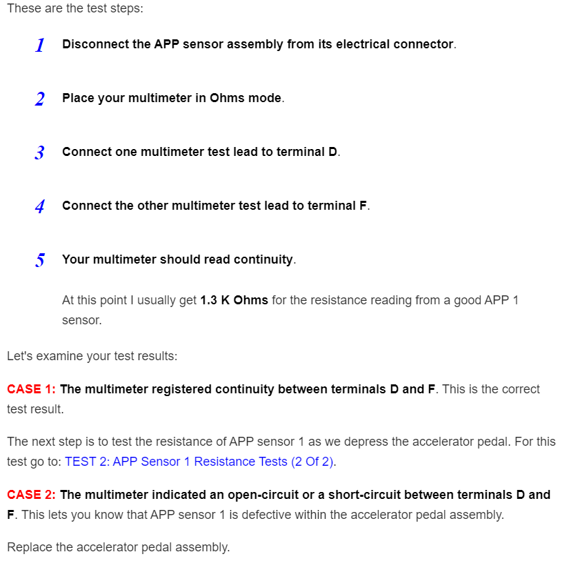

While the basic functions and test steps are probably the same from the 2.2 to the SC, the actual values given in the test may be different. I can’t actually get rid of the pop ups enough on my phone to actually read it.
Joebob
Sterilized for phone reading:
39648
39649
39650
39651
39652
39653
39654
39655
39656
39657

Joebob, can that pedal test be performed with the pedal out of the vehicle? It’d be a lot easier on a bench rather than in the Goblin.
Edit: just answered my own question by testing my old APP assembly on the bench.
Answer is yes, you can…. My old unit passes the test. Time to pull my new one from the car.
Edit 2: my new unit passes as well but I get closer to the description numbers with the old unit. Going to try this one moving forward.
C
Yes, that's how I did it just now. Your probing the connector on the pedal itself, so you have to disconnect the connector anyway. Might as well pull it out of the vehicle. It's pretty easy to do on the bench.
The service manual for the later models has a different test procedure for the 2.2 & 2.4.
In addition the P2138 is an indicator of high resistance in one of the APP circuits.

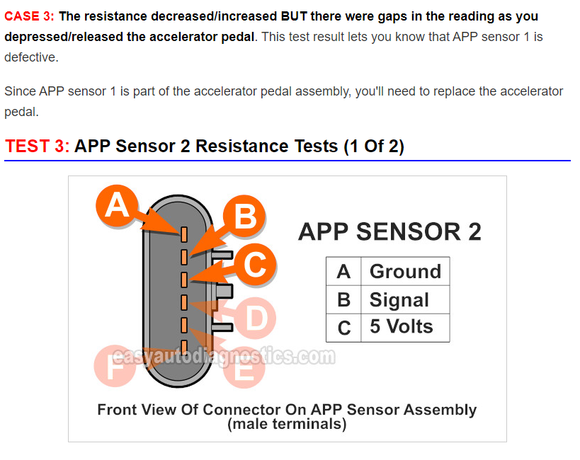

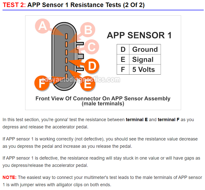

Yes, because of your Jumper connector, your pin outs will be different, but I could not find an LSJ procedure. Maybe with the jumper attached it would line up.
Like for me in the past and others have checke, it has not been the pedal assembly that is causing the issue but the modified wiring or connectors.

My Values from the bench testing:
New APP Unit (static/pedal pressed)
Test #1: 1.51 / X
Test #2: 2.35 / 1.62
Test #3: 2.23 / X
Test #4: 2.94 / 2.73
Old APP Unit (static/Pedal pressed)
Test #1: 1.48 / X
Test #2: 2.69 / 1.74
Test #3: 2.16 / X
Test #4: 3.10 / 2.82
Part numbers do seem to cross reference for APP for all models except TC. So I think the procedure I posted above will likely work for all models other than the TC. You still might have to determine the correct terminals. This is probably why the SC has the jumper harness.
I tested right to the APP terminal, not through the jumper harness. The output on the APP should be standard across, right? Then the jumper makes the wiring from the ECU work out properly. Unless I'm thinking this all wrong. I thinking out loud here, so if any of this is wrong then let me know.
I could check part numbers across a few different early models to see if they are the same...... Edit: you already did that.
Does the newer model with the potentiometer sensors still have the 6-pin connectors on the APP? Is that only used on the TC models?
