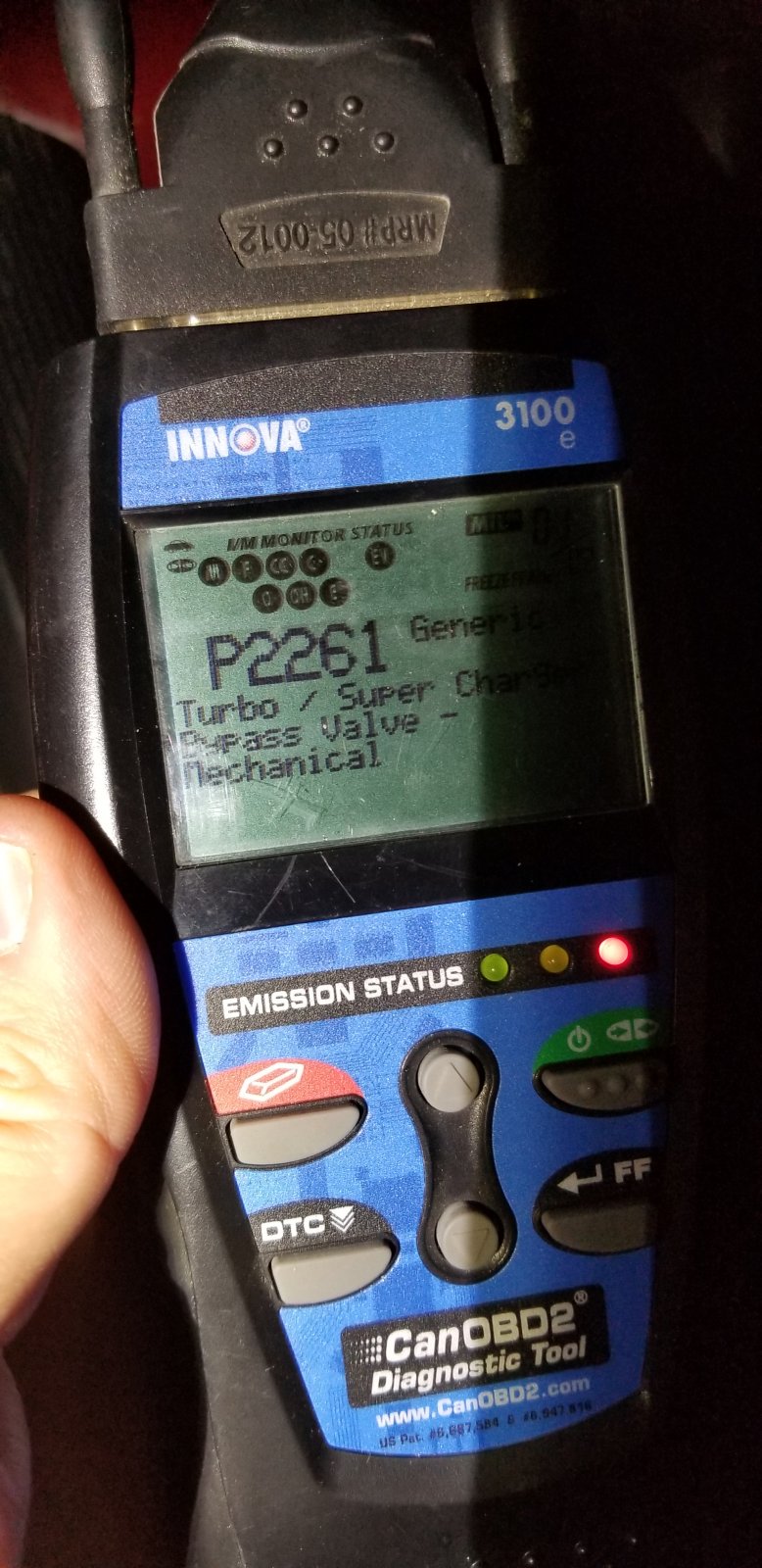

So I'm new to the turbo world. I've been working some bugs out of my 2010 cobalt ss. I've had to replace the transmission, and opt'd to pick up a zzp complete motor during black friday. Anyways, everything is back on the car and I've driven the car about 200 miles. I'm getting this p2261 code now. I thought maybe it was a soft code, so I cleared the code and it comes back on after a few miles. Can any LNF guys help me out with this. I swapped everything over so I'm capable for repairing it, if I know what to go after. Thanks View attachment 6857
I would check all of your vacuum lines and the solenoid on top of the intake manifold. The solenoid should have three lines connected to it. I believe one connects to engine vacuum, one that goes to the physical bypass valve on the turbo, and one that goes to the throttle body pipe right next to the pressure/temp sensor.
I might not be 100% correct on where they all run. I'm trying to visualize my engine while sitting here at work.
Amack1970
Briann1177 you are correct about the intake lines. One goes into the pass. side of the turbo to the intake solenoid. The other two lines go down below the fuel injectors to a vacuum canister. I was just feeling around on the canister and found one of the lines came loose from the canister. I've plugged it back in, but I wonder if a hose clamp or fastener should be on that line?
