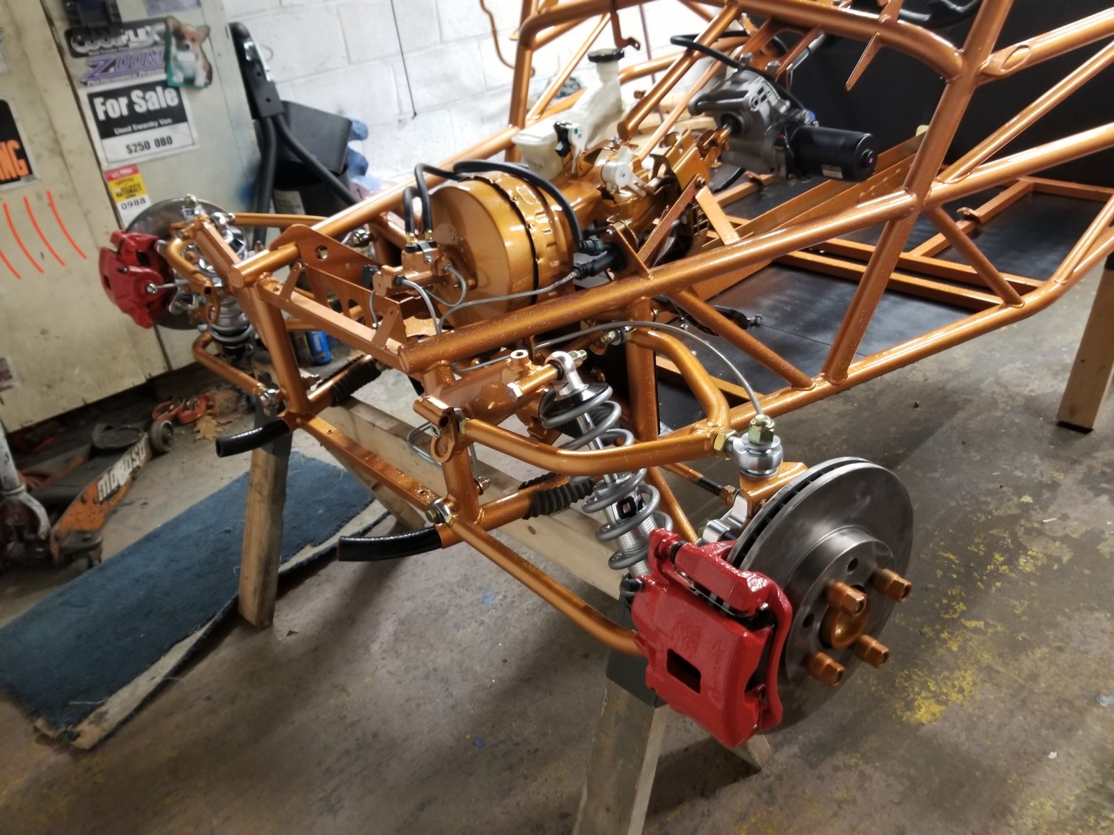

Thanks for the information! I'm assuming you mean washers on each side of each of the front suspension heim ends....
