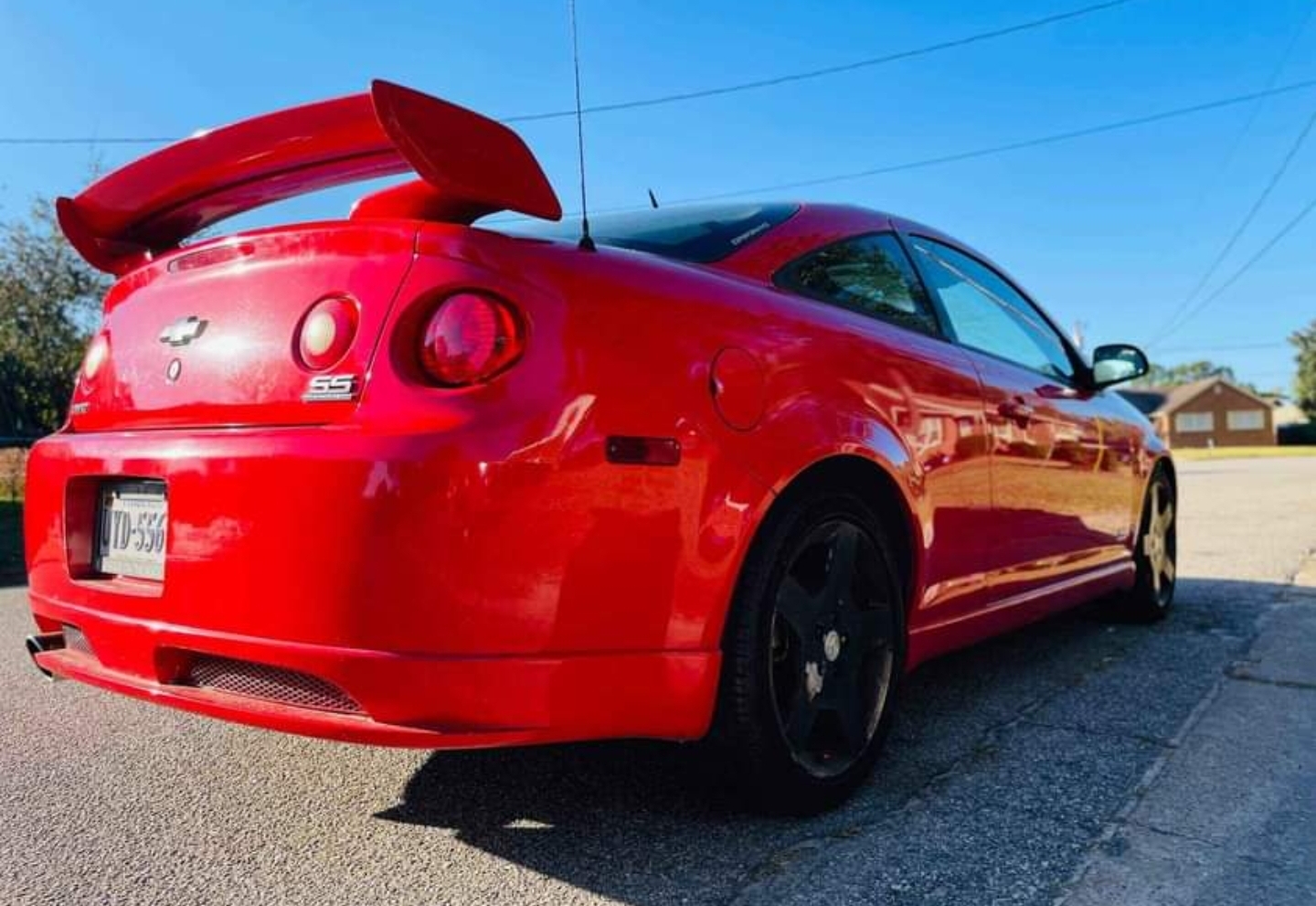

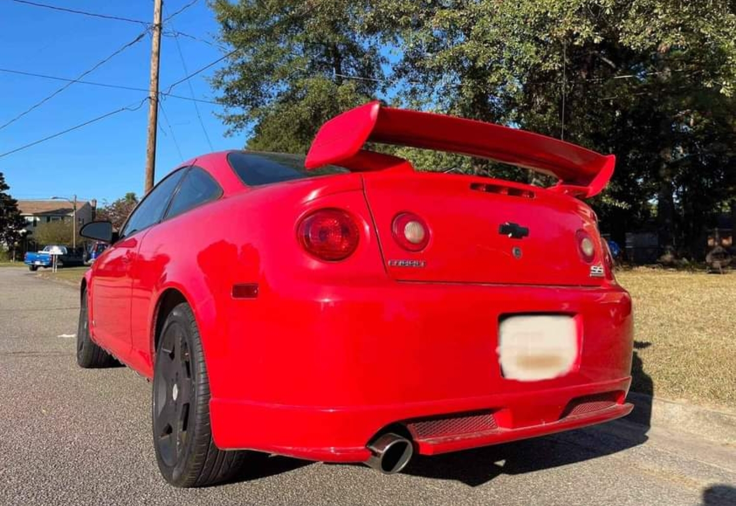

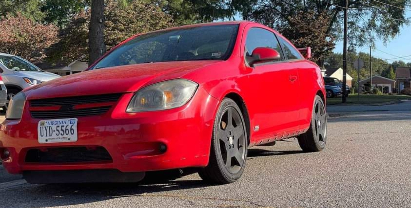

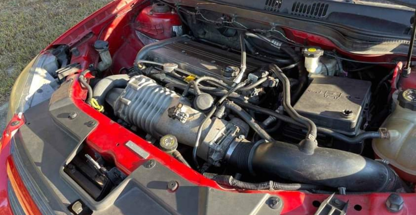

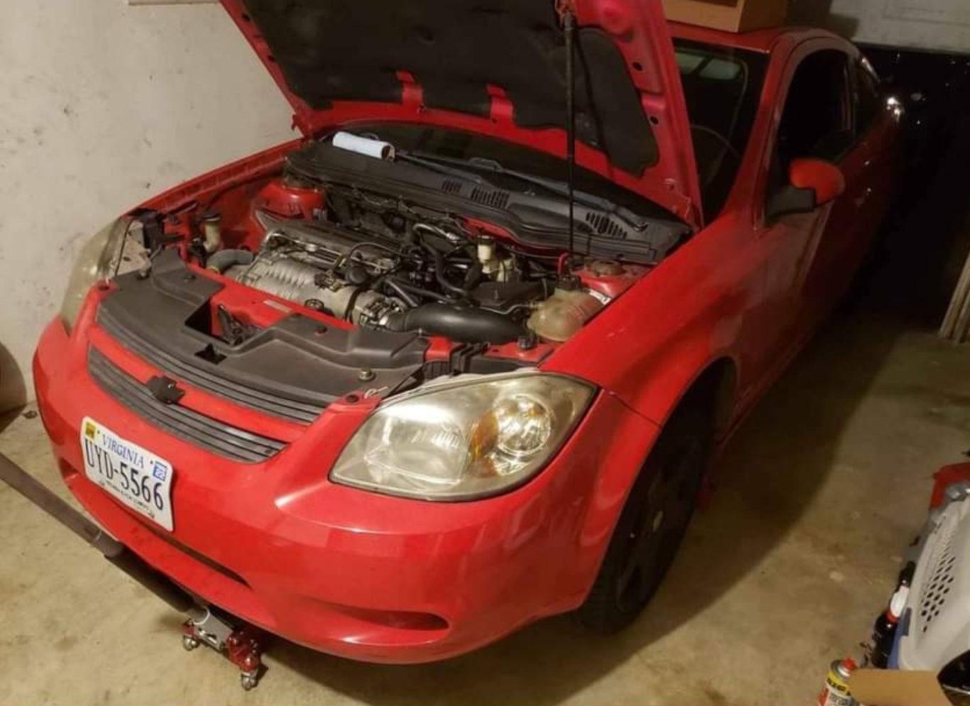

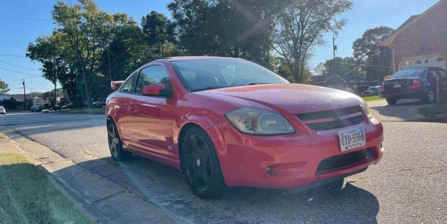

For viewing purposes. The $900 '06 SS/SC donor

That donor looks to be ideal, how many miles on it? There are several builders who have done the turbo swap onto the LSJ, seems relatively straightforward. The SC kit would be the choice if starting with the SC donor. :)

It's got 121k on it. Didn't run when my girlfriend picked it up. She loaded it on the trailer herself (since I've been gone). She also found out the fuel pump wasn't kicking on when the key was turned. Swapped the relay and the LSJ fired right up.

This one just happened to show up on Facebook marketplace about 3 weeks after I left so the girlfriend jumped on it.
