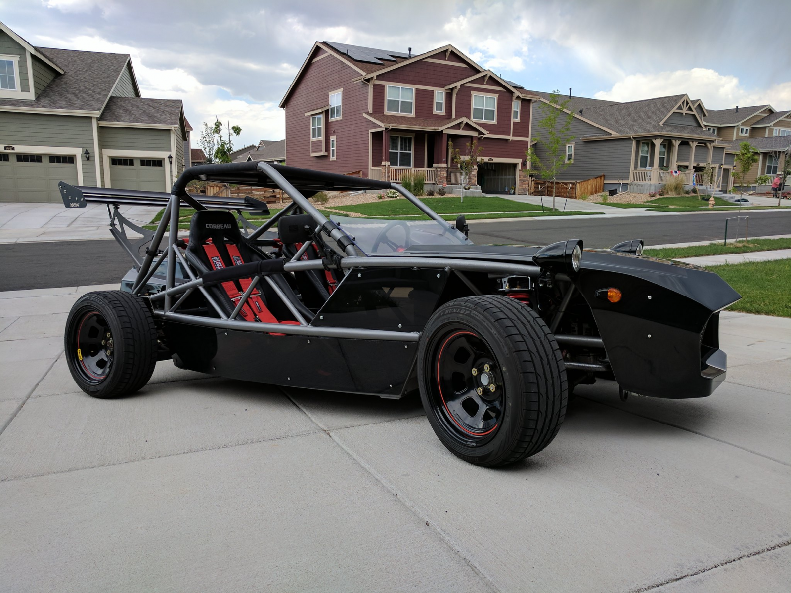

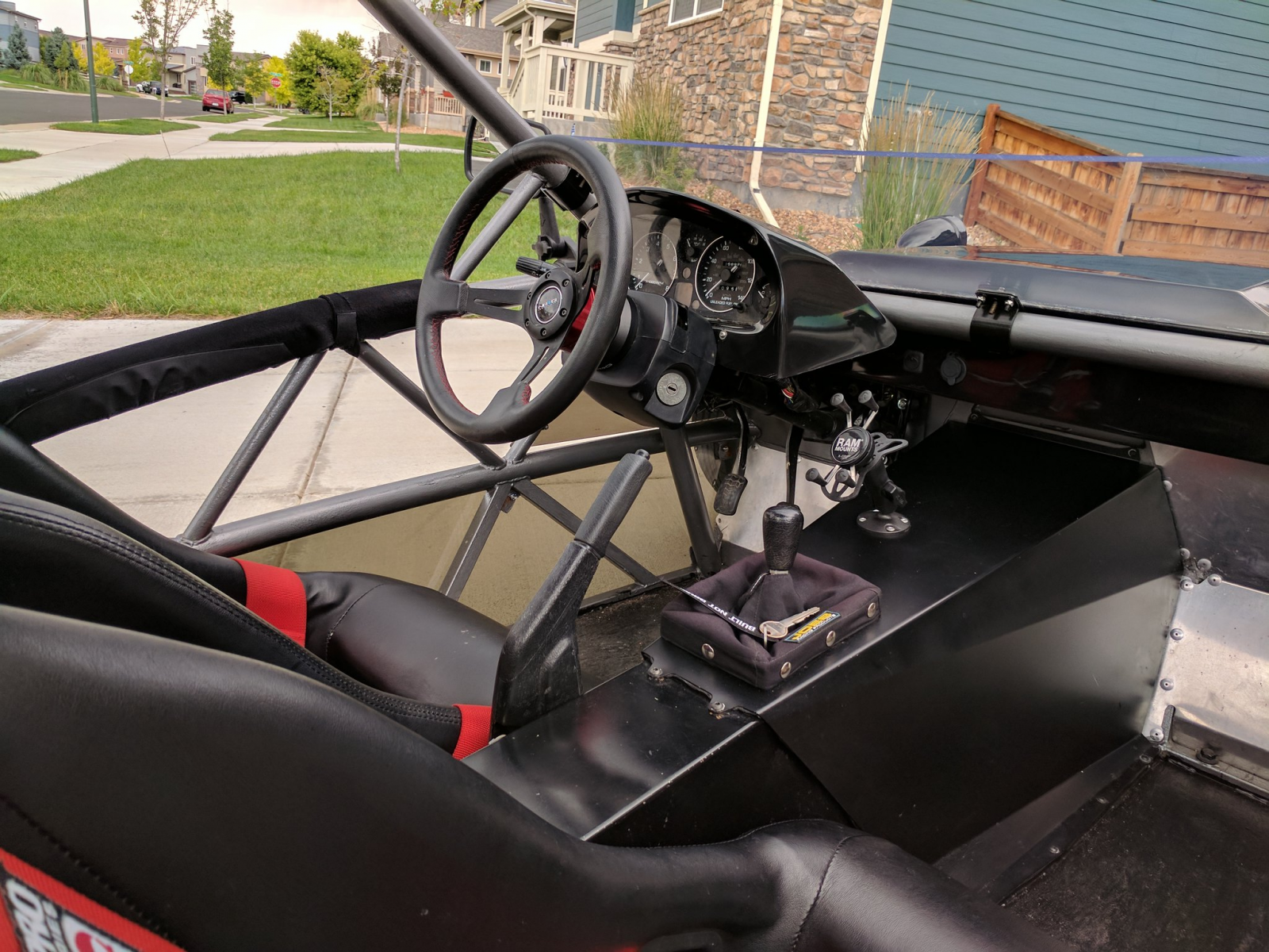

Having lexan side panels are what I plan on working on when I get my kit. I like the idea of the protection but also the open feeling. I haven't worked on it too much as I don't have my kit yet but will start taking measurements and seeing possibility in the coming weeks. here is my inspiration. Forgive me that it is not a Goblin.

Still Love that Look! this is exactly what i was envisioning!
I am guessing that you too welded tabs on to secure it??
edit: I am going for it... but I dont have any welding skills nor a welder on hand, going to fabricate a way to simply clasp onto the frame without any tabs... this ought to be fun

Going to try to pick up my frame tomorrow. My original idea was to have the lexan on the inside, but I know all the support is not level there as well as interference around belt mounts. Second option is to do like DF as a longer strip on the outside. Lexan is bendable to a degree and will practice prior to the final piece. Still looking at mounting options be it tube clamps, to weld tab, to rivnuts with grommet and oversized holes to reduce stress cracks.

You don't need to weld tabs if you don't want too. The DF side panels are secured with rivets, and you could easily put rivnuts in if you want to make the polycarbonate easily replaceable. Long as you don't drill into the bottom frame tubes, you can secure the side panels.
