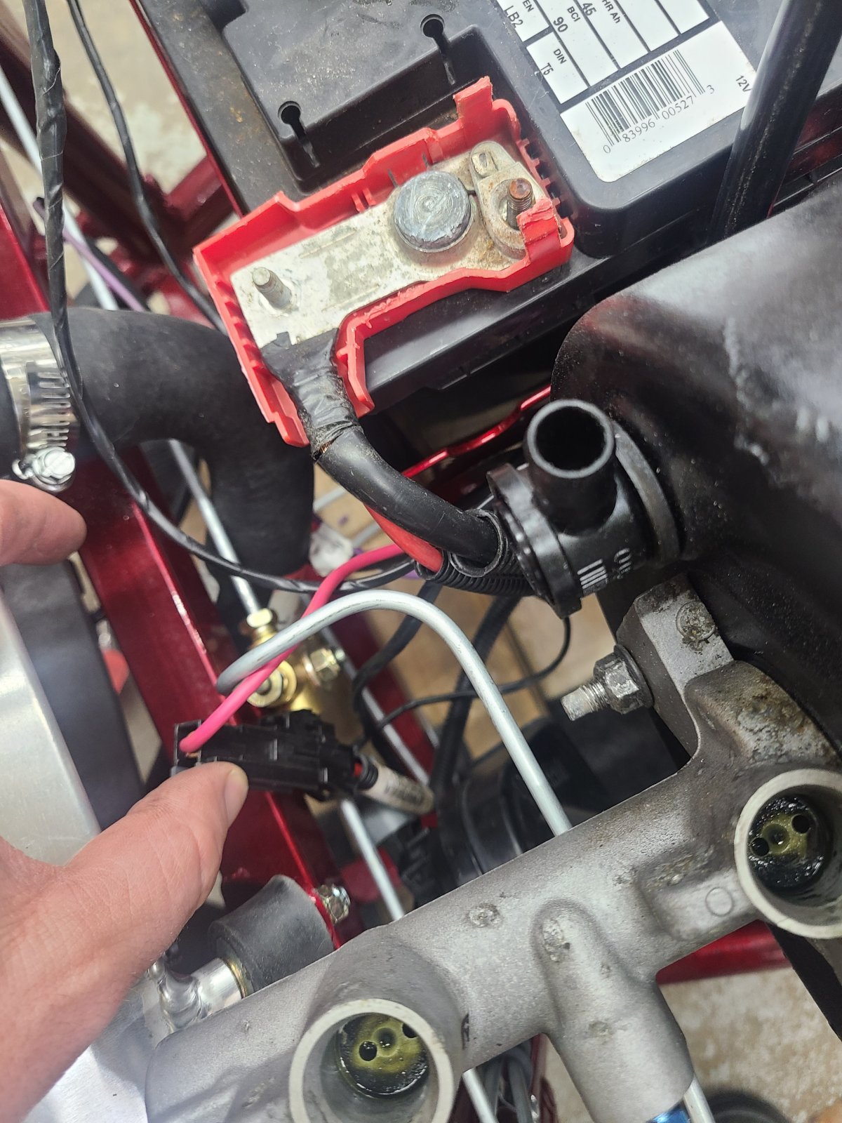

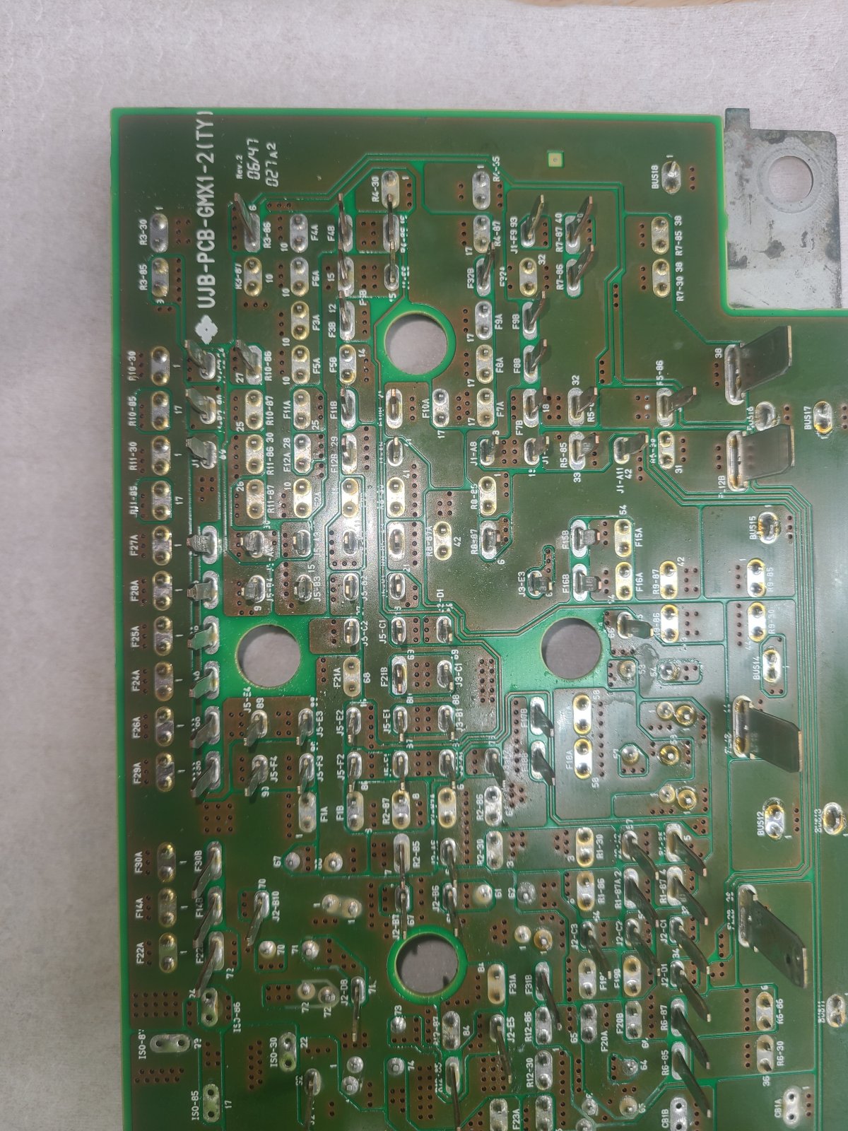

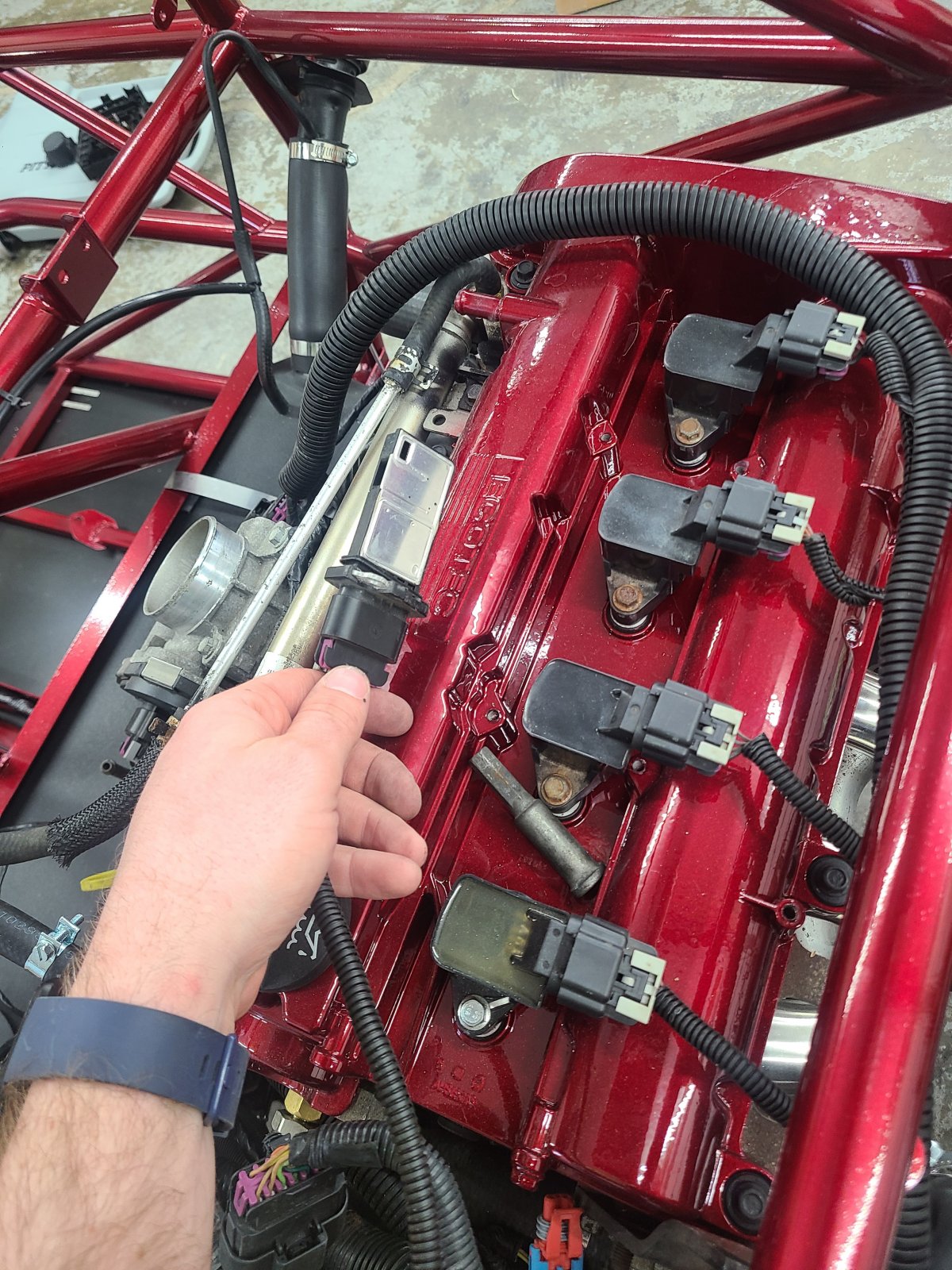

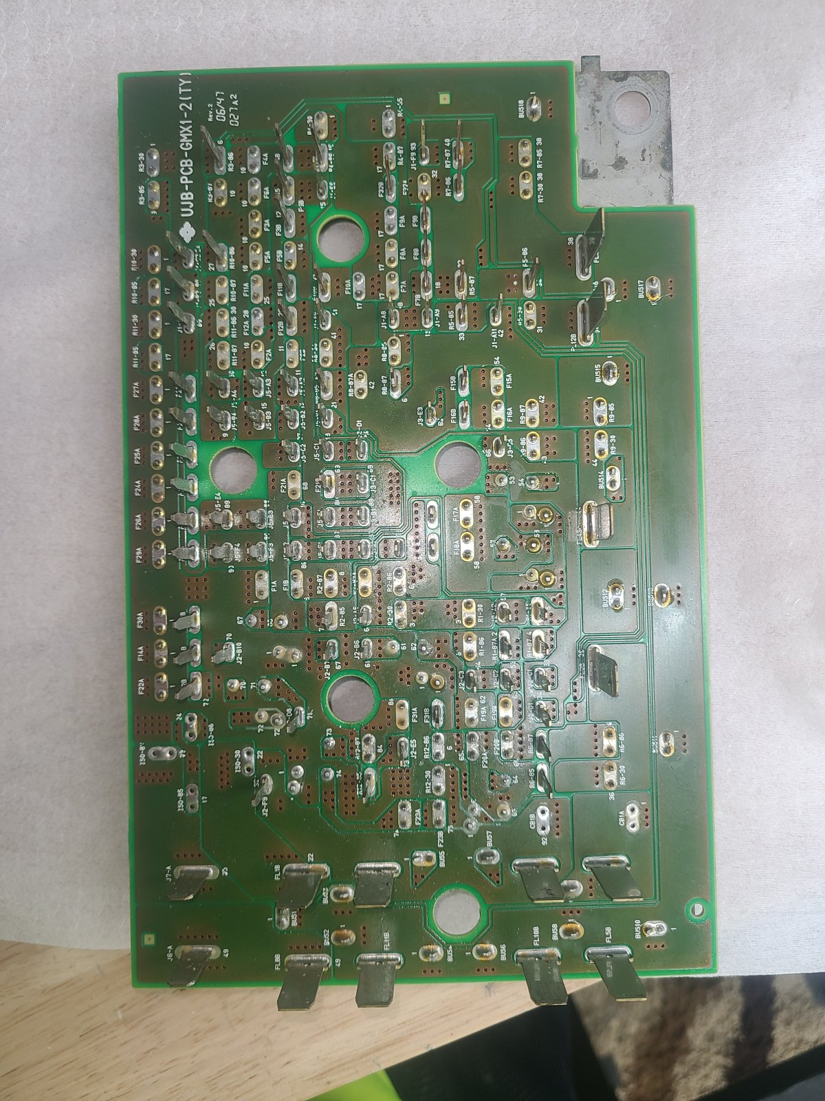

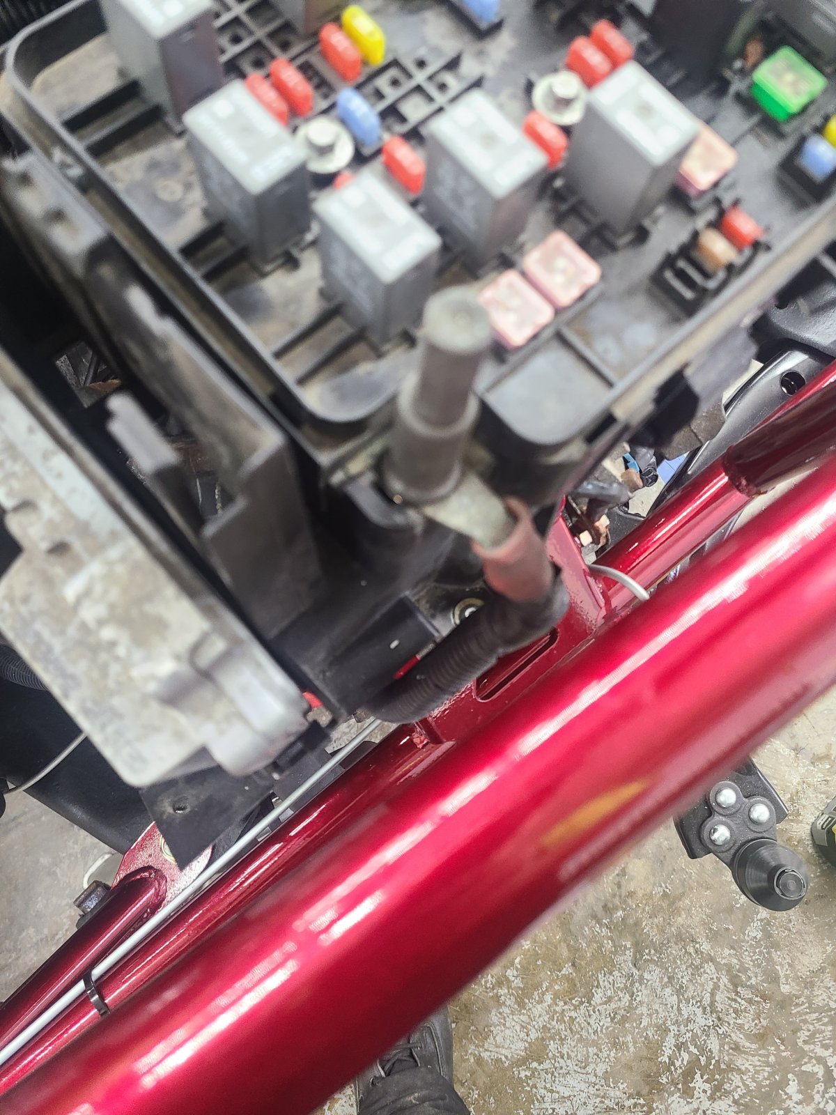

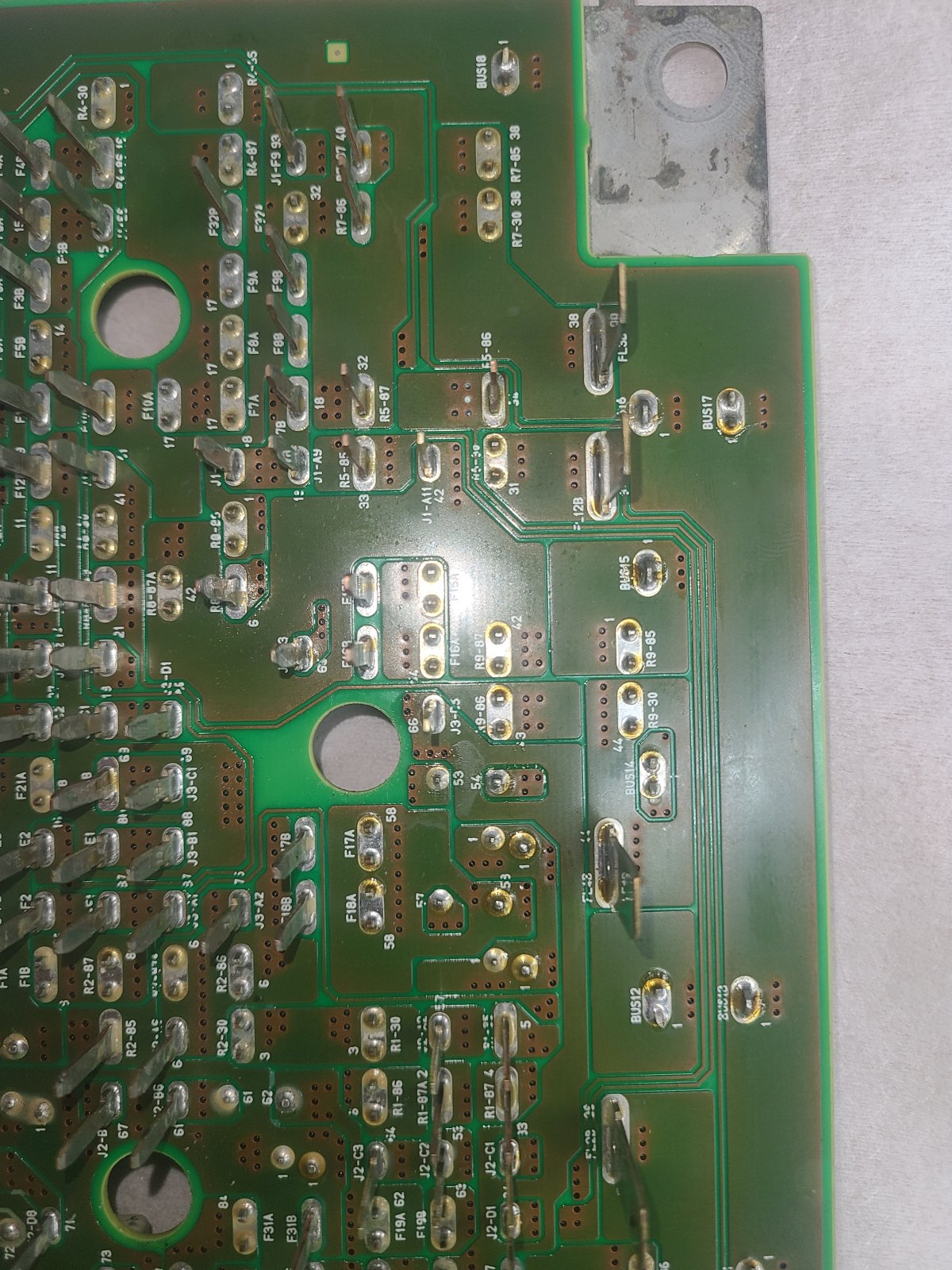

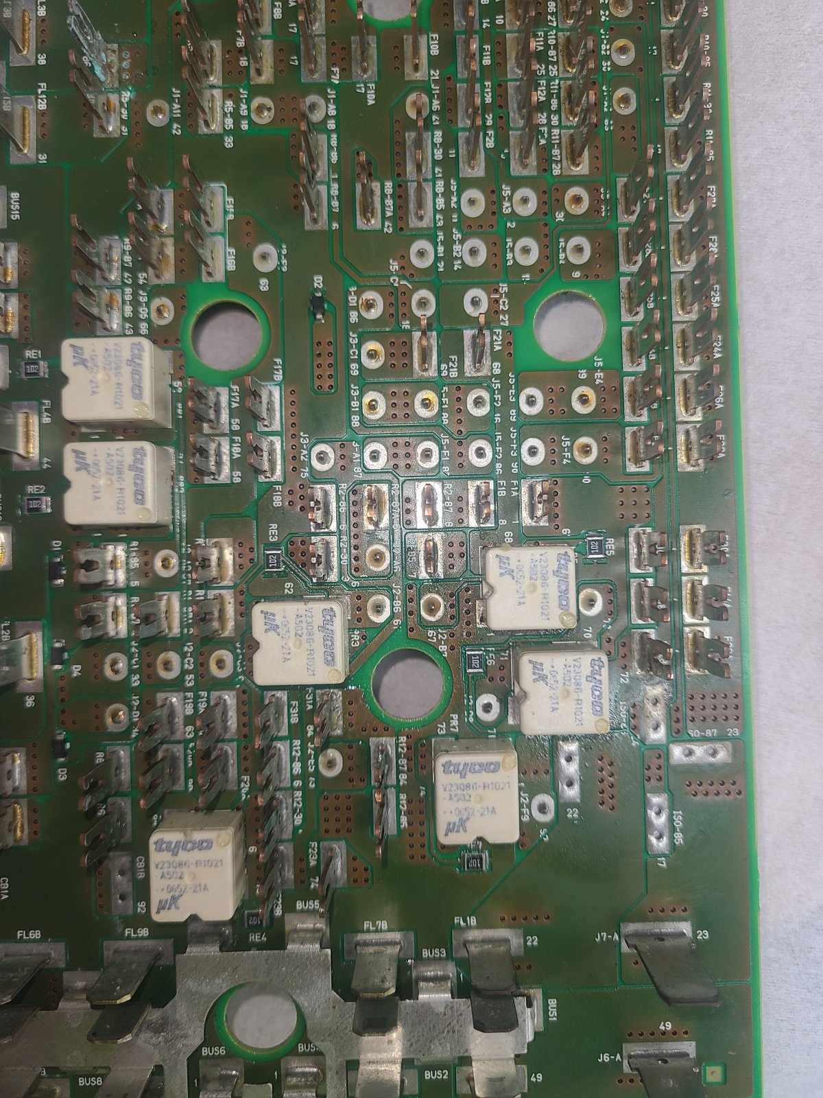

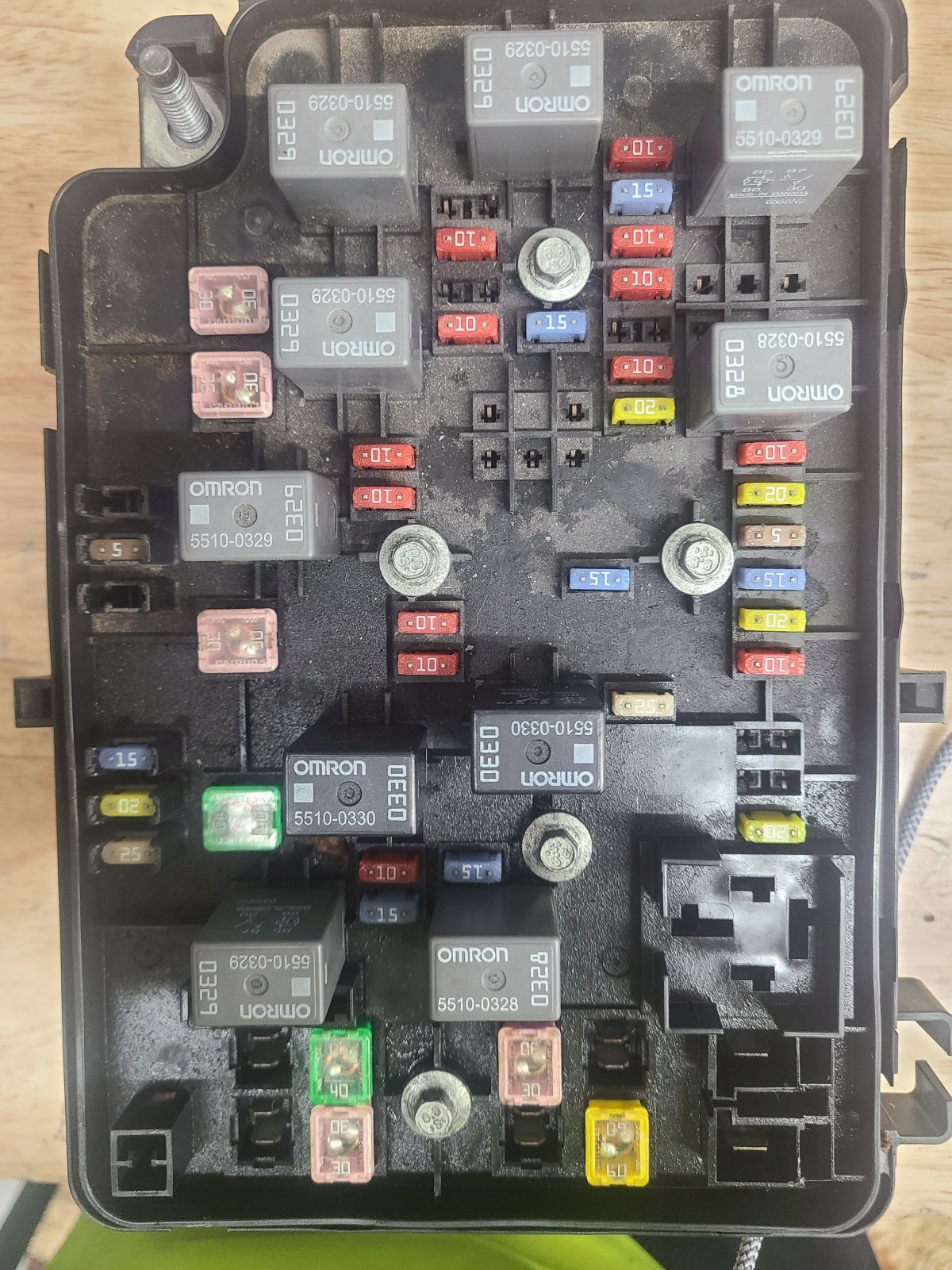

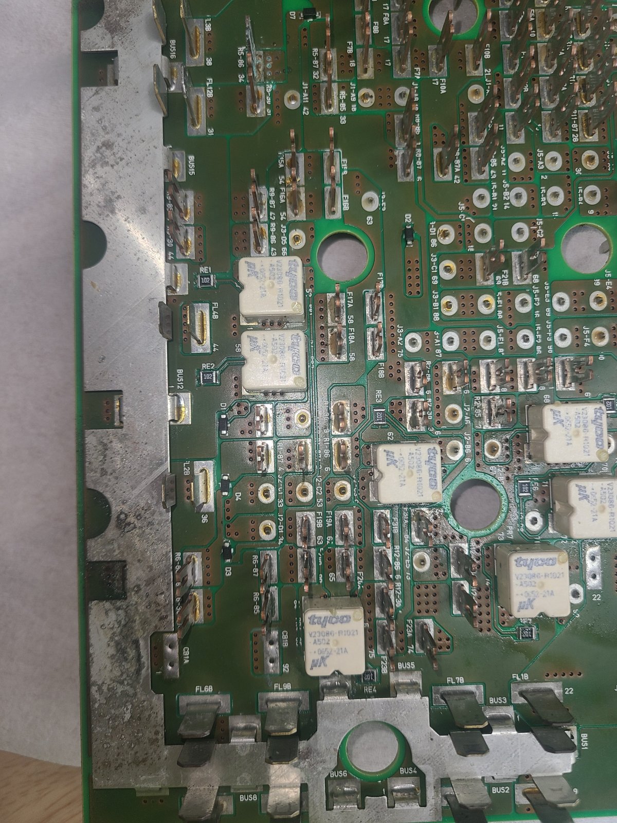

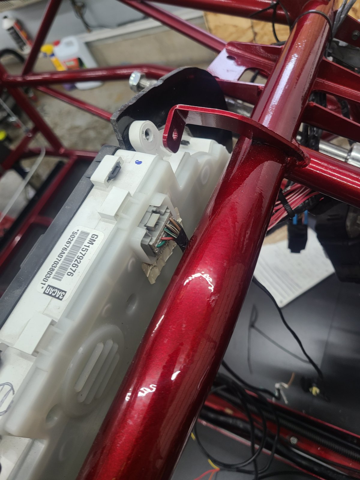

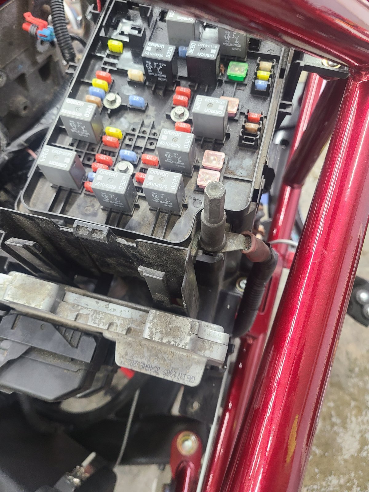

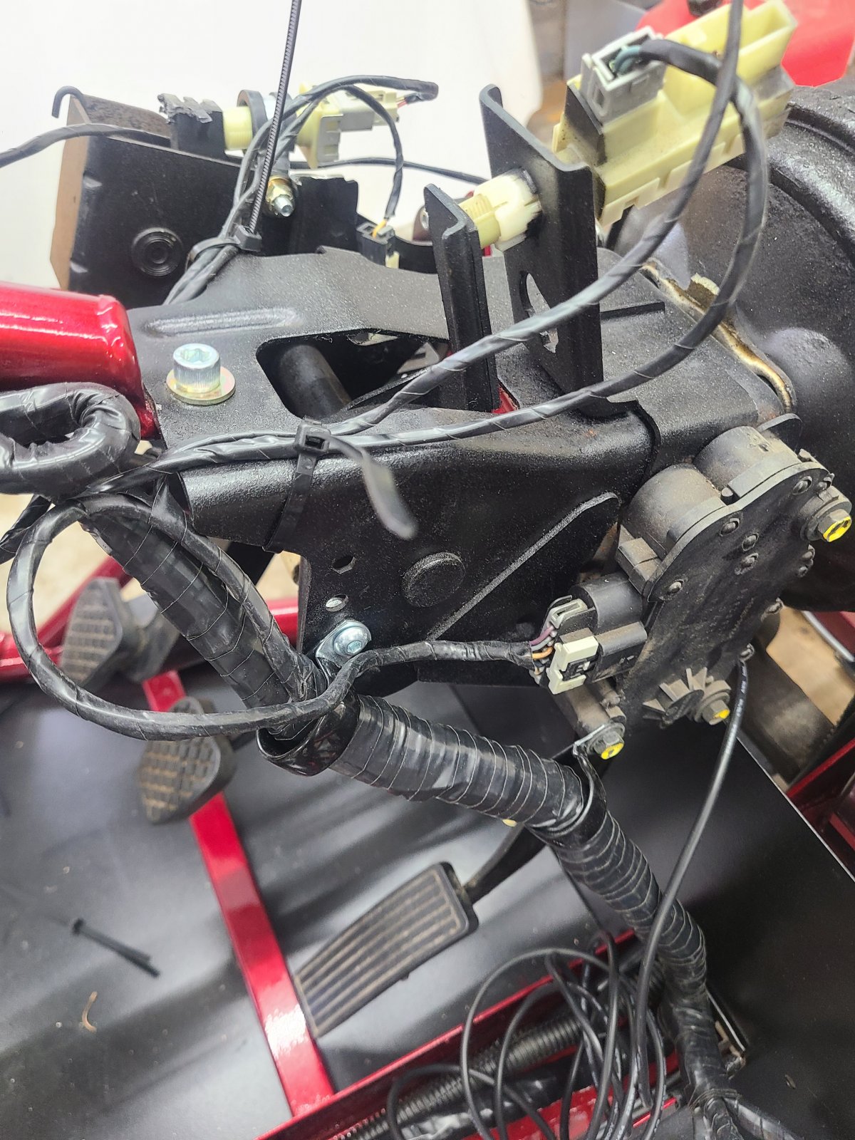

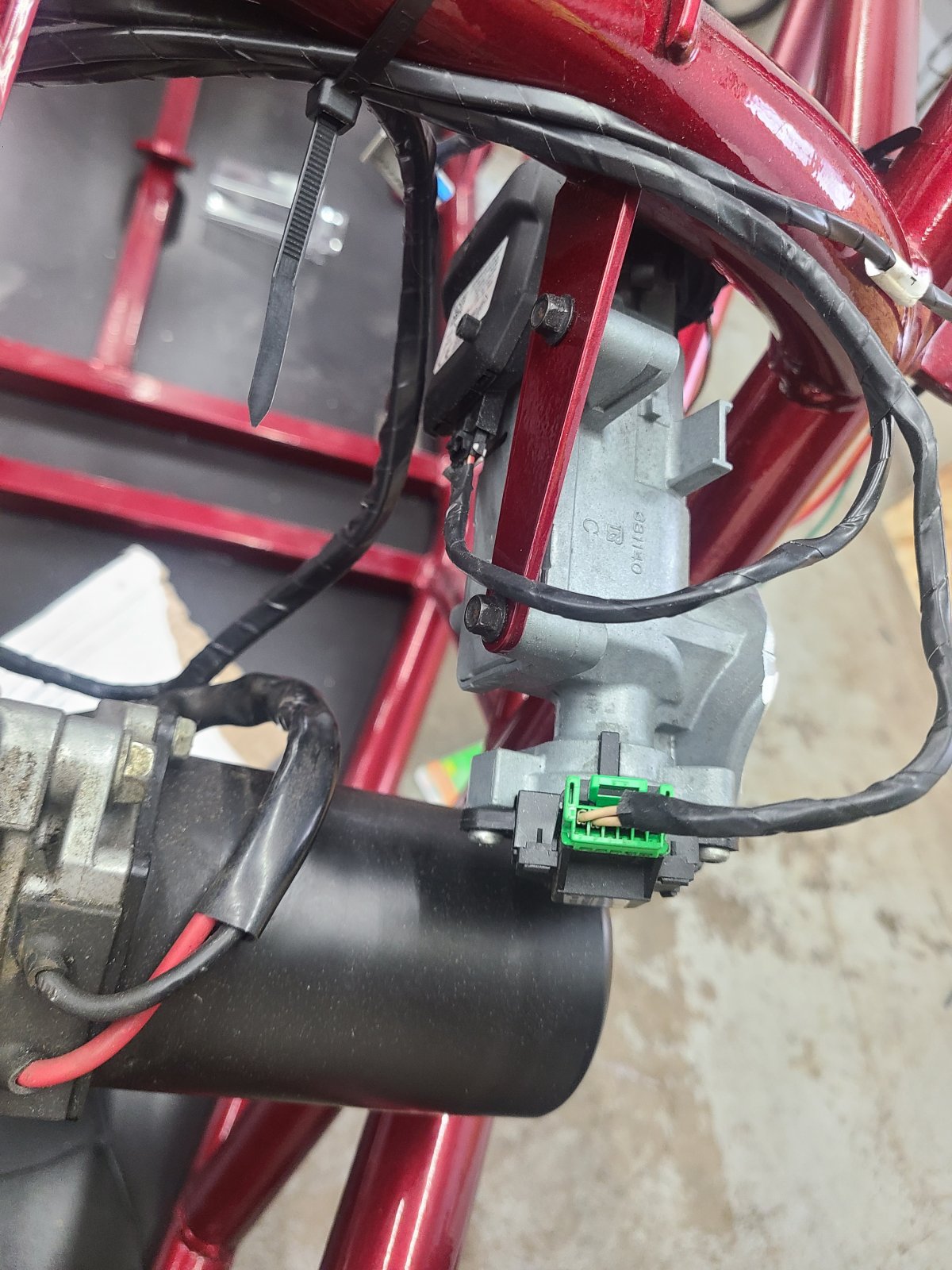

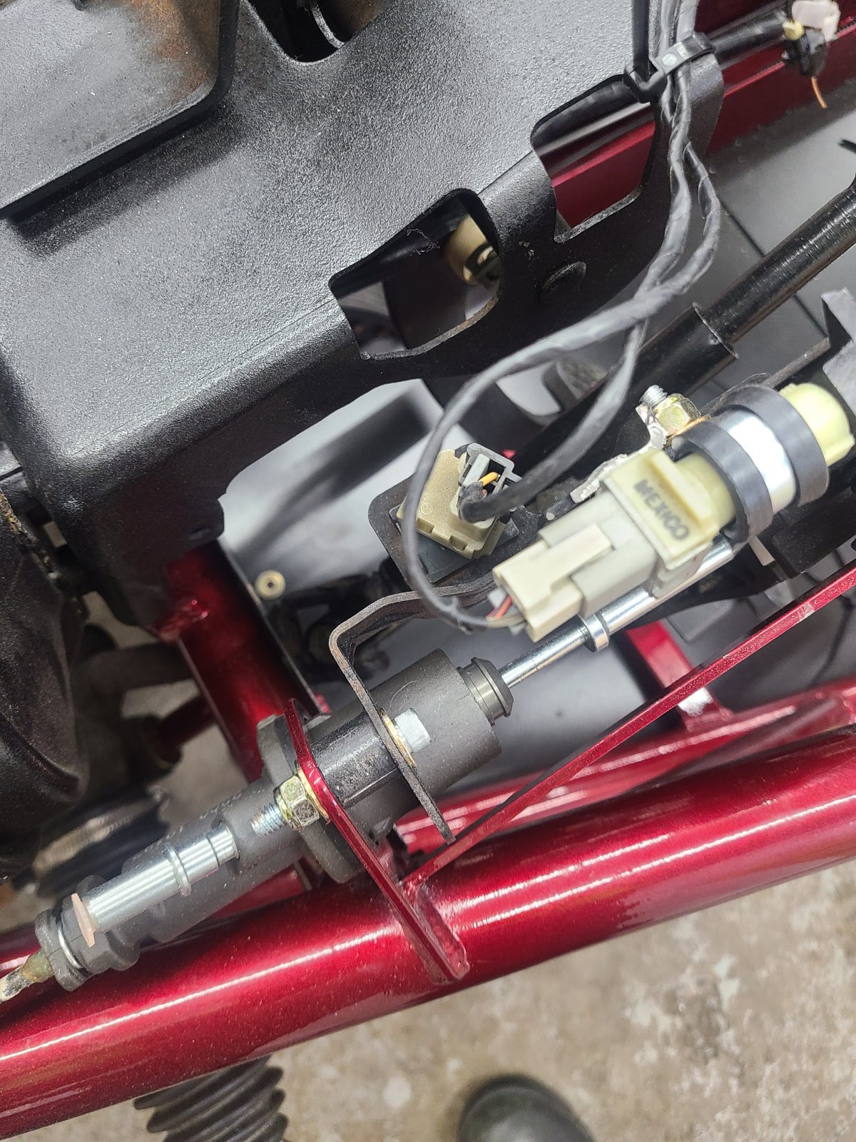

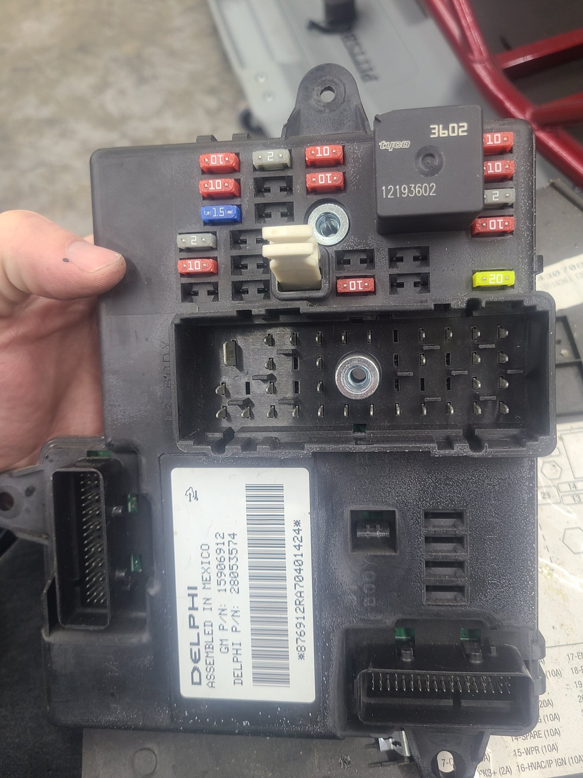

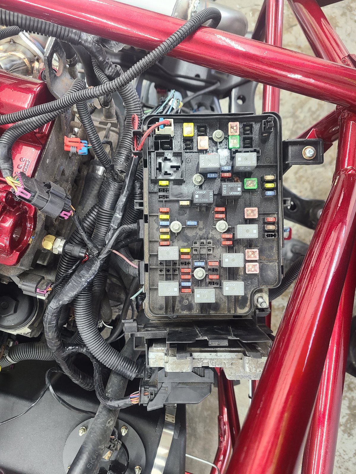

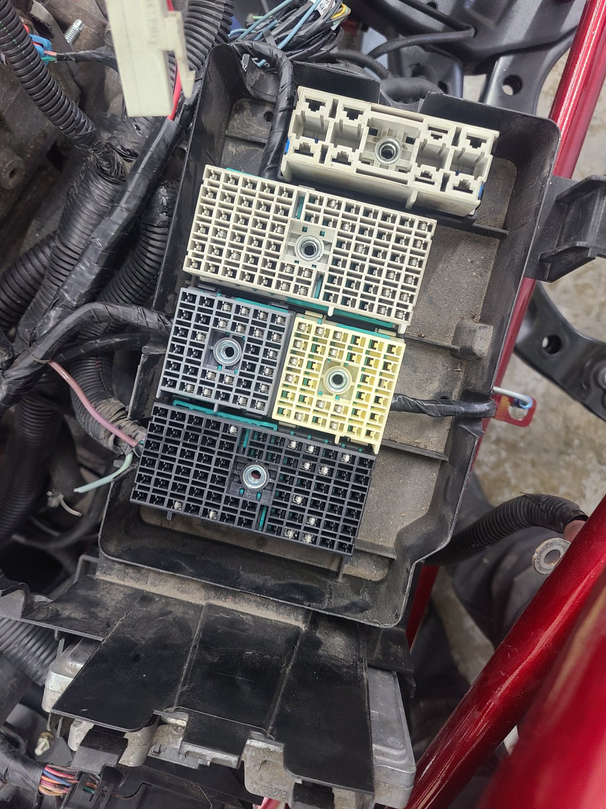

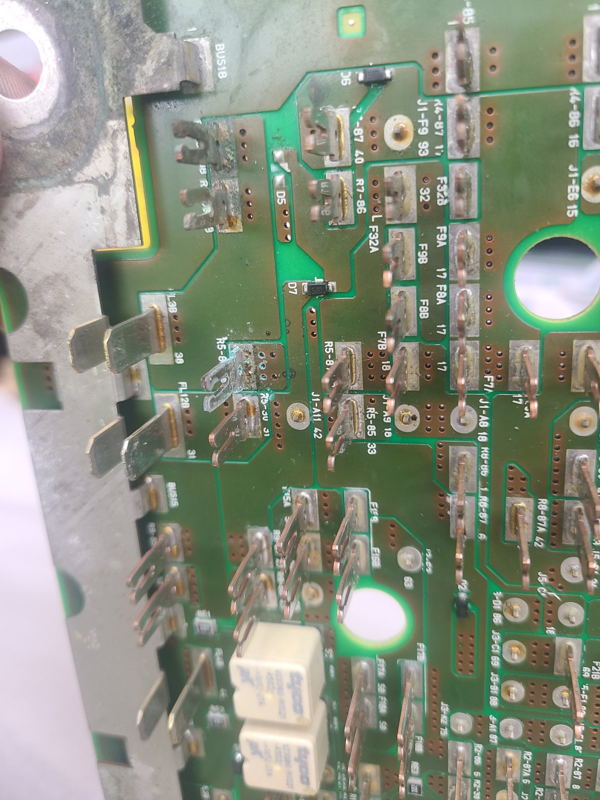

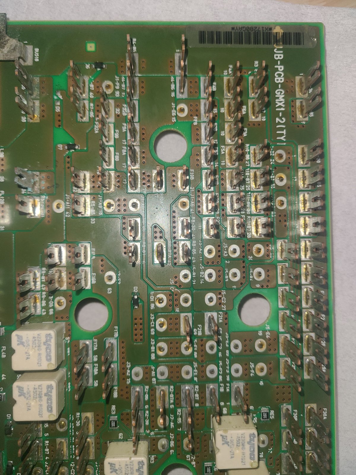

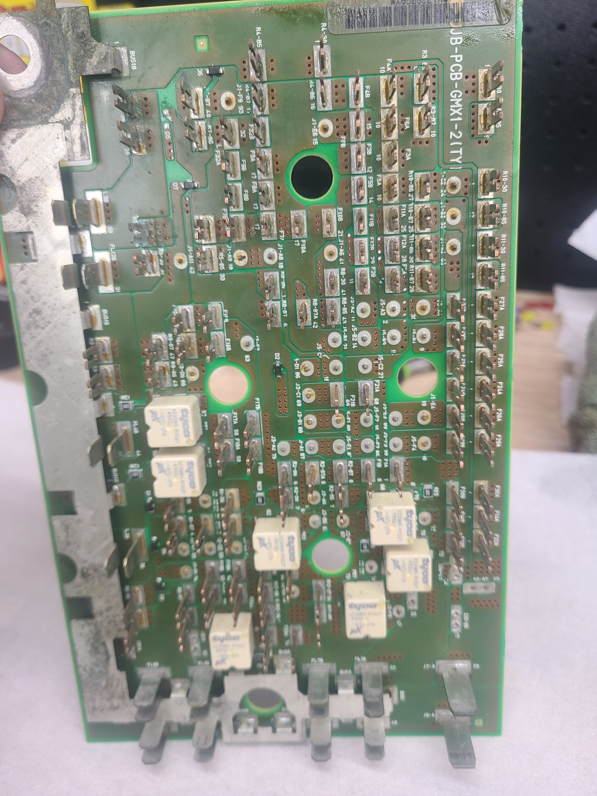

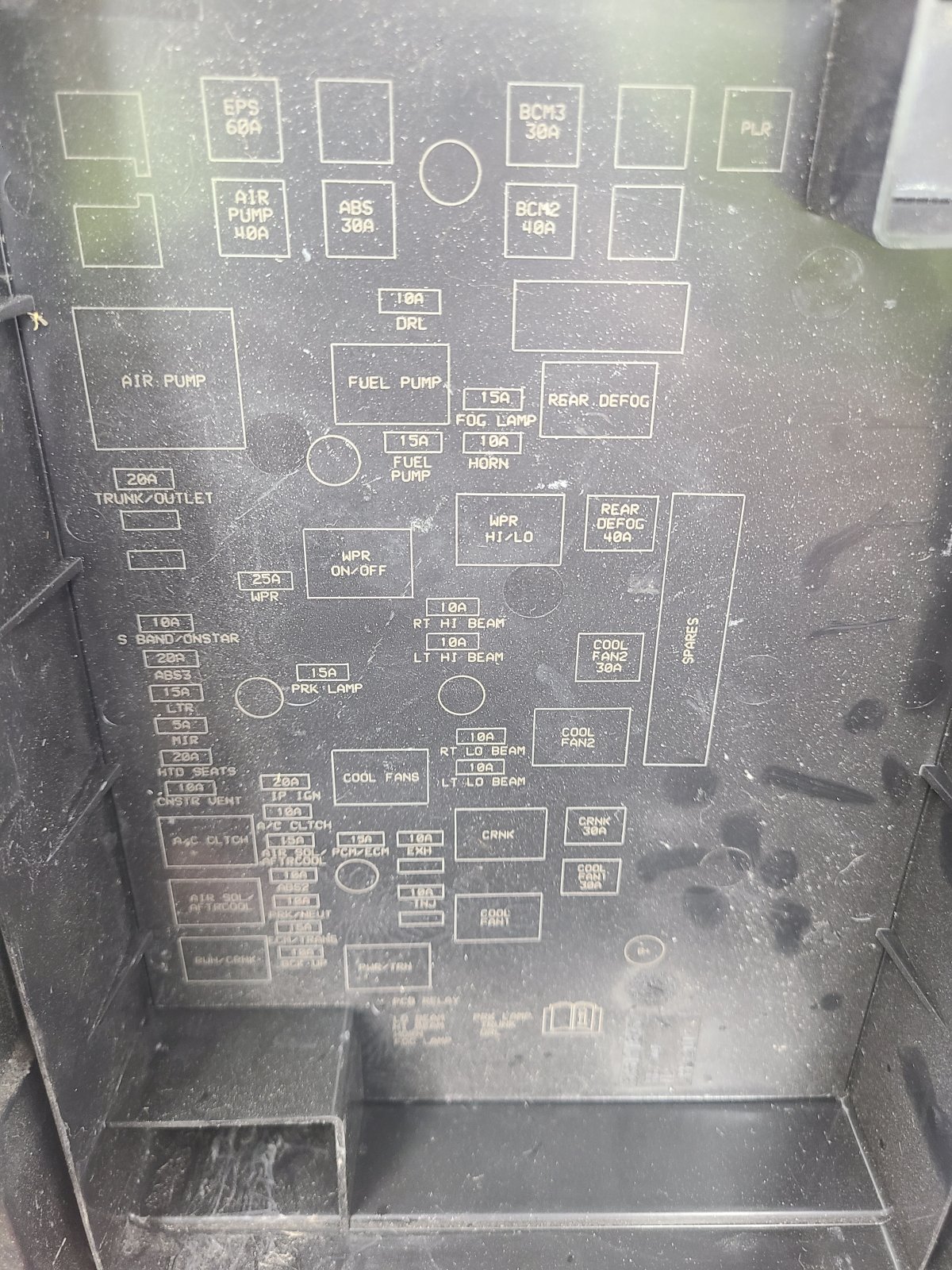

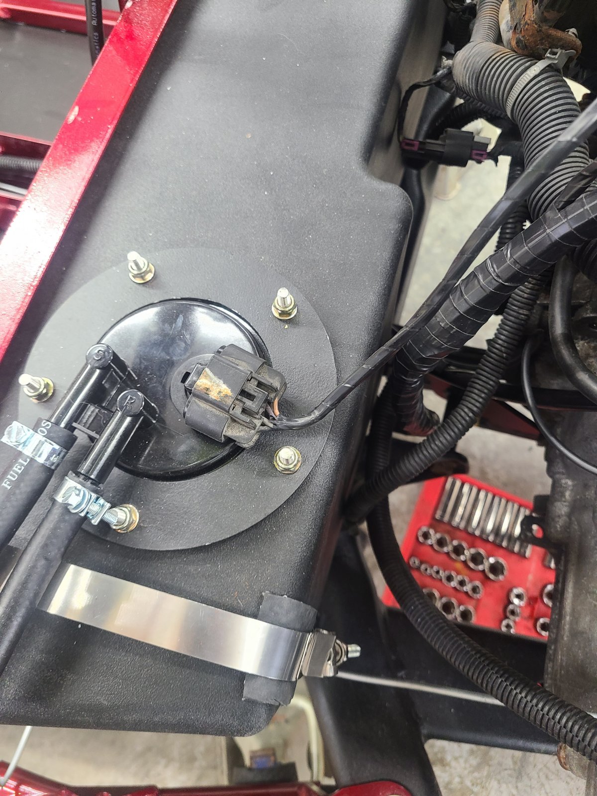

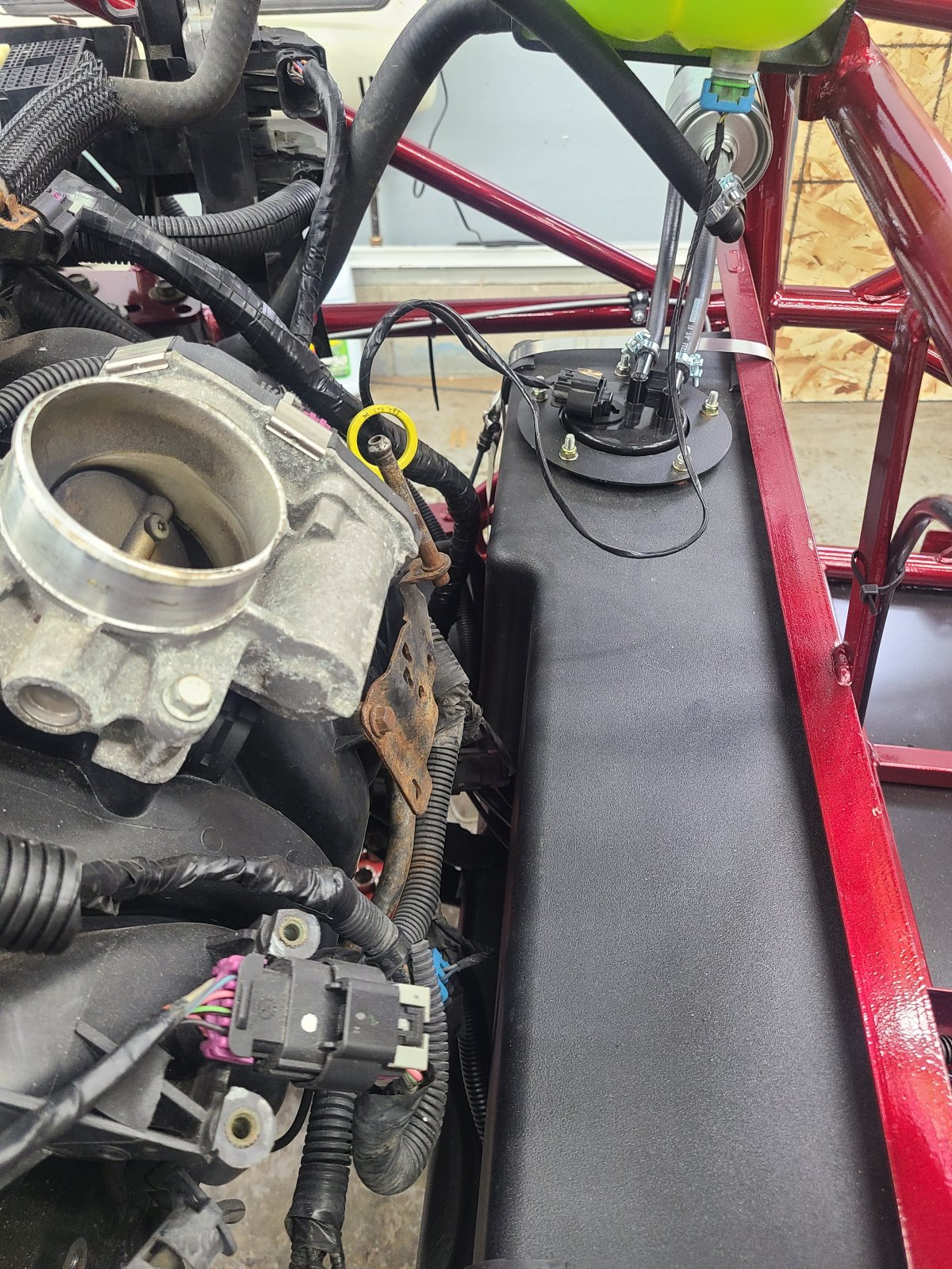

Photo dump of every connection.

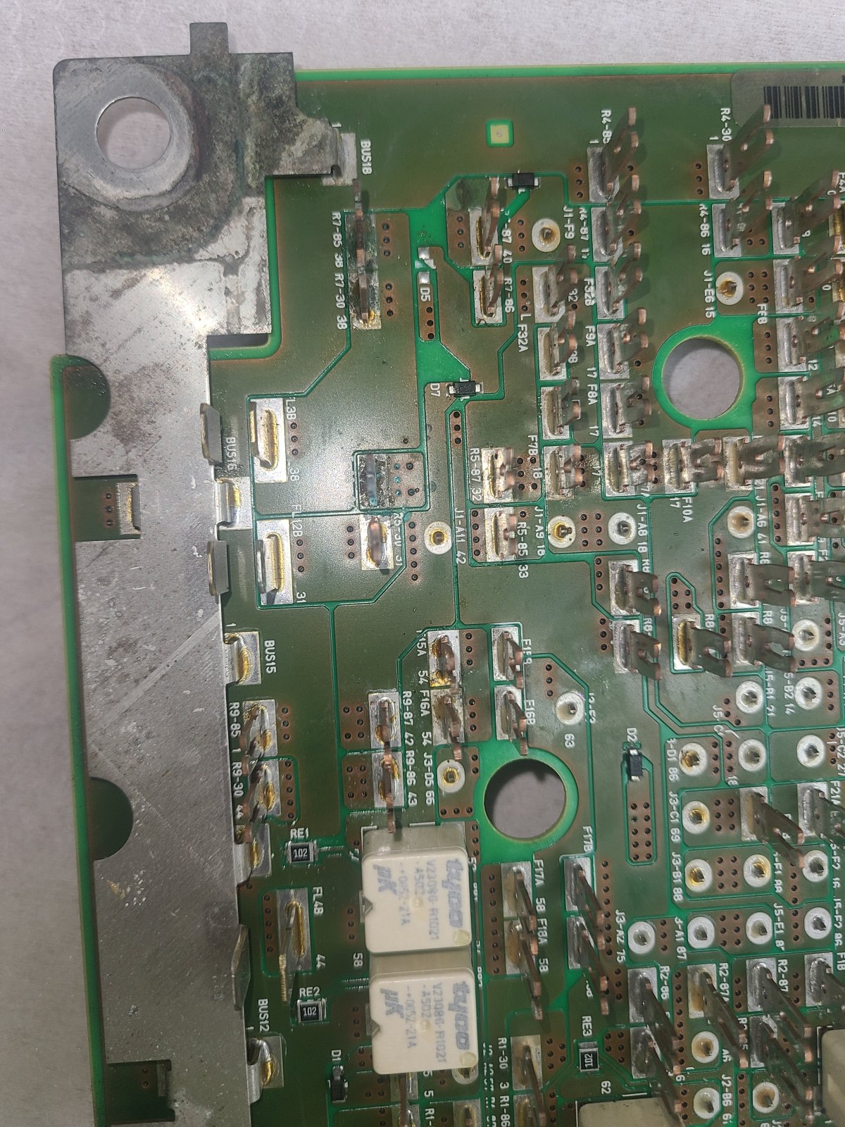

The fuse box appeared to have got some brake fluid on it so it was tore down and inspected as well.

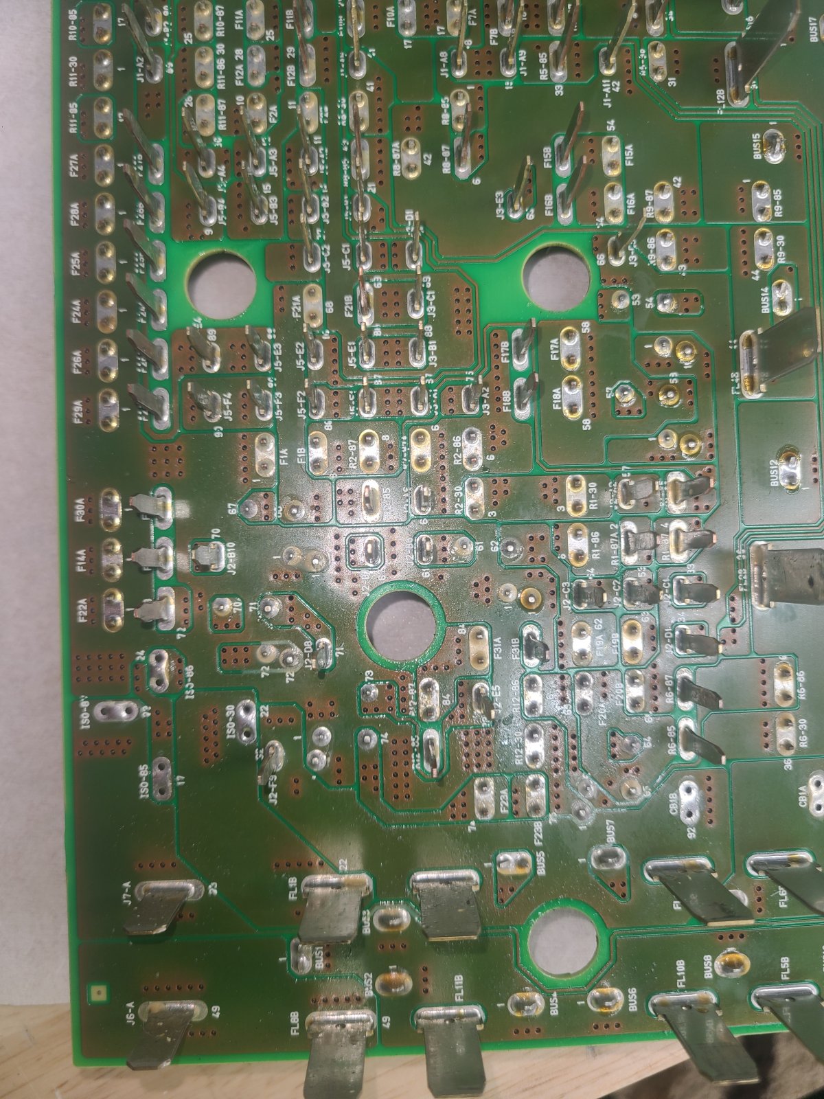

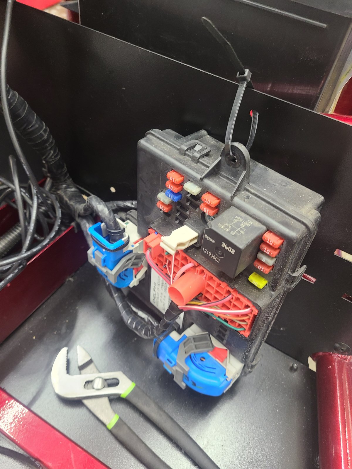

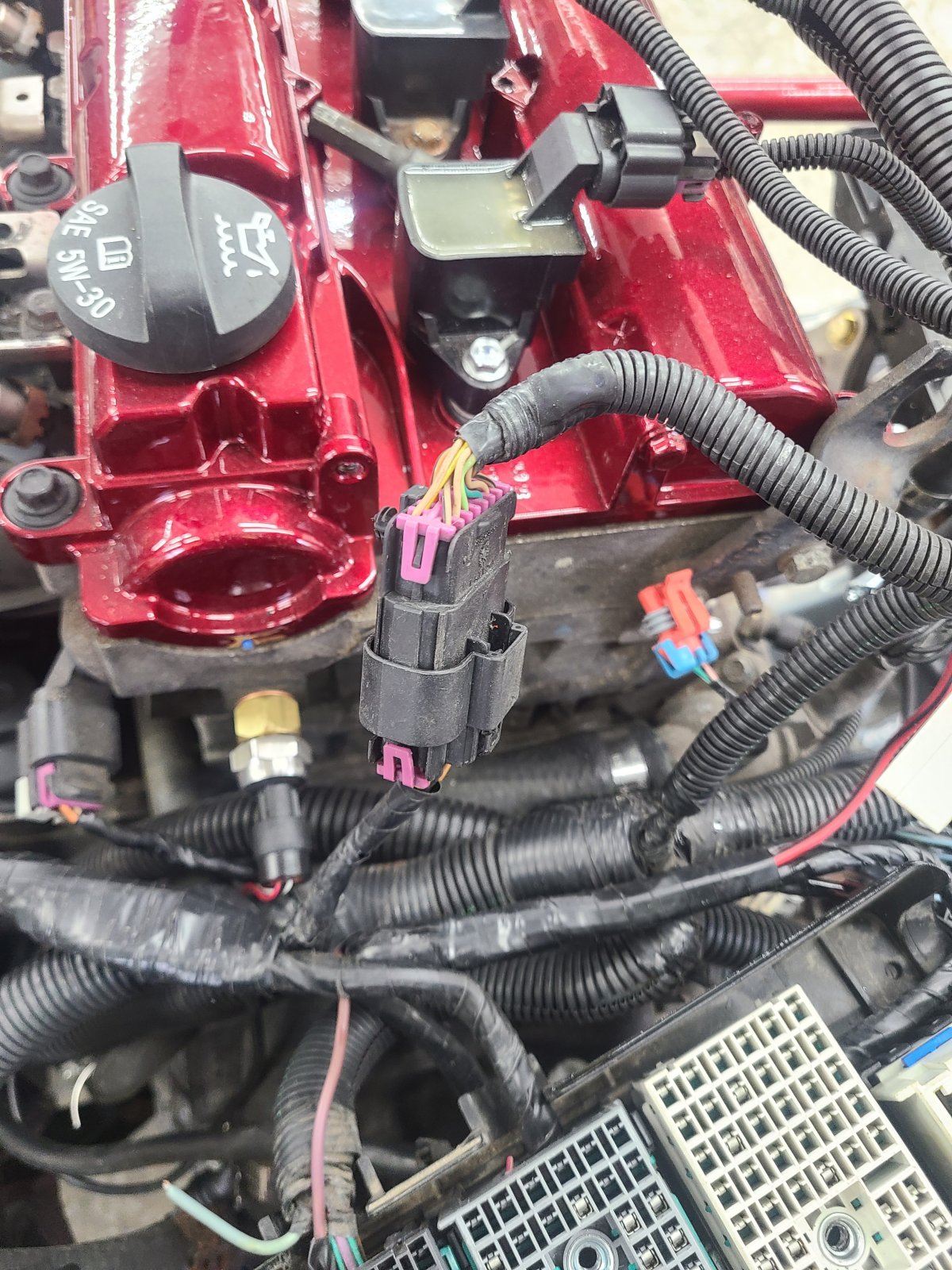

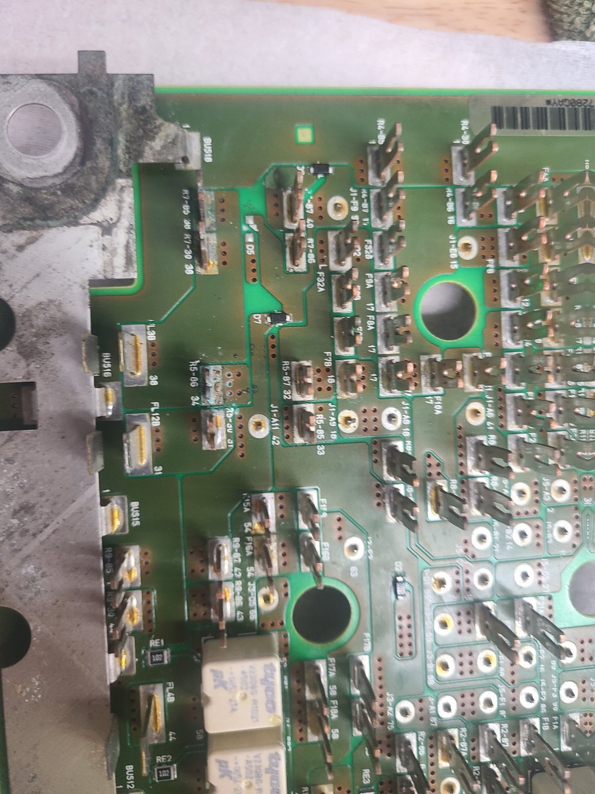

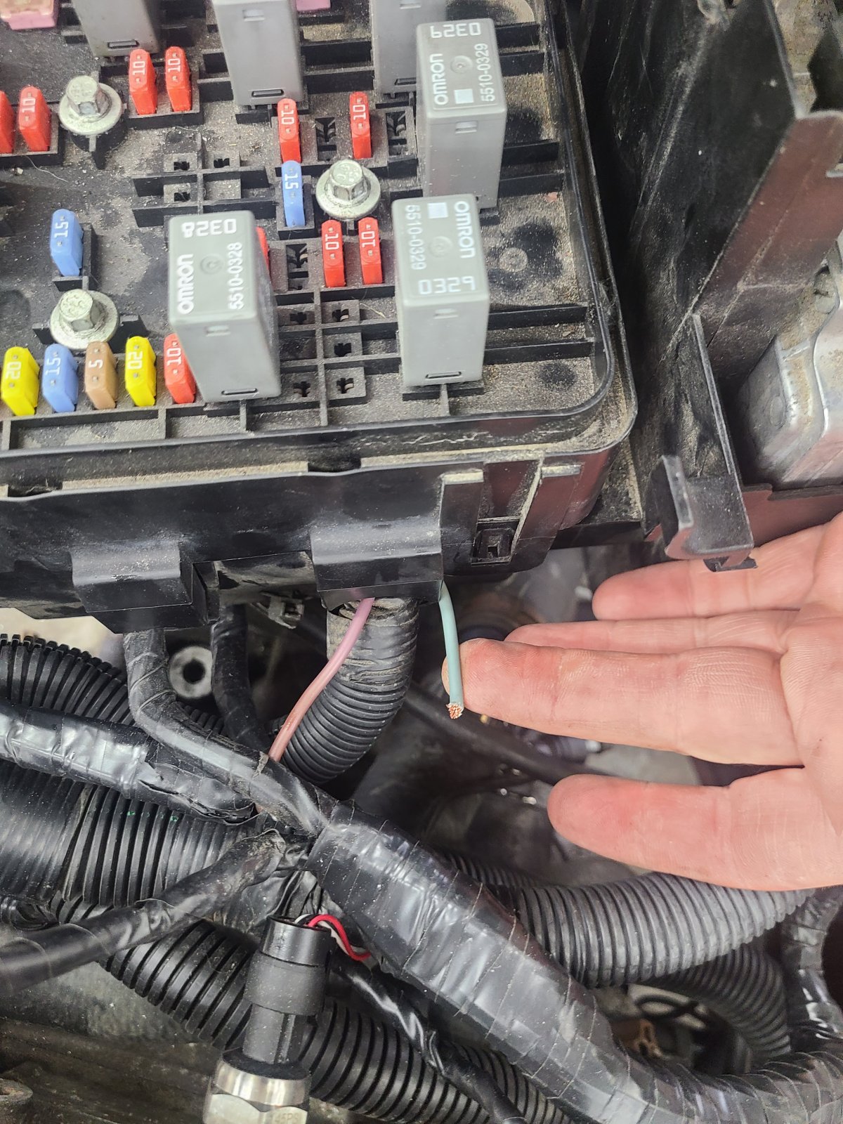

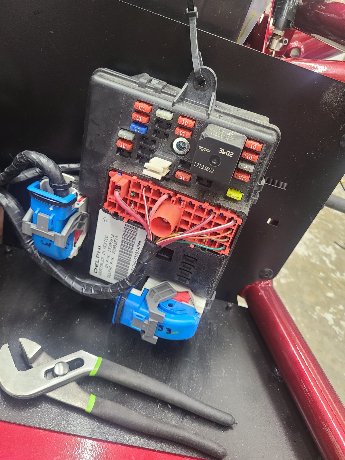

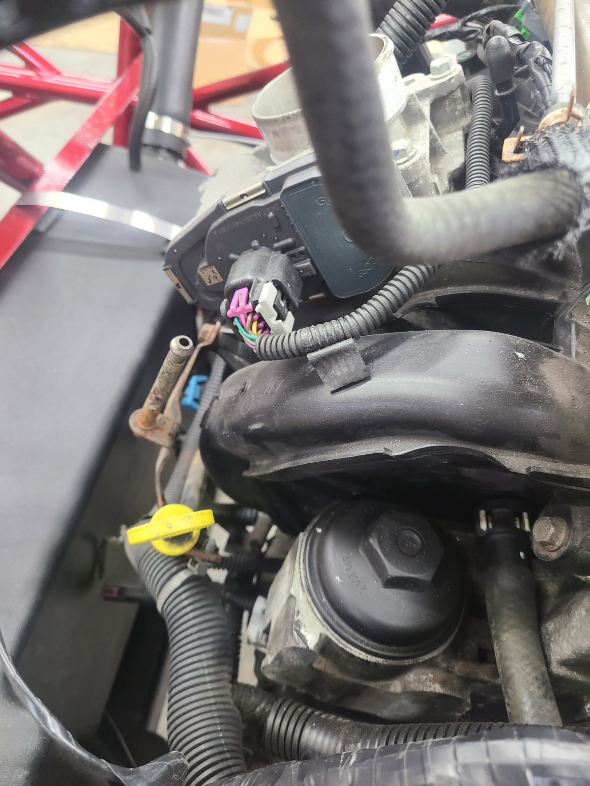

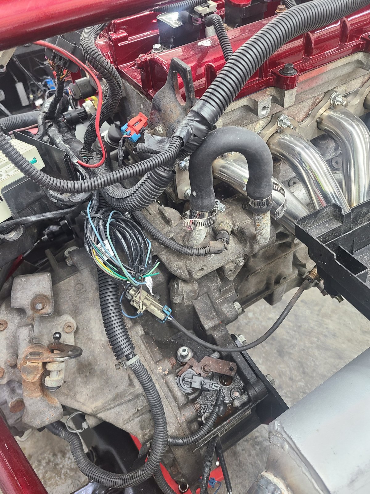

More pictures of the connections and fuse box

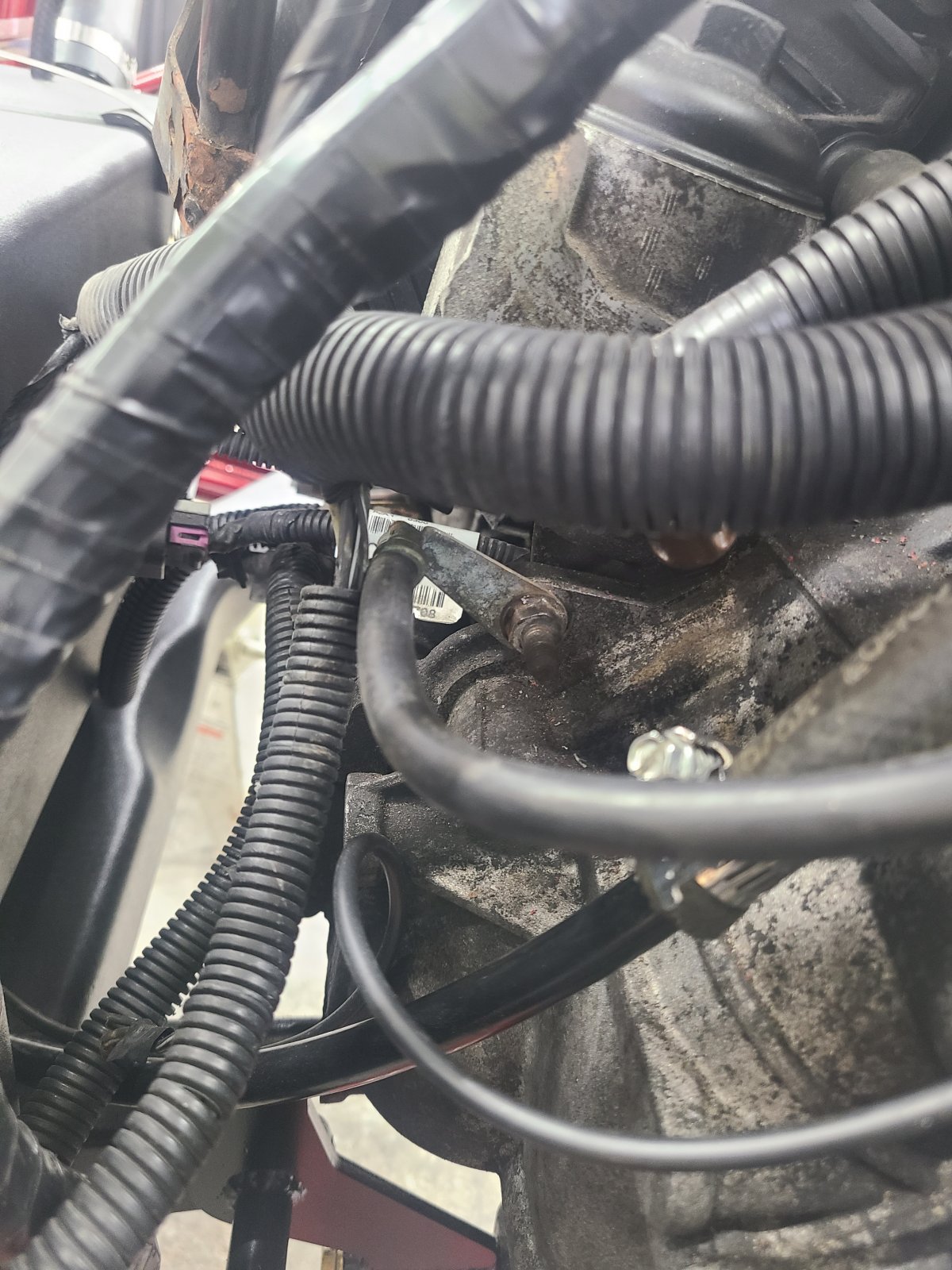

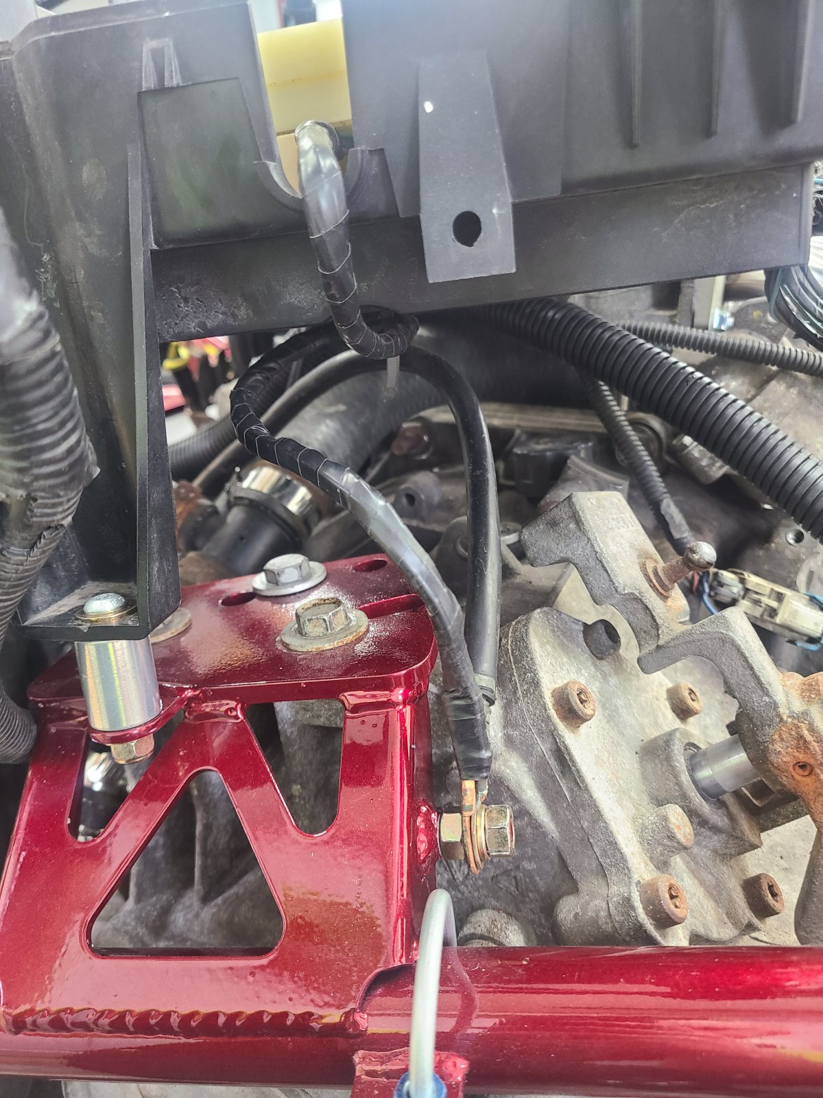

In your third photo of the grounds under the fuse box, shouldn't there be a third ground wire coming to that location? Mine had three, but it's an SC model.
In the next to last -photo of the first set, of the fuse box, is it still really oily from the brake fluid? If so, I'd clean that up a lot more. Saw more in the second set, that fuse box needs a better cleaning.
Are you sure the clutch switch is reading/working properly?

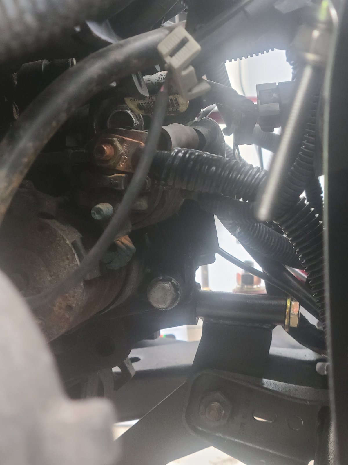

In 120017 and 120025. Is the black wire with red end going from the B+ terminal (the 10mm post on/in the fuse box) of the fuse box to the grounding spot in 120025? That B+ terminal should connect to the power stud of the starter. Wire runs from battery to the post of the starter. Then a wire runs from that post to the B+ terminal of the fuse box. Is the small purple wire also attached to the little 7 or 8mm post of the starter?
R
I have three attached. 2 of which were in the bundle that df did the top one runs to ground at the transmission housing

5% is a burnt trace in the fuse box, usually by mis-jumping the fuel pump relay to prime or empty the fuel tank

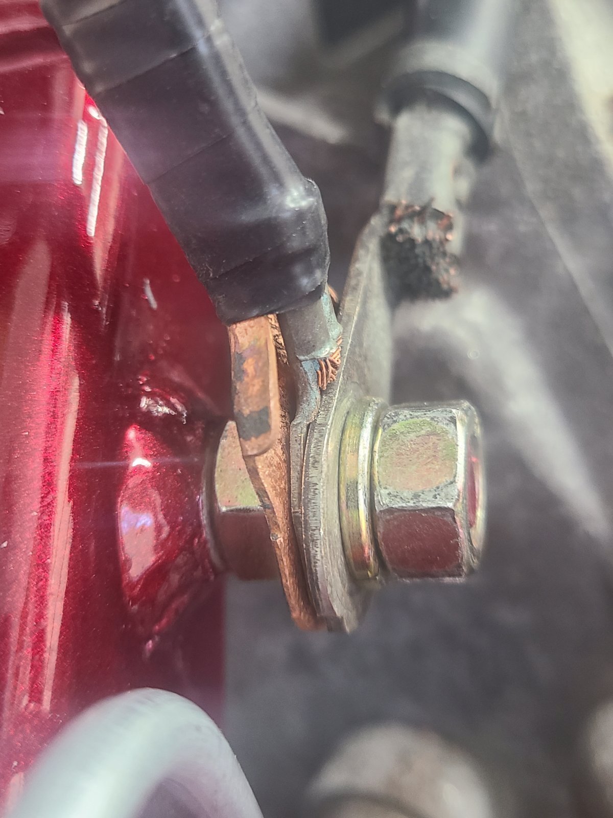

UPDATE
I GOT IT STARTED!!!

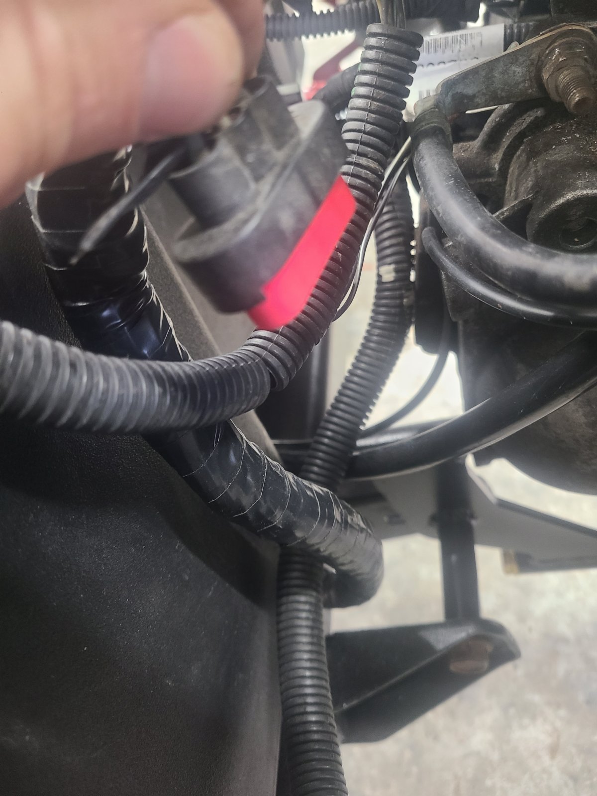

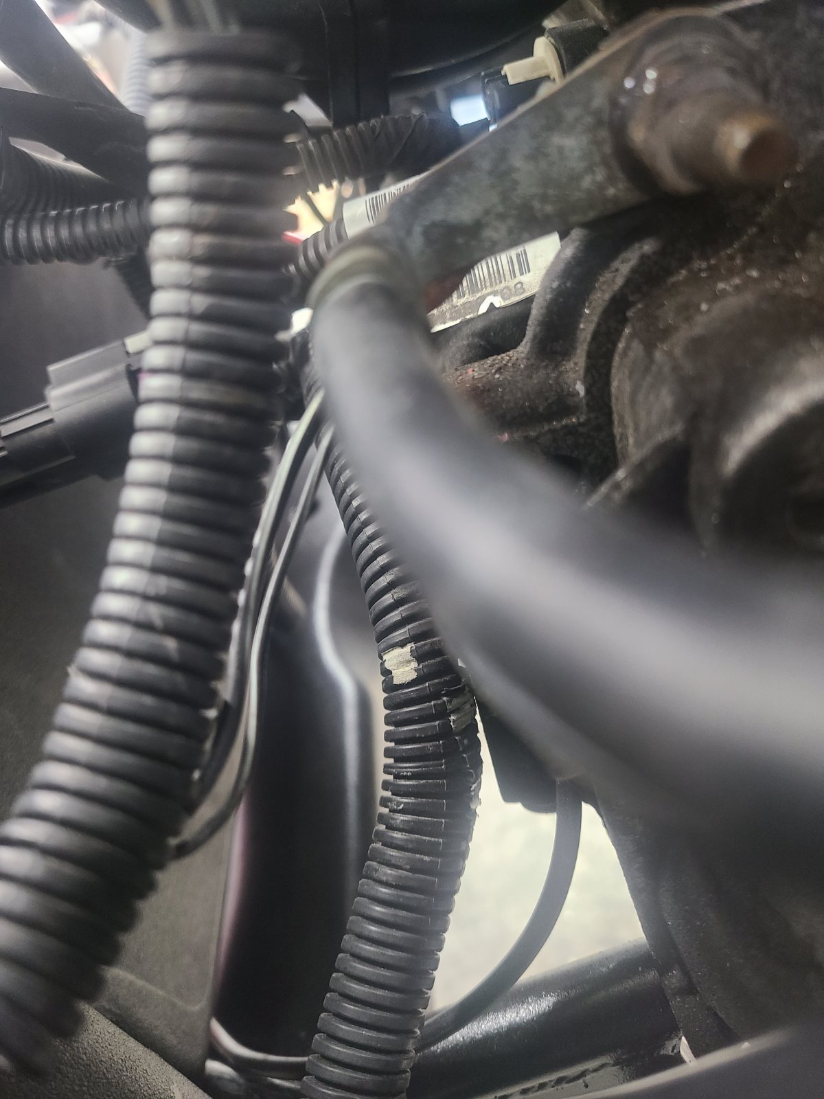

The red plug that used to go to the radiator fan on the donor had two grounds poking out of the loom leading up to the red connector. It appears as if those lines had been sheered off somehow. I put a new terminal on the ground wires connected it to the grond on the transmission housing and boom she started. Ran briefly, but I assume since I don't have the maf tube and sensor installed, it won't run for long.
But she's alive!!

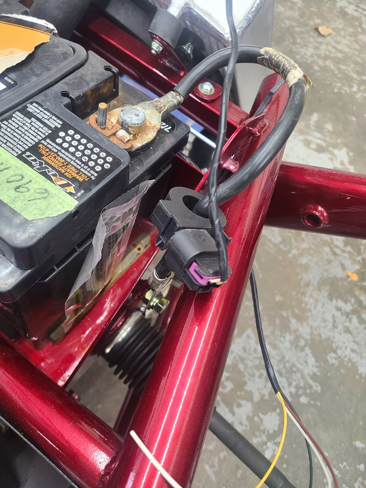

The corrosion on your negative battery cable and the amount of powder coating still visible around your forward chassis ground makes me think you should at least check. Although it probably isn't the problem, it would be at the top of my list of things to try because it's so quick/easy to check and ground issues are usually the culprit in these types of issues.

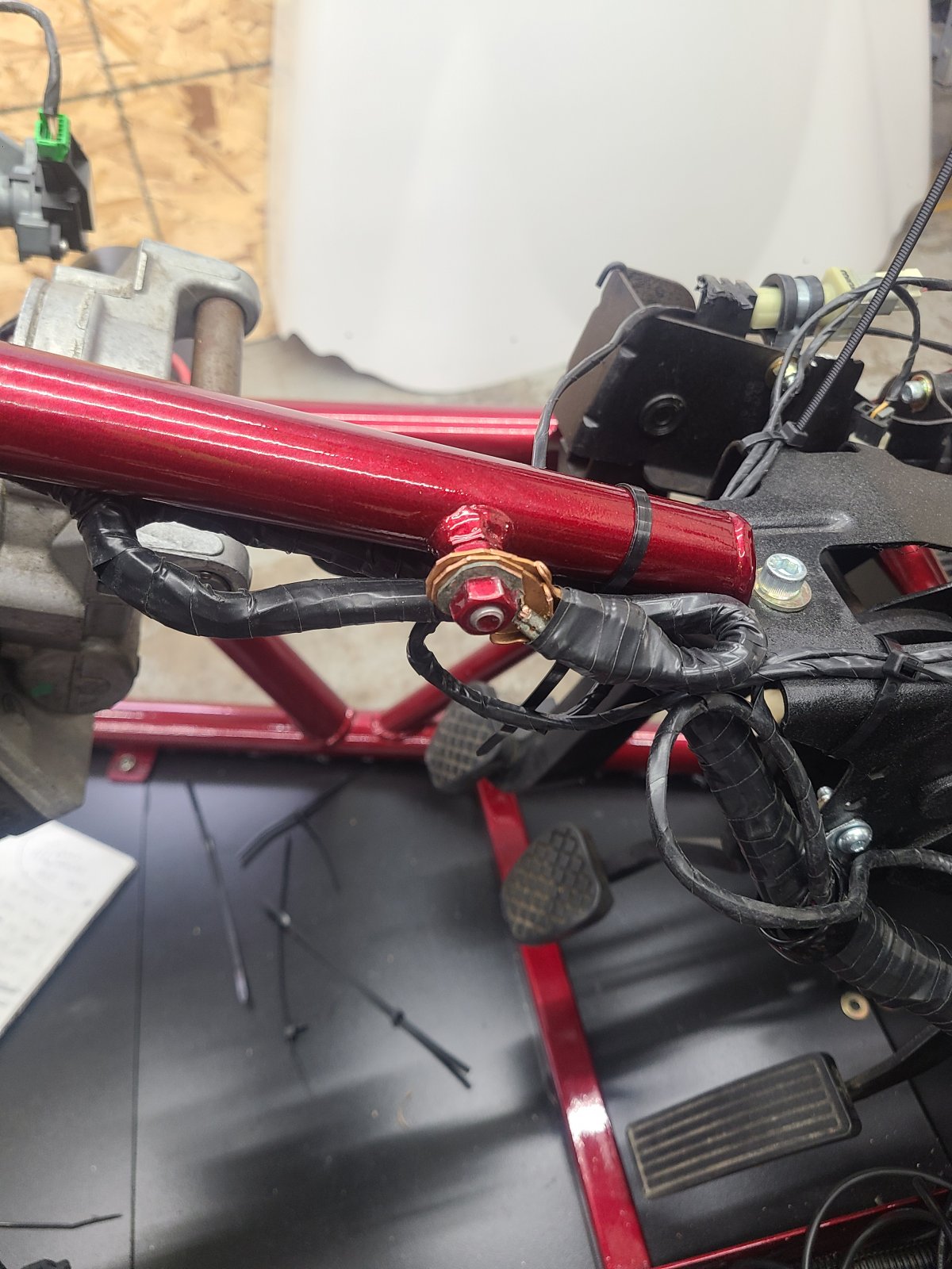

This was the ground that was sheered off. It was coming from the loom with the red plug.
