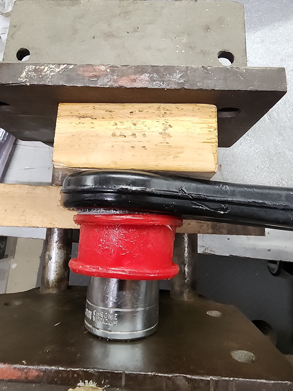

Hi All! I removed the stock bushings on the front and rear of the control arm. I purchased the Prothane brand bushing and have the front bushings in with no issues. For the rears, I burned out all the old rubber and have tried to press in the new ones 3 times, breaking 1 bushing thus far. Fortunately, Prothane has been awesome and sent me a replacement. I have done the freeze the bushings and heat the arms, lubed up all parts way more than they should need and the bushing keeps mushrooming over the hole vs in. I have access to a shop press and bench vise and tried both. I would appreciate any tips from those who have used this bushing on how they got it to fit.

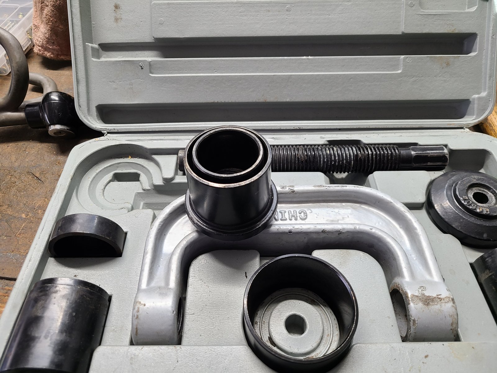

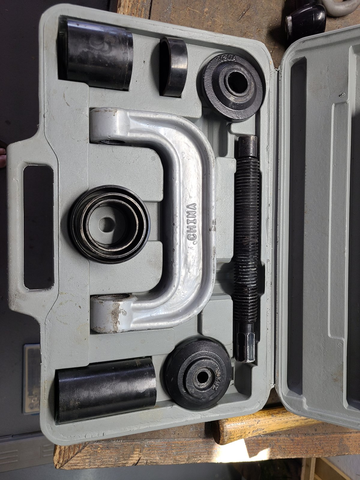

Press the new bushings in using the ball-joint press. (Borrow it from an auto supply store). The Prothane kit comes with a "special grease" - yea whatever., use it.. Use ALL of it. The grease helps let the bushings slide into place, as well as keep them lubed. Poly bushings are much harder then the rubber units they replace. They can and will make some noise in the cold, so don't freak out if you hear a few grunts and groans when it gets colder out. The grease is silicone dielectric grease. Use extra if you have to. Just wipe off the excess, dirt, rust, and grime will tear apart the new bushings, so try to keep the work area clean, and clean up the areas where the bushings are going to get pressed into.

I'm assuming the bushing is 'mushrooming' around the socket when pressing? The pressure on the bushing needs to be almost the width of the bushing (not the lip), but also even across the rest of the material on the face. As @Ross stated, a bushing install kit offers more options and the adapters can be stacked together to get the more even pressure.

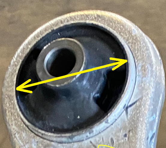

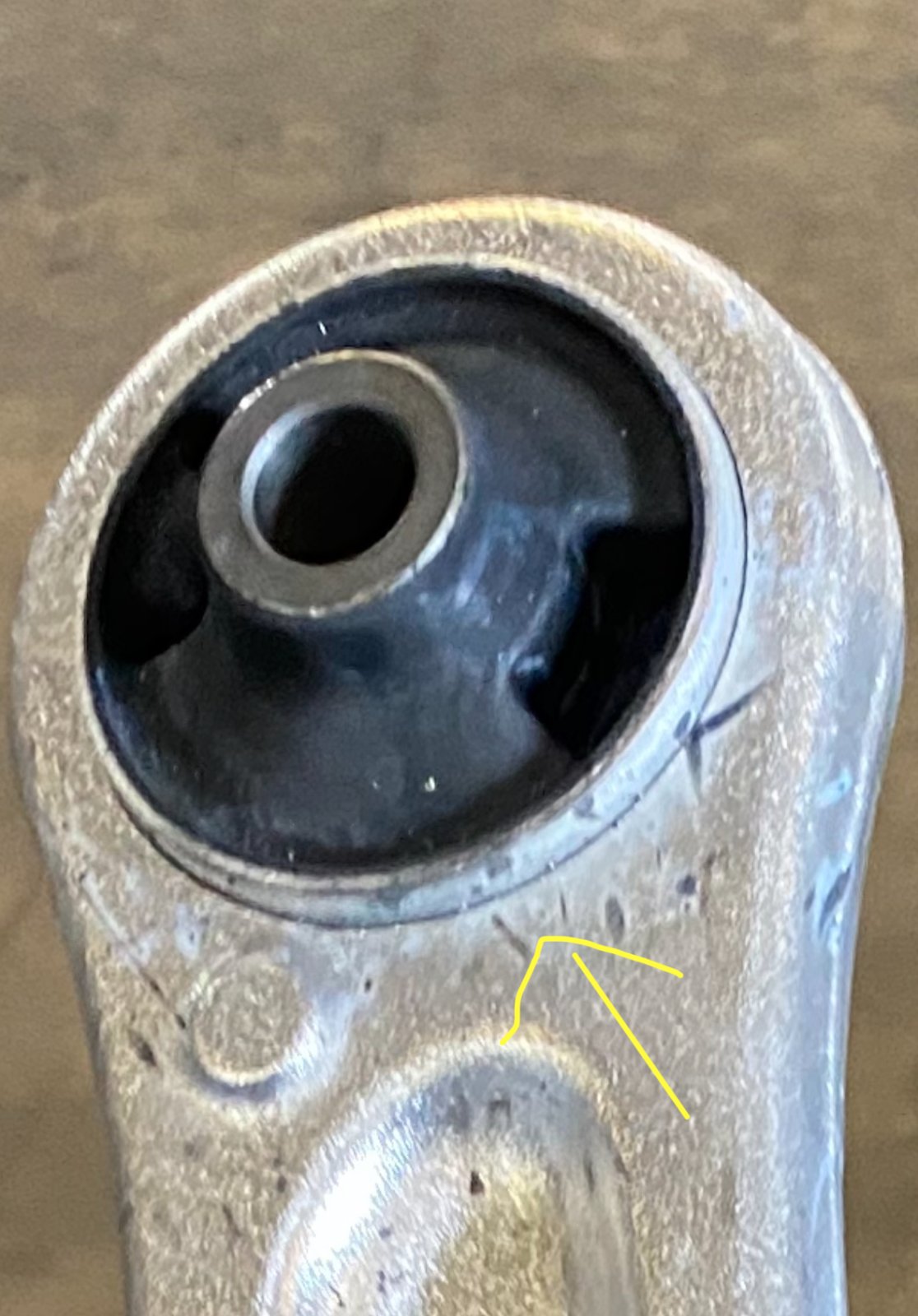

burned out the old one? It has a metal ring around it. Did you press out that ring? You might be resisting against it with the new bushing. Let me look for a pic
Have you measured the Prothane bushing (green arrow) and the inner diameter of the burned out bushing (yellow arrow)?

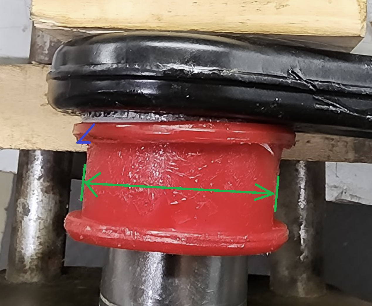

Is there suppose to be any squishing of the Prothane bushing?
I wonder why Prothane didn't chamfer the leading edge of their bushing (see blue line), as that whole edge is suppose to squish down thru the yellow arrows, then pop back into shape on the other side. Maybe modify the leading edge of the Prothane bushing?
