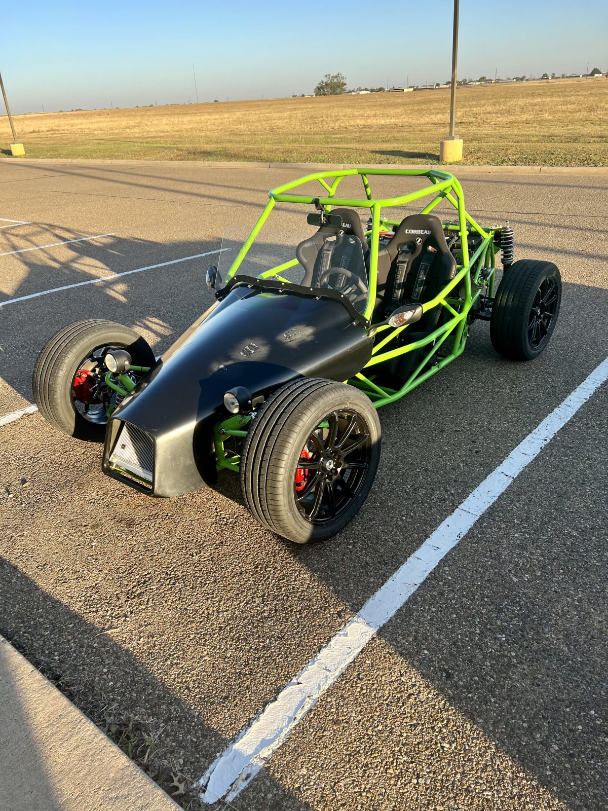

Has anyone painted the hood and engine covers with raptor liner? We live in a pretty windy area with tumbleweeds and I thought it would hold up better than a wrap or paint.
I used the spray one variant for some parts of my 'firewalls' and floor pans. It went on easily but was very hard to keep consistent. I had also used Rustoleum roll on. I think it did much better but definitely was a pain to roll on. It's really thick and hard to keep consistent. I worked better if I poured it on a section, then worked it around with the roller. It's held up pretty well on metal but do not know how it would stick to fiberglass.
If doing the Engine cover or hood, I think I would go with the professional applied Rhino Lining or Line-X.
If use the Rust-Oleum Spray on liner, you can spray over it with satin black to even out the color. But it comes as a very sandy texture. I would not use it for exterior visible parts.
