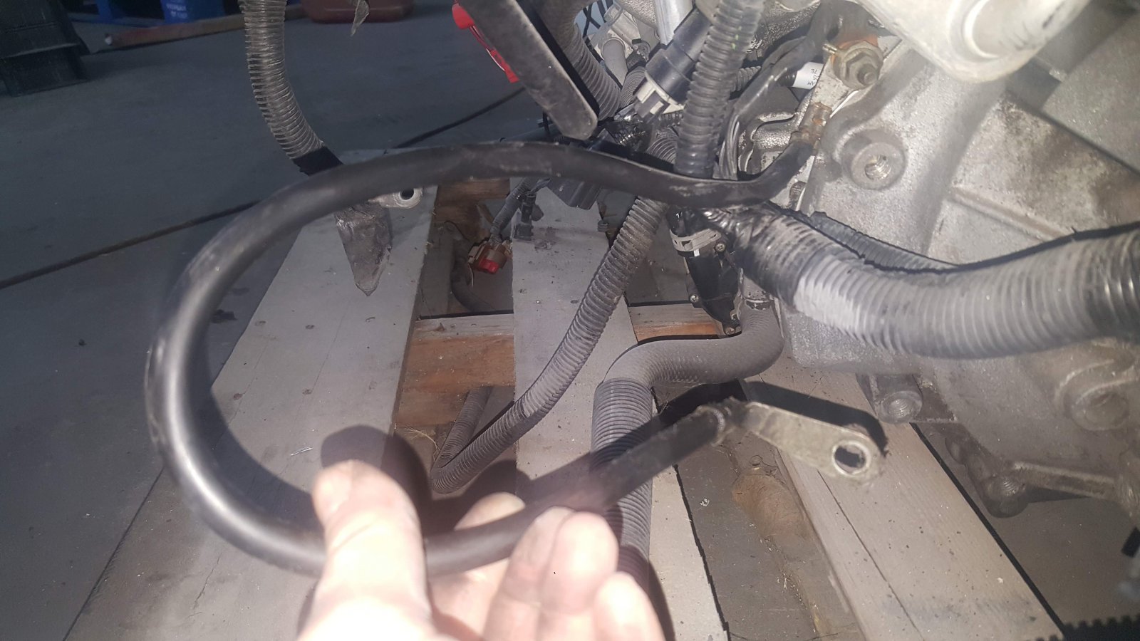

Image of original OEM engine ground. (lower front of engine/transmission)

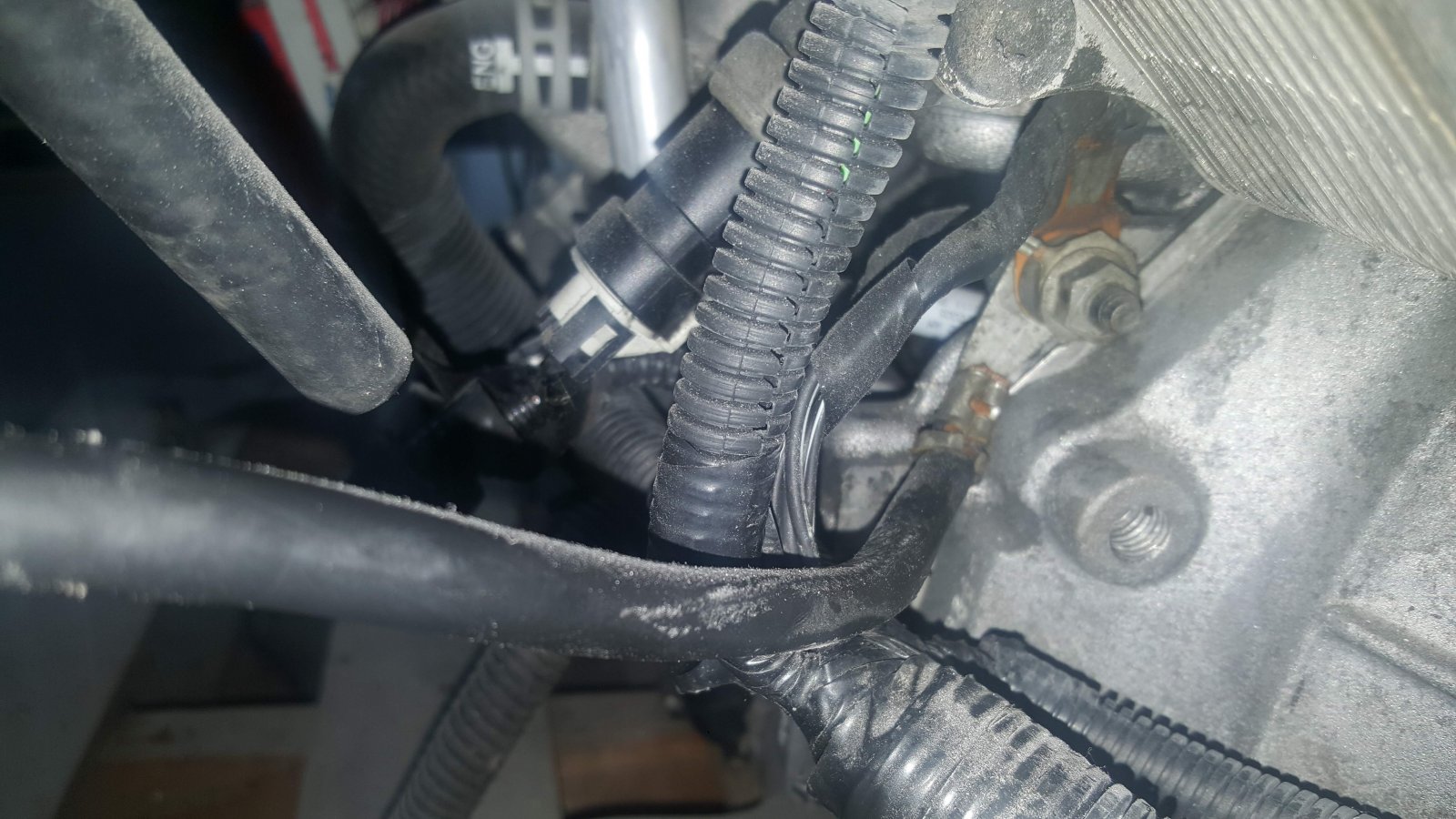

Close up of where it attached to the engine/transmission.

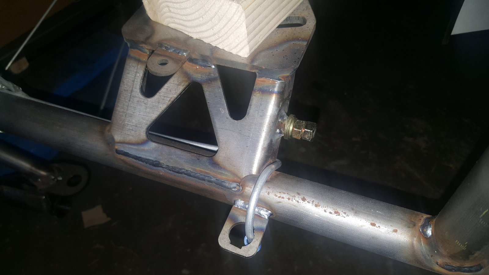

This image shows where it should attach to the frame. (remove the double nuts and use one of the nuts and the washers to attach the ground cable)

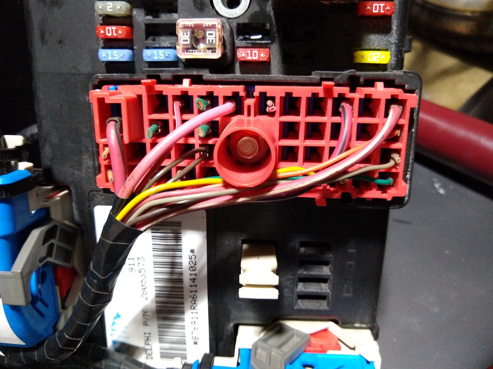

Make sure all the bolts through the plugs in your engine fuse box are very tight.

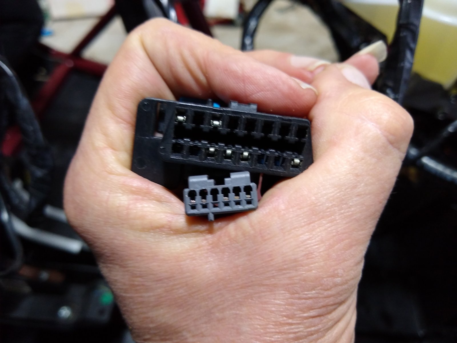

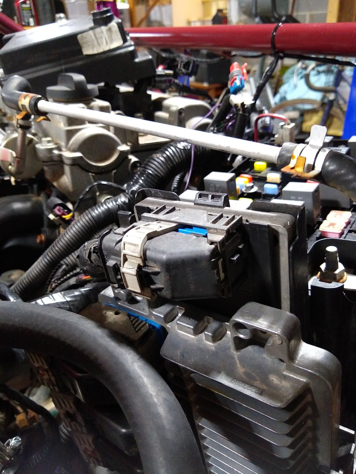

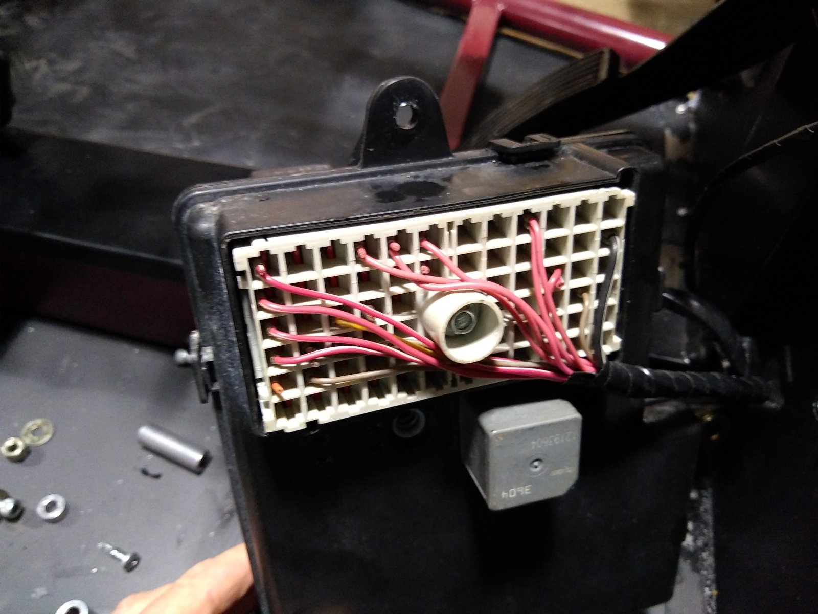

The throttle plug is in and secure. I'm getting continuity from OBD row 2 pin 3 (brown with black stripe) to power steering pin 1, and from OBD row 1 pin 3 (brown) to power steering pin 2. What do I check from power steering to BCM? And then where on the ECM (which I am guessing is the computer on top)?

I'm not going to be able to tell you the exact pins because all my documentation is for the SS/TC ECM, but if I was you, I would just start by testing end-to-end continuity from the ODBII port to the correct pins on your ECM plug. Alldatadiy or another forum user can probably tell you the right pins on the ECM side. If you don't get continuity there, then start breaking it down and testing in between.
