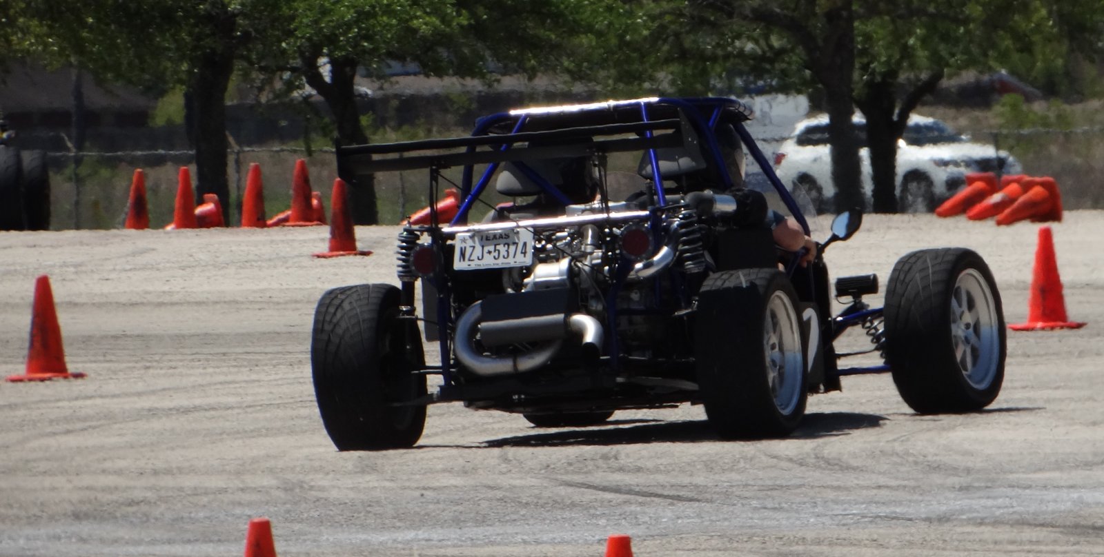

@Rttoys and I have run quite a few autoX in the last year. Russel installed a rear anti sway bar recently and is still evaluating it. I will let him chime in with his thoughts.

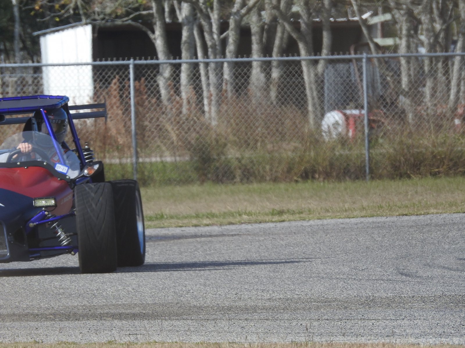

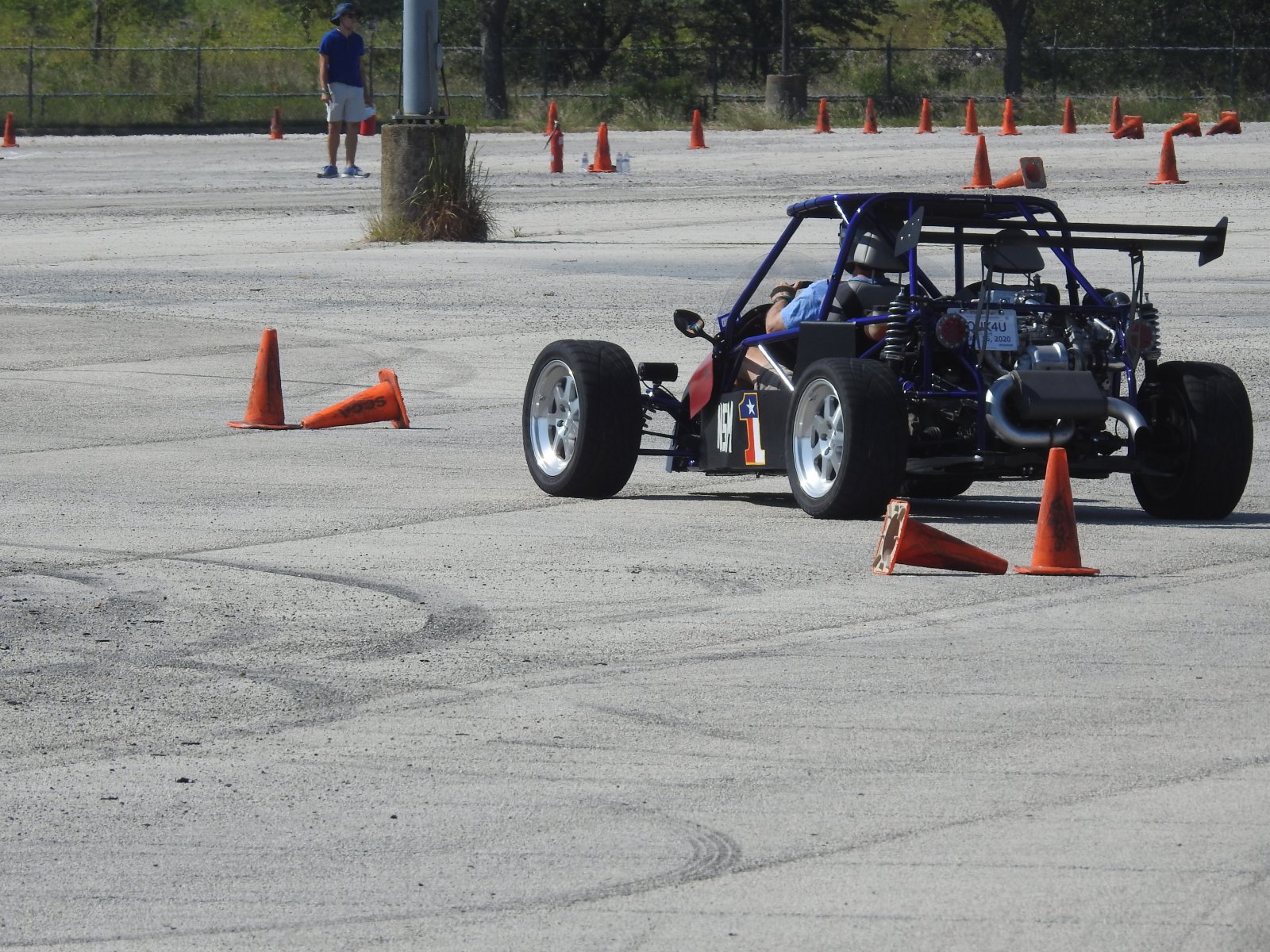

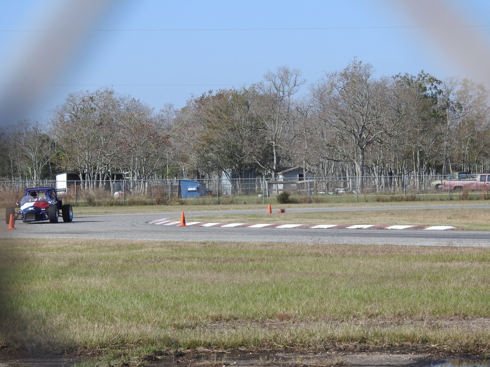

After looking at a bunch of pictures of my Goblin in corners, I do not see that much spring compression in the rear or body roll. At lower speeds in cornering (less than 50 mph), my opinion is a roll bar will not make that much of a difference. I do have and LSD too, just for a complete picture.
In the second and third pics below, I had not yet increased my front shock dampers to full yet. Since I have been running the front full hard, I notice less and a more balanced roll through corners and also the quick slaloms. The lighter front end is now picking up more weight in the turns.
My opinions above are with me alone in the car - 195 lbs.
With a hefty 230 lb passenger, the dynamics change considerably. Note the last pic. :0
Keep in mind that the ground was not level in that turn so it accentuates the roll appearance. The lower control arms relative to each other is a good gauge.
Just a few more data points for y'all. ;)

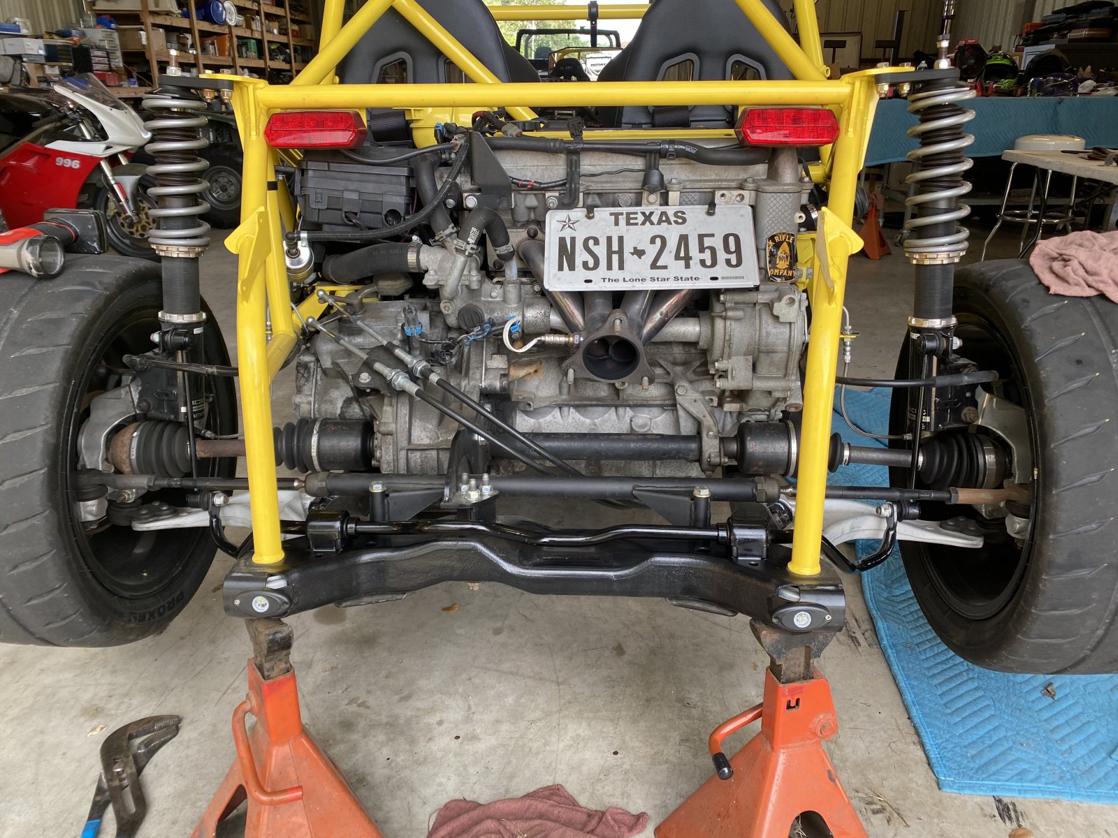

Maybe?

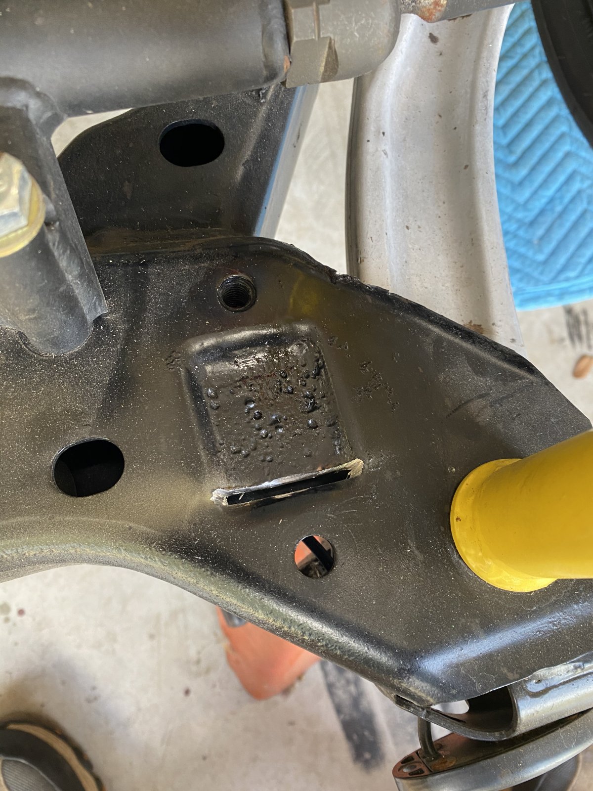

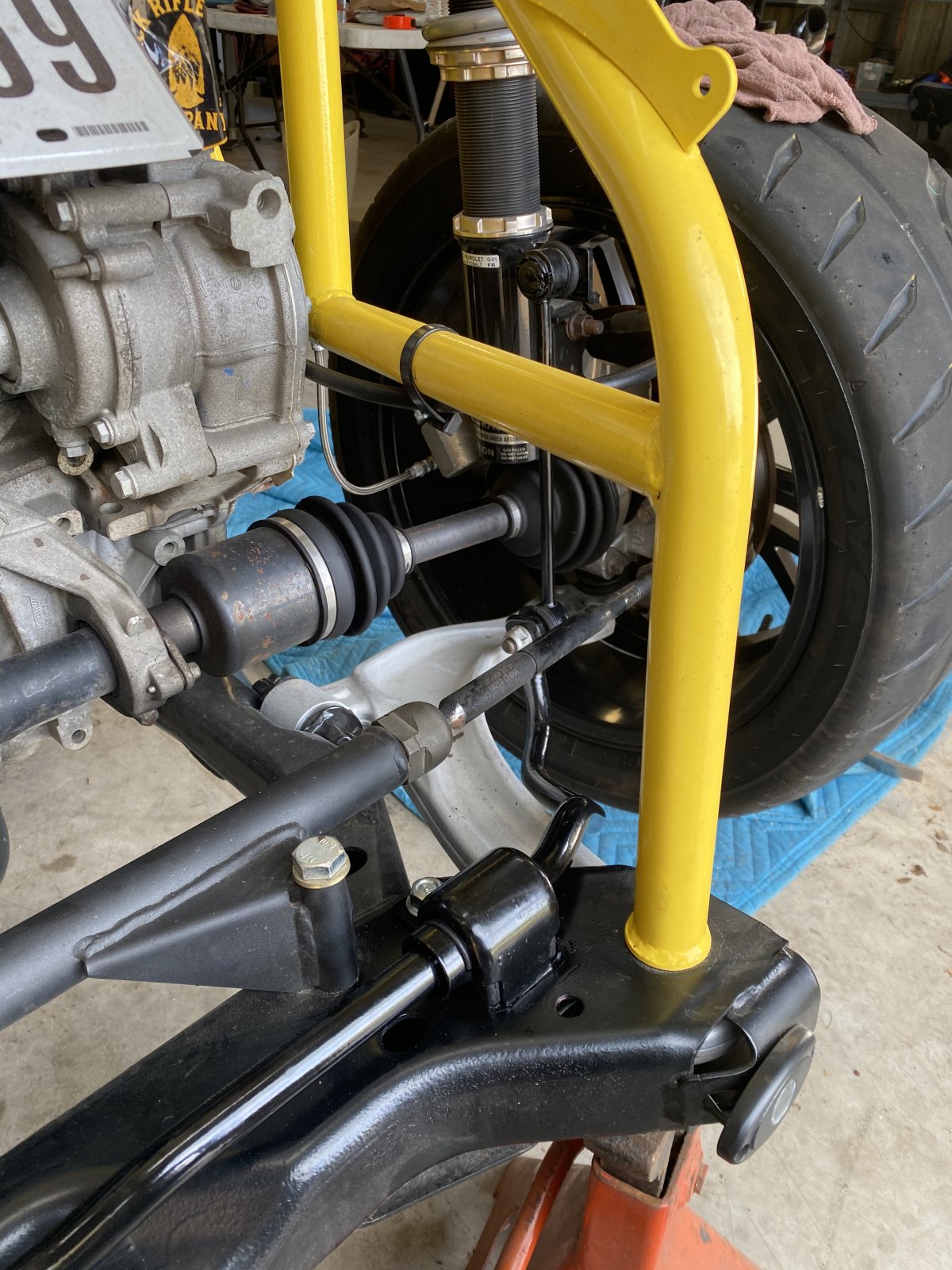

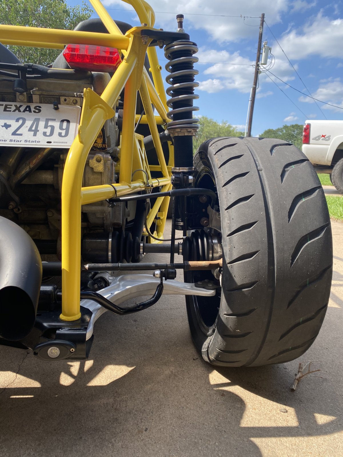

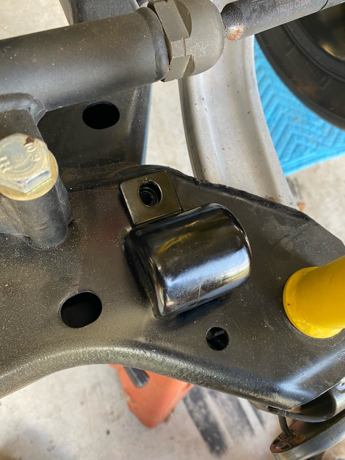

I’m not completely sold on it, but I think overall I like it. If you read up on them, you cannot use a “SS” swaybar, they are just too stiff. Dorman makes a “comfort ride” sway bar kit that is for the base model cobalt and is pretty thin. This comes with everything, *but* the end links seem way too long. I ended up using my SS end links to bring up the bar. Also, Depending on what subframe you have, you may need to cut notches for the bushing retainers to work. But it’s basically plug and play.
Dorman # 927-109

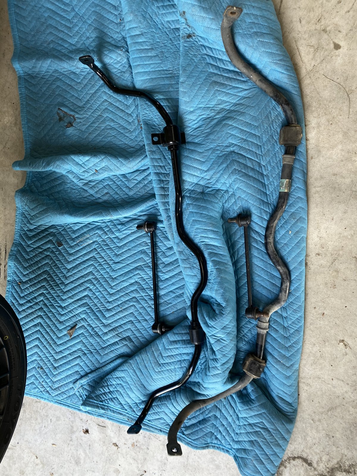

Here’s the difference between the ss and “smooth ride” sway bar.
