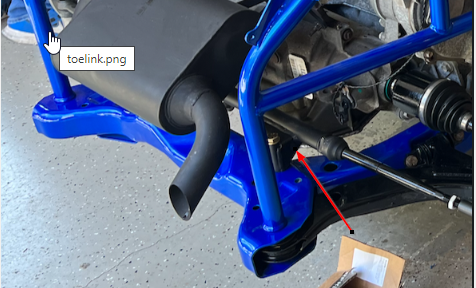

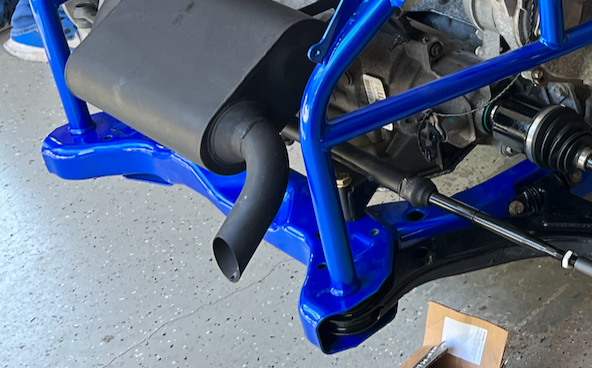

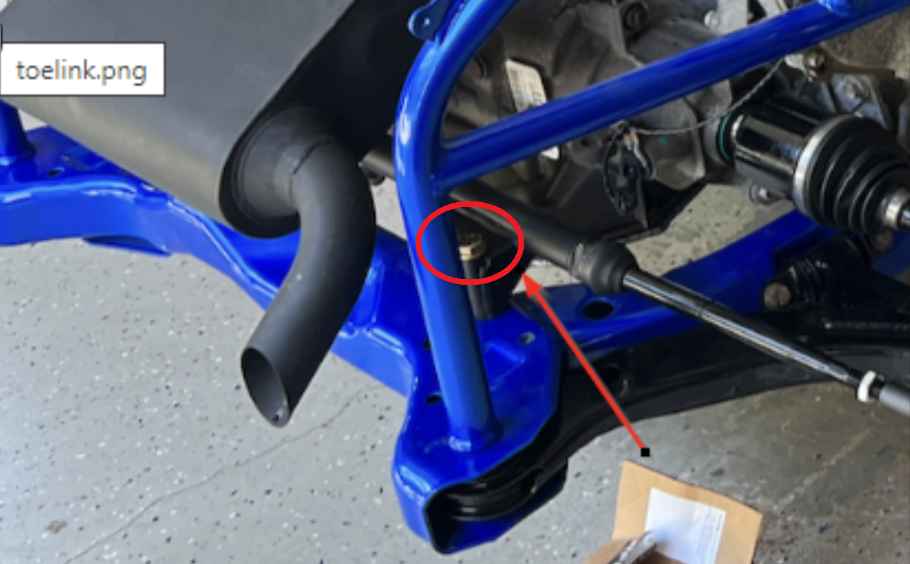

Here is one picture I found,
36497
This one has a bar running across it, would that be one of the steel parts DF provided?

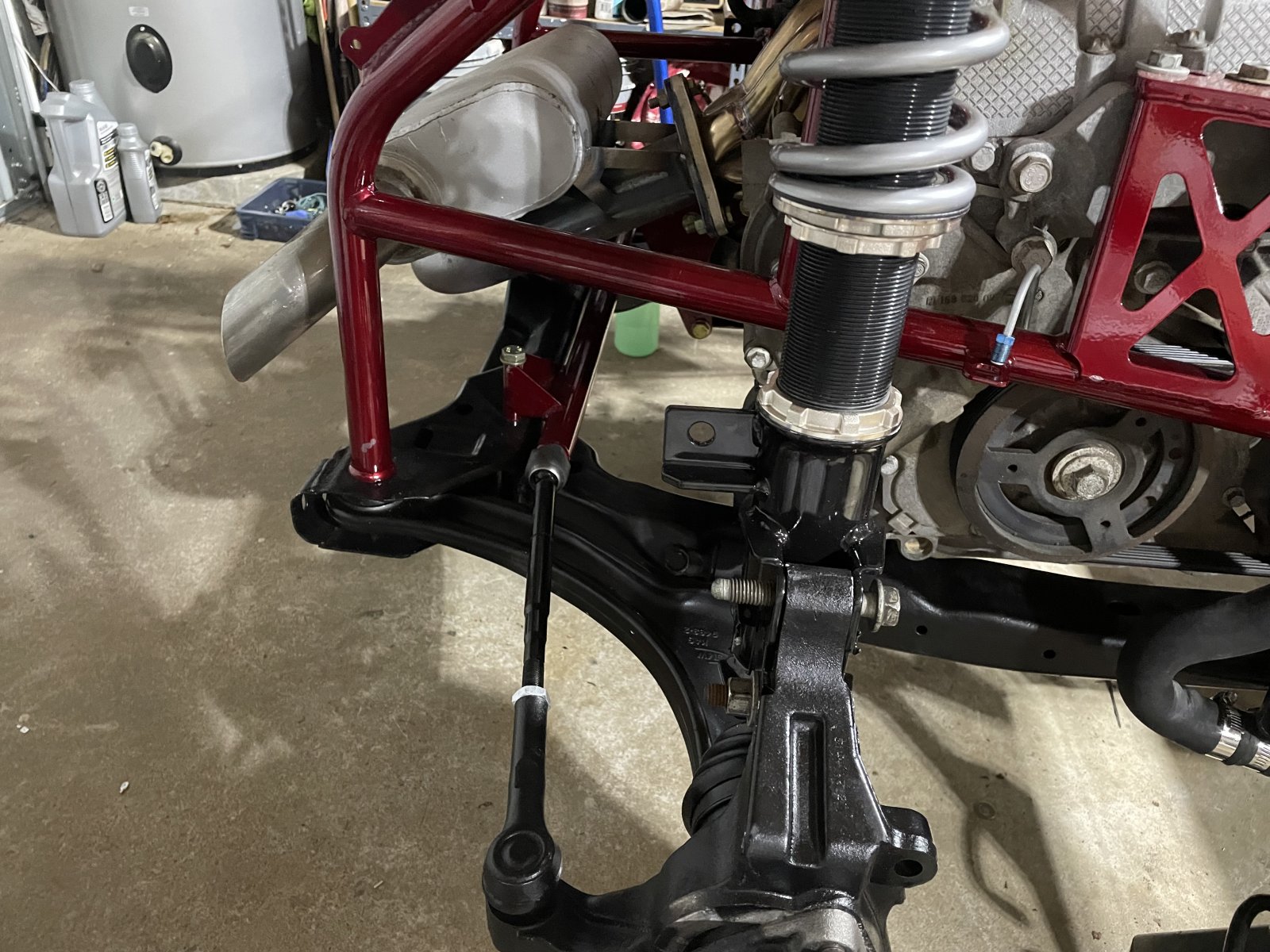

Yes, it's a steel bar that the DF supplied tie rods and the front tie rod ends mount to. My photos aren't great, but hopefully it helps add context to the one you found already.
Edit: my photos have the bar upside down. Do it the way below in posts #7. I swapped mine to the correct position and it made a huge difference with higher speed bumps. My rear end doesn't pucker as much when hitting bridges or asphalt changes at highway speed now.
That toe link bar is upside down. It will have a ton of bump-steer if you leave it this way.
