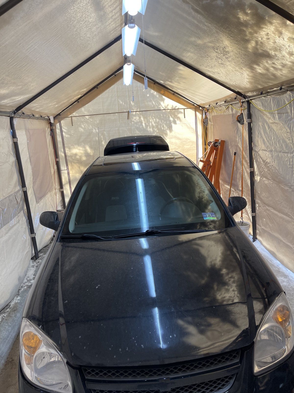

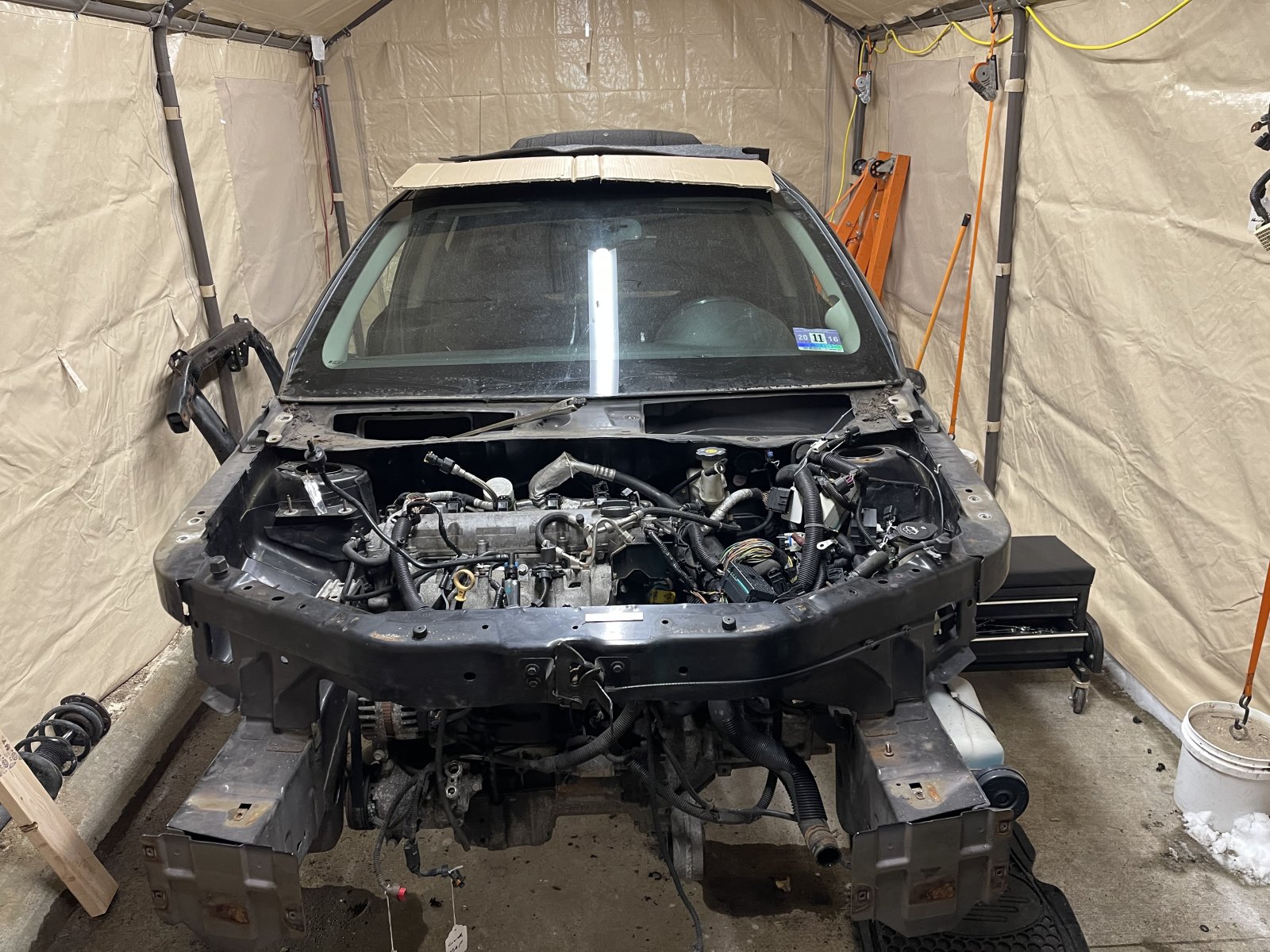

Some goblin builders put up a car sized tent, and strip the donor car down there, then scrap the car body, to make room for the DF kit car.

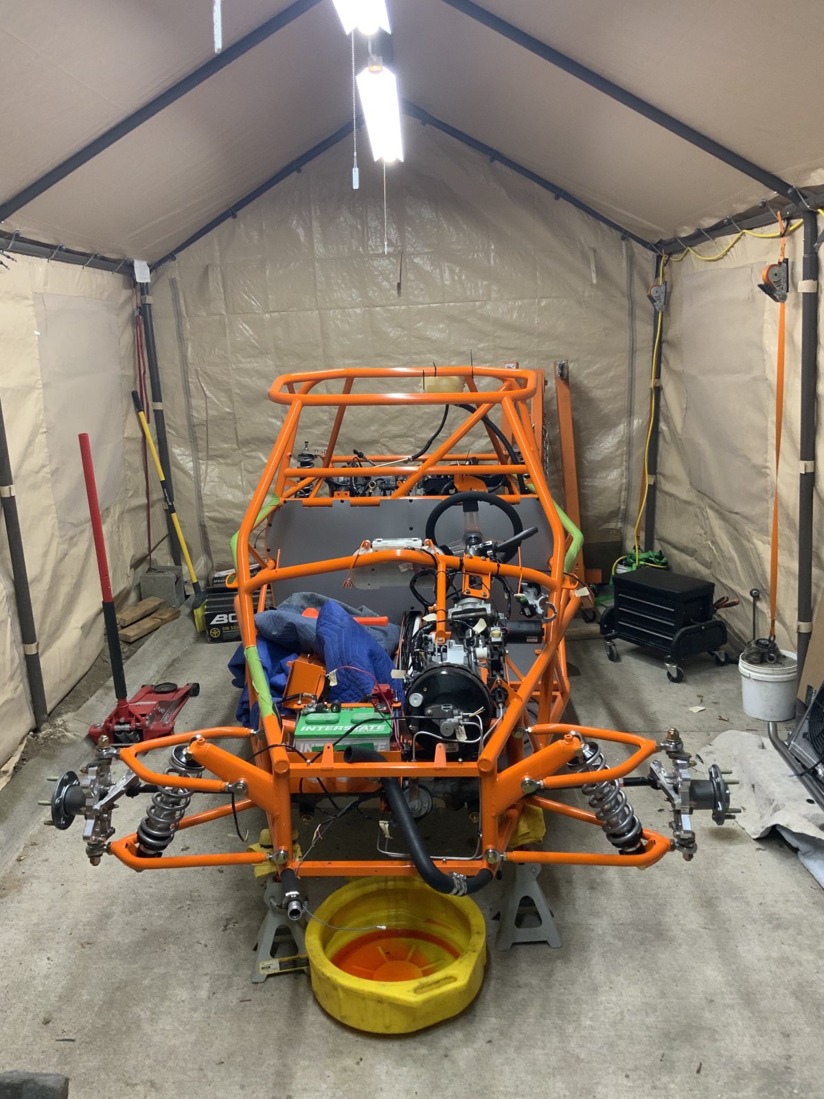

Most builders use one or two bays in their garage, to keep out of the weather. Start reading some build threads, and you will get a feel for what we have done.

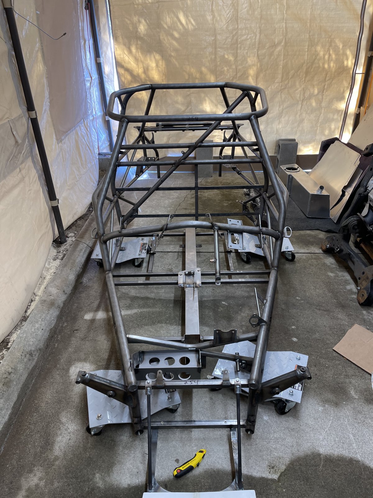

As far as space, it can be done in a 1 car garage, but it’ll take organization and a lot of shuffling. The more space the better. If you are determined and willing, anything can be done, and like Ross said, you can get creative on making your own work area to get it done.

Ross’s comment of a tent size shelter is good, I can see doing that in our driveway For a donor tear down. Goblin build in the garage.

I built mine in a 10X20 car port
in February in Michigan.

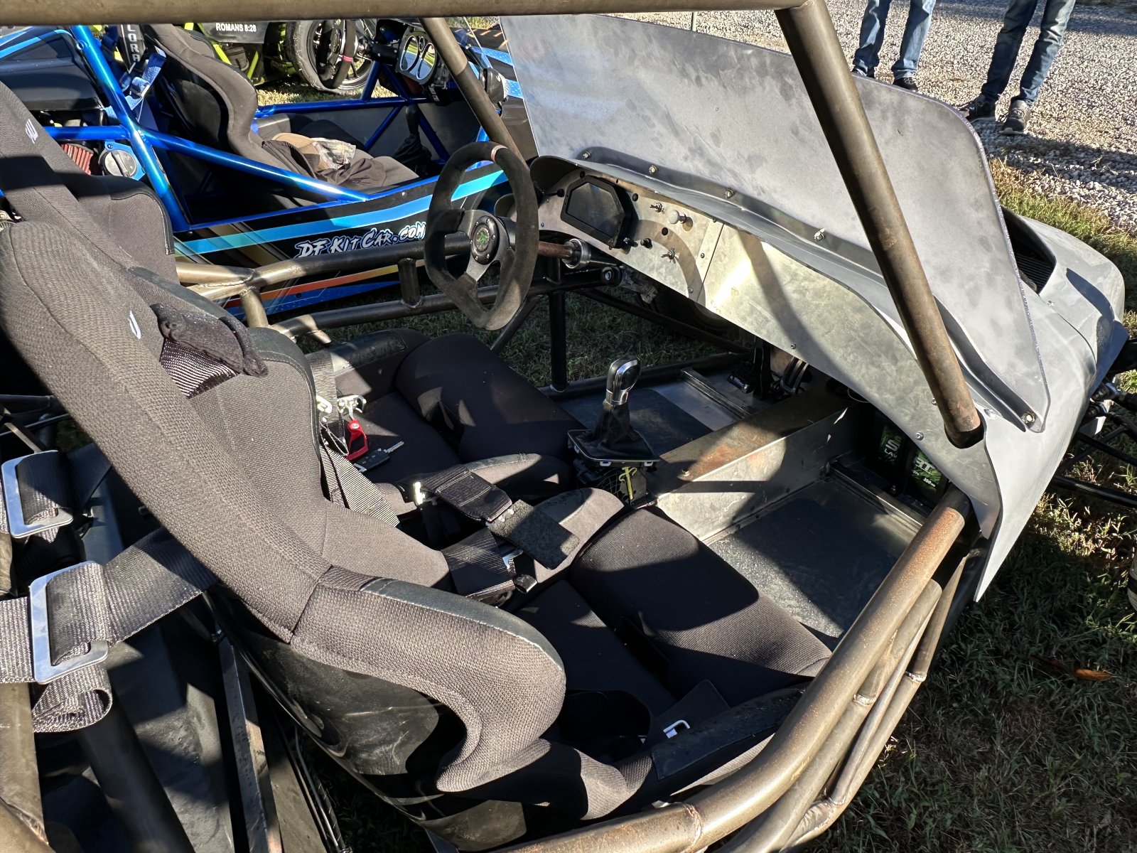

On my V1 goblin, I used the stock Cobalt seat belts, which just bolted in. When I added the 5 point harness, I did add a harness bar based on my sitting height, and end up drilling out 1 hole a bit bigger. The DF frame came with a center strap mounting tab with bolt hole, under the seat. This is just for those builders who upgrade to a race harness. The Cobalt seats did require a couple of small tweaks to get in, but those were pretty easy. Not sure about the V2 goblin, as those haven't started shipping out yet.
The V2 prototype has 5 point harness installed. I’m not sure if that’s the way it’s going or you can utilize the stock belts like the V1 does. Like Ross said on the V1, putting harnesses on was easy though.
