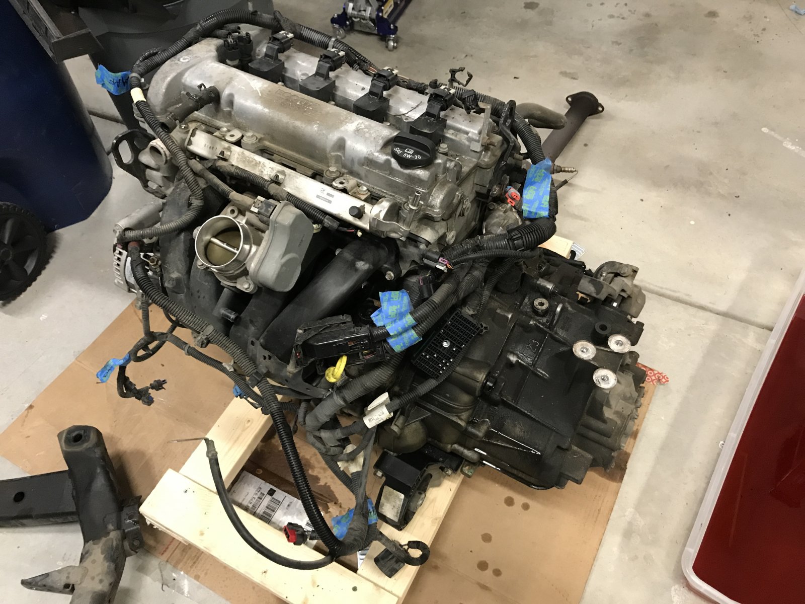

About to drop the 2.4L NA engine tonight. Do I need to save the motor mounts?
(What mounts are included with the kit? What are these solid mounts I hear about? Extra?)

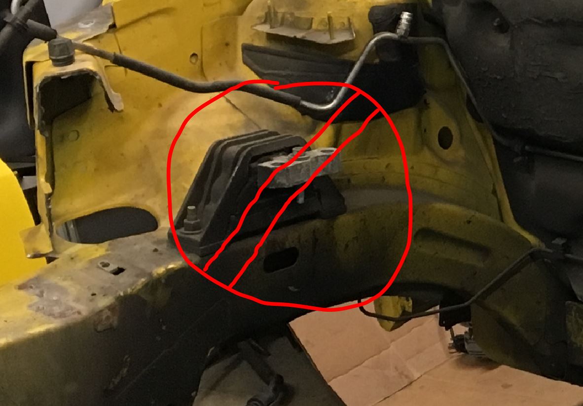

JeffsGoblin
Yes, save the motor mounts on the engine. You do not have to save the ones on the body:
All four of the OEM motor mounts are rubber mounted. The kit car mounts the left and right sides to the frame using a solid mounting. The forward and aft mounts use the original motor mounts from the engine to the subframe. DF can supply, at an option, solid mounts to replace the forward and aft mount so all four are solid. This is recommended for anyone with higher output engines as it can put additional stress on the frame mounts when the OEM front and rear are used retained since they allow for flexing and the frame mounts do not.
Dang, I didn't know that. I thought I had all four as rubber mount. Now I need to order the other 2 mounts as solid.

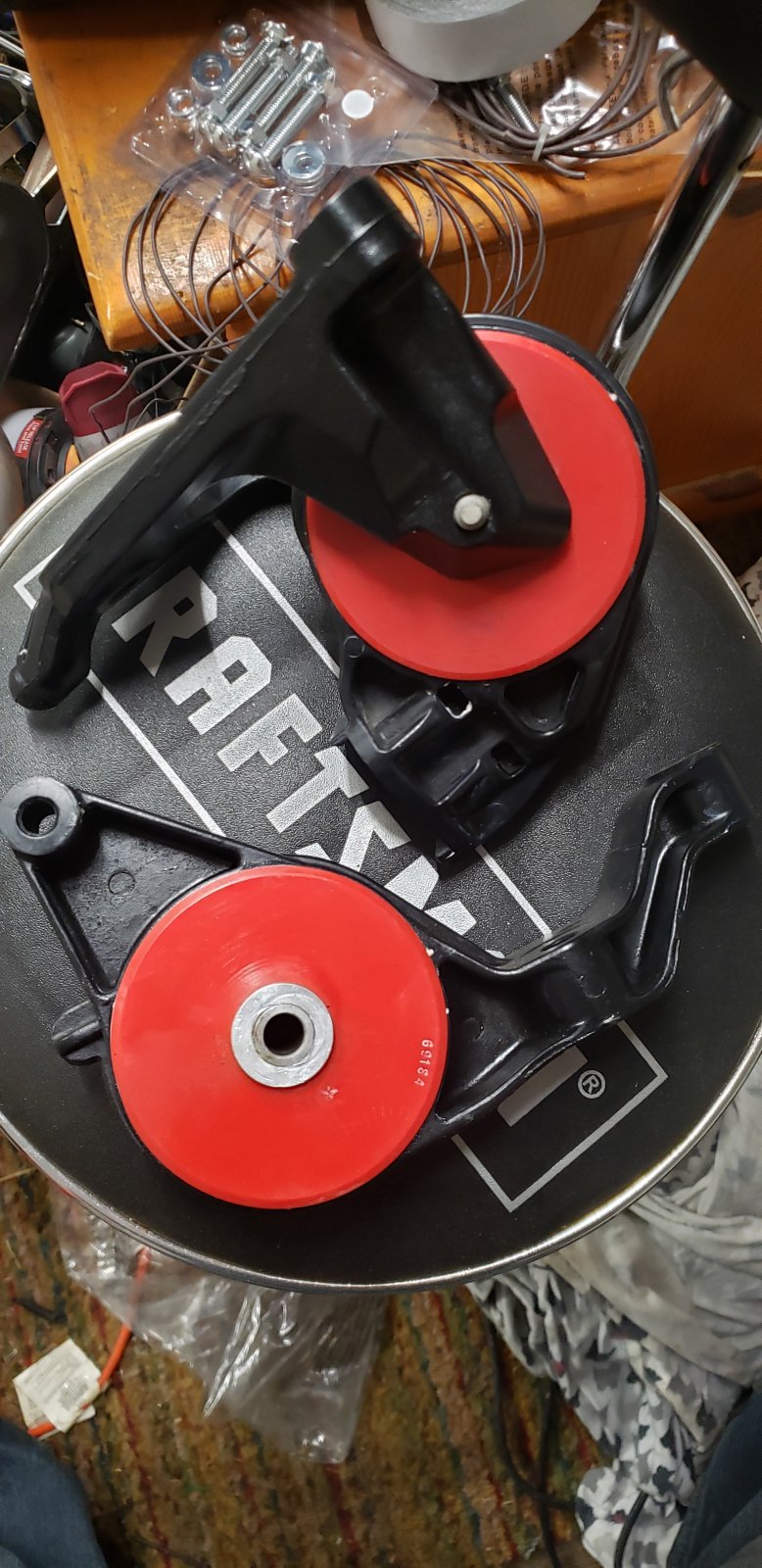

k.rollin
Another option for a more rigid mount is to remove the rubber isolators of the stock lower mounts and installing polyurethane ones.
Old rubber, full of holes.
New Prothane inserts, sans holes.
