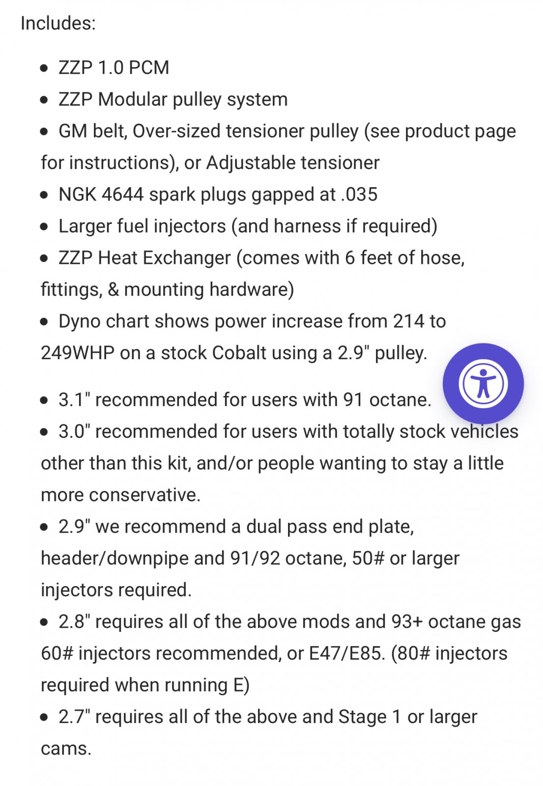

If you're dropping pulley sizes you definitely need to address cooling sooner than later. A stage 3 intercooler or equivalent. A phenolic spacer for the intake manifold helps keep the engine heat from transferring to the intake. And you don't need to port the intake manifold, just the head and sc if you choose. Most porting is done on the exhaust side(which is the restrictive side) to match the intake. You can however polish the intake manifold while you have it apart to do the dual pass endplate. You can get the SC ported to use the larger ls4 throttle body and move more air, which I think is especially beneficial if you're going to a smaller pulley. So if it were me, and you wanted more oomph and to maintain driveability:

2.8 or larger pulley which requires all of the above(2.7 requires cams according to ZZP)

Also here is the screenshot of the zzp stage 3 kit which shows how you should select the pulley size.
