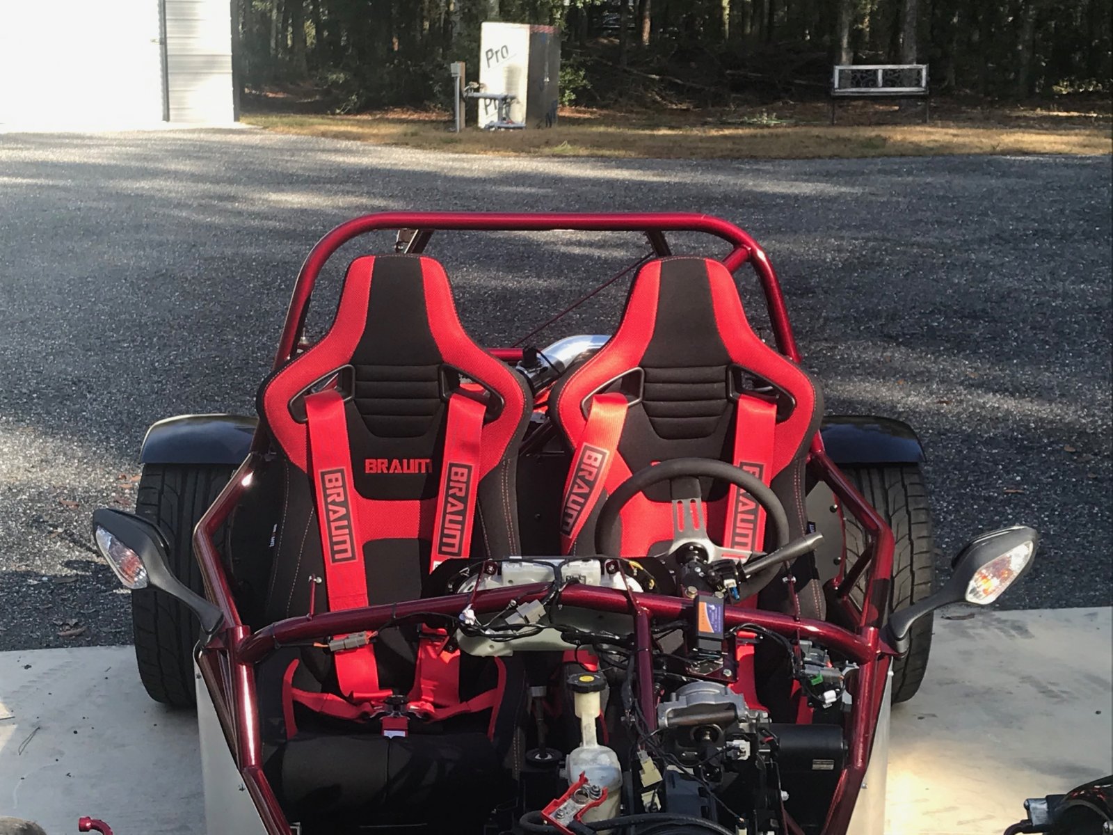

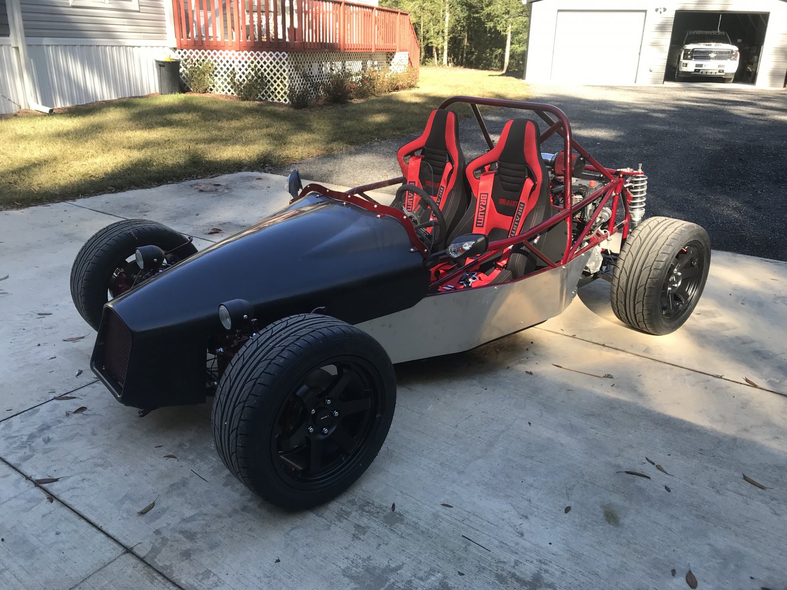

I went with Braum seats. The Elite-R series. They recline and are on sliders. I did weld in my own mounts before I powder coated the frame. I'm very happy with them. They are around $900 for the pair (sliders included) but I did get a nice Military Discount of $135 so I paid $765.

I’ve looked at these seats. Look fantastic in your car

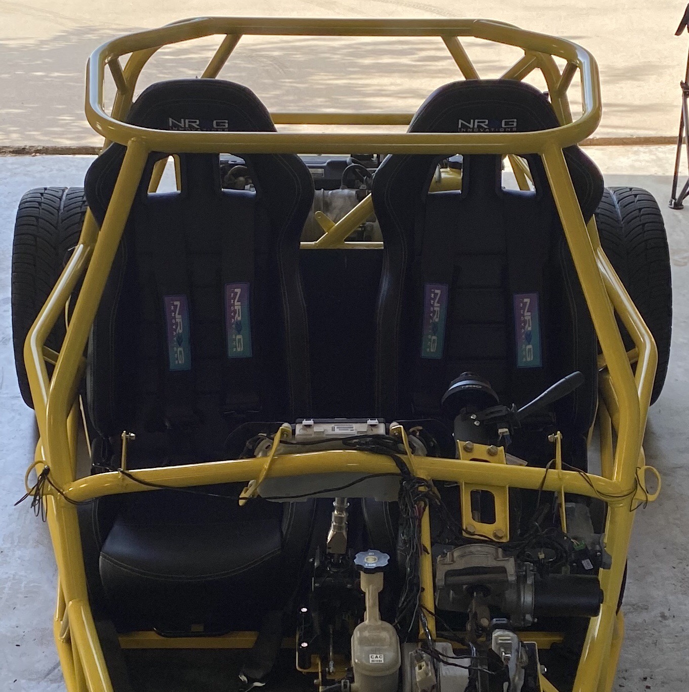

I’m using the NRG 208‘s with cobalt mounts and sliders.
Seats
NRG innovations RSC-208L/R
Planted technology cobalt seat brackets
SB225DR and PA
with the cobalt brackets, these were a direct bolt in.
I‘m a big guy (5’10” / 250#, 38” waist) and they work fine for me. Like I have said before, they could use a little more lumbar support, but I like a lot of lumbar.
