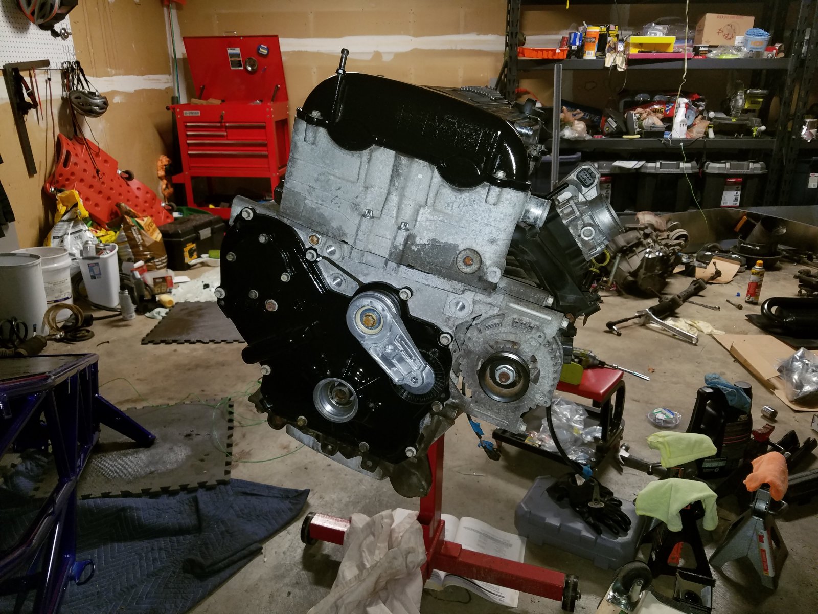

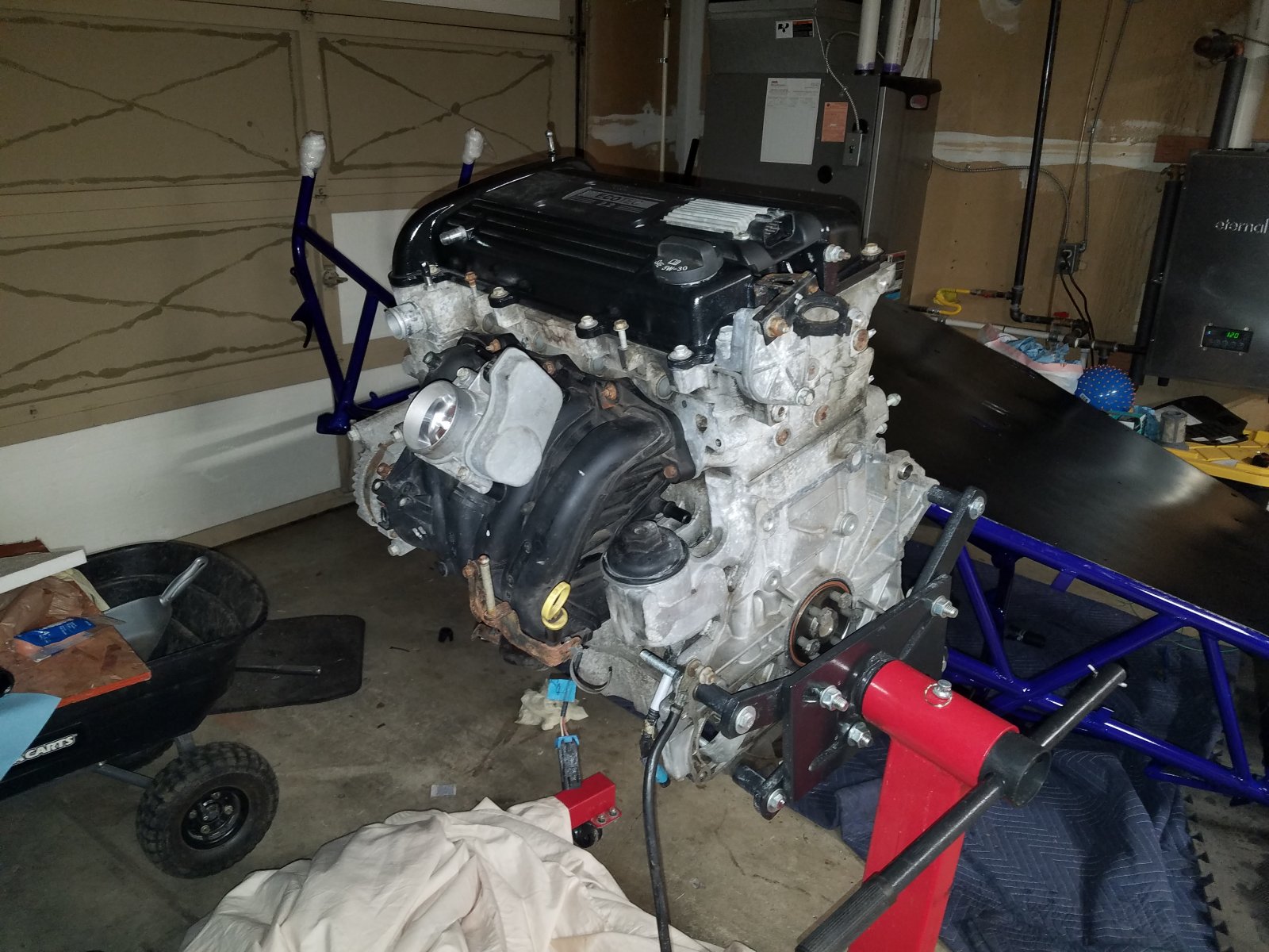

Fairly straight forward to take it off. I took my transmission off (manual) and put the engine on an engine stand to work on. I have not reassembled it yet. I will soon.
