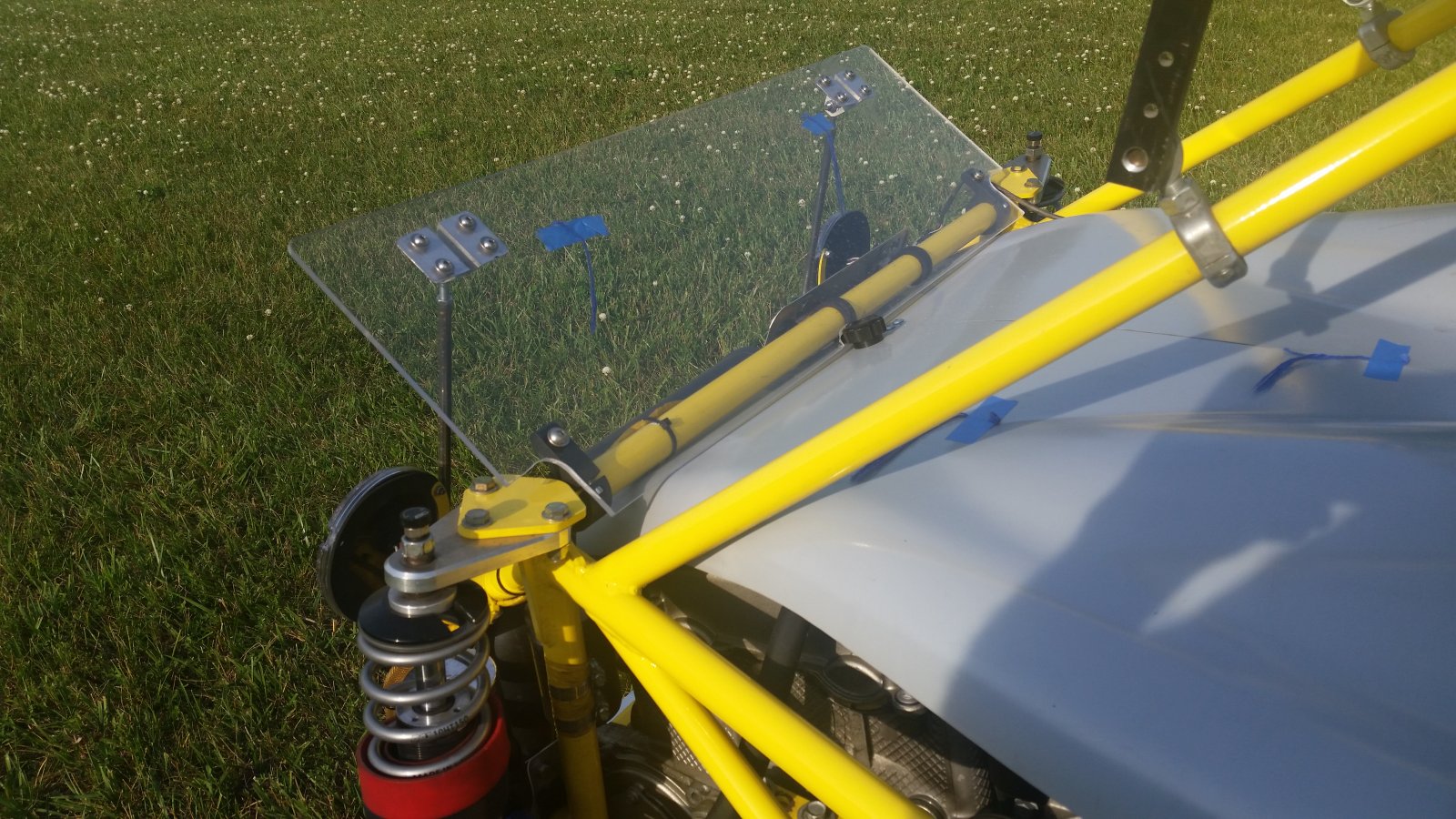

Installed last summers last year's wind screen that is cut down and has a U slot cut in the center. In the mirror could looked like air flow is better.

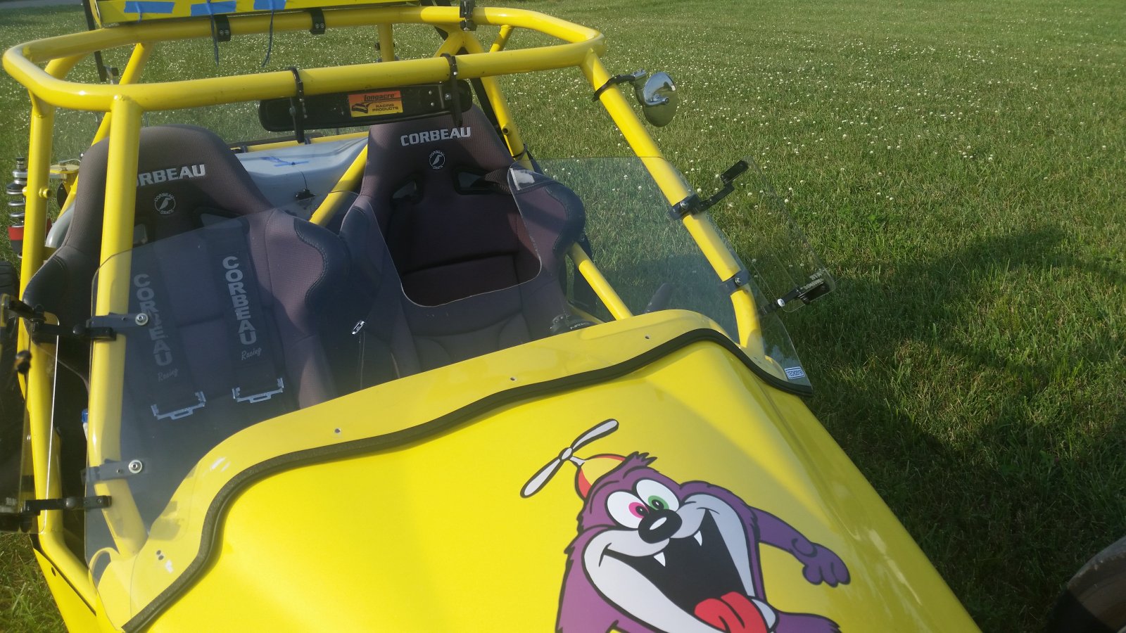

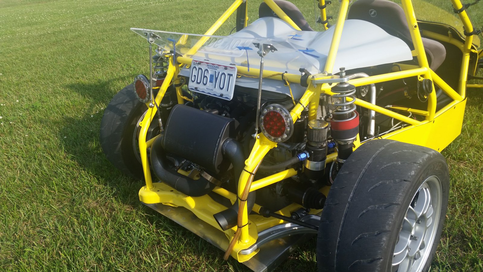

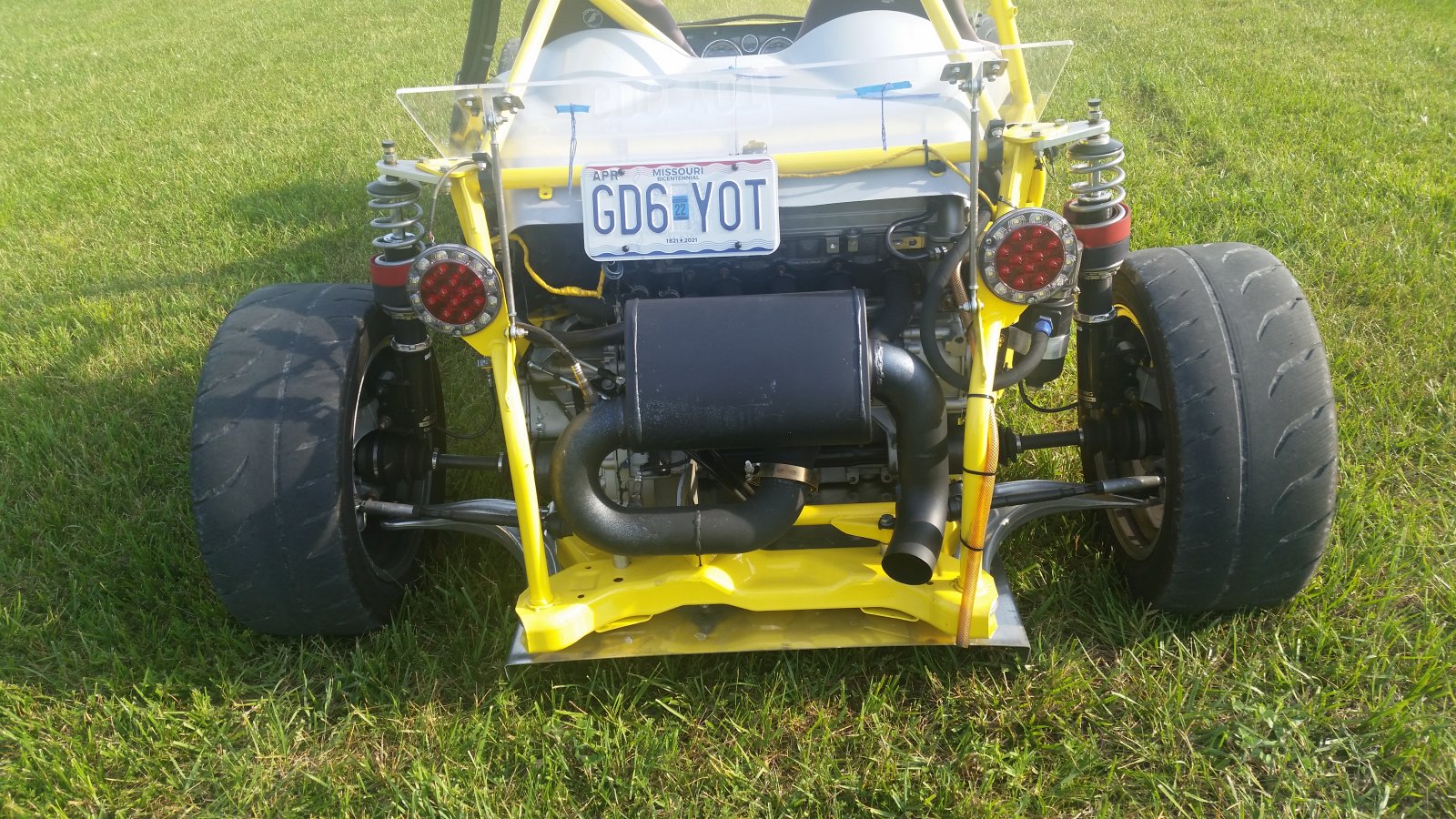

Made a couple of new parts for airflow. Besides the windshield with the U cut in the middle. Copied Waterdrivers rear belly pan. And added a 12x36 rear spoiler. With the engine cover on I get no hot air coming from the back and no exhaust fumes.
And the Air Wings work very we to keep the cold air out in the morning and crate air flow as the outside temps rise
Brad

Have you changed how the top of your rear shocks mount also ? Mine seem to seat further up with more threads exposed where the adjuster sits.

Used a spherical bearing 22mm od and Id to match strut.

Maybe I just thougnt I did. Searched for spherical bearing b with a 22mm od with I'd to match strut. Pressed the bearing in the aluminum strut mount. Threaded a small hole next to the bearing to place a small screw and washer to keep it in place.
Made hat pieces for below and above the bearing.
